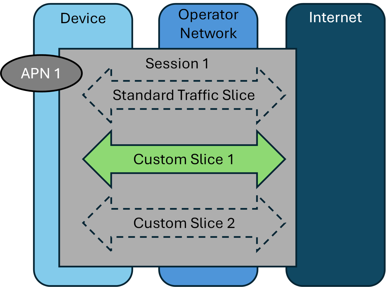

Single Slice
A single APN can be used on our 5G routers now, with the mobile network assigning the traffic to a specific slice. Each device can be configured to use a different slice. But just one slice at a time.
Technically, the device gets assigned a single IP address.

Single slice option is already available for ICR-4400, ICR-4100, ICR-4200, and ICR-2400 RedCap series.

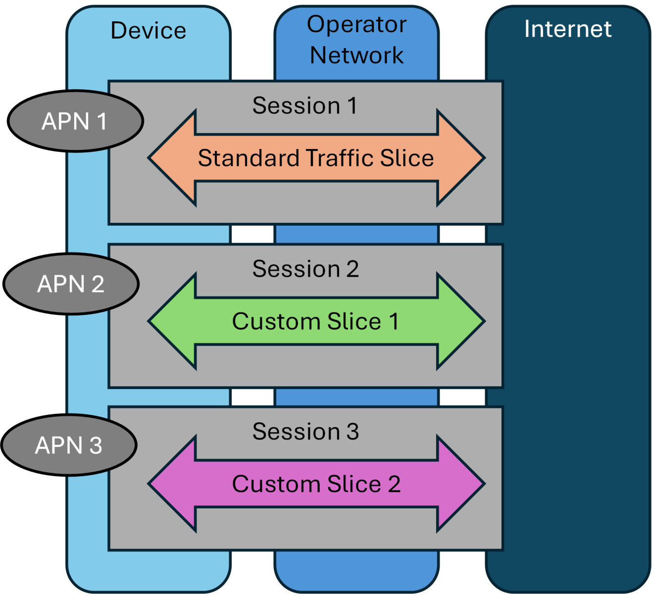

Multiple Slices
Devices can connect to multiple APNs in parallel, with each APN mapped to a different network slice. This allows router services and physical or virtual interfaces to be assigned to selected APNs/slices, enabling controlled separation of application traffic and connectivity paths. For example, management traffic can be routed via one slice, while machine control or sensor data uses another slice. Technically, the device gets assigned multiple IP addresses, which enables the device to route traffic from various VLANs to different network slices.

Multiple Slice capability is not currently supported by Advantech routers but is to be applied across the current Advantech portfolio of 5G and 5G RedCap routers (ICR-4400, ICR-4100, ICR-4200, and ICR-2400 RedCap series) during 2026 via firmware update with no any additional hardware changes required.
