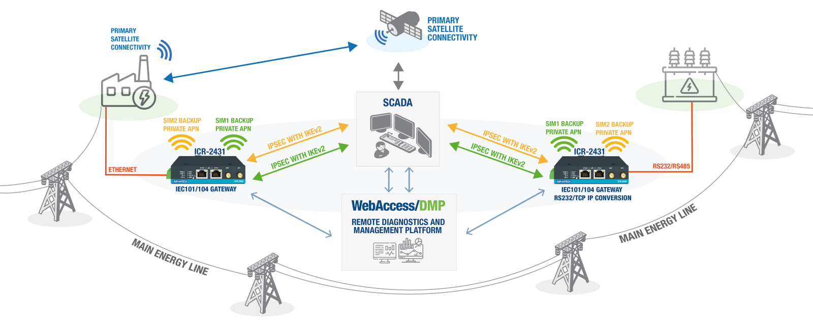

To ensure security for critical infrastructure, all communication between routers and central systems is fully encrypted using IPsec with IKEv2. Each SIM card uses a private APN, isolating it from the public Internet, and centralized certificate management via SCEP guarantees ongoing control and authentication of connected devices.
For network redundancy, the architecture includes dual, geographically independent VPN termination points using CheckPoint firewalls. Each router establishes two IPsec tunnels to both centers, ensuring uninterrupted service even if one path fails. At the field level, standard sites are equipped with dual-SIM routers, automatically switching between mobile operators in the event of network outages. High-priority sites go a step further with pair of the LTE routers, offering simultaneous connections over two mobile networks in hot-standby mode. Additionally, these critical locations integrate satellite connectivity as a third, independent transmission medium, achieving triple-path redundancy (2× LTE + 1× Satellite).
Legacy communication protocols also posed a challenge. Many remote devices still operate over IEC 60870-5-101 via RS232 serial ports, whereas modern SCADA systems rely on IEC 60870-5-104 over IP. To bridge this gap, Advantech provided bidirectional IEC 101/104 protocol conversion directly within the routers, along with a custom Router App for seamless integration.
Given the massive number of sites—more than 1,000 to be migrated and 4,000+ new ones to be deployed—manual configuration was not feasible. Advantech addressed this with its WebAccess/DMP management and provisioning platform, enabling Zero Touch Deployment, remote diagnostics, and site-specific configuration. The platform also features a REST API, allowing direct integration with the customer’s internal systems for streamlined rollout and monitoring.
