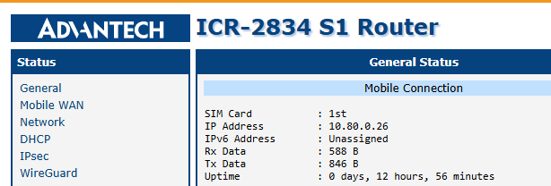

S1 Router GUI
What remains the same is the familiar look of the S1 Router's web interface for configuration.
Customers can operate a familiar interface, logically segmented into categories.

The GUI remains the same, making it very familiar to any user of our current routers. For standard users who use the GUI for configuration, there is virtually no difference between a standard router and an S1 Router. You can identify that you are configuring an S1 Router by the “S1” label in the router model name within the web GUI, as well as by the orange color scheme, which distinguishes it from the green color used in the standard production web GUI.
