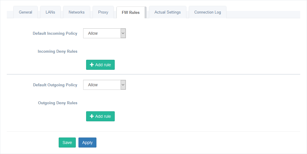

- Firewall filtering rules can be created separately for individual devices and for entire groups of devices (Networks).

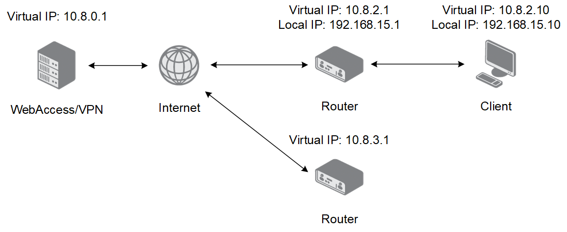

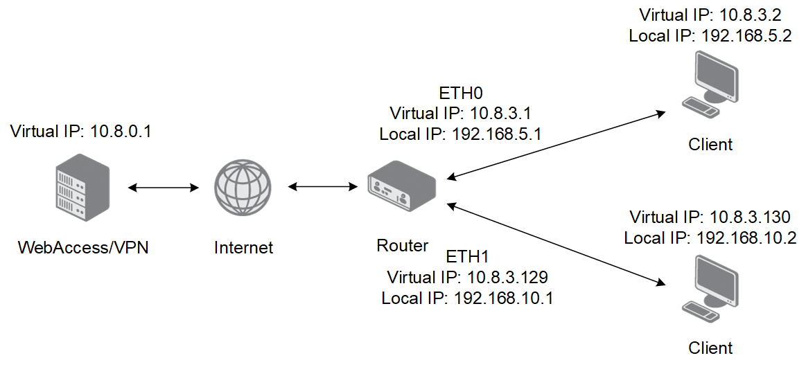

All routers connect directly to WebAccess/VPN via OpenVPN tunnels. Rules for mutual access (Networks — groups of devices) can also be created. Additional VPN tunnels (Standalone VPN Clients) allow any other device (Windows, Linux, smartphone, etc.) to access the secured network.
Parts of the WebAccess/VPN System
The elements of a WebAccess/VPN instance are:

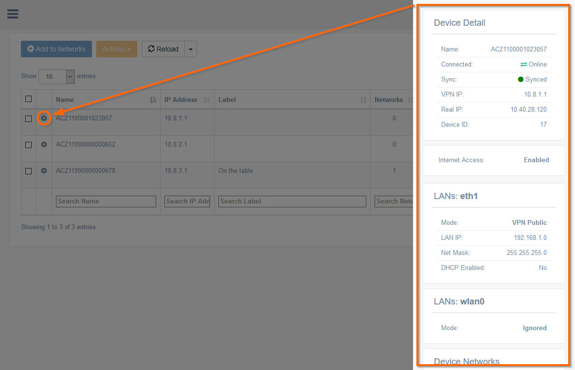

- Devices — Routers or Standalone VPN Clients are the leaf elements. The VPN Portal Router App must be uploaded to the router. Routers then connect to the following two entities:
- Dispatch Server (DS) — A registration service that holds the current IP address of the Customer Server (CS). Whenever routers have difficulty locating their CS, they contact the DS for its current address and credentials. The DS is used only when routers do not know the Customer Server address.
- Customer Server (CS) — The central traffic point for interconnected devices. Routers are organized into groups called Networks, which prescribe which routers may interconnect with which others.

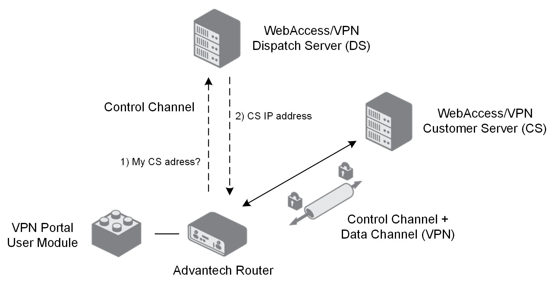

How the Router Connects to the System
As shown in the figure below, the router first contacts the Dispatch Server (DS). The DS provides the router with the Customer Server (CS) address. The router then connects directly to the Customer Server, an OpenVPN server with a Web UI that controls traffic. The CS lists the router as a new router waiting for validation.

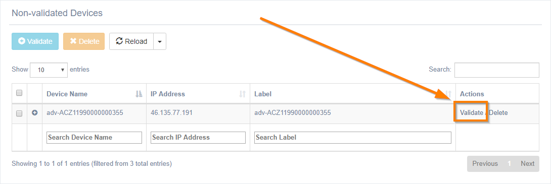

After the router is manually validated (granted access) by the administrator on the Customer Server, the CS provides OpenVPN credentials to the router and can force the configuration of LAN addresses if set manually by the administrator. The router (and its LANs) can then be manually added by an administrator to a Network, where it can access networked peers and their LANs.

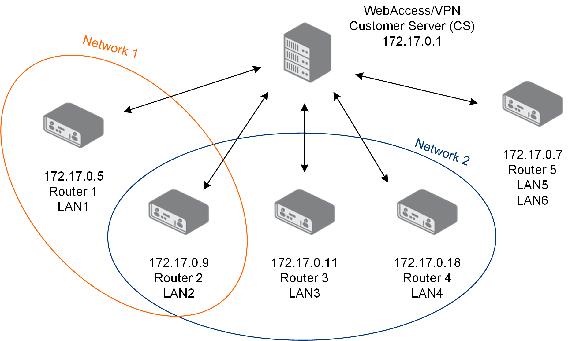

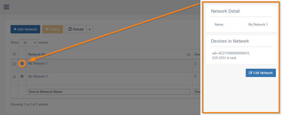

Networks — Groups of Devices
The local network behind a router is called a LAN. A group of devices (routers and Standalone VPN Clients) that can communicate with each other is called a Network. All validated routers (and the Customer Server) are part of the "VPN Network". See the example below, including example IP addresses.
Routers' LANs can be configured at the Customer Server. Networks are also configured on the Customer Server. Any router can be a member of multiple Networks. Configuration changes (LAN ranges, network routing) are propagated to routers when possible.

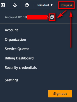

Log in to your Amazon AWS account (https://aws.amazon.com) and select My Account from the profile menu.
Copy your Account ID and send it along with your Region to Advantech at: AEU.CZ-VPN-aws@advantech.com
AWS Account ID Wait for a confirmation email that the installation image has been shared with your account.

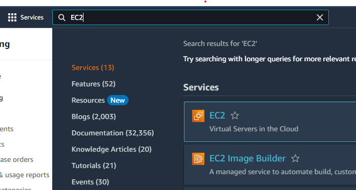

Log in to your Amazon AWS account and select Services → EC2.
EC2 in AWS Services Select AMIs from the Images menu on the left.

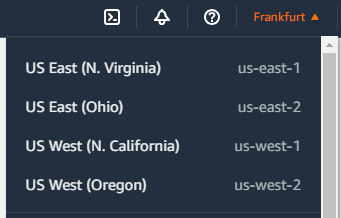

AMIs menu Switch your location to Frankfurt in the top-right corner. To use a different region, contact Advantech at AEU.CZ-VPN-aws@advantech.com to have the image copied to your location.

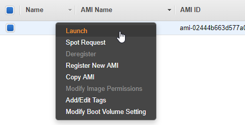

Private images filter The shared image from Advantech should appear under the name WebAccess/VPN. You can verify that the owner ID is
686278836833.Right-click the image and select Launch to create the instance.

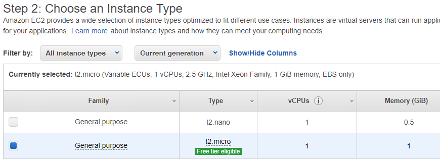

Launch the instance In Step 2: Choose an Instance Type, select t2.micro (for a free account) or follow the Performance Scaling Recommendations.

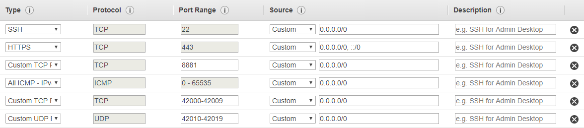

In Step 6: Configure Security Group, configure the firewall rules for the instance. Do not remove the SSH rule added by the system. Add the following additional rules:
- Allow HTTP traffic on port 80.
- Allow HTTPS traffic on port 443.
- Allow TCP port 8881.
- Allow ICMP protocol — all traffic.
- Allow TCP ports from 42000 to 42009.
- Allow UDP ports from 42010 to 42019.
Security group configuration Review and launch the instance. You can create a new key pair or select an existing one. This key is required for SSH login to the instance if needed.

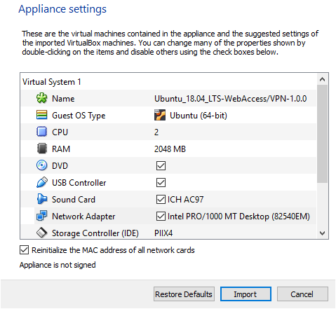

Choose OVA file Review the imported settings. Recommended parameters:
- CPU: 2
- RAM: 2 GB
- Video RAM (display): 64 MB (accessible later in settings)
- Network: bridged (accessible later in settings)
- HDD storage size: 20 GB (accessible later in settings)

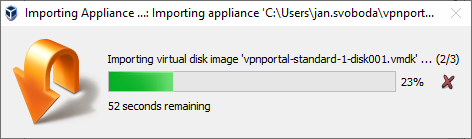

Check the Reinitialize the MAC address of all network cards option, then click Import.
Review appliance settings Wait while the appliance file is imported.

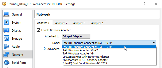

Importing appliance After the import, do not run the appliance immediately — go to Settings and check the Network settings.
Open VM settings In Network Settings, verify that Bridged Adapter is selected under Attached to: and choose your physical network interface.
Caution
A bridged network is required so that WebAccess/VPN is directly accessible in your network. The WebAccess/VPN IP address must be reachable from all routers and clients you want to add.

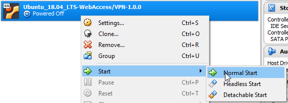

Bridged adapter configuration Run the appliance.

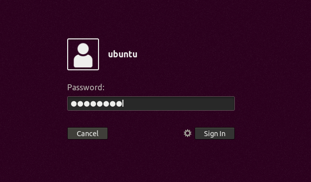

Run the appliance Wait for the system to boot and log in to Ubuntu with:
- Username:
ubuntu - Password:
wavpn123
Ubuntu login screen - Username:

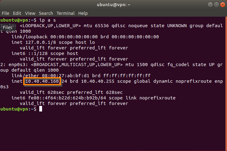

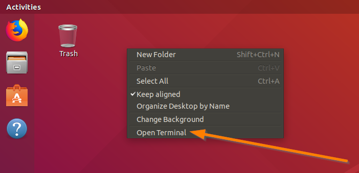

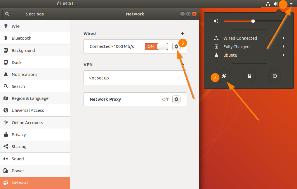

Find the IP address of the appliance's bridged network interface using one of the following methods:
In GUI system settings: Open Settings by clicking the top-right area of the top bar, select the Settings icon, then choose Network settings. Click the settings icon and read the IP address from the IPv4 Address field.
Find IP address via GUI Via terminal: Right-click the desktop and select Open Terminal. Use
ip a sorifconfigto find the IP address of the physical interface (enp0s3).
Find IP address via terminal

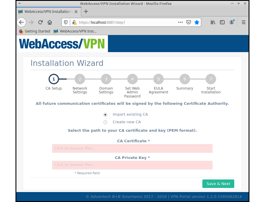

VPN-BOX Installation Wizard Caution
If you encounter the Potential Security Risk Ahead warning, select Advanced... and then Accept the Risk and Continue to access the application interface.
Continue with the wizard — see the Installation Wizard section.

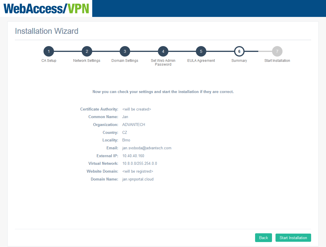

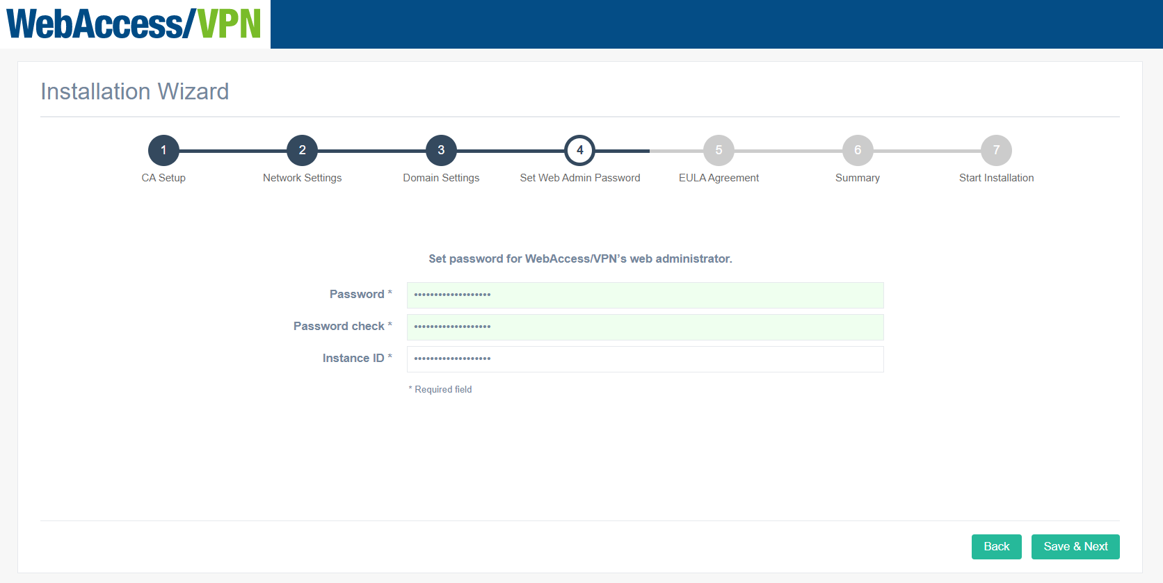

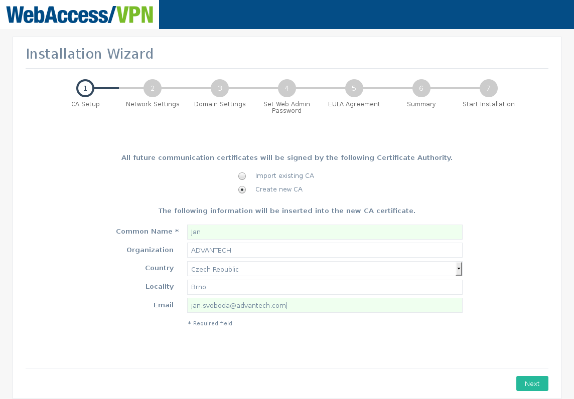

Follow the instructions in the installation wizard. If you do not have a Certification Authority to import (CRT certificate file and PEM key file), use the wizard to create one.
Note: If using your own Certificate Authority, the key file to be imported must not be password-protected.

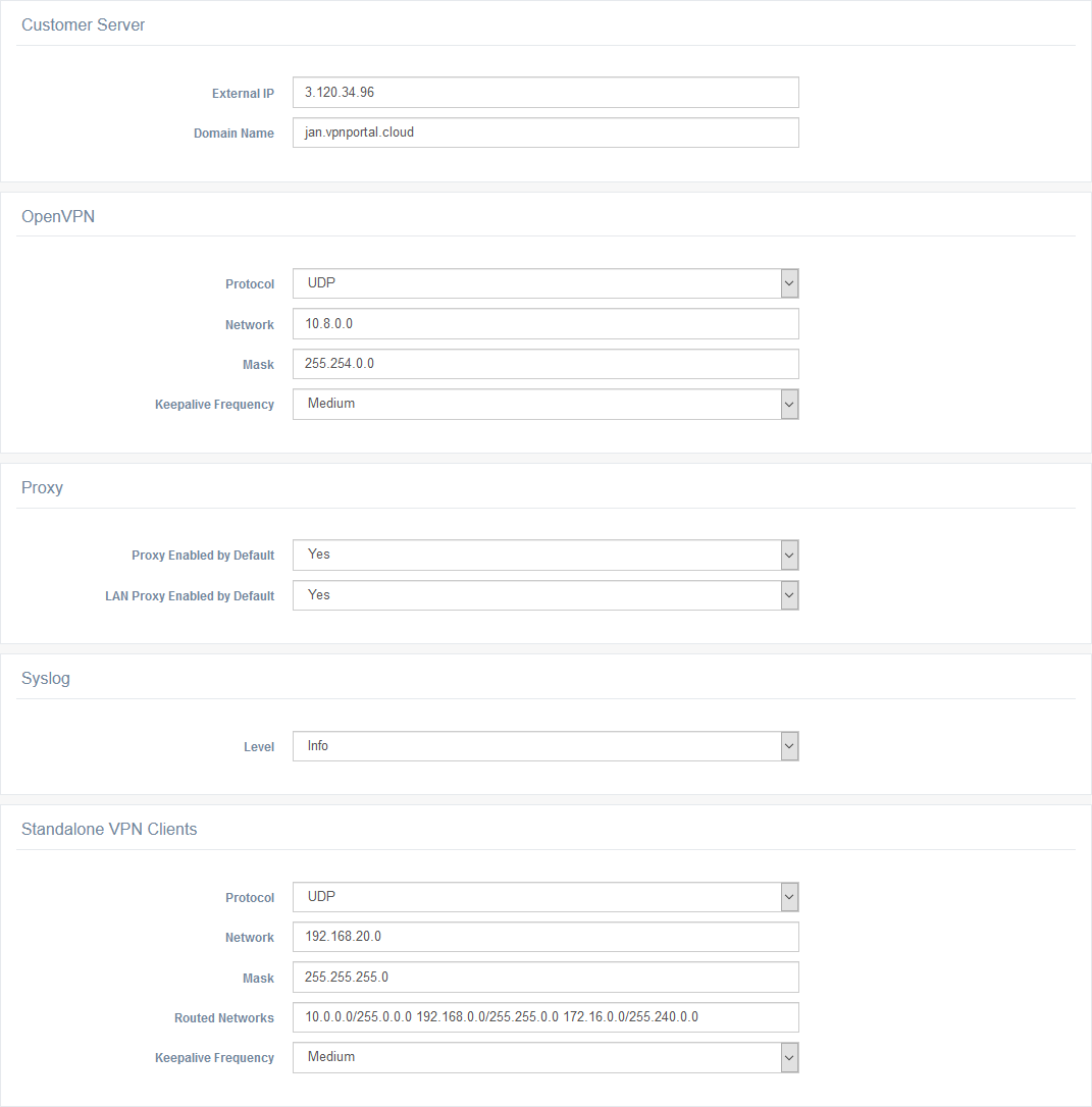

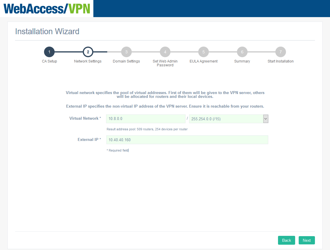

Wizard Step 1 — Certificate Authority In Step 2, configure the virtual internal network for OpenVPN connections with routers. The recommended values are network
10.8.0.0with a mask prefix chosen from the available options. The mask determines the maximum number of devices that can connect to WebAccess/VPN; the calculated number of routers is shown below the field. The number of devices per router is always 254 and cannot be changed. The virtual network address and mask can be changed later in Settings, but only when no validated routers exist.The External IP is either the IP address of the Amazon instance (detected automatically and cannot be changed in an Amazon image installation) or the IP address of the VirtualBox appliance.

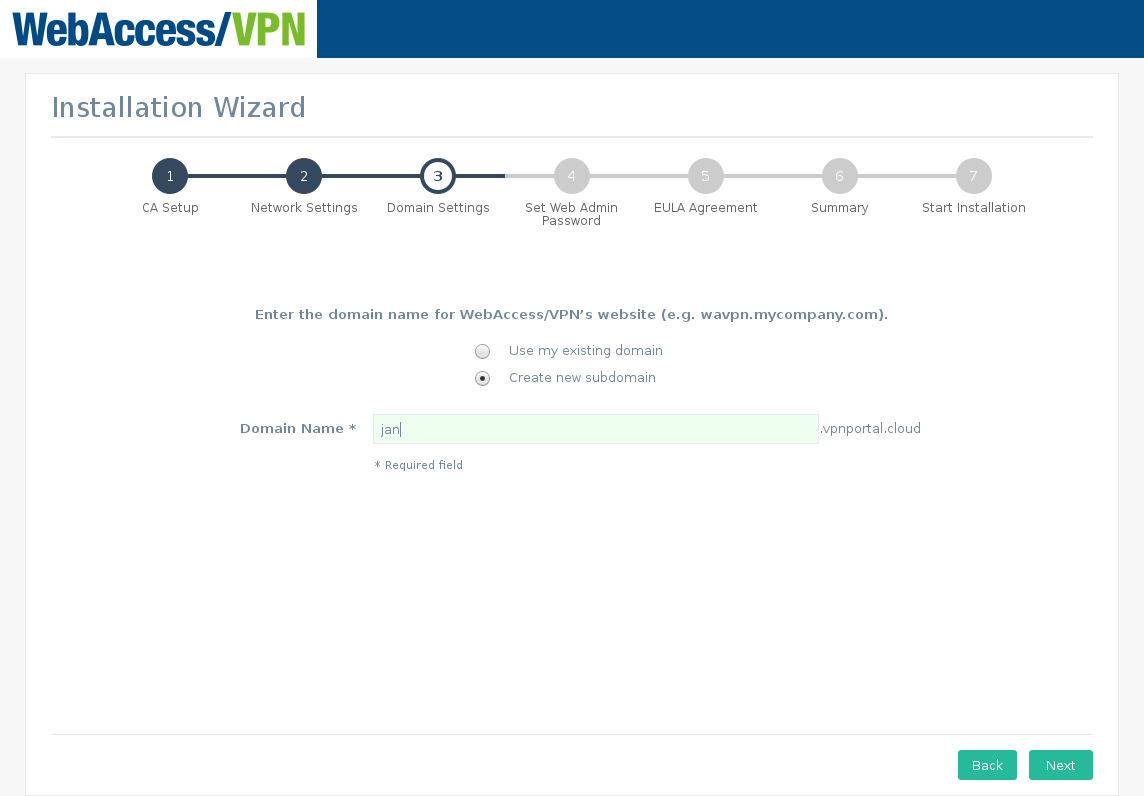

Wizard Step 2 — Virtual Network In Step 3, either enter your own domain name for WebAccess/VPN (recommended for on-premises installations) or create a new Advantech-managed subdomain (available for public IP only; subdomain of
vpnportal.cloud).
Wizard Step 3 — Domain Name Warning: On AWS, do not use the instance's AWS DNS domain name (for example,
ec2-35-156-197-5.eu-central-1.compute.amazonaws.com). Note that the AWS instance may change its public IP when stopped and restarted — either avoid stopping the instance or purchase a fixed public IP from Amazon.Using your own domain name: When directing your domain's DNS records to the installation IP, add an additional "A" record:
*.mydomain.com(or*.sub.mydomain.comfor a subdomain installation). This wildcard record is required for some WebAccess/VPN features.Using a domain name from Advantech: Suitable for AWS. For on-premises use, the VirtualBox appliance must have a public IP. Choose an unused subdomain on
vpnportal.cloud— the field turns red if the name is already taken. Advantech will set and manage the DNS records.In Step 4, set the password and enter your EC2 instance ID for admin web user access.

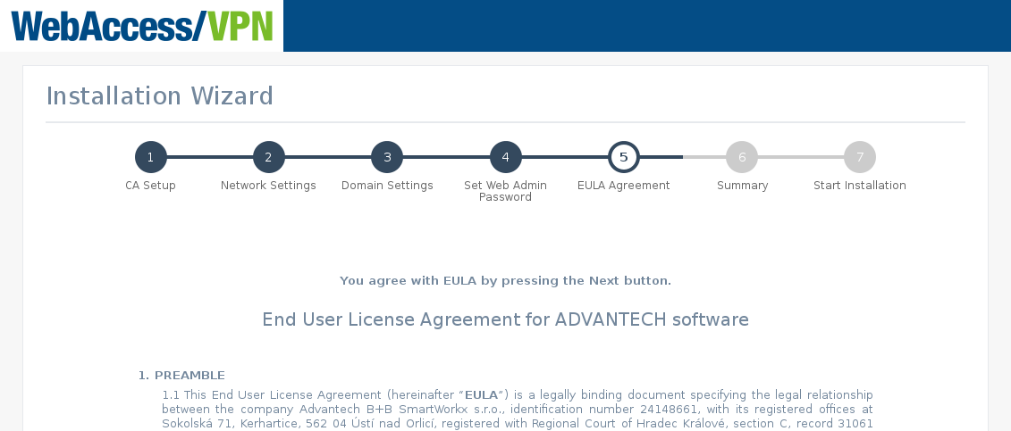

Wizard Step 4 — Admin Password In Step 5, read and agree to the EULA.
Wizard Step 5 — EULA In Step 6, review the installation parameters.
Caution
The installation wizard can be run only once and will be deactivated after the installation completes.

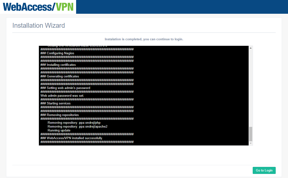

Wizard Step 6 — Review Parameters Click Start installation. A progress bar shows the installation status. After the installation, the message "Installation is completed, you can continue to login" appears and the Go to Login button becomes active.
Wizard Step 7 — Installation Progress Click Go to Login, or navigate to
https://IP-OR-DOMAIN-OF-INSTANCE-OR-APPLIANCEand log in with usernameadminand the password you set in the wizard. The installation wizard is now deactivated.

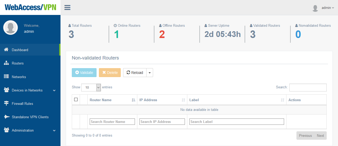

WebAccess/VPN Login
The default license is active after installation. You can download router apps for the next step from WebAccess/VPN — see the Application section under Administration.

Connect the Router to WebAccess/VPN

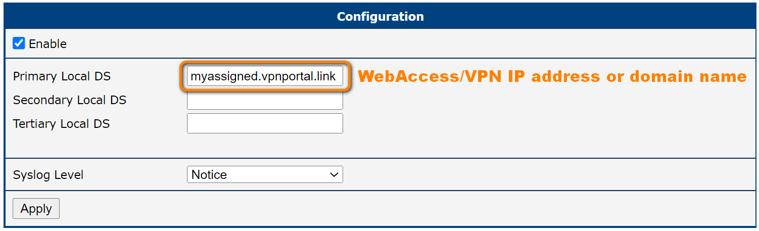

Ensure that WAN is configured in the router so that the Dispatch Server (Internet) is reachable through the WAN interface. Set the IP address or URL of the Dispatch Server on the VPN Connection configuration page. Verify that the Enable checkbox is checked, then click Apply.
Caution
In most cases, the DS is installed on the same server as the CS (for example, in customer-managed cloud installations). Enter your WebAccess/VPN IP address or domain name in the Primary Local DS field. The Secondary and Tertiary DS fields are optional.
Three Dispatch Servers can be configured: Primary, Secondary, and Tertiary Local DS. The router tries to connect to the Primary first; if unsuccessful, it tries the Secondary, then the Tertiary. This allows a backup Dispatch Server to be configured for maintenance scenarios. Both URLs and IP addresses can be used in the DS configuration fields.
Validate the Router on WebAccess/VPN
Log in to the WebAccess/VPN web UI and validate the router as shown in the figure below.

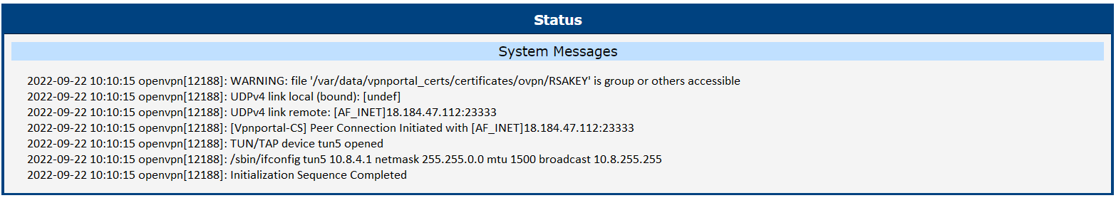

Router App Status and Log Messages
After the router is validated in WebAccess/VPN, the Ready for incoming messages notice appears on the VPN Portal status page in the router.

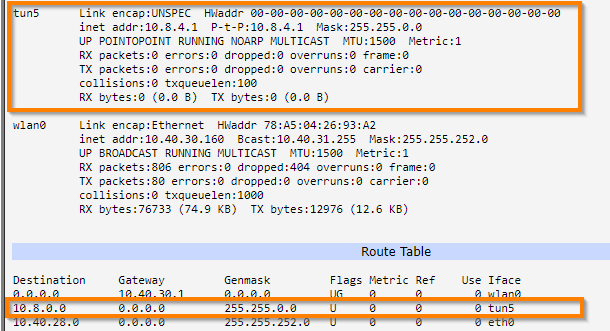

On the OpenVPN Tunnel page, Initialization Sequence Completed appears if the tunnel was established successfully.
In the router's main web interface, a new tunnel network interface is created and the Route Table is updated accordingly.
You can now use the WebAccess/VPN web UI to create networks, configure router LANs, and add them to networks so they can see each other.

Dashboard
After login, the Dashboard is the landing page.
The top of the Dashboard shows an overview and basic statistics: total Total Routers, Online Routers, Offline Routers, Server Uptime, Validated Routers, and Non-validated Routers.
Below the overview is the list of non-validated routers. You can validate or delete individual routers, or perform bulk actions using the checkboxes and buttons at the top of the list. The Dashboard is the only place to manually validate routers in WebAccess/VPN. An automatic option — pre-validation — is also available; see the Pre-validation section.

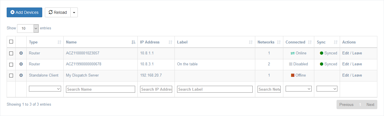

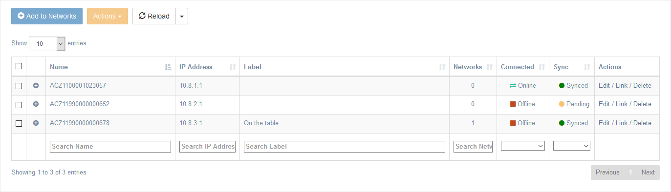

Routers
The Routers section shows a table of all validated routers. Buttons at the top allow bulk operations: add to networks (Add to Networks), enable/disable VPN access, and delete routers (via the Actions dropdown). You can reload the page or enable auto-refresh (every 5, 10, or 30 seconds) using the Reload dropdown. Router properties are explained in the table below.
| Router Property | Description |
| Name | Automatically obtained name of the router. Based on Serial Number in most cases (if SN is unavailable, based on MAC address or a random number). Can be changed on the General tab via Edit. |
| IP Address | The IP address of the router's end of the OpenVPN tunnel. |
| Label | An editable label for the device. Can be changed on the General tab via Edit. |
| Networks | The number of networks the device belongs to. |
| Connected | Online (green arrows) — connected to WebAccess/VPN. Offline (red square) — not connected to WebAccess/VPN. Disabled (grey square) — not allowed to connect to WebAccess/VPN. Editable via the Actions dropdown or on the General tab in Router Edit. |
| Sync | Synced (green) — all requested settings have been applied; no pending operations. Pending (yellow) — some changes have not yet been propagated to the router. Failed (red) — some settings caused an error on the router. Check the Router App log for details. |
| Actions | Edit — Access the router's main page with more information and available actions. Link — Redirect to the router's login page (via WebAccess/VPN proxy). Delete — Permanently remove the router. |
Routers properties
A quick overview of a router's details can be accessed by clicking the plus icon next to the Name. The overview appears as a panel on the right, showing Device Detail, LANs details, Device Networks, and Device Statistics. This is a read-only shortcut to the same information available via the Edit link.

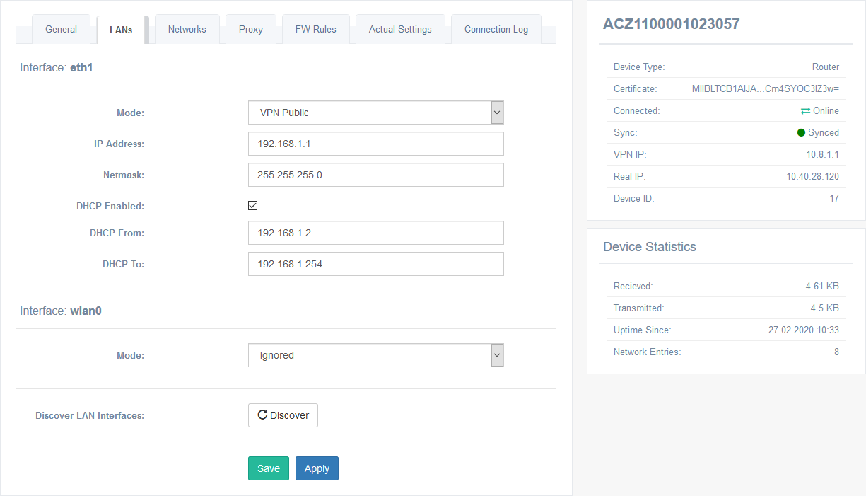

The Edit page provides controls for a router's general settings, LANs, network membership, proxy settings, and firewall rules, as well as views for actual settings and connection log.

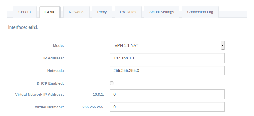

LANs Tab
| Interface Mode | Description |
| Ignored | The Customer Server does not manage the router's LAN. |
| Local Only | The administrator can configure the LAN, but it is invisible to all other devices in WebAccess/VPN. IP address, netmask, and DHCP can be configured. |
| VPN Public | The administrator can configure the LAN, which is visible to all routers (and devices behind them) that share at least one network with this router. IP address, netmask, and DHCP can be configured. |
| VPN 1:1 NAT | LAN addresses are translated to the virtual address space. Devices within the LAN are accessible via virtual addresses to all devices that share at least one network with this router. |
Devices — LANs Interface Modes
Interfaces: Each LAN interface can be configured, including wlan0 and eth2 if present. Both Save and Apply propagate changes to the router; Save also returns you to the device table.
Discover: Rescans the router's interfaces — useful after an interface change on the router (for example, when Backup Routes configuration has changed) without needing to delete and re-validate the router. Discover can only be requested when the router is online.

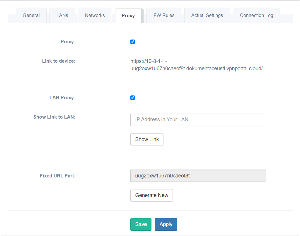

Proxy Tab
Proxy: Enable or disable the proxy Link to the router (access via VPN tunnel). If enabled, the link is shown below the checkbox. The default state is determined by Proxy settings in Administration → Settings.
LAN Proxy: Enable or disable proxy access for devices in LANs behind the router (access via VPN tunnel). If enabled, an address creator appears — fill in the device's local IP address and click Show Link to generate a link. LAN Proxy works with both HTTP and HTTPS URLs.
Fixed URL Part: Visible only when at least one proxy is enabled. Click Generate New to regenerate all proxy links for the router. This can serve as a security reset — existing shared links stop working after regeneration.
FW Rules Tab
Custom filtering rules can be created on the FW Rules tab. Use the green Add rule button to create a rule. For details on rule options and syntax, see the Firewall Rules for Router section below.

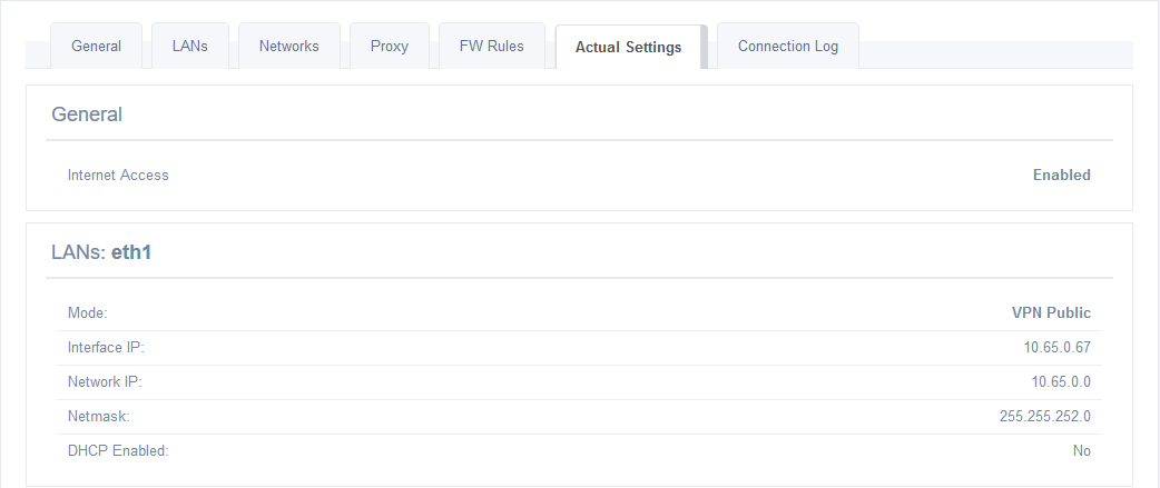

Actual Settings Tab
Tips
Displays settings that are currently applied on the router. This information may be inaccurate for LANs in Ignored mode, since they may have been changed manually on the router.

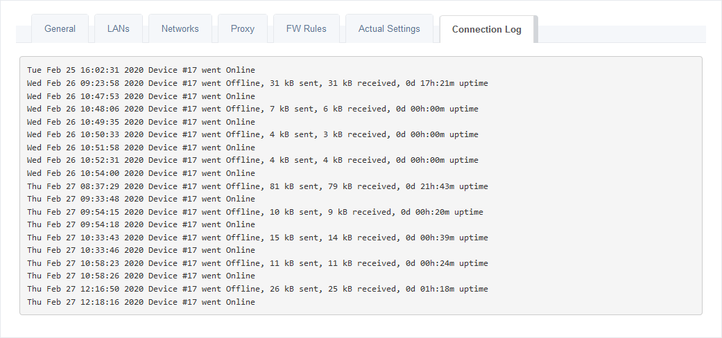

Connection Log Tab
Displays connection logs for this router. This is a filtered view of the overall Connection Log accessible in Administration → Logs.

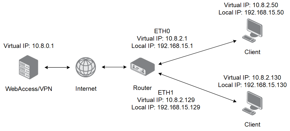

1:1 NAT
WebAccess/VPN supports 1:1 NAT. Devices in the router's LAN become visible in WebAccess/VPN under assigned virtual IP addresses. To configure 1:1 NAT on an interface, select the VPN 1:1 NAT interface mode and configure:
- Local Network — the address pool under which the device is known locally (IP address, netmask).
- Virtual Network — the address pool under which the device will be known (accessible) in WebAccess/VPN (Virtual IP, Virtual Netmask).
In VPN 1:1 NAT mode, the Customer Server reserves a pool of 254 virtual IP addresses per router. This amount cannot be changed in the current version.
For example, if two routers are connected:
- Virtual IP of the first router is
10.8.1.1; the virtual IP pool for its LAN devices is10.8.1.2–10.8.1.254. - Virtual IP of the second router is
10.8.2.1; the virtual IP pool for its LAN devices is10.8.2.2–10.8.2.254.
1:1 NAT Example 1
- Router has LAN
192.168.15.0/24oneth0. - Virtual IP of the router is
10.8.2.1. - 1:1 NAT configuration on
eth0:- (Local) IP Address:
192.168.15.1 - (Local) Netmask:
255.255.255.0 - Virtual Network IP Address:
10.8.2.0 - Virtual Netmask:
255.255.255.0
The router translates the local network to the virtual network: a device with local IP 192.168.15.10 is visible under virtual IP 10.8.2.10.
1:1 NAT Example 2
More than one 1:1 NAT can be configured for one device. All such LANs must be subnetted to fit within the virtual address range reserved for the router.
- Router has LAN
192.168.15.0/25oneth0and192.168.15.128/25oneth1. - Virtual IP of the router is
10.8.2.1. - 1:1 NAT on
eth0: Local192.168.15.1/255.255.255.128, Virtual10.8.2.0/255.255.255.128. - 1:1 NAT on
eth1: Local192.168.15.129/255.255.255.128, Virtual10.8.2.128/255.255.255.128.
A ping to 10.8.2.50 reaches device 192.168.15.50 (behind eth0). A ping to 10.8.2.130 reaches device 192.168.15.130 (behind eth1).
1:1 NAT Example 3
Networks can also be divided so that local networks differ per physical interface while the virtual network spans the same address range.
- Router has LAN
192.168.5.0/24oneth0and192.168.10.0/24oneth1. - 1:1 NAT on
eth0: Local192.168.5.1/255.255.255.0, Virtual10.8.3.0/255.255.255.128. - 1:1 NAT on
eth1: Local192.168.10.1/255.255.255.0, Virtual10.8.3.128/255.255.255.128.
Translations: 10.8.3.2 → 192.168.5.2, 10.8.3.3 → 192.168.5.3, 10.8.3.129 → 192.168.10.1, 10.8.3.130 → 192.168.10.2, etc.
Caution
The Router/Standalone VPN Client firewall is part of WebAccess/VPN. These rules are not propagated to the routers themselves and apply only to traffic through WebAccess/VPN.
- Firewall rules are divided by traffic direction:
- Incoming — applied to packets destined for the router or one of its LANs.
- Outgoing — applied to packets originating from the router or one of its LANs.
- Each direction has its own default policy: Allow or Deny.
- When the default policy changes, rules associated with the old policy are deactivated and rules for the new policy are activated.
- Filters are not applied to already established connections. For example, adding a rule denying ICMP while a ping is running does not stop the running ping — only new connections are affected.
Tips
Example: Default Incoming policy is Allow. Deny incoming traffic from IPs 10.40.20.1, 10.40.20.2, 10.40.20.3 to destination network 192.168.1.0/24 on TCP ports 50000–60000:
| Field | Options and Syntax |
| Protocol | TCP, UDP, or ICMP. |
| Source IPs, Destination IPs | A standalone IP address, a comma-separated list of IPs, CIDR notation (e.g., 192.168.1.0/24), or a range (e.g., 192.168.1.1-192.168.1.50). |
| Ports | A standalone port, a comma-separated list of ports, or a range using a colon (e.g., 120:130). |

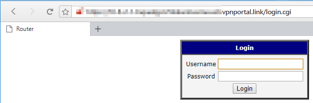

Routers: Link
Clicking Link in the Actions column opens a new browser tab with direct login to the router via HTTPS, using WebAccess/VPN as a proxy.
Tips
The following preconditions must be met for the Link to work correctly:
- DNS records for the WebAccess/VPN domain name must be configured.
- The HTTPS service must be enabled in the router (Configuration → Services → HTTP).
- Proxy must be enabled for the router (Router Edit → Proxy tab).

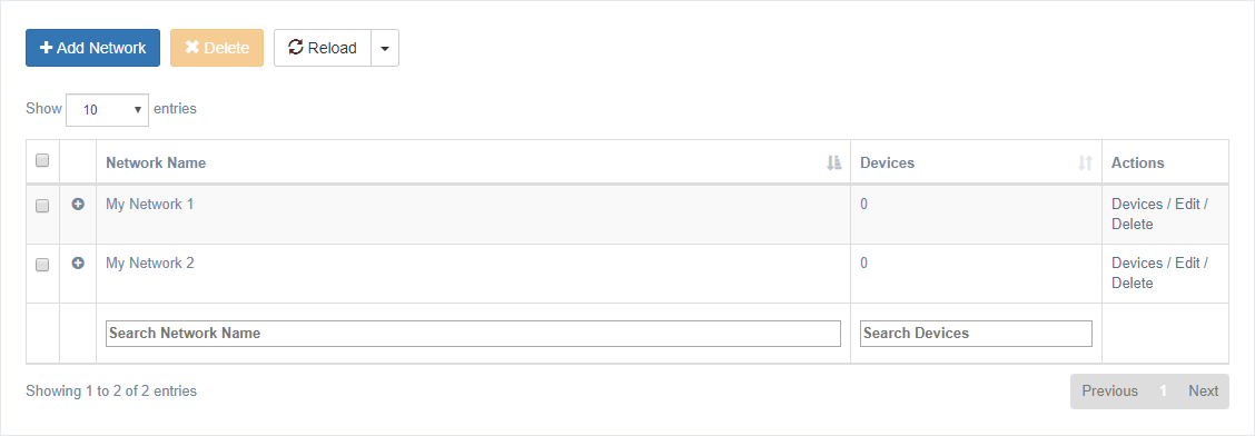

Networks
Tips
Routers and Standalone VPN Clients added to WebAccess/VPN can see each other only after they are added to the same Network. Networks can be created or deleted on the Networks page.
Use the blue Add Network button to create a new network. After creation, firewall rules can be added via Edit. The Delete button enables bulk deletion. The Reload button works the same way as on the Routers page. Click the plus icon next to a network name to see an overview.
The Devices column shows the number of devices in the network. The following Actions are available:
- Detail — shows the network's main page, where you can add or remove devices. This is the same page as Devices in Networks for the selected network.
- Edit — displays a page for setting up firewall rules or changing the network name.
- Delete — removes the network after a confirmation dialogue.

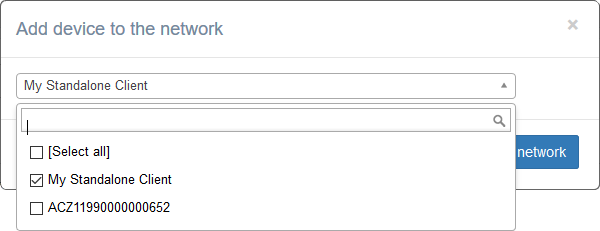

Add or remove Routers and Standalone VPN Clients from Networks on the Devices in Networks page. Select the network to edit from the dropdown menu on the left.
To add a device to a network, click the blue Add Devices button. A pop-up appears where you can select devices (from both Standalone VPN Clients and Routers) and confirm by clicking Add to network.

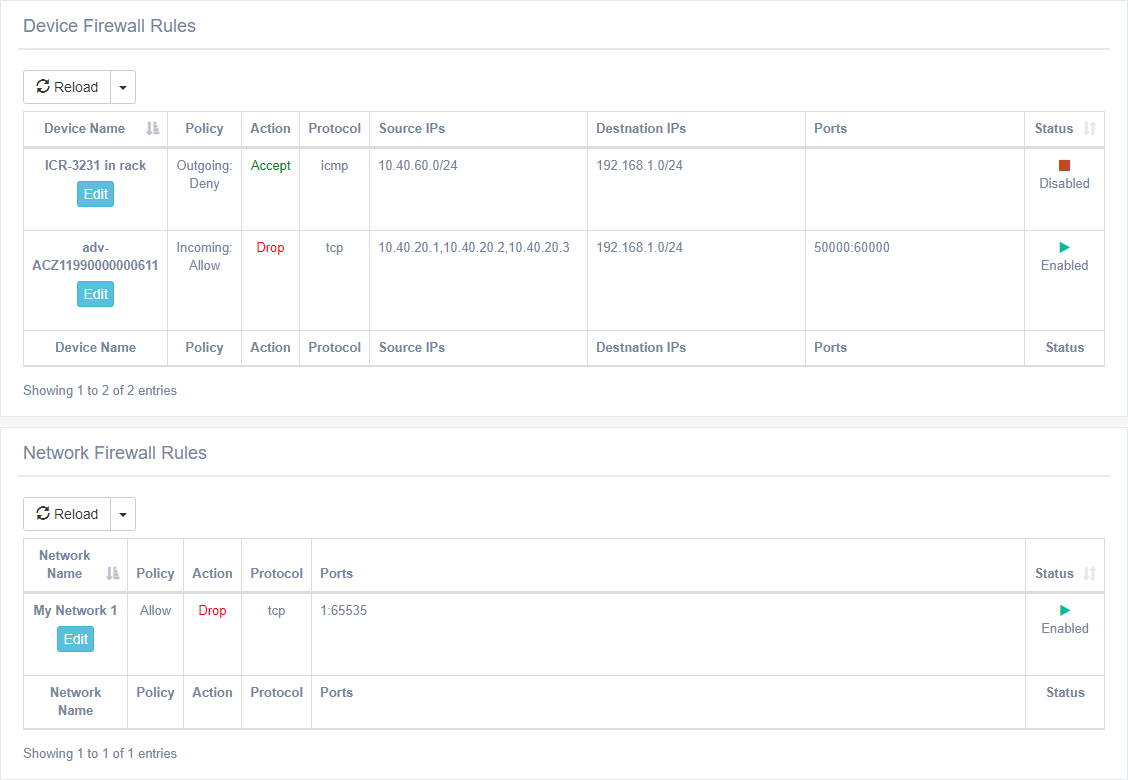

Firewall Rules
The Firewall Rules page provides an overview of all firewall rules created for devices (both Routers and Standalone VPN Clients) and networks, including their enabled/disabled status. There are two separate types: Device Firewall and Network Firewall.
Tips
Device Firewall and Network Firewall rules may both be applied to the same packet. When two devices share more than one network and communicate, firewall rules from multiple networks may apply.
All rule details are visible in the table columns. Use the blue Edit button to navigate directly to the Device/Network Edit page where a rule can be modified.
Caution
If a created rule does not appear in the overview, check whether the default policy conflicts with the rule. Rules that cannot be activated due to the current policy are not shown on this page.

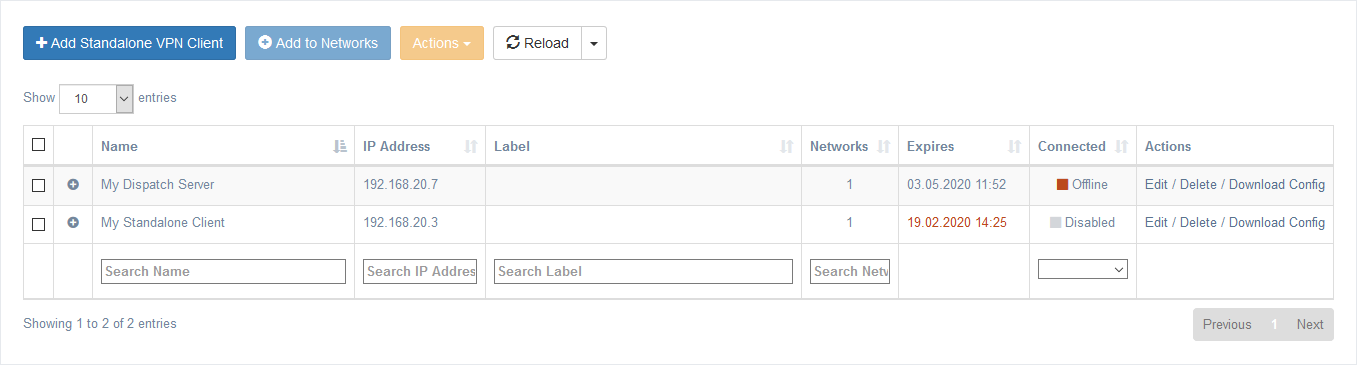

The Standalone VPN Clients service is based on OpenVPN. Clients connected as Standalone VPN Clients can be added to Networks in the same way as Routers.
Caution
A newly added Standalone VPN Client does not automatically see any other routers or Standalone VPN Clients. It must be added to a Network to communicate with other devices in that Network (with network firewall rules applied). Firewall rules can be set for Standalone VPN Clients in the same way as for Routers.
Prerequisites for using a Standalone VPN Client:
- The VPN Client Service on the Customer Server must be running (Online) — see the Application section.
- A new Standalone VPN Client must be created via the WebAccess/VPN web UI.
- The OpenVPN configuration file for this client can be downloaded via a link in the web UI and then used to initiate an OpenVPN connection.
Select Standalone VPN Clients in the menu to manage clients. Expired clients are shown with a red-colored date. You can add new clients, delete them, edit properties, or download the OpenVPN configuration file.
To create a Standalone VPN Client: Click the blue Add Standalone VPN Client button. Fill in the required information and optionally set an expiration period in days. The provided information (except the Name) cannot be changed later — it is used to create the certificate, private key, and configuration file.
To connect as a Standalone VPN Client: Download the client configuration file (a standard .ovpn file containing all keys and certificates) via the Download Config File link in the Actions column.
To delete a Standalone VPN Client: Click Delete in the table or in the client's General tab. Bulk deletion is available via checkboxes and the Actions dropdown. A confirmation dialogue appears. After deletion, the certificate is revoked and the client can no longer connect. To temporarily disable access without deleting, use the VPN Access toggle.

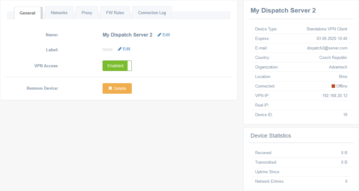

Standalone VPN Clients: Edit
Editing a Standalone VPN Client is similar to editing a Router, except that the expiration date and other non-configurable properties cannot be changed.
General Tab
The General tab is the same as for Routers (except for Internet Access enable/disable). The right side reflects the device type and shows the expiration date and other properties.

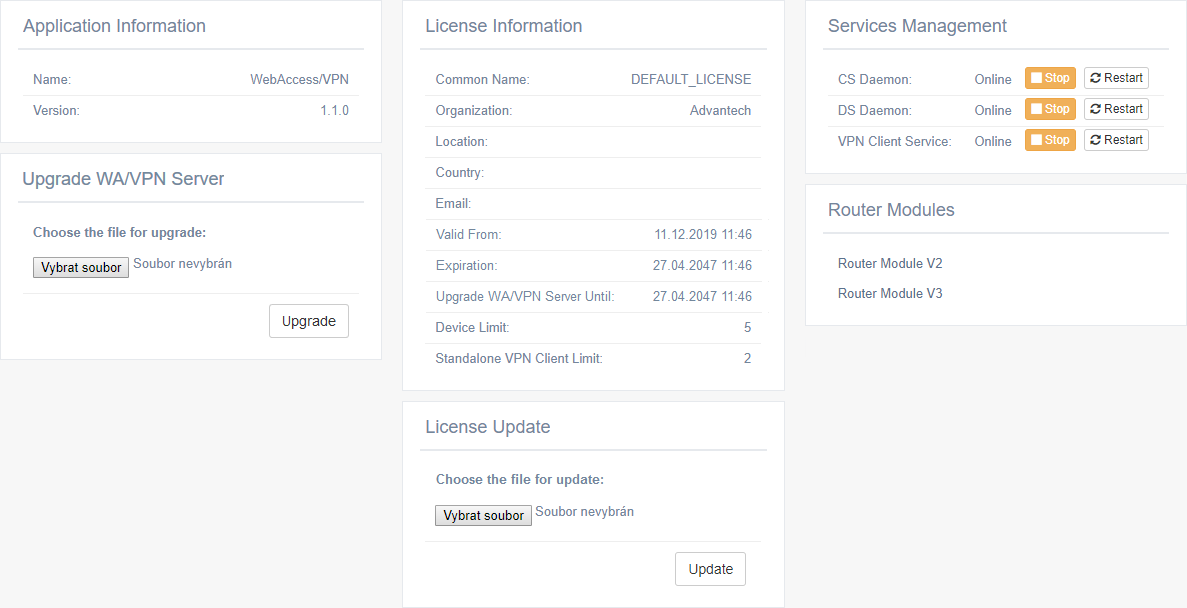

The Administration → Application page shows application information and provides management actions.
Upgrade WebAccess/VPN Server
Application information, including the version, is shown in the first section. You can upgrade the WebAccess/VPN server by selecting the proper tarball file and clicking Upgrade.
Caution
- Allow WebAccess/VPN a few minutes to complete the upgrade. Do not refresh the browser during the upgrade — there is currently no progress bar showing upgrade state.
- The free demo version from Amazon Marketplace cannot be upgraded or licensed to the production version. Upgrade availability may also be affected by the license (see Upgrade WA/VPN Server Until in the License Information box).
Update License
License information is shown in the middle section, displaying the limits and expiration of the current license. To update, select the .license file and click Update.

The top-right section allows managing the software services (components) of WebAccess/VPN. You can stop, start, or restart individual services:
- CS Daemon — the WebAccess/VPN UI itself.
- DS Daemon — tells routers where to connect, as described in the Introduction.
- VPN Client Service — handles Standalone VPN Clients.
Services management is useful for troubleshooting.

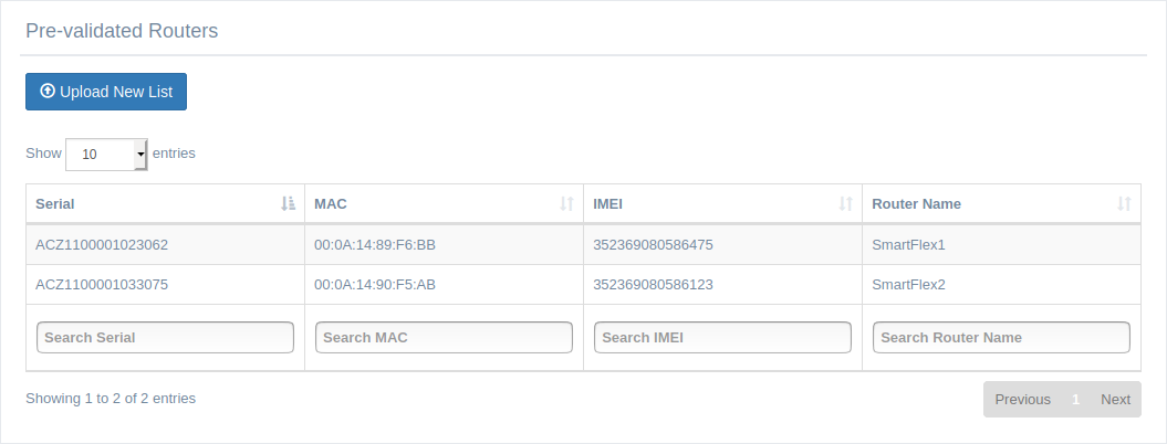

Pre-validation
A list of routers can be uploaded on the Administration → Pre-validation page. These routers are validated automatically when they attempt to connect to WebAccess/VPN. Once auto-validated, a router is removed from the pre-validation list and appears on the Routers page. Click Upload New List to upload the list.
Caution
Uploading a new list always overwrites the previous pre-validation list.
The list file must be a TXT file with the following format. The number of commas on each line must be consistent. A # character can be used for comments.
# SERIAL, MAC, IMEI, NAME
ACZ1100001023062, 00:0A:14:89:F6:BB, 352369080586475, SmartFlex
ACZ1100001033075, 00:0A:14:90:F5:AB, 352369080586123,Fields:
- Serial number (mandatory)
- MAC address (mandatory)
- IMEI of the cellular module (mandatory)
- Name (optional)
Settings
The Administration → Settings page contains configurable WebAccess/VPN parameters.
| Settings | Description |
| External IP | The IP address of the CS that is given to routers. Must be reachable from routers. Useful when moving WebAccess/VPN to a different IP. |
| Domain Name | The domain name of the CS. Useful when moving WebAccess/VPN to a different domain name. |
| Syslog | |
| Level | Verbosity level of the Syslog. |
| Proxy | |
| Proxy Enabled by Default | The default state of Proxy for newly added devices. Can be changed per device in Device Edit. |
| LAN Proxy Enabled by Default | The default state of LAN Proxy for newly added routers. Can be changed per router in Router Edit. |
| OpenVPN | |
| Protocol | The OpenVPN tunnel with routers is established via UDP (default) or TCP. Use TCP if your firewall blocks UDP. When running on Amazon, update your Security Group firewall rules accordingly. |
| Network Mask | The pool of virtual addresses for routers (and possibly devices behind them). Must be large enough for all your routers (255 addresses are reserved per router). Can only be changed when no validated routers exist. |
| Keepalive Frequency | The interval between pings used to check each device's connection state. A device is marked Offline after 2 consecutive failed ping checks (with no other traffic through the tunnel). Lower frequency reduces data consumption but increases delays in updating connection state. • Very low: once every 300 s • Low: once every 117 s • Medium: once every 40 s (default) • High: once every 15 s |
| Standalone VPN Clients | |
| Protocol | The OpenVPN tunnel with Standalone VPN Clients is established via UDP (default) or TCP. When running on Amazon, update your Security Group firewall rules accordingly. |
| Network Mask | The pool of virtual addresses assigned to Standalone VPN Clients. Both OpenVPN networks (VPN clients and routers) are restarted automatically when this is changed. |
| Routed Networks | IP ranges routed to the tunnel. By default, all private IP ranges are listed. |
| Keepalive Frequency | Same as for OpenVPN. |

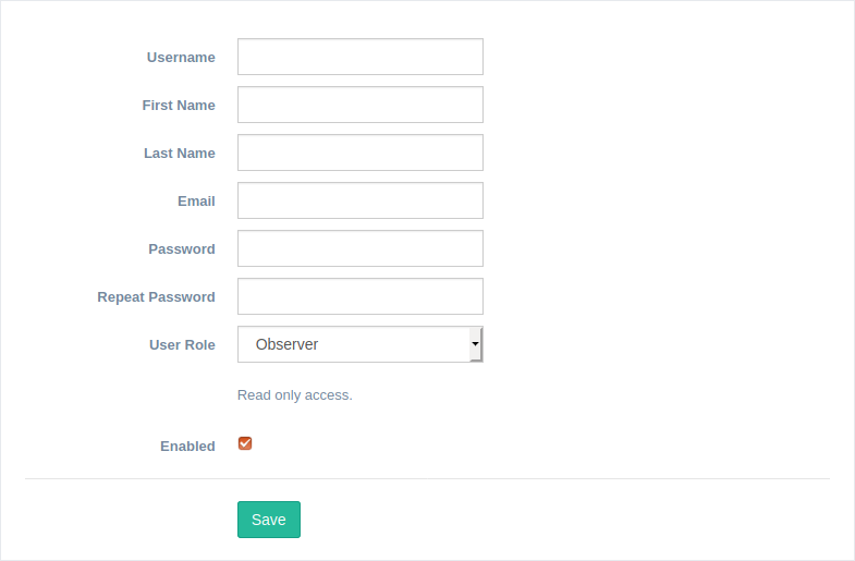

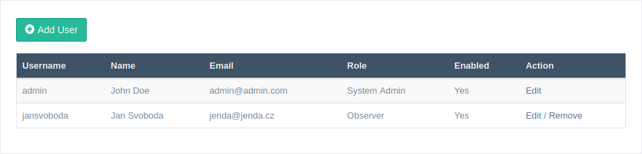

Users
The Administration → Users page shows a table of all configured users. You can add, edit, or remove user accounts.
Click Add User to add a new user. A dialogue appears (also used for editing) where you can enter identification information (Username, Name, Email, Password), specify the user role, and enable or disable the account. A disabled account does not allow login, but the information is retained and can be re-enabled by a System Admin.
Roles are hierarchical — each higher role includes all rights of the predecessor:
- Observer — read-only access (default role).
- Device Admin — device administration (can validate and edit devices — Routers and Standalone VPN Clients).
- Network Manager — network management (can add/remove devices from networks, add and edit firewall rules for networks).
- Network Admin — network administration (can create, edit, and delete networks).
- System Admin — full access: user management (add, edit, delete users), change settings, and administer the application.

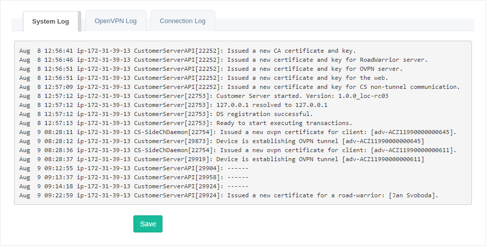

Logs
The Administration → Logs page provides access to system logs.
You can switch between the SystemLog, OpenVPN Log, and Connection Log views. The Connection Log consolidates connection information for all devices in one place. All logs can be downloaded as a single TXT file by clicking Save — the file contains sections for all three log types and can be shared with technical support.

How to Access Logs
Router Logs
On routers, log messages can be viewed on the Router App's VPN Portal web pages:
- OpenVPN Tunnel — shows the status of the OpenVPN tunnel.
- WebAccess/VPN — shows the status of the Router App.
WebAccess/VPN Logs
On the Administration → Logs page of the WebAccess/VPN UI, the System Log, OpenVPN Log, and Connection Log can be viewed. See the Logs section for details.
