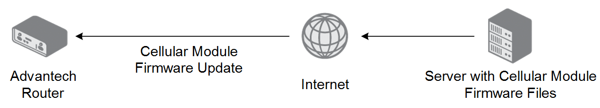

FOTA Operation
FOTA (Firmware Over-The-Air) is an additional feature for Advantech routers that enables automatic or manual firmware updates for their cellular modules. FOTA updates only the cellular module's firmware — not the router's main firmware.
For proper operation, the router must have either an active Internet connection to access the default Advantech FOTA server or a network connection to a custom-configured FOTA server.

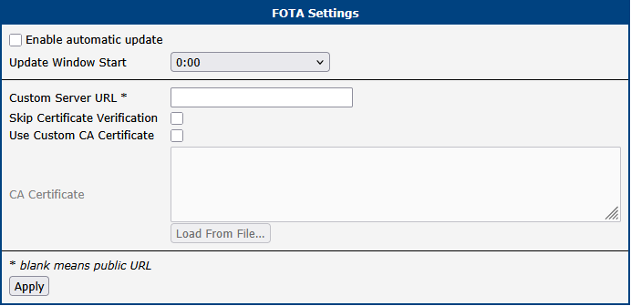

Automatic Updates
To configure automatic updates, navigate to Configuration → Settings. Select the Enable automatic update checkbox and click Apply. If you prefer to perform only manual checks and updates, refer to the Administration → Update section instead.
| Item | Description |
| Enable automatic update | Enables scheduled automatic updates using a preset connection to the Advantech FOTA server, which contains up-to-date firmware information. |
| Update Window Start | Specifies the hour when automatic updates start. You can also choose between daily and weekly update frequency. The update process may start a few minutes after the scheduled time. |
| Custom Server URL | Optional address of a custom copy of the Advantech FOTA server. Useful for isolated networks. See the Custom FOTA Server chapter for instructions on how to create the custom server. |
| Skip Certificate Verification | When enabled, the router skips the verification of the server's certificate. |
| Use Custom CA Certificate | Enable to use a custom CA certificate instead of the default Advantech CA certificate. |
| CA Certificate | Field for pasting or uploading your custom CA certificate. |
FOTA configuration items

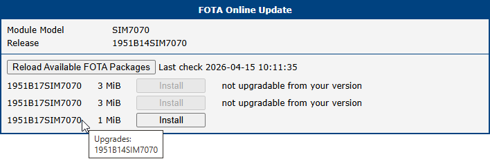

Update
The Update page displays available FOTA packages, with the newest version shown first. Click the Load Available FOTA Packages button to load the list from the FOTA server. After the first load, the button is renamed Reload Available FOTA Packages and the time of the last check appears next to it. Use the button to manually refresh the list.
Depending on the cellular module, the FOTA system may use a delta upgrade mechanism. In this case, instead of a single universal update package, multiple installation files may be listed, all targeting the same final firmware version.
The figure below shows an example of a module using the delta upgrade mechanism. The module model is SIM7070, with the currently installed firmware version 1951B14SIM7070. Three packages are listed, all targeting version 1951B17SIM7070. Each package is designed for a specific source firmware version. As a result, you can use only the package that matches the currently installed firmware. In this example, only the package for upgrading from 1951B14SIM7070 to 1951B17SIM7070 has the Install button enabled.
Tips
The Upgrades field, displayed as a tooltip for each entry, indicates the source firmware version the update package applies to — not the version that will be installed.
The following messages may appear in the last column of the firmware list. Each message is followed by the recommended action:
- not upgradable from your version → choose the highest upgradable version
- requires ICR-OS x.y.z → update the router's firmware first
- requires FOTA x.y.z → update the FOTA Router App first
Tips
When you hover over a firmware entry, a pop-up window shows the compatible firmware versions available for an upgrade. When you hover over the firmware size, the pop-up window shows the actual filename of the firmware.
