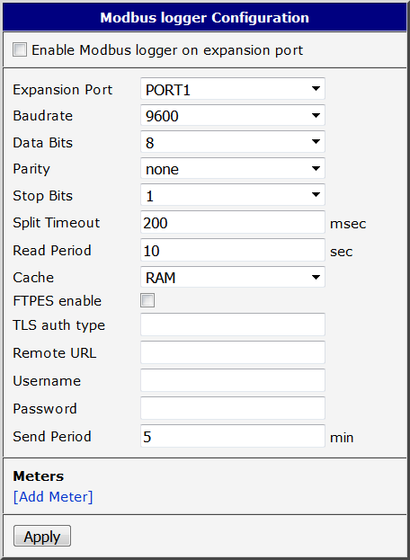

Configuration
Configure the Router App on the Global page under the Configuration menu section. The form contains three main parts: serial line parameters, FTP(S) server connection settings, and meter definitions. Meter configuration is described in detail in the section below.

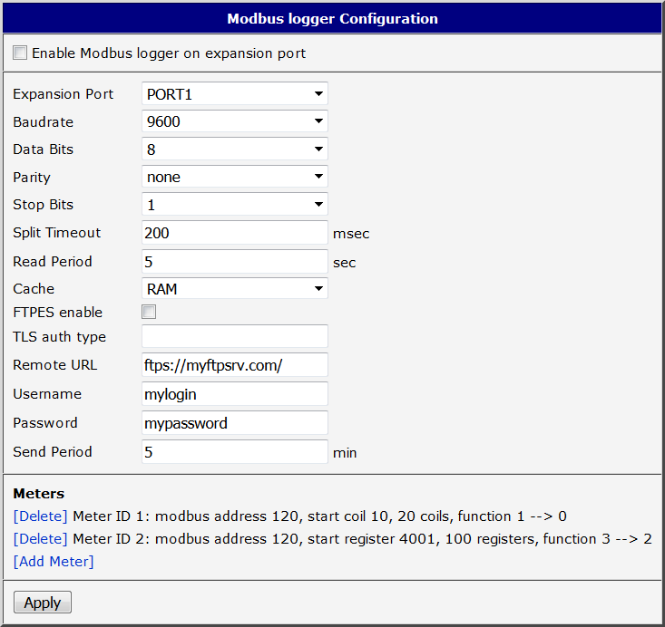

Configuration Example
In the example below, data is captured from a Modbus RTU device connected to the first serial interface every 5 seconds. Data is read from a Modbus slave device with address 120, and two meters are defined. The first meter reads 10 coil values starting at coil 10. The second meter reads 100 registers starting at register 4001.

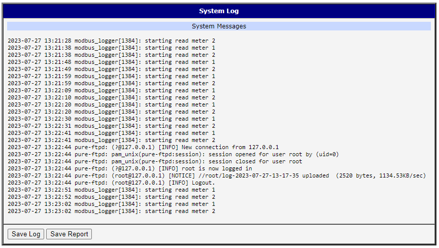

System Log
Log messages are available on the System Log page under the Status menu section. This log contains messages from this Router App as well as all other router system messages, and is identical to the system log available in the router's main Status → System Log page.
