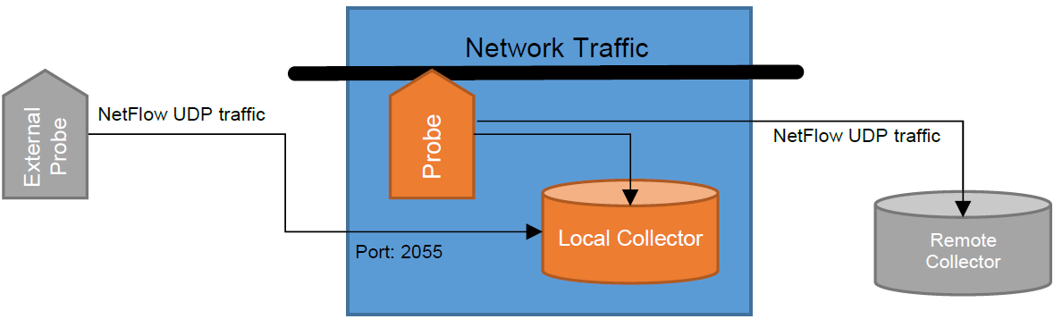

The NetFlow/IPFIX Router App monitors network traffic. Routers with NetFlow enabled run a probe that collects IP traffic information and submits it to a NetFlow collector and analyzer.
This Router App provides:
- A NetFlow probe that can send flow information to a compatible network collector or analyzer (e.g., PRTG).
- A NetFlow collector that stores collected flow data in files. It can also receive and store NetFlow traffic from other devices.

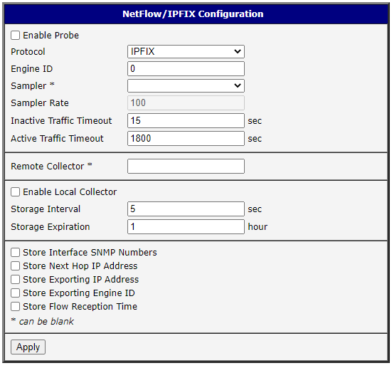

To configure all Router App settings, click the Global item in the main menu.
| Item | Description |
| Enable Probe | Starts submitting NetFlow information to a remote collector (when defined) or to the local collector (when enabled). |
| Protocol | Protocol to use: NetFlow v5, NetFlow v9, or IPFIX (NetFlow v10). |
| Engine ID | Sets the Observation Domain ID for IPFIX, Source ID for NetFlow v9, or Engine ID for NetFlow v5. Helps the collector distinguish between multiple exporters. See Engine ID Interoperability. |
| Sampler | (empty): submit every observed flow. deterministic: submit every Nth observed flow. random: randomly select one out of N flows. hash: select one out of N flows hash-randomly. |
| Sampler Rate | The value of N for the selected sampling method. |
| Inactive Traffic Timeout | Submits a flow after it has been inactive for the specified number of seconds. Default: 15 seconds. |
| Active Traffic Timeout | Submits a flow after it has been active for the specified number of seconds. Default: 1800 seconds (30 minutes). See Traffic Timeouts. |
| Remote Collector | IP address of a NetFlow collector or analyzer to which collected flow information is submitted. The port is optional (default: 2055). Specify a comma-separated list of IP addresses (and ports) to mirror NetFlow data to multiple collectors. |
| Enable Local Collector | Enables receiving NetFlow information from the local probe (when enabled) or from a remote probe. |
| Storage Interval | Time interval in seconds for rotating storage files. Default: 60 seconds. |
| Storage Expiration | Maximum lifetime, in hours, for files in the storage directory (0–8760). A value of 0 disables the lifetime limit. Default: 1 hour. |
| Store Interface SNMP Numbers | If checked, stores the SNMP index of the input/output interface (%in, %out). |
| Store Next Hop IP Address | If checked, stores the IP address of the next hop for outbound traffic (%nh). |
| Store Exporting IP Address | If checked, stores the IP address of the exporting router (%ra). |
| Store Exporting Engine ID | If checked, stores the Engine ID of the exporting router (%eng). |
| Store Flow Reception Time | If checked, stores the timestamp when the flow information was received (%tr). |
Configuration items

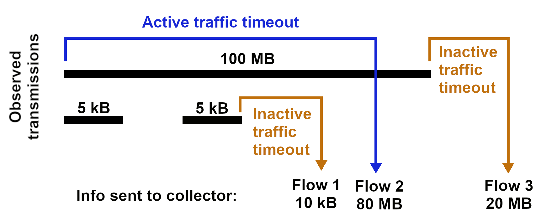

Traffic Timeouts
The probe exports whole flows — all packets that belong together. If no packets are observed for a given period (Inactive Traffic Timeout), the flow is considered complete and the probe sends the traffic information to the collector.
Information about a file transfer appears in the collector once the transfer is complete, which may take a long time. If a transmission remains active longer than the Active Traffic Timeout, it appears as multiple shorter flows. For example, with a 30-minute active traffic timeout, a 45-minute communication appears as two flows: one 30-minute and one 15-minute flow.
