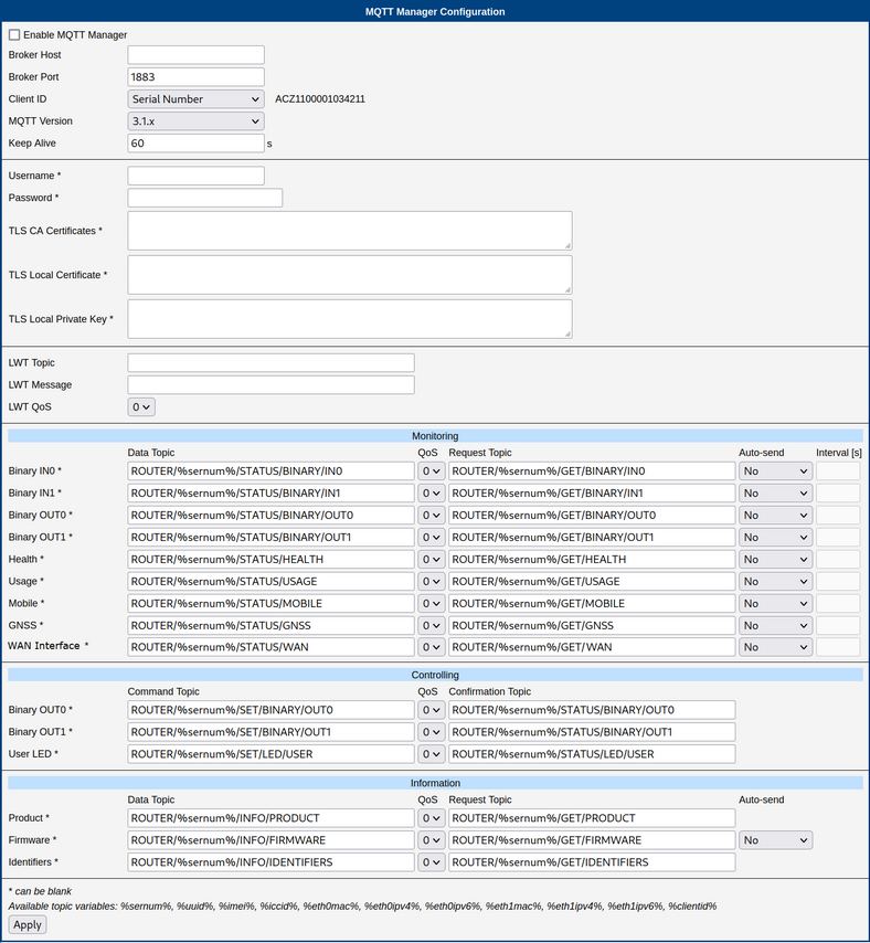

Global Configuration
Configure the Router App on the Settings page under the Router menu section. All configuration items are described in the table below.
| Item | Description |
| Enable MQTT Manager | When enabled, the MQTT Manager functionality of this Router App is turned on. |
| Broker Host | IP address or domain name of the MQTT broker. |
| Broker Port | Broker server port number (1–65535). |
| Client ID | String used as the client identifier to the broker. Choose from the router's unique IDs or enter a custom value. |
| MQTT Version | MQTT protocol version. |
| Keep Alive | MQTT Keep-Alive interval in seconds (1–3600). |
| Username | Username to connect to the broker, if required. |
| Password | Password to connect to the broker, if required. |
| TLS CA Certificates | CA certificate for TLS connection, if used. |
| TLS Local Certificate | Router's local certificate for TLS connection, if used. |
| TLS Local Private Key | Router's local private key for TLS connection, if used. |
| LWT Topic | Topic of the Last Will and Testament (LWT) message — sent by the broker to connected subscribers when a router disconnects or stops communicating. |
| LWT Message | Content of the LWT message. |
| LWT QoS | Quality of Service level for the LWT message. |
| Monitoring | See the Monitoring section below. |
| Controlling | See the Controlling section below. |
| Information | See the Information section below. |
Configuration items
