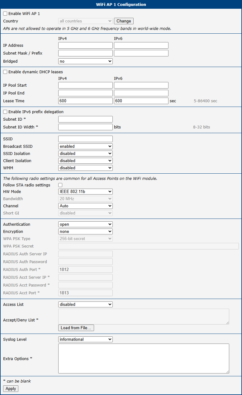

To include a Wi-Fi AP interface in the bridge, at least one Ethernet interface must also be part of the bridge configuration. In this case, the IP address of the bridge interface br0 will again be determined by the Ethernet interface (or interfaces) with the lowest index.

WiFi Access Point
Important Note on Upgrading to Firmware 6.6.0
When upgrading from a firmware version prior to 6.6.0, any separate Country settings for the Wi-Fi Access Point (AP) and Station (STA) modes will be consolidated into a single, unified Country setting. This change ensures regulatory compliance and simplifies configuration.
Info
- The router supports configuring two separate WLANs (multiple SSIDs) for access point 1 (AP1) and access point 2 (AP2). However, both access points must share the same radio settings (channel, mode, channel width, etc.).
- The router supports operating as both an access point (AP) and a station (STA) simultaneously. If both Wi-Fi STA and Wi-Fi AP are enabled at the same time, reliable operation is only assured when the Follow STA radio settings option is active, the target Wi-Fi network does not use DFS-regulated channels, and the STA connection remains stable.
- RADIUS (Remote Authentication Dial-In User Service) is supported as a networking protocol for centralized authentication, authorization, and accounting (AAA). The router acts only as a RADIUS client, communicating with an external RADIUS server.
To enable Wi-Fi access point mode, check the Enable Wi-Fi AP box at the top of the Configuration → WiFi → Access Point 1 or Access Point 2 configuration page. In this mode, the router operates as an access point, allowing other devices in station (STA) mode to connect.
| Item | Description |
| Enable WiFi AP | Enables the Wi-Fi access point (AP). Both Access Point 1 (AP1) and Access Point 2 (AP2) can be enabled and operated simultaneously. |
| Country | A single Wi-Fi country code applies to all AP and STA interfaces and is configured on a separate page (accessible via the Change button), refer to WiFi Country. After changing the country, you must review the HW Mode, Bandwidth, and Channel settings. |
| IP Address | A fixed IP address for the Wi-Fi interface. Use standard IPv4 or IPv6 notation. |
| Subnet Mask / Prefix | Specifies the subnet mask for an IPv4 address or the prefix length (0 to 128) for an IPv6 address. |
| Bridged | Activates bridge mode: • no: Bridged mode is disabled (default). The WLAN is a separate network from the LAN. • yes: Bridged mode is enabled. The WLAN is connected to one or more LAN networks. In this mode, most network settings in this table are ignored, and the router uses the settings of the bridged LAN interface. See the Bridge Notes in Ethernet for further details. |
| Enable dynamic DHCP leases | Enables the dynamic allocation of IP addresses using the DHCP (or DHCPv6) server. |
| IP Pool Start | The start of the IP address range assigned to DHCP clients. |
| IP Pool End | The end of the IP address range assigned to DHCP clients. |
| Lease Time | The duration (in seconds) for which a client can use its assigned IP address. |
| Enable IPv6 prefix delegation | Enables prefix delegation for IPv6 clients. |
| Subnet ID | The decimal value of the Subnet ID for the interface. The maximum value is determined by the Subnet ID Width. |
| Subnet ID Width | The maximum Subnet ID width, which depends on your site's configuration. The remaining bits (up to 64) are used for the prefix. |
| SSID | The unique identifier (name) of the Wi-Fi network. Access Point 1 (AP1) and Access Point 2 (AP2) can have different SSIDs. |
| Broadcast SSID | Defines how the SSID is broadcast in the beacon frame: • enabled: The SSID is included in the beacon frame (standard behavior). • zero length: The SSID is omitted from the beacon frame. Requests to send beacon frames are ignored. • clear: SSID characters in the beacon are replaced with zeros, maintaining the original length. Requests for beacon frames are ignored. |
| SSID Isolation | When enabled with a selected zone, clients on this access point cannot communicate with clients on other access points that have a different zone selected. |
| Client Isolation | If enabled, clients connected to this access point are prevented from communicating with each other. If disabled, the AP functions like a switch, allowing clients on the same LAN to communicate. |
| WMM | Enables basic QoS (Quality of Service) for the Wi-Fi network. Suitable for simple applications that require QoS but does not guarantee network throughput. |
| Follow STA radio settings | When enabled, if the STA mode is connected to an external access point, the router's own AP radio settings will automatically adjust to match those of the external AP. If both Wi-Fi STA and Wi-Fi AP are enabled simultaneously, reliable operation is only assured when this option is active, the target network avoids DFS-regulated channels, and the connection remains stable. |
| HW Mode¹ | Specifies the Wi-Fi standard supported by the access point. Available options include: IEEE 802.11b (2.4 GHz), IEEE 802.11b+g (2.4 GHz), IEEE 802.11b+g+n (2.4 GHz), IEEE 802.11a (5 GHz), IEEE 802.11a+n (5 GHz), IEEE 802.11ac (5 GHz). This setting is shared by both Access Point 1 and Access Point 2. |
| Bandwidth¹ | Selects the transfer bandwidth. This option may be unavailable for some hardware modes. If the selected bandwidth is occupied, the router may automatically switch to a lower bandwidth. This setting is shared by both Access Point 1 and Access Point 2. |
| Channel¹ | The channel on which the Wi-Fi access point operates. Available channels depend on the selected Country. Select Auto to allow the router to choose the optimal channel automatically. If you change the country, review this setting, as the previously selected channel may no longer be valid. This setting is shared by both Access Point 1 and Access Point 2. Note: When 40 MHz bandwidth is selected, in the 2.4 GHz band the channel number refers to the primary (20 MHz) channel; in the 5 GHz and 6 GHz bands, it refers to the center frequency of the 40 MHz channel. On NAM routers, only channels 1 to 11 are supported in the 2.4 GHz band. |
| Short GI | Available for 802.11n mode — enables a short guard interval (400 ns instead of 800 ns) to improve data transmission efficiency. This setting is shared by both Access Point 1 and Access Point 2. |
| Authentication | Defines the access control method for the Wi-Fi network: • open: [insecure] No authentication required. Encryption is not available.• shared: [insecure] Basic authentication with a WEP key.• WPA-PSK: [insecure] Pre-Shared Key authentication with WPA encryption.• WPA2-PSK: [insecure] Pre-Shared Key authentication with WPA2 encryption (AES).• WPA3-PSK: Simultaneous Authentication of Equals (SAE) with WPA3 encryption (AES). • WPA-Enterprise: [insecure] RADIUS-based authentication via an external server.• WPA2-Enterprise: RADIUS-based authentication with stronger encryption. • WPA3-Enterprise: RADIUS-based authentication with stronger encryption. |
| Encryption | Specifies the type of data encryption: • none: [insecure] No data encryption.• WEP: [insecure] Wired Equivalent Privacy.• TKIP: [insecure] Temporal Key Integrity Protocol, used for WPA.• AES: Advanced Encryption Standard, used for WPA2/WPA3. |
| WPA PSK Type | Specifies the format of the WPA Pre-Shared Key: • 256-bit secret: A 64-character hexadecimal key. • ASCII passphrase: A passphrase of 8 to 63 characters. • PSK File: Absolute path to a file containing key-MAC address pairs. |
| WPA PSK Secret | The secret key or passphrase for WPA-PSK authentication. |
| RADIUS Auth Server IP | The IPv4 or IPv6 address of the RADIUS authentication server. |
| RADIUS Auth Password | The access password for the RADIUS authentication server. |
| RADIUS Auth Port | The port number of the RADIUS authentication server (default is 1812). |
| RADIUS Acct Server IP | The IPv4 or IPv6 address of the RADIUS accounting server (if different from the authentication server). |
| RADIUS Acct Password | The access password for the RADIUS accounting server. |
| RADIUS Acct Port | The port number of the RADIUS accounting server (default is 1813). |
| Access List | Defines the mode of the client access list: • disabled: The access list is not used. • accept: Only clients in the list can access the network. • deny: Clients in the list are blocked from accessing the network. |
| Accept/Deny List | A list of client MAC addresses for network access control. Each MAC address should be entered on a new line. |
| Syslog Level | Defines the logging level for messages sent to the system log: • verbose debugging: The highest level of detail. • debugging • informational: The default level. • notification • warning: The lowest level. |
| Extra options | Allows the user to define additional parameters for hostapd. The options are appended to the configuration file. Use this feature only if you are familiar with its functionality. For more information, refer to the hostapd.conf configuration file. |
¹ The availability of configuration options may vary depending on the specific WiFi module and can be affected by the selected country code.

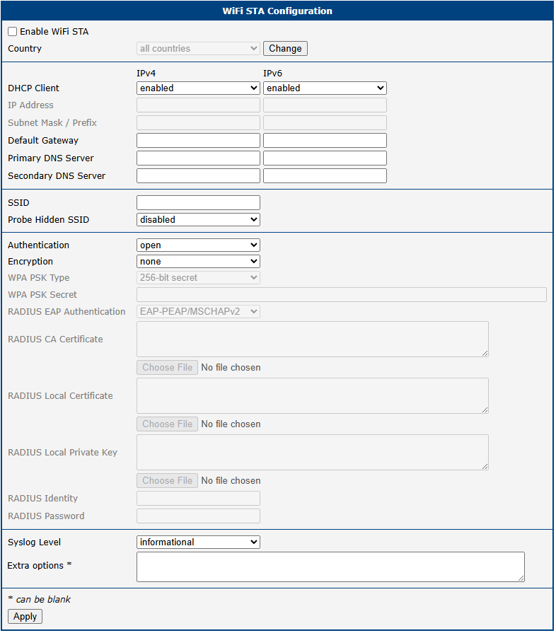

WiFi Station
Info
- You can find and connect to an available Wi-Fi network using Status → Wi-Fi → WiFi Scan.
- For networks using WPA-Enterprise security (RADIUS authentication), the station mode supports only the EAP-PEAP/MSCHAPv2 (both PEAPv0 and PEAPv1) and EAP-TLS authentication methods.
Activate Wi-Fi station mode by checking the Enable WiFi STA box at the top of the Configuration → WiFi → Station configuration page. In this mode, the router functions as a client station, connecting to an available access point (AP) and bridging its wired connection to the Wi-Fi network. In station mode, the Wi-Fi channel and bandwidth are determined by the associated access point.
| Enable WiFi STA | Enables the Wi-Fi station (STA) mode. |
| Country | A single Wi-Fi country code applies to all AP and STA interfaces and is configured on a separate page (accessible via the Change button), refer to WiFi Country. After changing the country, you must review your radio settings. |
| DHCP Client | Activates or deactivates the DHCP client (or DHCPv6 client for IPv6). |
| IP Address | Specifies a fixed IP address for the Wi-Fi interface. Use standard IPv4 or IPv6 notation. |
| Subnet Mask / Prefix | Defines the subnet mask for an IPv4 address or the prefix length (0 to 128) for an IPv6 address. |
| Default Gateway | Specifies the IP address of the default gateway. Packets with destinations not found in the routing table are sent to this gateway. |
| Primary DNS Server | Specifies the primary IP address of the DNS server. |
| Secondary DNS Server | Specifies the secondary IP address of the DNS server. |
| SSID | The unique identifier (name) of the Wi-Fi network to connect to. |
| Probe Hidden SSID | An access point with a hidden SSID does not broadcast its name, preventing the station from connecting automatically. Enable this option to force the station to probe for a specific hidden SSID. If you are not connecting to a hidden network, keep this disabled to reduce unnecessary radio transmissions. |
| Authentication | Access control methods for the Wi-Fi network: • open: [insecure] No authentication required.• shared: [insecure] Basic authentication with a WEP key.• WPA-PSK: [insecure] Authentication using a PSK with the WPA standard.• WPA2-PSK: [insecure] Authentication using a PSK with the WPA2 standard.• WPA3-PSK: Authentication using SAE with the WPA3 standard. • WPA-Enterprise: [insecure] Authentication using a RADIUS server with the WPA standard.• WPA2-Enterprise: Authentication using a RADIUS server with the WPA2 standard. • WPA3-Enterprise: Authentication using a RADIUS server with the WPA3 standard. |
| Encryption | The data encryption method: • none: [insecure] No encryption.• WEP: [insecure] Static encryption with WEP keys (may not be supported on some models).• TKIP: [insecure] Legacy dynamic encryption used with WPA/WPA2.• AES: Modern dynamic encryption used with WPA2/WPA3. |
| WPA PSK Type | The format of the key for WPA-PSK authentication: • 256-bit secret: A 64-character hexadecimal key. • ASCII passphrase: A passphrase of 8 to 63 characters. |
| RADIUS EAP Authentication | The EAP protocol used for RADIUS authentication: • EAP-PEAP/MSCHAPv2: Uses TLS to protect legacy EAP authentication. • EAP-TLS: Uses TLS for mutual authentication between the client and server. |
| RADIUS CA Certificate | The Certificate Authority (CA) certificate used to verify the server certificate during EAP-TLS authentication. |
| RADIUS Local Certificate | The client certificate required for EAP-TLS authentication. |
| RADIUS Local Private Key | The private key associated with the client certificate for EAP-TLS authentication. |
| RADIUS Identity | The identity (username) used to connect to the RADIUS server. |
| RADIUS Password | The password used to authenticate the RADIUS identity (for EAP-PEAP/MSCHAPv2). For EAP-TLS, this field is optional and specifies the decryption key for the local private key if it is encrypted. |
| Extra options | Allows the user to define additional parameters for wpa_supplicant. The options are appended to the configuration file. Use this feature only if you fully understand the implications. For more information, refer to the wpa_supplicant.conf configuration file. |

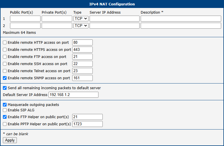

NAT
Network Address Translation (NAT) is a fundamental networking function that modifies IP address information in packet headers while they are in transit. The router implements NAPT (Network Address and Port Translation), also known as PAT (Port Address Translation) or IP masquerading, which allows multiple devices in a private network to share a single public IP address.
The NAT configuration is managed on the Configuration → NAT page, which has separate subpages for IPv4 and IPv6.
Port Forwarding
Port forwarding, also known as destination NAT (DNAT), allows external devices to connect to a specific service on a device within the private LAN. You can define up to sixty-four port forwarding rules.
| Public Port(s) | The external port or port range on the router's WAN interface. A single port or a range (e.g., 8000-8010) can be specified. |
| Private Port(s) | The internal port or port range on the destination server. |
| Type | The protocol for the rule: TCP or UDP. |
| Server IP Address | The private IPv4 or IPv6 address of the server on the LAN to which traffic will be forwarded. |
| Description | An optional description for the rule. |
For configurations requiring more than sixty-four rules, additional rules can be added to the startup script (Configuration → Scripts). Use the following iptables command format for IPv4:
For IPv4 NAT:
iptables -t nat -A pre_nat -p tcp --dport [PORT_PUBLIC] -j DNAT --to-destination [IPADDR]:[PORT_PRIVATE]For IPv6, use the ip6tables command:
ip6tables -t nat -A pre_nat -p tcp --dport [PORT_PUBLIC] -j DNAT --to-destination [IP6ADDR]:[PORT_PRIVATE]Replace the bracketed values with your specific port numbers and IP addresses.

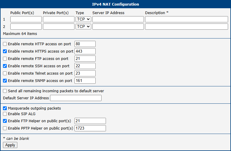

Remote Access
This section allows you to enable remote access to the router's own management services from the WAN interface.
| Enable remote HTTP access on port | Enables remote access to the router's web interface via HTTP on the specified port. If the HTTP service is disabled in Services → HTTP while HTTPS is enabled, incoming requests on this port will be redirected to HTTPS. |
| Enable remote HTTPS access on port | Allows secure remote access to the router's web interface via HTTPS on the specified port. |
| Enable remote FTP access on port | Allows remote access to the router's FTP server on the specified port. |
| Enable remote SSH access on port | Allows remote access to the router's command-line interface via SSH on the specified port. |
| Enable remote Telnet access on port | Allows remote access to the router's command-line interface via Telnet on the specified port. |
| Enable remote SNMP access on port | Allows remote management and monitoring of the router via SNMP on the specified port. |
Warning
For secure management, always use HTTPS access. The HTTP remote access option is for redirection only. Exposing unsecured services to the Internet poses a significant security risk and should be avoided.
Default Server and NAT Helpers
This section contains advanced NAT features, including a default server (DMZ) setting and Application-Layer Gateways (ALGs) for specific protocols.
| Send all remaining incoming packets to default server | When enabled, all incoming traffic from the WAN that does not match any other port forwarding rule is forwarded to the specified default server. This is often referred to as a DMZ. |
| Default Server Address | The private IPv4 or IPv6 address of the default server. |
| Enable NAT64 | (IPv6 only) Activates NAT64 translation, allowing IPv6-only clients to communicate with IPv4-only services. Requires a corresponding firewall rule to be effective. |
| Masquerade outgoing packets | Enables source NAT (SNAT) for all outgoing traffic, making it appear to originate from the router's public WAN IP address. This should almost always be enabled. |
| Enable SIP ALG | (IPv4 only) Enables the Session Initiation Protocol Application-Layer Gateway, which helps VoIP traffic traverse NAT by modifying SIP packet headers. |
| Enable FTP Helper on public port(s) | Assists with NAT traversal for the FTP protocol, particularly for active mode FTP, on the specified port (default is 21). |
| Enable PPTP Helper on public port(s) | (IPv4 only) Assists with NAT traversal for the Point-to-Point Tunneling Protocol (PPTP) for VPN connections on the specified port (default is 1723). |
Warning
The NAT64 functionality is based on the Jool implementation, which has certain limitations. It is not possible to connect to the router itself using its NAT64-mapped IPv4 address (e.g., 64:ff9b::192.0.2.1). Furthermore, firewall rules for NAT64 traffic must be created in the input chain, not the forward chain, as Jool processes the packets as if they originate from the router itself.
NAT Configuration Examples
Example 1: Forward All Traffic to a Single Device (DMZ)
This configuration forwards all incoming traffic from the Internet to a single device on the LAN, effectively placing it in a Demilitarized Zone (DMZ).
- Enable the Send all remaining incoming packets to default server option.
- Enter the IP address of the target device in the Default Server IP Address field.
The LAN device must be configured to use the router's IP address as its default gateway. With this setup, a ping request to the router's public SIM card IP address will be answered by the device, not the router.
Example 2: Port Forwarding to Multiple Devices
This example shows how to make services on multiple internal devices accessible from the Internet using port forwarding. A different public port is mapped to a service on each internal server.
For instance, to make a web server on device 192.168.1.2 (port 80) accessible via public port 81, create the following rule:
- Public Port(s):
81 - Private Port(s):
80 - Type: TCP
- Server IP Address:
192.168.1.2
External users can then access the web server by navigating to http://<router_public_ip>:81. Since the Send all remaining incoming packets to default server option is disabled, any traffic not matching a specific rule will be dropped.

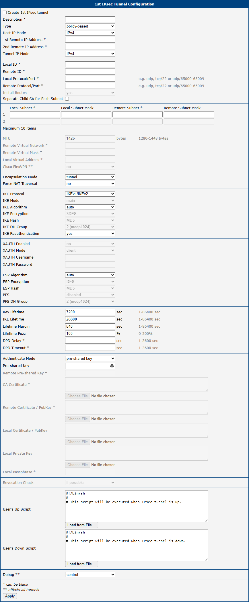

IPsec
The IPsec tunnel feature enables you to create secure connections between two separate LAN networks. You can configure up to four IPsec tunnels, with support for both IPv4 and IPv6 dual stack operation.
To configure an IPsec tunnel, select IPsec from the Configuration section of the main menu. The menu will expand to show configuration pages for each tunnel (1st Tunnel through 4th Tunnel).
The system supports both policy-based and route-based VPN approaches. You can transport IPv6 traffic through IPv4 tunnels and vice versa using the dual stack capability.
Warning
When configuring IPsec tunnels, keep these key points in mind:
- To encrypt data between local and remote subnets, specify the appropriate values in the subnet fields on both routers. To encrypt only the data stream between the routers, leave the local and remote subnet fields blank.
- If you specify protocol and port information in the Local Protocol/Port field, the router will encapsulate only packets matching those settings.
- For an optimal and secure setup, follow the instructions on the strongSwan Security Recommendations page.
Info
- Detailed information and more examples of IPsec tunnel configuration can be found in the IPsec Tunnel application guide.
- The FRR Router App is an Internet routing protocol suite for Advantech routers. It includes protocol daemons for BGP, IS-IS, LDP, OSPF, PIM, and RIP.
Policy-based vs. Route-based VPN
The router supports two VPN modes, selectable via the Type field on the IPsec configuration page. The key differences are summarized in the table below.
| Feature | Policy-based | Route-based |
| Traffic selection | Subnet pairs defined in Local Subnet and Remote Subnet fields | Routing table entries |
| Virtual interface | None | ipsecX interface is created |
| Traffic inspection | Not possible on tunnel traffic | Possible using tcpdump -i ipsecX |
| Dynamic routing | Not supported | Supported (e.g., FRR/BGP, FRR/OSPF) |
| Multiple clients | Limited | Fully supported |
| Cisco FlexVPN | Not supported | Supported |
| Configuration complexity | Lower | Higher |
In policy-based mode, the router encrypts traffic based on configured security policies defined by the subnet pairs in Local Subnet and Remote Subnet. No virtual interface is created — the kernel's policy engine handles encapsulation transparently. This is the simpler approach and is suitable for most standard site-to-site VPN deployments.
In route-based mode, a virtual ipsecX interface is created for each tunnel. Traffic is routed into the tunnel using standard routing rules, which enables dynamic routing protocols and more flexible topologies. The available route-based scenarios are described in the Configuration Scenarios section.
Tips
When using policy-based mode, if neither Local Subnet nor Remote Subnet is configured, only router-to-router traffic is encrypted — no LAN-to-LAN traffic will pass through the tunnel.
The following scenarios describe the most common VPN topologies supported by Advantech routers. The examples use route-based mode, but — with the exception of scenarios 2 and 3 — they are equally applicable to policy-based mode.
Enabled Installing Routes
- Remote and local subnets are used as traffic selectors (routes).
- This results in the same outcome as a policy-based VPN.
- A benefit of this approach is the ability to inspect unencrypted traffic on the
ipsecXinterface using a tool liketcpdump -i ipsecX. - Set Install Routes to yes.
Static Routes (route-based only)
- Routes are installed statically by an application as soon as the IPsec tunnel is established.
- An application like FRR/STATICD can be used for this purpose.
- Set Install Routes to no.
Dynamic Routing (route-based only)
- Routes are installed dynamically by a routing protocol application, such as FRR/BGP or FRR/OSPF.
Multiple Clients
- This allows for a VPN network with multiple clients. One router acts as the server and assigns IP addresses to all clients.
- The server has Remote Virtual Network and Remote Virtual Mask configured, while clients use the Local Virtual Address setting.
IPsec Authentication Scenarios
The system supports four primary authentication options:
Pre-shared Key
- Set Authenticate Mode to pre-shared key
- Enter the shared key in the Pre-shared Key field
Public Key
- Set Authenticate Mode to X.509 certificate
- Enter the public key in the Local Certificate/PubKey field
- CA certificate not required
Peer Certificate
- Enter the remote key in the Remote Certificate/PubKey field
- Allows users with this certificate
CA Certificate
- Enter the CA certificate or certificate list in the CA Certificate field
- Accepts any certificate signed by the CA
- Remote certificate not required
Note that Peer and CA Certificate authentication methods can be used simultaneously, allowing authentication through either method. The Local ID is significant - when using certificate authentication, the IKE identity must be contained in the certificate as either subject or subjectAltName.
Configuration Items Description
The configuration GUI for IPsec is shown in the figure below, and the description of all items is provided in the following table.
| Description | A user-defined name or description for the tunnel. |
| Type | • policy-based: Standard VPN approach based on security policies. • route-based: VPN approach based on routing rules. Data throughput may be slightly lower compared to policy-based VPN. |
| Host IP Mode | • IPv4: The router communicates with the remote peer using IPv4. • IPv6: The router communicates with the remote peer using IPv6. |
| 1st Remote IP Address | The primary IPv4, IPv6 address, or domain name of the remote peer, corresponding to the selected Host IP Mode. |
| 2nd Remote IP Address | The secondary (failover) IPv4 or IPv6 address, or domain name, of the remote peer. If configured, failover works as follows: at startup, the router initiates a connection to the 1st Remote IP Address. If that connection fails, the router attempts to connect to the 2nd Remote IP Address. Once the secondary connection is established, the router continues to use it until it fails — it does not automatically switch back to the primary address while the secondary connection is active. |
| Tunnel IP Mode | • IPv4: IPv4 traffic is transported inside the tunnel. • IPv6: IPv6 traffic is transported inside the tunnel. |
| Local ID | The identifier (ID) for the local side of the tunnel, typically composed of a hostname and a domain name (e.g., router@mycompany.com). |
| Remote ID | The identifier (ID) for the remote side of the tunnel. |
| Local Protocol/Port | Narrows the traffic selector by specifying the protocol and port for the local network. The format is protocol/port (e.g., 17/1701 for UDP port 1701). |
| Remote Protocol/Port | Narrows the traffic selector by specifying the protocol and port for the remote network. |
| Install Routes | For route-based mode only. If set to yes, the router automatically uses the traffic selectors to create and install routes. |
| Separate Child SA for Each Subnet | If enabled, a unique Child Security Association (SA) is created for each pair of local and remote subnets. This can improve interoperability with certain vendors and allow for more granular traffic policies. If disabled, a single Child SA covers all defined traffic selectors. |
| Local Subnet | The IPv4 or IPv6 address of the local network, based on the selected Tunnel IP Mode. |
| Local Subnet Mask | The IPv4 subnet mask or IPv6 prefix length (0–128) for the local network. |
| Remote Subnet | The IPv4 or IPv6 address of the network behind the remote peer. |
| Remote Subnet Mask | The IPv4 subnet mask or IPv6 prefix length for the remote network. |
| MTU | The Maximum Transmission Unit for the tunnel in route-based mode. The default value is 1426 bytes. |
| Remote Virtual Network | Specifies the virtual remote network for a server (responder). |
| Remote Virtual Mask | Specifies the virtual remote network mask for a server. |
| Local Virtual Address | Specifies the virtual local network address for a client. Use 0.0.0.0 to have an address assigned by the server. |
| Cisco FlexVPN | Enable to support Cisco FlexVPN functionality (route-based type only). For more information, see the strongswan.conf page. |
| Encapsulation Mode | Specifies the IPsec encapsulation method: • tunnel: The entire IP datagram is encapsulated. • transport: Only the IP header is encapsulated (not supported for route-based VPN). |
| Force NAT Traversal | Enforces NAT traversal by enabling UDP encapsulation of ESP packets. |
| IKE Protocol | Specifies the version of the Internet Key Exchange (IKE) protocol: IKEv1/IKEv2 (auto-negotiate), or explicitly IKEv1 or IKEv2. When set to IKEv1/IKEv2, the router first attempts to negotiate using IKEv2. If the peer does not support IKEv2, the router automatically falls back to IKEv1. IKEv2 is strongly recommended whenever possible, as it provides improved security and enhanced functionality. |
| IKE Mode | Specifies the mode for establishing a connection: main or aggressive. It is strongly recommended not to use the aggressive mode due to lower security. |
| IKE Algorithm | Specifies how algorithms are selected: • auto: Encryption and hash algorithms are selected automatically. • manual: Algorithms are defined by the user. |
| IKE Encryption | Available encryption algorithms: 3DES, AES128, AES192, AES256, AES128GCM128, AES192GCM128, AES256GCM128, CAMELLIA192, CAMELLIA256, CHACHA20POLY1305. |
| IKE Hash | Available hash algorithms: MD5, SHA1, SHA256, SHA384, SHA512. |
| IKE DH Group | Selects the Diffie-Hellman (DH) group, which determines the strength of the key used in the key exchange process. The choice of group is a trade-off between security and performance, as stronger groups require more computation. For detailed guidance on selecting an appropriate group, refer to the official Algorithm Proposals (Cipher Suites) page. |
| IKE Reauthentication | Enable or disable IKE reauthentication (not for IKEv1). |
| XAUTH Enabled | Enable eXtended Authentication (for IKEv1 only). |
| XAUTH Mode | Select the XAUTH mode: client or server. |
| XAUTH Username | The username for XAUTH. |
| XAUTH Password | The password for XAUTH. |
| ESP Algorithm | Specifies how algorithms are selected: • auto: Encryption and hash algorithms are selected automatically. • manual: Algorithms are defined by the user. |
| ESP Encryption | Available encryption algorithms: DES, 3DES, AES128, AES192, AES256, AES128GCM128, AES192GCM128, AES256GCM128, CAMELLIA192, CAMELLIA256, CHACHA20POLY1305. |
| ESP Hash | Available hash algorithms: MD5, SHA1, SHA256, SHA384, SHA512. |
| PFS | Enables or disables Perfect Forward Secrecy, which ensures that session keys are not compromised if one of the long-term private keys is compromised. |
| PFS DH Group | Specifies the Diffie-Hellman group for PFS (see IKE DH Group). |
| Key Lifetime | Specifies the maximum interval after which a new set of encryption keys is automatically negotiated. The typical value is a few hours. The connection remains uninterrupted. |
| Key Lifetime | Specifies the maximum interval after which a new set of encryption keys is automatically negotiated. The typical value is a few hours. The connection remains uninterrupted. (default: 7200 seconds) |
| IKE Lifetime | Specifies the time period after which the router must re-authenticate the connection. The typical value ranges from a few hours to several days and must be greater than Key Lifetime. The entire connection is re-established, and a brief interruption may occur. (default: 28800 seconds) |
| Lifetime Margin | Specifies how long before Key Lifetime or IKE Lifetime expires the router should initiate rekeying or reauthentication, to ensure the process completes within the lifetime interval. This value should be less than half of Key Lifetime and IKE Lifetime. (default: 540 seconds) |
| Lifetime Fuzz | Specifies a percentage used to calculate a random time offset added to Lifetime Margin. This introduces random variation in each rekeying and reauthentication cycle to prevent multiple devices from synchronizing their requests. |
| DPD Delay | Time after which the IPsec tunnel functionality is tested. |
| DPD Timeout | The period the router waits for a DPD response before considering the peer to be down. |
| Authenticate Mode | Specifies the authentication method: • Pre-shared key: Use a shared secret for both sides. • X.509 Certificate: Use X.509 certificates for authentication. |
| (Local) Pre-shared Key | The shared secret for both sides of the tunnel (for IKEv2, this is the local key). This field appears only when pre-shared key mode is selected. |
| Remote Pre-shared Key | The shared secret for the remote side (for IKEv2). Appears only when pre-shared key mode is selected. |
| CA Certificate | The CA certificate or chain used for X.509 authentication to validate the remote peer's certificate. |
| Remote Certificate \ PubKey | The remote peer's X.509 certificate or public key for signature-based authentication. |
| Local Certificate \ PubKey | The local router's X.509 certificate or public key. |
| Local Private Key | The private key corresponding to the local certificate. |
| Local Passphrase | The passphrase used during private key generation. |
| Revocation Check | Certificate revocation policy: • if possible: Fails only if a certificate is known to be revoked. • if URI defined: Fails if a CRL/OCSP URI is available, but revocation checking fails. • always: Fails if no revocation information is available (the certificate is not known to be unrevoked). |
| User's Up Script¹ | A custom script executed when the IPsec tunnel is established. |
| User's Down Script¹ | A custom script executed when the IPsec tunnel is closed. |
| Debug | Controls the level of logging verbosity: silent (no logging), audit (logs only successful connections and disconnections), control (default level), control-more, raw, private (most verbose, including private keys). See the Logger Configuration page on the strongSwan website for details. |
¹ Parameters passed to the script:
- for policy-based type: one parameter: connection name, returns e.g.
ipsec1-1, - for route-based type: two parameters: connection name and interface name, returns e.g.
ipsec1-1andipsec0.
We recommend retaining the default settings. Increasing key lifetimes reduces operational costs but also decreases security. Conversely, shorter lifetimes increase security but may affect performance. Changes are applied after clicking the Apply button.
Warning
- If local and remote subnets are not configured, only packets between local and remote IP addresses are encapsulated, so only router-to-router communication is encrypted.
- If protocol/port fields are configured, only packets matching those settings are encapsulated.
Basic IPv4 IPsec Tunnel Configuration Example
Configuration of Router A and Router B is as follows:
| Configuration | Router A | Router B |
| Host IP Mode | IPv4 | IPv4 |
| 1st Remote IP Address | 10.0.0.2 | 10.0.0.1 |
| Tunnel IP Mode | IPv4 | IPv4 |
| Local Subnet | 192.168.1.0 | 192.168.2.0 |
| Local Subnet Mask | 255.255.255.0 | 255.255.255.0 |
| Remote Subnet | 192.168.2.0 | 192.168.1.0 |
| Remote Subnet Mask | 255.255.255.0 | 255.255.255.0 |
| Authenticate mode | pre-shared key | pre-shared key |
| Pre-shared key | test | test |
WireGuard

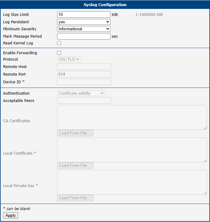

Syslog
The Syslog service collects and manages system messages from the router's operating system and applications. To configure it, navigate to Services → Syslog.
The collected logs can be viewed at Status → System Log, or via the command line with the slog command.
Local Logging
These settings control how logs are stored on the router itself.
| Log Size Limit | Sets the maximum size (in KiB) for the local log files. The default is 10 KiB. |

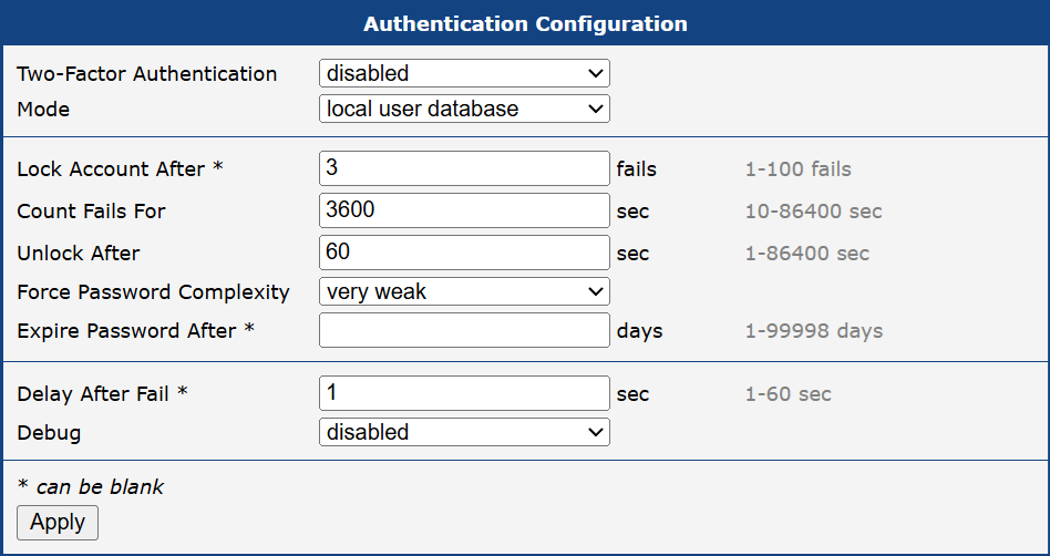

The Configuration → System → Authentication page allows for the configuration of user authentication methods, password policies, and account lockout settings. The router can authenticate users against its local database or against external RADIUS or TACACS+ servers.
General Settings
These settings are common across all authentication modes.
| Two-Factor Authentication | Enables a second layer of security for user logins. Options include Google Authenticator or OATH. |
| Mode | Selects the primary authentication method: • Local user database: Authenticates against the router's local user list, refer to Manage Users. • RADIUS with fallback: Authenticates against a RADIUS server. If the server is unreachable, it falls back to the local database. • RADIUS only: Authenticates only against a RADIUS server. Caution: If the server is unreachable, login will be impossible. • TACACS+ with fallback: Authenticates against a TACACS+ server, with fallback to the local database. • TACACS+ only: Authenticates only against a TACACS+ server. Caution: If the server is unreachable, login will be impossible. |
| Lock Account After | The number of failed login attempts before an account is locked. |
| Count Fails For | The time window in seconds during which failed attempts are counted. |
| Unlock After | The duration in seconds after which a locked account is automatically unlocked. |
| Force Password Complexity | Enforces minimum password strength requirements. The four character classes are: uppercase letters (A–Z), lowercase letters (a–z), digits (0–9), and special characters (e.g., !@#$+.). • Very Weak: At least 6 characters; must not contain the username; must not be a palindrome. • Weak: At least 8 characters from at least 2 of the 4 classes; must not contain the username; must not be a palindrome. • Good: At least 12 characters from at least 3 of the 4 classes; no more than 3 identical consecutive characters; must not contain the username; must not be a palindrome. • Strong: At least 16 characters from all 4 classes; no more than 2 identical consecutive characters; must not contain the username; must not be a palindrome. |
| Expire Password After | The number of days until a user password expires, forcing a change on next login. |
| Delay After Fail | The time in seconds the login screen is disabled after a failed attempt. |
| Debug | Enables detailed authentication-related messages in the system log. |

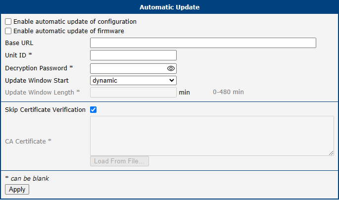

Automatic Update
The router can be configured to automatically download and apply firmware and configuration updates from a remote server. This feature is essential for managing large-scale deployments and ensuring that devices are always up-to-date. The settings are located on the Configuration → System → Automatic Update page.
Update Configuration
| Enable automatic update of configuration | Enables the automatic update of the router's configuration file. |
| Enable automatic update of firmware | Enables the automatic update of the router's firmware. |
| Base URL | The base URL of the remote server where update files are stored. The default protocol is HTTPS. To use a different protocol (HTTP, FTP, or FTPS), the prefix must be specified explicitly (e.g., http://myupdateserver.com). |
| Unit ID | A custom identifier used as the filename for the configuration file. If empty, the router defaults to using its ETH0 MAC address as the filename. |
| Decryption Password | The password required to decrypt an encrypted configuration file. |
| Update Window Start | The hour (1–24) when the daily update check should begin. If set to dynamic, the check runs five minutes after boot and every 24 hours thereafter. |
| Update Window Length | A duration in minutes defining a window of time, starting at the Update Window Start, during which the update is performed at a random moment. This helps distribute load on the update server in large deployments. |
| Skip Certificate Verification | When enabled, the router does not validate the SSL/TLS certificate of the remote HTTPS/FTPS server. |
| CA Certificate | The custom CA certificate used for server validation. |

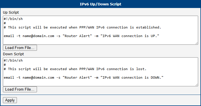

Up/Down IPv6
The Up/Down IPv6 page serves a purpose similar to that of the IPv4 page, but it is specifically intended for IPv6 connections.
Script Example
This example uses the IPv6 Up/Down scripts to send an email notification whenever the IPv6 WAN connection status changes. The SMTP service must be configured beforehand.
Up Script:email -t name@domain.com -s "Router Alert" -m "IPv6 WAN connection is UP."
Down Script:email -t name@domain.com -s "Router Alert" -m "IPv6 WAN connection is DOWN."
Warning
After saving an Up/Down script, the router must be rebooted for the changes to become active.

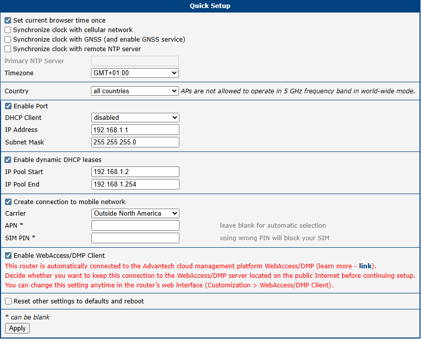

Quick Setup
The Quick Setup page provides a streamlined, single-page interface that gathers all of the most critical settings for the initial configuration of the router. This page is automatically displayed upon the first login to a new or factory-reset device, but it can also be accessed manually at any time via Configuration → Quick Setup.
This wizard conveniently consolidates essential settings from various sections of the web interface, allowing you to configure time, LAN, and mobile network settings from a single page.
Time and Region
For a complete overview of these settings, refer to NTP and WiFi Country. To set the date and time manually, see the Set Date and Time administration page.
| Set current browser time once | A one-time action that sets the router's system time to match the time of your web browser. |
| Synchronize clock with... | Selects the method for automatic time synchronization. Note that synchronization via GNSS is only available on router models equipped with a GNSS module. |
| Primary NTP Server | The address of the NTP server to use when Synchronize clock with remote NTP server is selected. |
| Timezone | Sets the local timezone for the router. |
| Country | For models equipped with Wi-Fi, this setting configures the regulatory domain. Select the country of operation to ensure compliance with local radio frequency regulations, as this affects which Wi-Fi channels are available. |
LAN Port and DHCP Server
The full configuration options for the LAN interface are described in Ethernet.
| Enable Port | Enables or disables the primary LAN port (eth0). |
| DHCP Client | If enabled, the router's LAN port requests an IP address from another DHCP server on the network. |
| IP Address | The static IPv4 address assigned to the router's primary LAN interface. |
| Subnet Mask | The subnet mask for the primary LAN interface. |
| Enable dynamic DHCP leases | Enables the router's built-in DHCP server, which automatically assigns IPv4 addresses to client devices on the LAN. |
| IP Pool Start | The starting address of the IP range that the DHCP server leases to clients. |
| IP Pool End | The ending address of the IP range that the DHCP server leases to clients. |
Mobile Network
Info
This section is only available on cellular router models.
The complete configuration for the mobile network is available in Mobile WAN.
| Create connection to mobile network | When checked, the router automatically attempts to connect to the mobile network after booting. |
| Carrier | Allows the selection of a pre-defined profile for a specific mobile carrier (e.g., for North American operators). |
| APN | The Access Point Name for your mobile network data plan. In many cases, this can be left blank to allow for automatic selection by the carrier. |
| SIM PIN | The PIN for your SIM card. Entering an incorrect PIN multiple times may permanently block the SIM card. |
System and Service Settings
| Enable WebAccess/DMP Client | Enables or disables the client for the WebAccess/DMP remote management platform. For complete details, see Remote Management Platform. |
| Reset other settings to defaults and reboot | If checked, any settings not present on this Quick Setup page are reset to their factory defaults when the new configuration is applied. |
