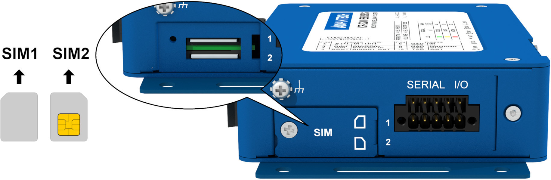

SIM Card Slots
The router includes slots for two Mini SIM cards (2FF; 25.0 x 15.0 x 0.76 mm), located beneath a metal cover. If the router is used for cellular communication, insert an activated SIM card with data enabled into the SIM card reader.
Dual SIM Feature: You can install two SIM cards simultaneously to use the dual SIM switching feature. Each SIM card can be configured with a unique Access Point Name (APN).
SIM Card Handling Procedure:
- Disconnect the router from the power supply.
- Unscrew and remove the SIM card cover.
- To remove a SIM card, use a spudger or your fingernail to press the card slightly into the slot until it clicks. Release it to eject.
- To insert a SIM card, push it into the slot until it clicks into place.
- Replace and secure the SIM card cover with screws.
- If required, enter the SIM PIN in the web interface (Administration → Unlock SIM Card).

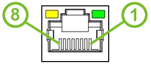

The router features two Ethernet interfaces (ETH0 and ETH1), accessible via RJ45 panel sockets. The pinout and signal descriptions are as follows:
| Pin | Signal Mark | Description |
| 1 | Tx+ | Transmit Data+ (positive pole) |
| 2 | Tx- | Transmit Data- (negative pole) |
| 3 | Rx+ | Receive Data+ (positive pole) |
| 4 | — | — |
| 5 | — | — |
| 6 | Rx- | Receive Data- (negative pole) |
| 7 | — | — |
| 8 | — | — |
Tips
Ethernet ports are isolated from the ground with a barrier of 1500 V.

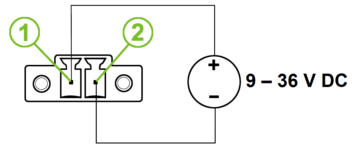

The router operates on a DC power supply with a voltage range of +9 V to +36 V. A two-pin terminal connector (3.5 mm pitch) is included as standard. The power source must supply a peak current of 1.2 A. The router must be powered by a supply classified as a Limited Power Source (LPS) or CEC/NEC Class 2.
| Pin number | Signal mark | Description |
| 1 | VCC(+) | Positive pole of DC supply voltage (+9 to +36 V DC) |
| 2 | GND(-) | Negative pole of DC supply voltage |

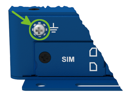

- Use the grounding screw on the left panel to ground the router. Ensure the negative pole of the DC power supply shares the same voltage reference as the grounding screw.
- A voltage difference between the grounding point and the negative pole may damage the router.

Grounding
All metal parts, including the box, are connected together with the negative pole of the power supply (common pole). Use the grounding screw on the left panel to ground the router.

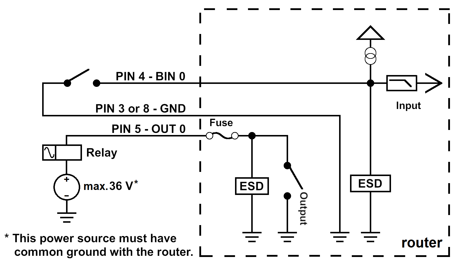

- Use external termination resistors to reduce noise and signal reflections.
- The maximum digital output load is 36 V at 500 mA.
The figure below shows the functional connection scheme for the digital input and output.
