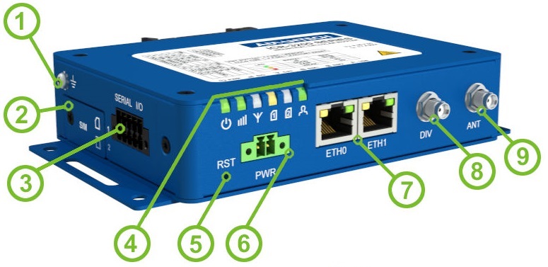

The ICR-3200 series supports a wide array of hardware features, as illustrated in the image below. Refer to the Model Overview section for model-specific details.
| # | Caption | Type | Description |
| 1 | Grounding Screw | M3 | Ensure proper grounding; see Power Supply and Grounding. |
| 2 | SIM Slots | Mini SIM | Two SIM card slots; see SIM Card Slots. |
| 3 | Serial I/O | 10-pin terminal | RS-232, RS-485, and digital I/O interfaces; see Serial and I/O Ports. |
| 4 | LEDs | — | Status LED indicators; see LED Indicators. |
| 5 | Reset Button (RST) | — | Button to reboot the router or restore the defaults; see Reset. |
| 6 | Power Supply (PWR) | 2-pin terminal | Connect the power supply; see Power Supply and Grounding. |
| 7 | Ethernet Ports (ETH0, ETH1) | RJ45 | 100 Mbps Ethernet ports; see Ethernet Interfaces. |
| 8 | Diversity Antenna (DIV) | SMA | Connector for cellular diversity antenna; see Antenna Connections and Cellular Module Parameters. |
| 9 | Main Antenna (ANT) | SMA | Connector for the main cellular antenna; see Antenna Connections and Cellular Module Parameters. |

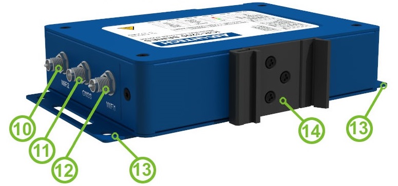

| 10 | Wi-Fi Antenna 1 (WiFi1) | RP-SMA | Connector for the first Wi-Fi antenna; see Antenna Connections and Wi-Fi Parameters. |
| 11 | GNSS Antenna | SMA | Connector for GNSS antenna; see Antenna Connections and GNSS Parameters. |
| 12 | Wi-Fi Antenna 2 (WiFi2) | RP-SMA | Second Wi-Fi antenna connector, also used for Bluetooth; see Bluetooth Support and Bluetooth Parameters. |
| 13 | Wall Mount Clips | — | Standard wall-mounting clips; see Wall Mounting. |
| 14 | DIN Rail Clip | — | Pre-installed DIN rail clip; see DIN Rail Mounting. |

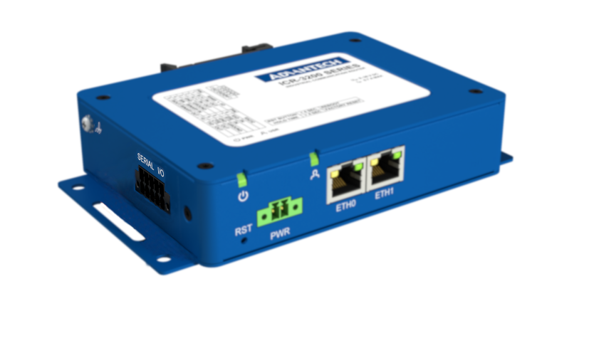

| Router | ICR-3200 series router | ![]() | 1 |

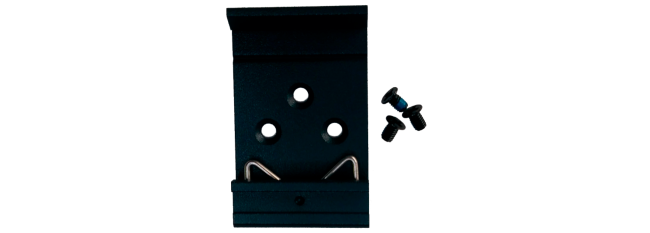

| DIN Rail Mount | DIN rail clip for mounting on EN 60715 rails; pre-installed on the router | ![]() | 1 set |

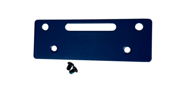

| Wall Mount Wings | Wall mounting clips for surface installation; pre-installed on the router | ![]() | 2 pcs |

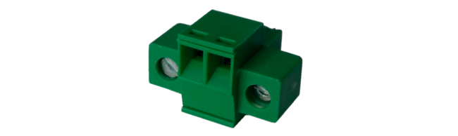

| Power Terminal Block | 2-pin terminal block for DC power supply connection; pre-installed on the router | ![]() | 1 |

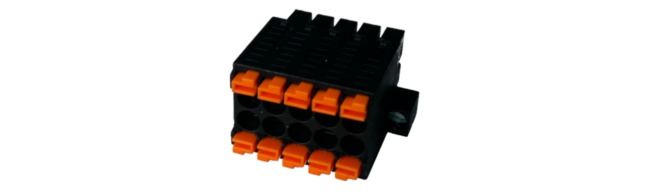

| I/O Terminal Block | 10-pin terminal block for RS-232, RS-485, and digital I/O; pre-installed on the router | ![]() | 1 |
