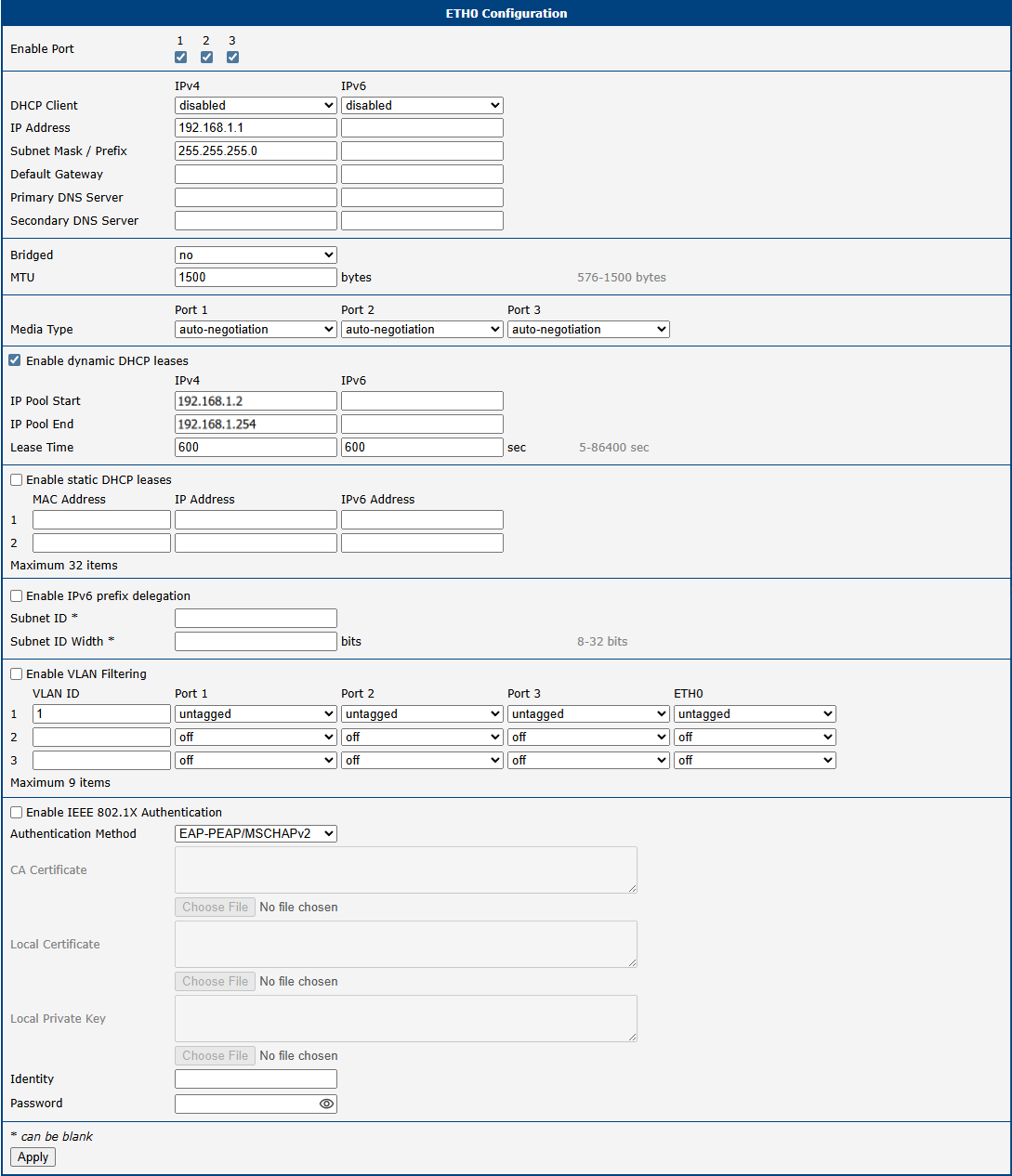

To enter the Local Area Network configuration, select the Ethernet menu item in the Configuration section. The Ethernet item will expand in the menu on the left, allowing you to choose the appropriate Ethernet interface to configure: ETH0 for the first Ethernet interface and ETH1 for the second Ethernet interface.
The LAN Configuration page is divided into IPv4 and IPv6 columns, as shown in Figure below. There is dual stack support for IPv4 and IPv6 protocols, meaning they can run concurrently. You can configure either one of them or both. If both IPv4 and IPv6 are configured, network devices will automatically select the communication protocol. The configuration items and differences between IPv6 and IPv4 are described in the tables below.
Since some models have the ETH0 interface as a switched Ethernet interface with three ports, there are three checkboxes on the page labeled Enable Port. These can be used to enable or disable individual ports. Unlike a single-port Ethernet interface, this configuration page also includes a section for VLAN filtering settings; for more information, see VLAN Filtering below.
| Item | Description |
| Enable Port | Enables or disables the physical Ethernet port. |
| DHCP Client | Enables or disables the DHCP client function. If in the IPv6 column, the DHCPv6 client is enabled. The DHCPv6 client supports all three methods of obtaining an IPv6 address: SLAAC, stateless DHCPv6, and stateful DHCPv6. Options: • disabled: The router does not allow automatic allocation of an IP address from a DHCP server in the LAN network. • enabled: The router allows automatic allocation of an IP address from a DHCP server in the LAN network. |
| IP Address | A fixed IP address for the Ethernet interface. Use IPv4 notation in the IPv4 column and IPv6 notation in the IPv6 column. Shortened IPv6 notation is supported. |
| Subnet Mask / Prefix | Specifies the subnet mask for the IPv4 address. In the IPv6 column, fill in the prefix for the IPv6 address: a number in the range of 0 to 128. |
| Default Gateway | Specifies the IP address of the default gateway. If provided, every packet with a destination not found in the routing table is sent to this IP address. Use the correct IP address notation in both the IPv4 and IPv6 columns. |
| Primary DNS Server | Specifies the primary IP address of the DNS server. When the IP address is not found in the routing table, the router forwards the request to the DNS server specified here. Use the correct IP address notation in both the IPv4 and IPv6 columns. |
| Secondary DNS Server | Specifies the secondary IP address of the DNS server. |
The Default Gateway and DNS Server items are only used if the DHCP Client is set to disabled and if the ETH0 or ETH1 LAN is selected by the Backup Routes system as the default route.
The following three items (in the table below) are global for the configured Ethernet interface. Only one bridge can be active on the router at a time. The DHCP Client, IP Address, and Subnet Mask / Prefix parameters of only one of the interfaces are used for the bridge. The ETH0 LAN has higher priority when both interfaces (ETH0 and ETH1) are added to the bridge. Other interfaces can be added to or removed from an existing bridge at any time. The bridge can be created on demand for such interfaces, but not if it is configured by their respective parameters.
Warning
Under certain conditions, the ETH interface may operate as a WAN interface, and the rules defined in the Firewall settings will be applied to it. Details are described in Backup Routes and are demonstrated with examples provided there.
| Bridged | Activates or deactivates the bridging function on the router. • no: The bridging function is inactive (default). • yes: The bridging function is active. See the Bridge Notes below the table for further details. |
| MTU | Maximum Transmission Unit value. Default value is 1500 bytes. |
| Media Type | Specifies the type of duplex and speed used in the network. • Auto-negotiation: The router automatically sets the best speed and duplex mode of communication according to the network's possibilities. • 100 Mbps Full Duplex: The router communicates at 100 Mbps, in the full duplex mode. • 100 Mbps Half Duplex: The router communicates at 100 Mbps, in the half duplex mode. • 10 Mbps Full Duplex: The router communicates at 10 Mbps, in the full duplex mode. • 10 Mbps Half Duplex: The router communicates at 10 Mbps, in the half duplex mode. |
Bridge Notes
A bridge behaves like a network switch, forwarding packets between interfaces that are connected to it. The Advantech router supports creating a bridge network within Ethernet interfaces or between Ethernet interfaces and Wi-Fi Access Point (AP) interfaces. Once the bridge is configured and established, a new interface named br0 is created. This interface will appear in the Status → Network → Interfaces section.
If a bridge is configured on two Ethernet interfaces, the br0 interface will inherit the IP address of the Ethernet interface with the lower index. IP address and subnet configuration of the Ethernet interface with the higher index will be removed. This behavior is consistent regardless of the order in which the interfaces are configured.
To include a Wi-Fi AP interface in the bridge, at least one Ethernet interface must also be part of the bridge configuration. In this case, the IP address of the bridge interface br0 will again be determined by the Ethernet interface (or interfaces) with the lowest index.
DHCP Server
The DHCP server assigns the IP address, gateway IP address (IP address of the router) and IP address of the DNS server (IP address of the router) to the connected clients. If these values are filled in by the user in the configuration form, they will be preferred.
The DHCP server supports static and dynamic assignment of IP addresses. Dynamic DHCP assigns clients IP addresses from a defined address space. Static DHCP assigns IP addresses that correspond to the MAC addresses of connected clients.
Info
- If IPv6 column is filled in, the DHCPv6 server is used. DHCPv6 server offers stateful address configuration to connected clients. Only when the Subnet Prefix above is set to 64, the DHCPv6 server offers both: the stateful address configuration and SLAAC (Stateless Address Autoconfiguration).
- For DHCPv6 static address assignment to work, DHCPv6 client must use DUID-LL or DUID-LLT types that are derived from its MAC address.
Warning
Do not to overlap ranges of static allocated IP addresses with addresses allocated by the dynamic DHCP server. IP address conflicts and incorrect network function can occur if you overlap the ranges.
Configuration of Dynamic DHCP Server
| Enable dynamic DHCP leases | Select this option to enable a dynamic DHCP server. |
| IP Pool Start | Starting IP addresses allocated to the DHCP clients. Use proper notation in IPv4 and IPv6 column. |
| IP Pool End | End of IP addresses allocated to the DHCP clients. Use proper IP address notation in IPv4 and IPv6 column. |
| Lease time | Time in seconds that the IP address is reserved before it can be re-used. |
Configuration of Static DHCP Server
| Enable static DHCP leases | Select this option to enable a static DHCP server. You can define up to thirty-two rules. A new row for defining the next rule appears automatically after filling in the previous one. |
| MAC Address | MAC address of a DHCP client. |
| IPv4 Address | Assigned IPv4 address. Use proper notation. |
| IPv6 Address | Assigned IPv6 address. Use proper notation. |

VLAN Filtering
Info
- This feature is available for the ICR-2500 and ICR-2600 product lines only.
- The functionality in this section controls VLAN membership within the ETH0 switch. The router also allows you to define up to three separate VLAN interfaces (
vlan1,vlan2,vlan3) with their own DHCP settings, accessible via Configuration → VLAN → 1st/2nd/3rd VLAN.
Virtual LAN (VLAN) filtering allows you to partition a single physical Ethernet switch into multiple, isolated logical networks. Each VLAN is identified by a unique VLAN ID, and traffic is strictly forwarded only between ports assigned to the same VLAN. This provides enhanced network segmentation and security. Individual ports can be configured as either access ports, which connect end devices to a single VLAN, or trunk ports, which carry traffic for multiple VLANs to other network devices.
The VLAN filtering interface is located on the Ethernet → ETH0 configuration page. The figure below shows the default configuration table for a three-port ETH0 switch, which allows up to nine VLANs to be configured.
By default, VLAN filtering is disabled, and all LAN ports function as a single, unsegmented switch: all enabled LAN ports forward traffic between each other without restriction, the internal eth0 interface receives all traffic from all connected ports, and VLAN-tagged frames are forwarded transparently.

Enabling VLAN Filtering
When Enable VLAN Filtering is checked, the switch enforces VLAN rules. Each port, including the internal trunk port (eth0), can be assigned to a VLAN in one of three modes:
- Untagged — The port acts as an access port for the selected VLAN. Incoming untagged frames are assigned to this VLAN (its PVID); outgoing frames are transmitted untagged.
- Tagged — The port acts as a trunk port for the selected VLAN. It accepts and transmits frames with VLAN tags intact.
- Off — The port is not a member of this VLAN and will not forward its traffic.
How It Works
- Untagged VLAN on
eth0— This defines the Native VLAN. Untagged traffic on the trunk is delivered to the baseeth0interface. - Tagged VLAN on
eth0— Tagged traffic is delivered to the corresponding VLAN sub-interface (e.g., VLAN 100 →vlan1). - Access Ports (Untagged) — A port can only have one untagged VLAN (its PVID). It handles traffic for non-VLAN-aware devices.
- Trunk Ports (Tagged) — A port can forward multiple tagged VLANs to other VLAN-aware devices and can also handle one Native VLAN (untagged).
Info
A port can have only one untagged VLAN (PVID). This ensures all incoming untagged frames are mapped to a single VLAN and is enforced by the GUI.
Caution
If you manage the router via its eth0 interface, always keep the management port configured as Untagged for the native VLAN to avoid losing access.
Warning
Removing a VLAN ID from the filtering table disables that VLAN across the entire switch.

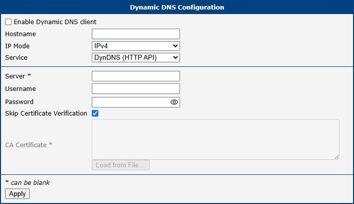

Dynamic DNS
The Dynamic DNS client allows you to access the router using a fixed, memorable hostname, even if the router’s IP address changes. The client monitors the router’s public IP address and automatically updates the DNS record on a Dynamic DNS server whenever a change is detected. To configure the service, navigate to Services → Dynamic DNS.
Warning
For the Dynamic DNS service to function correctly, the router’s SIM card must be assigned a public IP address by the mobile provider.
| Hostname | Your fully qualified domain name registered with a Dynamic DNS provider (e.g., myrouter.example.com). |
| IP Mode | The IP protocol version for DNS updates: IPv4 (default), IPv6, or IPv4/IPv6 (dual-stack). |
| Service | The protocol used for the update. Only DynDNS (HTTP API) for standard webbased providers is available. |
| Server | The update server address of your Dynamic DNS provider. If left blank, the default value members.dyndns.org is used. Several free services are available: freedns.afraid.org, www.duckdns.org, www.noip.com. Secure HTTPS URLs are supported. Active only when Service is set to DynDNS (HTTP API). |
| Username | The username for your Dynamic DNS service account. Active only when Service is set to DynDNS (HTTP API). |
| Password | The password for your Dynamic DNS service account. Active only when Service is set to DynDNS (HTTP API). |
| Skip Certificate Verification | Check to bypass SSL/TLS certificate validation when connecting to an HTTPS server. Active only when Service is set to DynDNS (HTTP API). |
| CA Certificate | The Certificate Authority (CA) certificate used to verify the server’s identity during HTTPS updates. Active only when Service is set to DynDNS (HTTP API). |
Configuration Example
The example below shows how to configure the router to securely update a dual-stack DNS record using a custom provider’s HTTPS API, with certificate verification enforced. The content of the CA Certificate is pasted into the corresponding text area (or imported using the Load From File button) to authenticate the server.
| Setting | Value |
| Hostname | router.example.com |
| IP Mode | IPv4/IPv6 |
| Service | DynDNS (HTTP API) |
| Server | https://ddns.example.com |
| Username | admin_user |
| Password | <your_secure_password> |
| Skip Certificate Verification | unchecked |
| CA Certificate | <pasted PEM certificate content> |

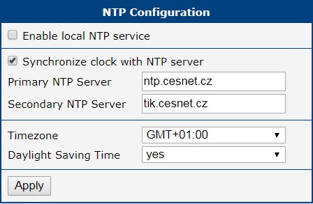

NTP
The NTP (Network Time Protocol) configuration page allows you to configure the router’s NTP client and/or server functions. To open the NTP configuration page, click NTP in the Configuration section of the main menu. NTP allows you to periodically set the internal clock of the router. The time is set from servers that provide the exact time to network devices.
- If you check the Enable local NTP service box, the router acts as an NTP server for other devices in the local network (LAN).
- If you check the Synchronize clock with NTP server box, the router acts as an NTP client. This means that the router automatically adjusts the internal clock every eight hours.
| Primary NTP Server Address | IP address or domain name of the primary remote NTP server. This server is queried first for time synchronization. |
| Secondary NTP Server Address | IP address or domain name of the secondary remote NTP server. This server is used if the primary server is unavailable. |
| Timezone | Specifies the geographical timezone where the router is physically located. This setting is crucial for correct local time display and DST adjustments. |
| Daylight Saving Time | Enables or disables automatic adjustment for Daylight Saving Time (DST). When enabled, the router will adjust its clock according to the DST rules for the selected Timezone. |

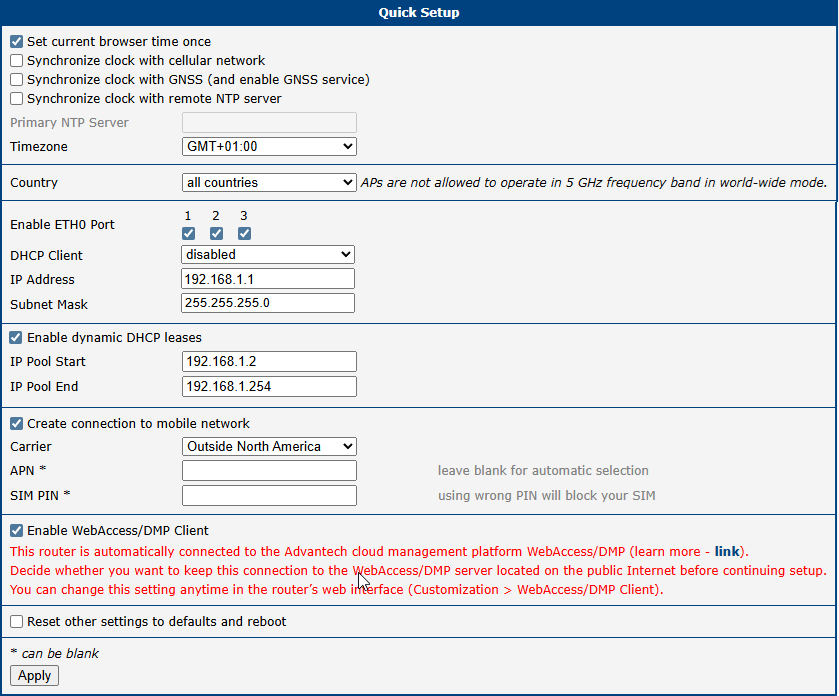

Quick Setup
The Quick Setup page provides a streamlined, single-page interface that gathers all of the most critical settings for the initial configuration of the router. This page is automatically displayed upon the first login to a new or factory-reset device, but it can also be accessed manually at any time via Configuration → Quick Setup.
This wizard conveniently consolidates essential settings from various sections of the web interface, allowing you to configure time, LAN, and mobile network settings from a single page.
Time and Region
For a complete overview of these settings, refer to NTP and WiFi Country. To set the date and time manually, see the Set Date and Time administration page.
| Set current browser time once | A one-time action that sets the router's system time to match the time of your web browser. |
| Synchronize clock with... | Selects the method for automatic time synchronization. Note that synchronization via GNSS is only available on router models equipped with a GNSS module. |
| Primary NTP Server | The address of the NTP server to use when Synchronize clock with remote NTP server is selected. |
| Timezone | Sets the local timezone for the router. |
| Country | For models equipped with Wi-Fi, this setting configures the regulatory domain. Select the country of operation to ensure compliance with local radio frequency regulations, as this affects which Wi-Fi channels are available. |
LAN Port and DHCP Server
The full configuration options for the LAN interface are described in Ethernet.
| Enable ETH0 Port / Enable Port | For models equipped with an integrated switch, this allows each physical port on ETH0 to be enabled or disabled individually. For other models, it enables or disables the entire ETH0 interface. |
| DHCP Client | If enabled, the router's LAN port requests an IP address from another DHCP server on the network. |
| IP Address | The static IPv4 address assigned to the router's primary LAN interface. |
| Subnet Mask | The subnet mask for the primary LAN interface. |
| Enable dynamic DHCP leases | Enables the router's built-in DHCP server, which automatically assigns IPv4 addresses to client devices on the LAN. |
| IP Pool Start | The starting address of the IP range that the DHCP server leases to clients. |
| IP Pool End | The ending address of the IP range that the DHCP server leases to clients. |
Mobile Network
Info
This section is only available on cellular router models.
The complete configuration for the mobile network is available in Mobile WAN.
| Create connection to mobile network | When checked, the router automatically attempts to connect to the mobile network after booting. |
| Carrier | Allows the selection of a pre-defined profile for a specific mobile carrier (e.g., for North American operators). |
| APN | The Access Point Name for your mobile network data plan. In many cases, this can be left blank to allow for automatic selection by the carrier. |
| SIM PIN | The PIN for your SIM card. Entering an incorrect PIN multiple times may permanently block the SIM card. |
System and Service Settings
| Enable WebAccess/DMP Client | Enables or disables the client for the WebAccess/DMP remote management platform. For complete details, see Remote Management Platform. |
| Reset other settings to defaults and reboot | If checked, any settings not present on this Quick Setup page are reset to their factory defaults when the new configuration is applied. |
