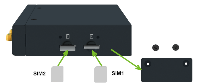

SIM Card Slots
Tips
Models ICR-2031 and ICR-2041 have one SIM card slot. All other models have two SIM card slots.
Slots for two SIM cards are located on the router beneath a metal cover. To communicate over a cellular network, insert an activated, data-provisioned SIM card into a SIM card slot. You can install two SIM cards simultaneously to use the SIM switching feature. You can configure each SIM card with a different APN (Access Point Name).
Tips
SIM card type: Micro SIM (3FF) — 15.0 × 12.0 × 0.76 mm.
Changing the SIM Card
- Always disconnect the router from the power supply before handling the SIM card.
- Unscrew the two screws on the SIM card cover and remove the cover.
- To remove an inserted SIM card, use the flat end of a spudger or your fingernail. Press the card slightly into its slot until you hear a click. Release the card; it will pop out of its slot.
- To insert a SIM card, push the card into the slot until it clicks into place.
- Replace the cover and tighten the two screws.
If the SIM card requires a PIN, enter it in the router's web interface under Administration → Unlock SIM Card.

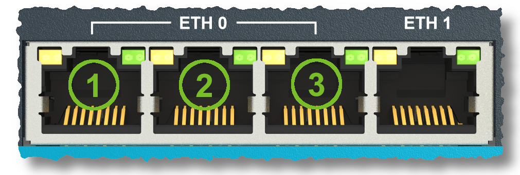

Ethernet Interfaces
Models ICR-2501, ICR-2531, ICR-2631, and ICR-2645 provide three switched ETH0 ports and one ETH1 port. When viewing the router from the front, the first ETH0 port is on the left.
All other models provide one ETH0 port and one ETH1 port. All Ethernet ports are accessible via RJ45 panel sockets.
| Pin | Signal | Description |
| 1 | Tx+ | Transmit Data+ |
| 2 | Tx− | Transmit Data− |
| 3 | Rx+ | Receive Data+ |
| 4 | — | Not Connected |
| 5 | — | Not Connected |
| 6 | Rx− | Receive Data− |
| 7 | — | Not Connected |
| 8 | — | Not Connected |
Tips
The isolation barrier of the Ethernet ports from ground is 1500 V.

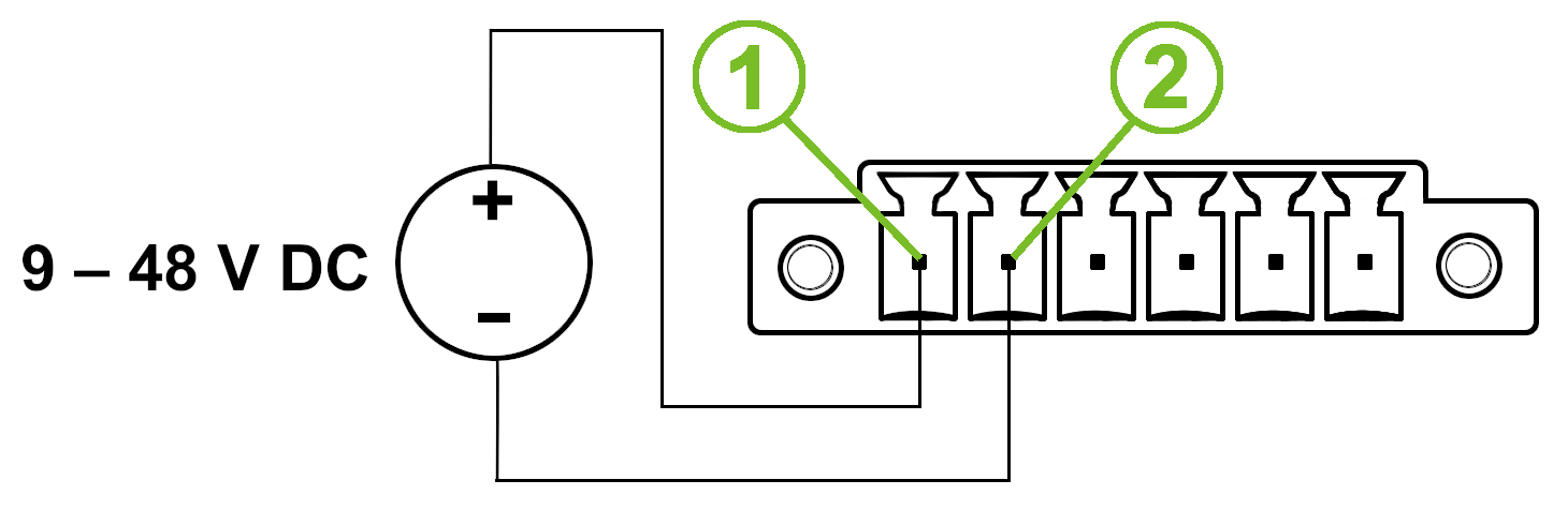

Power Supply
The power supply connects to pins 1 and 2 of the 6-pin terminal block on the left panel. The I/O interface uses pins 3–6 of the same block — see I/O Port.
| 1 | PWR(+) | Positive pole of DC supply voltage (+9 to +48 V DC) |
| 2 | PWR(−) | Negative pole of DC supply voltage |
The required supply voltage is +9 to +48 V DC. The router has built-in protection against reversed polarity without signaling.
Warning
Use a power supply specified as a Limited Power Source (LPS) or CEC/NEC Class 2 power supply.
Tips
The power supply common pole is not connected to the router's metal chassis or internal ground.
To protect the router, ground it using the grounding screw as shown below.

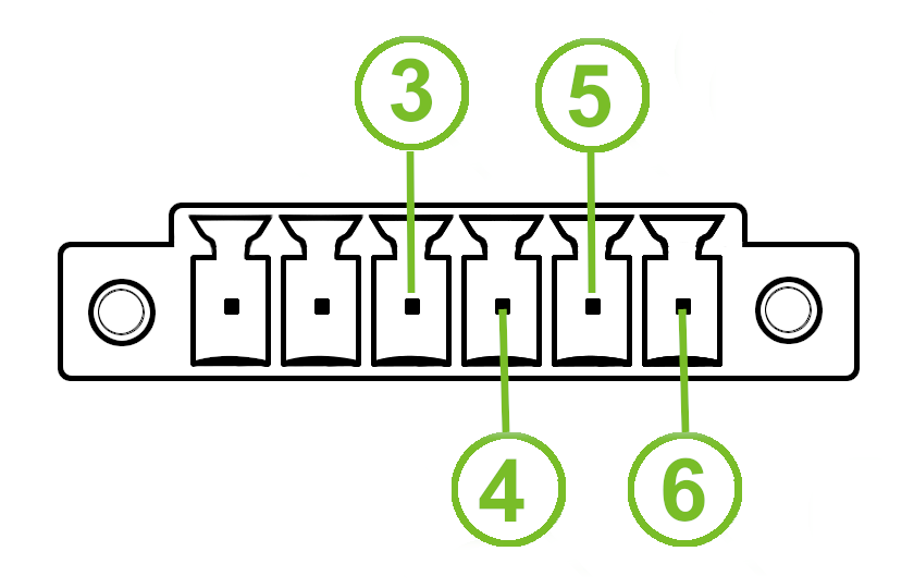

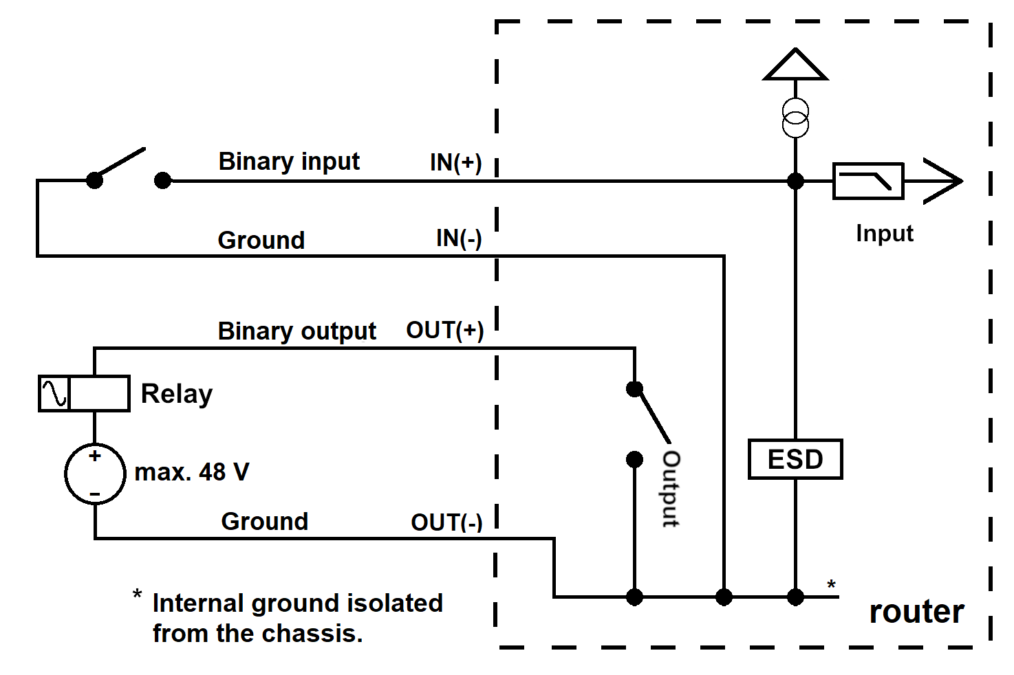

I/O Port
The I/O interface connects to pins 3–6 of the 6-pin terminal block on the left panel. The power supply uses pins 1–2 of the same block — see Power Supply.
Warning
On models ICR-2031, ICR-2041, ICR-2431, and ICR-2441: the maximum length of wires connected to the I/O ports is 3 meters to meet EMC immunity conditions.
| 3 | IN(+) | Digital input (positive pole) |
| 4 | IN(−) | Digital input (negative pole) |
| 5 | OUT(+) | Digital output (positive pole) |
| 6 | OUT(−) | Digital output (negative pole) |

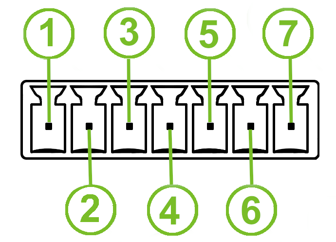

Serial Interfaces
Tips
The serial interface is not available on all models. Refer to the product specifications to confirm whether your model includes a serial interface.
The RS-232 and RS-485 serial interfaces connect to a 7-pin terminal block on the left panel.
RS-485:
| 1 | D (+) | In/Out |
| 2 | D (−) | In/Out |
| 3 | GND | Ground (common with RS-232) |
RS-232:
| 3 | GND | Ground (common with RS-485) |
| 4 | RXD | Received Data |
| 5 | TXD | Transmit Data |
| 6 | RTS | Request to Send |
| 7 | CTS | Clear to Send |
Tips
The serial interfaces are not electrically isolated from the router.
