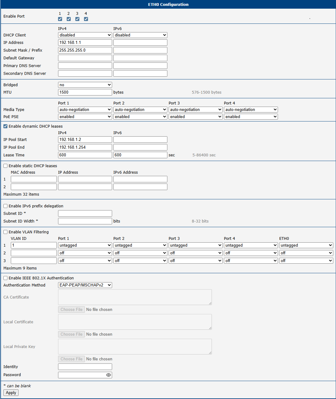

To enter the Local Area Network configuration, select the Ethernet menu item in the Configuration section. The Ethernet item will expand in the menu on the left, allowing you to choose the appropriate Ethernet interface to configure: ETH0 for the first Ethernet interface and ETH1 for the second Ethernet interface, and ETH2 for the third Ethernet interface.
The LAN Configuration page is divided into IPv4 and IPv6 columns, as shown in Figure below. There is dual stack support for IPv4 and IPv6 protocols, meaning they can run concurrently. You can configure either one of them or both. If both IPv4 and IPv6 are configured, network devices will automatically select the communication protocol. The configuration items and differences between IPv6 and IPv4 are described in the tables below.
Since the ETH0 interface is a switched Ethernet interface with four ports, there are four checkboxes on the page labeled Enable Port. These can be used to enable or disable individual ports. Unlike a single-port Ethernet interface, this configuration page also includes a section for VLAN filtering settings; for more information, see VLAN Filtering below.
| Item | Description |
| Enable Port | Enables or disables the physical Ethernet port. |
| DHCP Client | Enables or disables the DHCP client function. If in the IPv6 column, the DHCPv6 client is enabled. The DHCPv6 client supports all three methods of obtaining an IPv6 address: SLAAC, stateless DHCPv6, and stateful DHCPv6. Options: • disabled: The router does not allow automatic allocation of an IP address from a DHCP server in the LAN network. • enabled: The router allows automatic allocation of an IP address from a DHCP server in the LAN network. |
| IP Address | A fixed IP address for the Ethernet interface. Use IPv4 notation in the IPv4 column and IPv6 notation in the IPv6 column. Shortened IPv6 notation is supported. |
| Subnet Mask / Prefix | Specifies the subnet mask for the IPv4 address. In the IPv6 column, fill in the prefix for the IPv6 address: a number in the range of 0 to 128. |
| Default Gateway | Specifies the IP address of the default gateway. If provided, every packet with a destination not found in the routing table is sent to this IP address. Use the correct IP address notation in both the IPv4 and IPv6 columns. |
| Primary DNS Server | Specifies the primary IP address of the DNS server. When the IP address is not found in the routing table, the router forwards the request to the DNS server specified here. Use the correct IP address notation in both the IPv4 and IPv6 columns. |
| Secondary DNS Server | Specifies the secondary IP address of the DNS server. |
The Default Gateway and DNS Server items are only used if the DHCP Client is set to disabled and if the ETH0 or ETH1 LAN is selected by the Backup Routes system as the default route.
The following three items (in the table below) are global for the configured Ethernet interface. Only one bridge can be active on the router at a time. The DHCP Client, IP Address, and Subnet Mask / Prefix parameters of only one of the interfaces are used for the bridge. The ETH0 LAN has higher priority when both interfaces (ETH0 and ETH1) are added to the bridge. Other interfaces can be added to or removed from an existing bridge at any time. The bridge can be created on demand for such interfaces, but not if it is configured by their respective parameters.
Warning
Under certain conditions, the ETH interface may operate as a WAN interface, and the rules defined in the Firewall settings will be applied to it. Details are described in Backup Routes and are demonstrated with examples provided there.
| Bridged | Activates or deactivates the bridging function on the router. • no: The bridging function is inactive (default). • yes: The bridging function is active. See the Bridge Notes below the table for further details. |
| MTU | Maximum Transmission Unit value. Default value is 1500 bytes. |
| Media Type | Specifies the type of duplex and speed used in the network. • Auto-negotiation: The router automatically sets the best speed and duplex mode of communication according to the network's possibilities. • 1000 Mbps Full Duplex: The router communicates at 1000 Mbps, in the full duplex mode. • 100 Mbps Full Duplex: The router communicates at 100 Mbps, in the full duplex mode. • 100 Mbps Half Duplex: The router communicates at 100 Mbps, in the half duplex mode. • 10 Mbps Full Duplex: The router communicates at 10 Mbps, in the full duplex mode. • 10 Mbps Half Duplex: The router communicates at 10 Mbps, in the half duplex mode. This can be set individually for each port on the switched ETH0 interface. |
| PoE PSE | • enabled: The PoE PSE feature is enabled. This can be set individually for each port on the switched ETH0 interface. • disabled: The PoE PSE feature is disabled (default). |

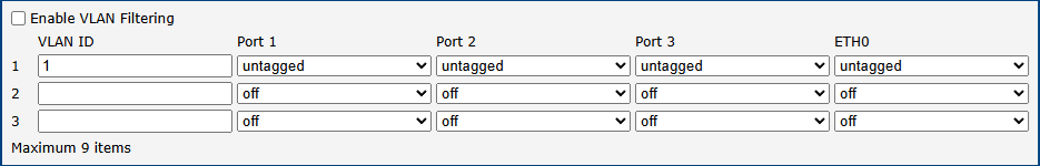

Virtual LAN (VLAN) filtering allows you to partition a single physical Ethernet switch into multiple, isolated logical networks. Each VLAN is identified by a unique VLAN ID, and traffic is strictly forwarded only between ports assigned to the same VLAN. This provides enhanced network segmentation and security. Individual ports can be configured as either access ports, which connect end devices to a single VLAN, or trunk ports, which carry traffic for multiple VLANs to other network devices.
The VLAN filtering interface is located on the Ethernet → ETH0 configuration page. The figure below shows the default configuration table for a three-port ETH0 switch, which allows up to nine VLANs to be configured.
By default, VLAN filtering is disabled, and all LAN ports function as a single, unsegmented switch: all enabled LAN ports forward traffic between each other without restriction, the internal eth0 interface receives all traffic from all connected ports, and VLAN-tagged frames are forwarded transparently.
Terminology
| Term | Definition |
| VLAN ID | A number (1–4094) that uniquely identifies a VLAN. |
| Access Port | A port that carries traffic for a single VLAN. It assigns all incoming untagged frames to its Port VLAN ID (PVID) and transmits all outgoing frames as untagged. |
| Trunk Port | A port that carries traffic for multiple tagged VLANs. It can also carry one untagged VLAN, known as the Native VLAN. |
| ETH0 | The router's internal switch interface. VLANs configured on top of eth0 (e.g., vlan1) act as independent interfaces. |
| PVID (Port VLAN ID) | The VLAN ID assigned to all untagged frames entering a port. |
Enabling VLAN Filtering
When Enable VLAN Filtering is checked, the switch enforces VLAN rules. Each port, including the internal trunk port (eth0), can be assigned to a VLAN in one of three modes:
- Untagged — The port acts as an access port for the selected VLAN. Incoming untagged frames are assigned to this VLAN (its PVID); outgoing frames are transmitted untagged.
- Tagged — The port acts as a trunk port for the selected VLAN. It accepts and transmits frames with VLAN tags intact.
- Off — The port is not a member of this VLAN and will not forward its traffic.
How It Works
- Untagged VLAN on
eth0— This defines the Native VLAN. Untagged traffic on the trunk is delivered to the baseeth0interface. - Tagged VLAN on
eth0— Tagged traffic is delivered to the corresponding VLAN sub-interface (e.g., VLAN 100 →vlan1). - Access Ports (Untagged) — A port can only have one untagged VLAN (its PVID). It handles traffic for non-VLAN-aware devices.
- Trunk Ports (Tagged) — A port can forward multiple tagged VLANs to other VLAN-aware devices and can also handle one Native VLAN (untagged).
Info
A port can have only one untagged VLAN (PVID). This ensures all incoming untagged frames are mapped to a single VLAN and is enforced by the GUI.
Caution
If you manage the router via its eth0 interface, always keep the management port configured as Untagged for the native VLAN to avoid losing access.
Warning
Removing a VLAN ID from the filtering table disables that VLAN across the entire switch.

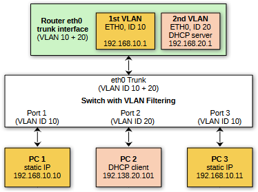

Example 1: Simple VLAN Separation
The following diagram shows a simple VLAN configuration on a three-port switch.
- PC1 and PC3 can communicate, as they share VLAN 10, and are isolated from PC2 (VLAN 20).
- The router can provide inter-VLAN routing if Layer 3 interfaces are configured for both VLANs.
| VLAN ID | Port 1 | Port 2 | Port 3 | eth0 (trunk) |
| 10 | untagged | off | untagged | tagged |
| 20 | off | untagged | off | tagged |
VLAN filtering for simple separation

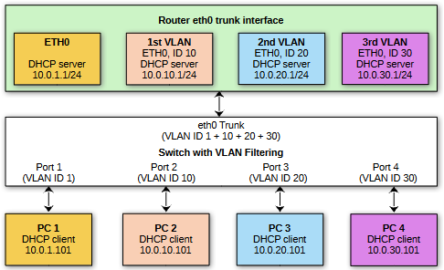

Example 2: Different Subnet on Each Port
This example shows how to create a separate network for each physical port of a four-port switch.
- Each LAN port provides a different IP subnet and DHCP pool.
- Devices connected to different ports are isolated at Layer 2.
- The router provides inter-VLAN routing and firewalling.
Layer 3 configuration — the first subnet (Native VLAN 1) is configured on the Ethernet → ETH0 page; the other three are configured on the 1st/2nd/3rd VLAN pages:
| VLAN ID | Router Interface | IP Address | DHCP Pool |
| 1 | eth0 | 10.0.1.1/24 | 10.0.1.100–10.0.1.200 |
| 10 | vlan1 | 10.0.10.1/24 | 10.0.10.100–10.0.10.200 |
| 20 | vlan2 | 10.0.20.1/24 | 10.0.20.100–10.0.20.200 |
| 30 | vlan3 | 10.0.30.1/24 | 10.0.30.100–10.0.30.200 |
Switch VLAN filtering configuration:
| VLAN ID | Port 1 | Port 2 | Port 3 | Port 4 | eth0 (trunk) |
| 1 | untagged | off | off | off | untagged |
| 10 | off | untagged | off | off | tagged |
| 20 | off | off | untagged | off | tagged |
| 30 | off | off | off | untagged | tagged |

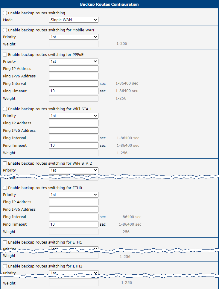

Backup Routes
The Backup Routes feature provides a mechanism for managing WAN connectivity, enabling automatic failover and load balancing across multiple Internet sources. The configuration is managed on the Configuration → Backup Routes page.
You can choose to let the router manage WAN connections automatically using its default priorities, or customize the behavior to meet specific network requirements.
Warning
- Some WAN interfaces (e.g., Wi-Fi, secondary Ethernet ports) may not be available on all router models.
- When using default priorities, an Ethernet interface will not be considered a valid WAN connection unless it has a static IP address configured or its DHCP client is enabled.
- In default priority mode, merely unplugging an Ethernet cable will not trigger a failover. The interface must be administratively down or fail to obtain an IP address.
Default Failover
If the Enable backup routes switching option is unchecked, the router uses a predefined, internal priority list to select the active WAN interface. The default interface priority is as follows:
- Mobile WAN (
usb0orusb1) - PPPoE (
pppoe0) - Wi-Fi STA (
wlan0) - ETH1 (
eth1) - ETH2 (
eth2) - ETH0 (
eth0)
Based on this order, the router will only use the ETH1 interface if the Mobile WAN, PPPoE, and Wi-Fi connections are all unavailable. Note that a LAN interface (like ETH0) can become a WAN interface under certain conditions, which may have security implications. Ensure your firewall and NAT rules are configured accordingly.
Customized Backup Routes
To gain full control over failover and load balancing, check the Enable backup routes switching box. This allows you to define interface priorities, connection checking parameters, and select one of three operational modes.
Operational Modes
| Mode | Selects the operational mode for managing WAN interfaces: • Single WAN: Only one WAN interface is active at a time. If the primary interface fails, the router switches to the next available interface by priority. The router is accessible from outside only on the active interface. • Multiple WANs: Same as Single WAN, with one difference: the router is accessible from outside on all enabled WAN interfaces simultaneously. • Load Balancing: Traffic is distributed across multiple WAN interfaces simultaneously. Assign a Weight to each interface to control its share of traffic streams. |
Interface Configuration
For each interface to include in the backup system, check its Enable backup routes switching box and configure the following parameters.
| Priority | Sets the priority of the interface (1st is highest). The router always uses the highest-priority active interface. |
| Ping IP Address | The destination IPv4 address or domain name for ICMP echo requests used to verify connection health. |
| Ping IPv6 Address | The destination IPv6 address or domain name for ICMP echo requests. |
| Ping Interval | The time in seconds between each ping test. |
| Ping Timeout | The time in seconds to wait for a response before considering a ping test failed. |
| Weight | (Load Balancing mode only) A value from 1 to 256 that determines the traffic ratio for this interface. For example, if two interfaces have weights of 4 and 1, they will handle approximately 80% and 20% of traffic streams, respectively. |
Warning
- Load Balancing: The traffic distribution is based on data streams, not total bandwidth. The actual data volume may not perfectly match the weight ratio, especially with a small number of concurrent connections.
- Mobile WAN: To use a cellular connection in a custom backup scenario, set Check Connection to enabled + bind on the Mobile WAN configuration page.
Backup Routes Examples
Example 1: Default Settings
If no settings are configured on the Backup Routes page, the system operates with the default priorities. This provides a simple, automatic failover mechanism.
Note: Assume all affected interfaces are correctly configured and activated on their configuration pages.
Example 2: Default Route Switching
This example shows how the default system handles a primary interface failure. If the highest-priority interface (Mobile WAN) becomes unavailable, the router automatically switches to the next interface in the default priority list (PPPoE).
Example 3: Custom Backup Routes
This example demonstrates a custom failover configuration using the Mobile WAN, PPPoE, and ETH1 interfaces. The Mobile WAN is set as the highest priority, followed by PPPoE, and finally ETH1. The connection status of the PPPoE tunnel is monitored by pinging 172.16.1.1.
In Single WAN mode, if the Mobile WAN connection fails, the router fails over to the PPPoE tunnel.
In Multiple WANs mode, the router is accessible via all three interfaces simultaneously, even though only one is used for outbound traffic at a time.
Example 4: Load Balancing Mode
This example shows a load balancing configuration between the Mobile WAN and a PPPoE interface. The weights are set to 4 and 1, respectively, meaning the Mobile WAN will handle approximately 80% of traffic streams and the PPPoE interface 20%.
Example 5: No WAN Routes
If Backup Routes is enabled but no interfaces are selected for WAN routing, the router has no dedicated WAN connection and functions as a LAN router. The Mobile WAN interface will not be used, even if connected to a cellular network.

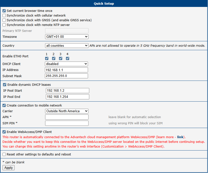

Quick Setup
The Quick Setup page provides a streamlined, single-page interface that gathers all of the most critical settings for the initial configuration of the router. This page is automatically displayed upon the first login to a new or factory-reset device, but it can also be accessed manually at any time via Configuration → Quick Setup.
This wizard conveniently consolidates essential settings from various sections of the web interface, allowing you to configure time, LAN, and mobile network settings from a single page.
Time and Region
For a complete overview of these settings, refer to NTP and WiFi Country. To set the date and time manually, see the Set Date and Time administration page.
| Set current browser time once | A one-time action that sets the router's system time to match the time of your web browser. |
| Synchronize clock with... | Selects the method for automatic time synchronization. Note that synchronization via GNSS is only available on router models equipped with a GNSS module. |
| Primary NTP Server | The address of the NTP server to use when Synchronize clock with remote NTP server is selected. |
| Timezone | Sets the local timezone for the router. |
| Country | For models equipped with Wi-Fi, this setting configures the regulatory domain. Select the country of operation to ensure compliance with local radio frequency regulations, as this affects which Wi-Fi channels are available. |
LAN Port and DHCP Server
The full configuration options for the LAN interface are described in Ethernet.
| Enable ETH0 Port | Allows each physical port on ETH0 to be enabled or disabled individually. |
| DHCP Client | If enabled, the router's LAN port requests an IP address from another DHCP server on the network. |
| IP Address | The static IPv4 address assigned to the router's primary LAN interface. |
| Subnet Mask | The subnet mask for the primary LAN interface. |
| Enable dynamic DHCP leases | Enables the router's built-in DHCP server, which automatically assigns IPv4 addresses to client devices on the LAN. |
| IP Pool Start | The starting address of the IP range that the DHCP server leases to clients. |
| IP Pool End | The ending address of the IP range that the DHCP server leases to clients. |
Mobile Network
Info
This section is only available on cellular router models.
The complete configuration for the mobile network is available in Mobile WAN.
| Create connection to mobile network | When checked, the router automatically attempts to connect to the mobile network after booting. |
| Carrier | Allows the selection of a pre-defined profile for a specific mobile carrier (e.g., for North American operators). |
| APN | The Access Point Name for your mobile network data plan. In many cases, this can be left blank to allow for automatic selection by the carrier. |
| SIM PIN | The PIN for your SIM card. Entering an incorrect PIN multiple times may permanently block the SIM card. |
System and Service Settings
| Enable WebAccess/DMP Client | Enables or disables the client for the WebAccess/DMP remote management platform. For complete details, see Remote Management Platform. |
| Reset other settings to defaults and reboot | If checked, any settings not present on this Quick Setup page are reset to their factory defaults when the new configuration is applied. |
