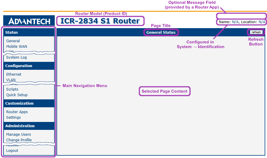

- The router's Name and Location fields in SNMP settings control the display in the interface's upper-right corner — detailed in SNMP.

Advantech routers feature a secure web-based configuration interface accessible via HTTPS. This interface provides real-time network statistics, signal strength monitoring, system log access, and comprehensive device management capabilities. The web interface enforces TLS 1.2 or higher for all connections, with certificate validation required to prevent man-in-the-middle attacks.
