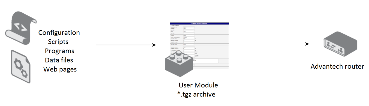

What are Router Apps
Router App (formerly known as User Module) refers to a software application specifically designed to run on Advantech routers. These applications allow users to extend the router's built-in features, customize its behavior, and add new features tailored to specific needs. This guide describes the structure, development process, and technical considerations necessary for creating your own Router Apps that integrate correctly with the Advantech router environment.
Advantech routers run a Linux-based operating system (ICR-OS). While using a Linux environment for Router App development is recommended for ease of use with toolchains and testing, it is not strictly required. Router Apps can be developed using languages such as C, C++, or Python, provided they can be compiled or executed within the router's environment. This guide focuses on the general structure, scripting conventions, configuration management, and system integration rules applicable across different development approaches.

Application Packaging
Router App Archive Format
To upload a Router App into an Advantech router, it must be packaged as a *.tgz archive file (a TAR archive compressed with Gzip). This archive must contain a single top-level directory, refer to Directory Structures for Applications.
The name of this single top-level directory inside the archive must be identical to the base name of the *.tgz archive file itself (excluding the platform suffix and .tgz extension). This base name is restricted to a maximum of 24 characters and can only contain alphanumeric characters ('a'-'z', 'A'-'Z', '0'-'9') and the underscore ('_'). Using spaces or other special characters in the base name, or in any subdirectory or file names within the archive, is strongly discouraged.
The name of a Router App archive has this syntax: <RAname>.<platform>.tgz, e.g. mymodule.v4.tgz.
