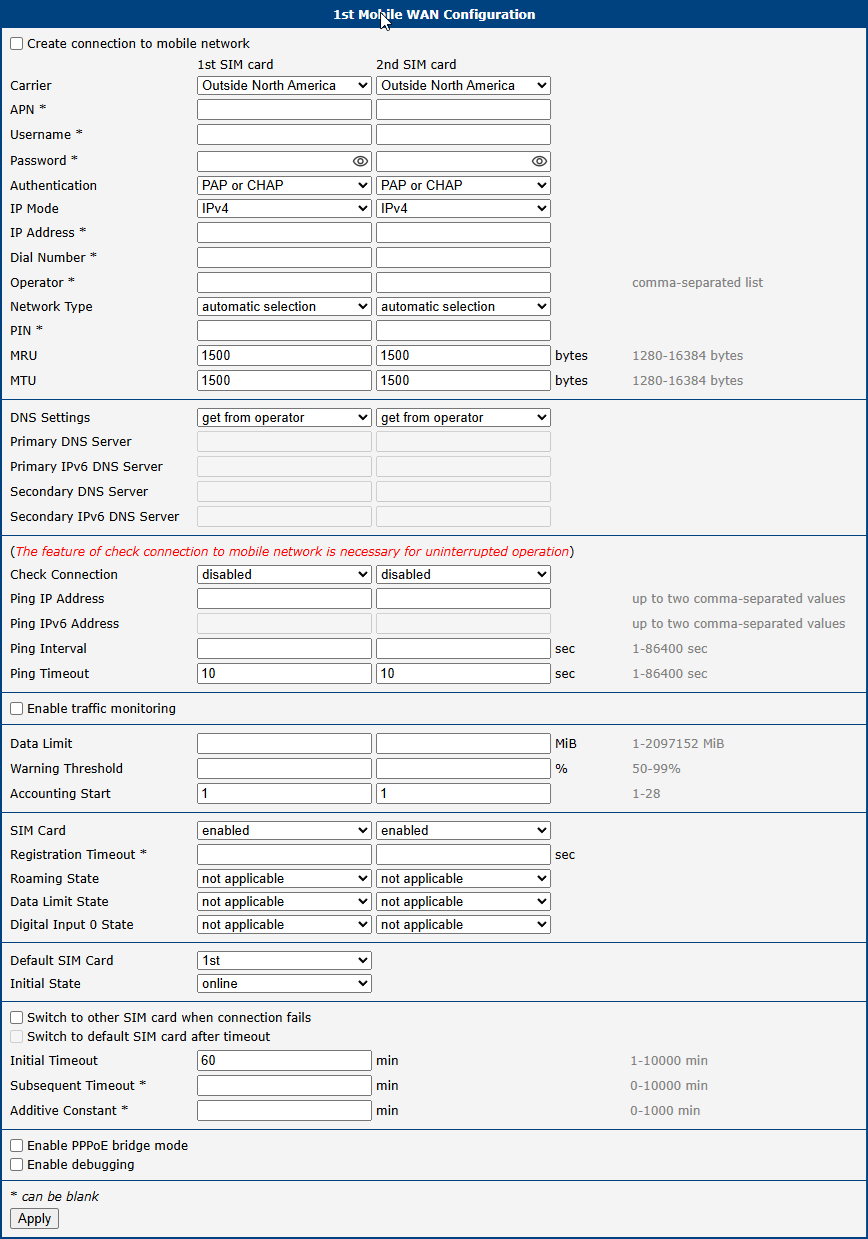

Mobile WAN
Select the Mobile WAN item in the Configuration menu to open the cellular network configuration page.
Connection to Mobile Network
Info
- Starting with firmware version 6.6.0, PLMN whitelisting is now an integrated firmware feature, available in the Operator field. This native functionality replaces the legacy PLMN Whitelist Router App.
- To avoid potential conflicts, disable or uninstall the legacy Router App before using the integrated PLMN whitelisting feature.
If the Create connection to mobile network checkbox is checked, the router will automatically attempt to establish a connection after booting up. You can specify the following parameters for each SIM card separately.
| Item | Description |
| Carrier | Allows for manual or automatic selection of a mobile network carrier. This is primarily available for global or NAM (North American) certified models. • For non-NAM or global models, the Outside North America option restricts connections to non-NAM operators. • For NAM-certified models, choices typically include: ◦ North America, Autoselect: Automatically detects and connects to a suitable NAM operator. ◦ North America, Generic: Enables a generic, PTCRB-compliant configuration. ◦ Manual selection of specific operators like AT&T, Rogers, T-Mobile, or Verizon. |
| APN | The Access Point Name (APN) of the mobile network. |
| Username | The username for logging into the mobile network. |
| Password | The password for logging into the mobile network. |
| Authentication | The authentication protocol used by the network. Both Username and Password must be specified for this setting to apply. • PAP or CHAP: The router automatically selects the authentication method. • PAP: Forces PAP authentication. • CHAP: Forces CHAP authentication. |
| IP Mode | The version of the IP protocol to be used. • IPv4: Use only the IPv4 protocol (default). • IPv6: Use only the IPv6 protocol. • IPv4/IPv6: Enable an independent dual stack for both IPv4 and IPv6. |
| IP Address | The IP address of the SIM card (for IPv4 and IPv4/IPv6 modes only). Enter this manually only if the carrier has assigned a static IP address. |
| Dial Number | The number the router dials for a CSD connection. The default is *99***1#. |
| Operator | Specifies the preferred mobile network operator using the carrier’s PLMN code. The behavior depends on the input: • Empty field: The router operates in automatic mode, connecting to any available network. • Single PLMN: The router locks to the specified operator and connects only to that network. • Comma-separated list (whitelist): By providing two or more PLMNs, you create a whitelist of allowed operators. Upon connecting or if the current network is not on the list, the router will perform a network scan (which may take up to two minutes) and connect to the first operator from your list that it finds available. • Whitelist with automatic fallback: Prefix the list with 0, (e.g., 0,23001,90001) to first connect automatically and then switch to a whitelisted operator if needed. |
| Network Type | Specifies the type of protocol used in the mobile network: Automatic selection, LTE, UMTS/HSPA, GPRS/EDGE. |
| PIN | The Personal Identification Number used to unlock the SIM card. Use this only if required by the SIM card. The card will be blocked after several failed attempts. |
| MRU | Maximum Receive Unit: the maximum packet size the router can receive. Default is 1500 B. Incorrect values may cause data reception errors. Minimum: 128 B for IPv4, 1280 B for IPv6. |

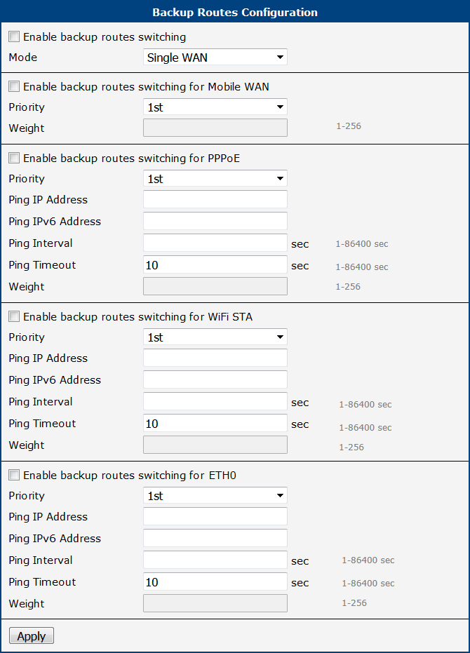

To gain full control over failover and load balancing, check the Enable backup routes switching box. This allows you to define interface priorities, connection checking parameters, and select one of three operational modes.
Operational Modes
| Mode | Selects the operational mode for managing WAN interfaces: • Single WAN: Only one WAN interface is active at a time. If the primary interface fails, the router switches to the next available interface by priority. The router is accessible from outside only on the active interface. • Multiple WANs: Same as Single WAN, with one difference: the router is accessible from outside on all enabled WAN interfaces simultaneously. • Load Balancing: Traffic is distributed across multiple WAN interfaces simultaneously. Assign a Weight to each interface to control its share of traffic streams. |
Interface Configuration
For each interface to include in the backup system, check its Enable backup routes switching box and configure the following parameters.
| Priority | Sets the priority of the interface (1st is highest). The router always uses the highest-priority active interface. |
| Ping IP Address | The destination IPv4 address or domain name for ICMP echo requests used to verify connection health. |
| Ping IPv6 Address | The destination IPv6 address or domain name for ICMP echo requests. |
| Ping Interval | The time in seconds between each ping test. |
| Ping Timeout | The time in seconds to wait for a response before considering a ping test failed. |
| Weight | (Load Balancing mode only) A value from 1 to 256 that determines the traffic ratio for this interface. For example, if two interfaces have weights of 4 and 1, they will handle approximately 80% and 20% of traffic streams, respectively. |
Warning
- Load Balancing: The traffic distribution is based on data streams, not total bandwidth. The actual data volume may not perfectly match the weight ratio, especially with a small number of concurrent connections.
- Mobile WAN: To use a cellular connection in a custom backup scenario, set Check Connection to enabled + bind on the Mobile WAN configuration page.
Backup Routes Examples
Example 1: Default Settings
If no settings are configured on the Backup Routes page, the system operates with the default priorities. This provides a simple, automatic failover mechanism.
Note: Assume all affected interfaces are correctly configured and activated on their configuration pages.
Example 2: Default Route Switching
This example shows how the default system handles a primary interface failure. If the highest-priority interface (Mobile WAN) becomes unavailable, the router automatically switches to the next interface in the default priority list (PPPoE).
Example 3: Custom Backup Routes
This example demonstrates a custom failover configuration using the Mobile WAN, PPPoE, and ETH1 interfaces. The Mobile WAN is set as the highest priority, followed by PPPoE, and finally ETH1. The connection status of the PPPoE tunnel is monitored by pinging 172.16.1.1.
In Single WAN mode, if the Mobile WAN connection fails, the router fails over to the PPPoE tunnel.
In Multiple WANs mode, the router is accessible via all three interfaces simultaneously, even though only one is used for outbound traffic at a time.
Example 4: Load Balancing Mode
This example shows a load balancing configuration between the Mobile WAN and a PPPoE interface. The weights are set to 4 and 1, respectively, meaning the Mobile WAN will handle approximately 80% of traffic streams and the PPPoE interface 20%.
Example 5: No WAN Routes
If Backup Routes is enabled but no interfaces are selected for WAN routing, the router has no dedicated WAN connection and functions as a LAN router. The Mobile WAN interface will not be used, even if connected to a cellular network.

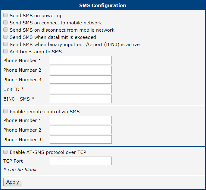

SMS
Open the SMS page in the Services submenu of the Configuration section of the main menu. The router can automatically send SMS messages to a cell phone or SMS message server when certain events occur. The form allows you to select which events generate an SMS message.
| Send SMS on power up | Activates/deactivates the sending of an SMS message automatically on power up. |
| Send SMS on connect to mobile network | Activates/deactivates the sending of an SMS message automatically when the router connects to a mobile network. |
| Send SMS on disconnect from mobile network | Activates/deactivates the sending of an SMS message automatically when the router disconnects from a mobile network. |
| Send SMS when datalimit is exceeded | Activates/deactivates the sending of an SMS message automatically when the data limit is exceeded. |
| Send SMS when binary input on I/O port (BIN0) is active | Automatic sending of an SMS message after the binary input on the I/O port (BIN0) is active. The text of the message is the BIN0 parameter. |
| Add timestamp to SMS | Activates/deactivates the adding of a timestamp to the SMS messages. This timestamp has a fixed format YYYY-MM-DD hh:mm:ss. |
| Phone Number 1 | Specifies the first phone number to which the router sends the generated SMS. |
| Phone Number 2 | Specifies the second phone number to which the router sends the generated SMS. |
| Phone Number 3 | Specifies the third phone number to which the router sends the generated SMS. |
| Unit ID | The name of the router. The router sends the name in the SMS. |
| BIN0 - SMS | Text of the SMS message when the first binary input is activated. |
| BIN1 - SMS | Text of the SMS message when the second binary input is activated. |

Mobile Network
Info
This section is only available on cellular router models.
The complete configuration for the mobile network is available in Mobile WAN.
| Create connection to mobile network | When checked, the router automatically attempts to connect to the mobile network after booting. |
| Carrier | Allows the selection of a pre-defined profile for a specific mobile carrier (e.g., for North American operators). |
| APN | The Access Point Name for your mobile network data plan. In many cases, this can be left blank to allow for automatic selection by the carrier. |
| SIM PIN | The PIN for your SIM card. Entering an incorrect PIN multiple times may permanently block the SIM card. |
