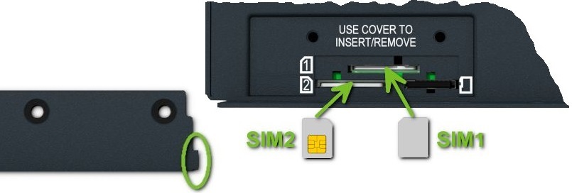

SIM Card Slots
The router has two SIM card slots located on the rear panel under a metal cover. To communicate over a cellular network, insert an activated, data-provisioned SIM card into a SIM card slot. You can install two SIM cards simultaneously to use the SIM switching feature. You can configure each SIM card with a different APN (Access Point Name).
Tips
SIM card type: Mini SIM (2FF) — 25.0 × 15.0 × 0.76 mm.
Changing the SIM Card
- Always disconnect the router from the power supply before handling the SIM card.
- Unscrew the two screws on the rear panel SIM card cover and remove the cover.
- To remove an inserted SIM card, use the protrusion on the SIM card cover to gently press the card into its slot until you hear a click. Release the pressure; the card will pop out of its slot.
- To insert a SIM card, push the card into the slot until it clicks into place. Optionally, use the protrusion on the SIM card cover to assist with insertion.
- Replace the cover and tighten the two screws.
If the SIM card requires a PIN, enter it in the router's web interface under Administration → Unlock SIM Card.

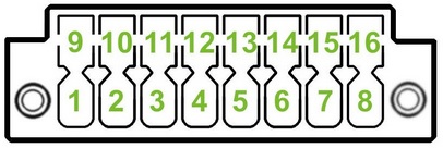

The digital I/O and two independently switchable serial interfaces share a single 16-pin terminal block panel socket. Neither the serial interfaces nor the I/O interface is electrically isolated from the router.

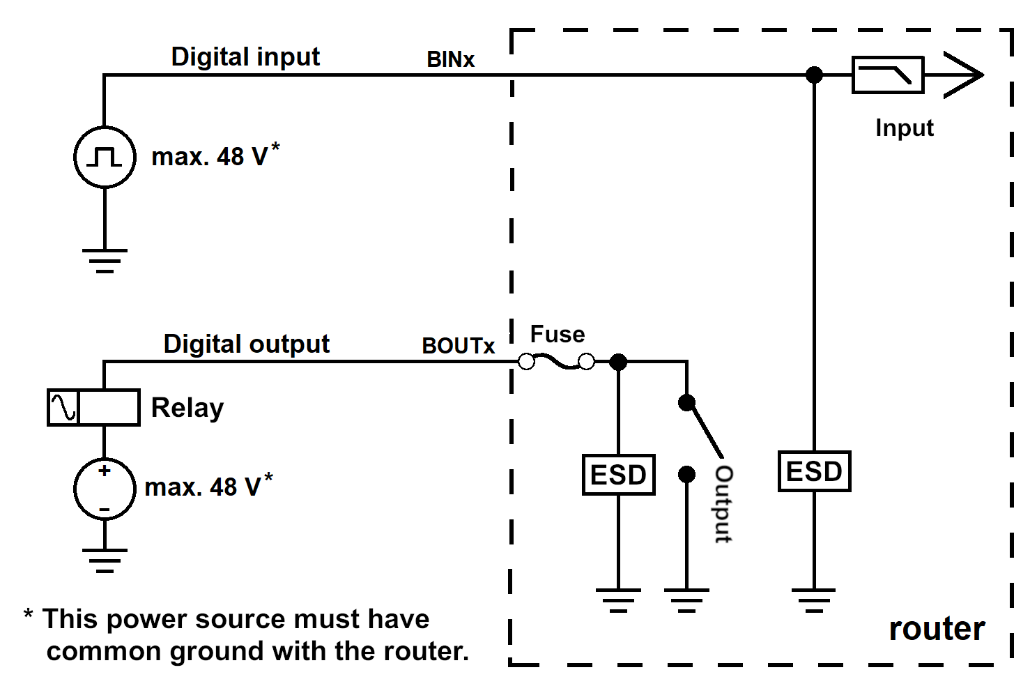

I/O Port
The I/O interface provides four digital inputs and two digital outputs.
| Pin | Signal | Description |
| 14 | BIN0 | First digital input |
| 6 | BIN1 | Second digital input |
| 15 | BIN2 | Third digital input |
| 7 | BIN3 | Fourth digital input |
| 16 | BOUT0 | First digital output |
| 8 | BOUT1 | Second digital output |
| 5, 13 | GND | Ground (common negative pole) |

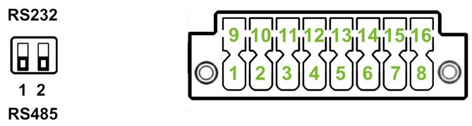

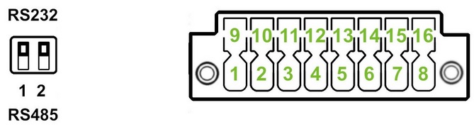

Serial Interfaces
Warning
Switch the serial interface only when the router is powered off.
Both serial interfaces connect to the 16-pin terminal block socket and can be independently switched between RS-232 and RS-485 using the DIP switch located beneath the SIM card cover. Setting a DIP switch to the up position configures the corresponding interface as RS-232; setting it to the down position configures it as RS-485.
RS-232 Mode:
| 1 | RXD | Received Data (interface 1) |
| 2 | TXD | Transmit Data (interface 1) |
| 3 | RTS | Request to Send (interface 1) |
| 4 | CTS | Clear to Send (interface 1) |
| 5 | GND | Ground (interface 1) |
| 9 | RXD | Received Data (interface 2) |
| 10 | TXD | Transmit Data (interface 2) |
| 11 | RTS | Request to Send (interface 2) |
| 12 | CTS | Clear to Send (interface 2) |
| 13 | GND | Ground (interface 2) |
RS-485 Mode:
| 2 | D (+) | In/Out (interface 1) |
| 1 | D (−) | In/Out (interface 1) |
| 10 | D (+) | In/Out (interface 2) |
| 9 | D (−) | In/Out (interface 2) |

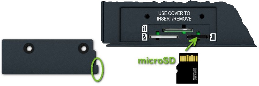

microSD Card
The microSD card reader is located under the SIM cover on the router.
| Specification | Value |
| Supported technologies | SD, SDHC, and SDXC |
| SDHC capacity | Up to 32 GB |
| SDXC capacity | 32 GB to 512 GB |
| Supported filesystems | vfat, exFAT, ext2, ext3, and ext4 |
Inserting the microSD Card
- To remove an inserted microSD card, use the flat end of a spudger or your fingernail. Press the card slightly into its slot until you hear a click. Release the card; it will pop out of its slot.
- To insert a microSD card, push the card into the slot with the correct orientation as shown until it clicks into place.
Mounting the microSD Card
To access the microSD card in the router's system, mount it:
- Run
dmesgto view recently connected devices and identify the microSD card entry, for example:mmcblk0: p1. - Mount the card to the
/mntdirectory:
mount /dev/mmcblk0p1 /mntTips
For commands to create, mount, check, and unmount a filesystem on a microSD card, refer to the Ext4 Filesystem Utilities router app documentation.
