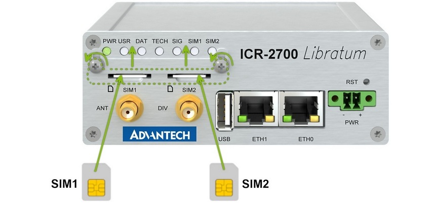

SIM Card Slots
The router has two SIM card slots located beneath a metal cover. To communicate over a cellular network, insert an activated, data-provisioned SIM card into a SIM card slot. You can install two SIM cards simultaneously to use the SIM switching feature. You can configure each SIM card with a different APN (Access Point Name).
Tips
SIM card type: Mini SIM (2FF) — 25.0 × 15.0 × 0.76 mm.
Changing the SIM Card
- Always disconnect the router from the power supply before handling the SIM card.
- Release the two screws on the SIM card cover and swipe the cover to the side to remove it.
- To remove an inserted SIM card, use the flat end of a spudger or your fingernail. Press the card slightly into its slot until you hear a click. Release the card; it will pop out of its slot.
- To insert a SIM card, push the card into the slot until it clicks into place.
- Replace the cover and tighten the two screws.
If the SIM card requires a PIN, enter it in the router's web interface under Administration → Unlock SIM Card.

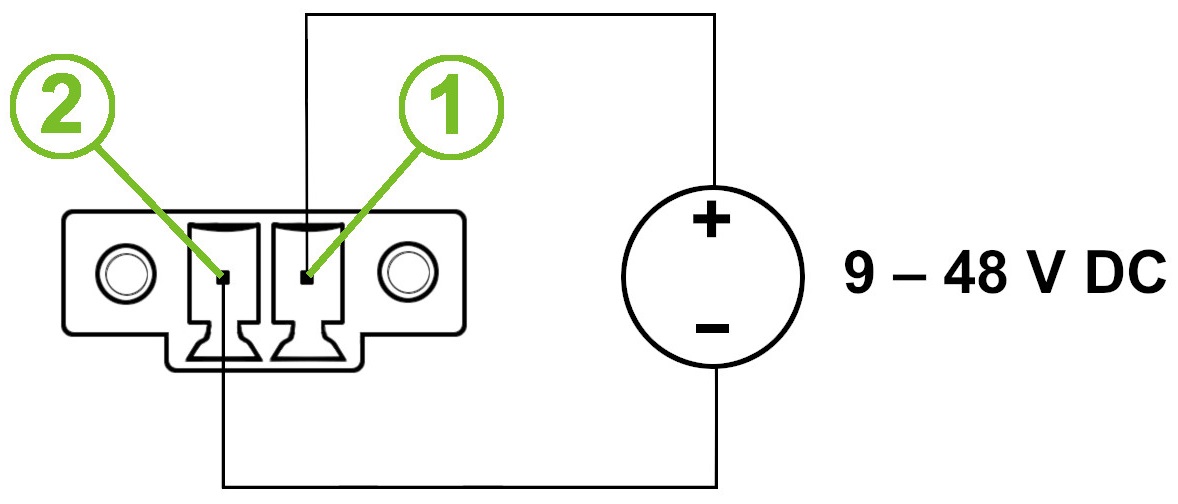

A two-pin terminal connector (pitch 3.5 mm) is used to power the router. The matching connector is included as a standard accessory.
| Pin | Signal | Description |
| 1 | PWR(+) | Positive pole of DC supply voltage (+9 to +48 V DC) |
| 2 | PWR(−) | Negative pole of DC supply voltage |
The required supply voltage is +9 to +48 V DC. The router has built-in protection against reversed polarity without signaling.

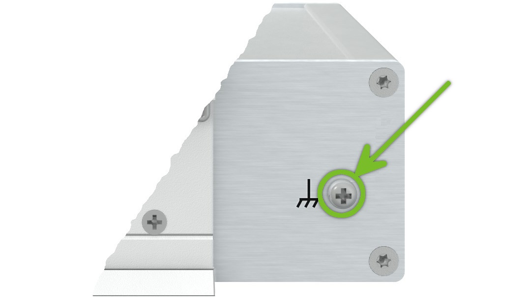

All metal parts, including the chassis, are connected to the negative pole of the power supply (common pole). To protect the router, ground it using the grounding screw as shown below. The maximum tightening torque for the grounding screw is 1 Nm.

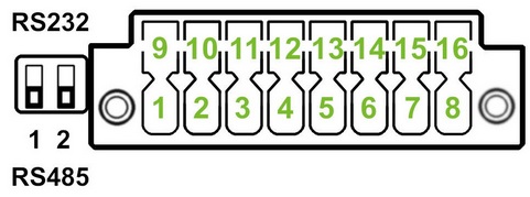

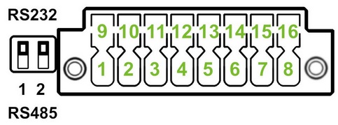

Both serial interfaces connect to the 16-pin terminal block socket and can be independently switched between RS-232 and RS-485 using the DIP switch located on the left panel. Setting a DIP switch to the up position configures the corresponding interface as RS-232; setting it to the down position configures it as RS-485.
RS-232 Mode:
| 1 | RXD | Received Data (interface 1) |
| 2 | TXD | Transmit Data (interface 1) |
| 3 | RTS | Request to Send (interface 1) |
| 4 | CTS | Clear to Send (interface 1) |
| 5 | GND | Ground (interface 1) |
| 9 | RXD | Received Data (interface 2) |
| 10 | TXD | Transmit Data (interface 2) |
| 11 | RTS | Request to Send (interface 2) |
| 12 | CTS | Clear to Send (interface 2) |
| 13 | GND | Ground (interface 2) |
RS-485 Mode:
| 2 | D (+) | In/Out (interface 1) |
| 1 | D (−) | In/Out (interface 1) |
| 10 | D (+) | In/Out (interface 2) |
| 9 | D (−) | In/Out (interface 2) |
