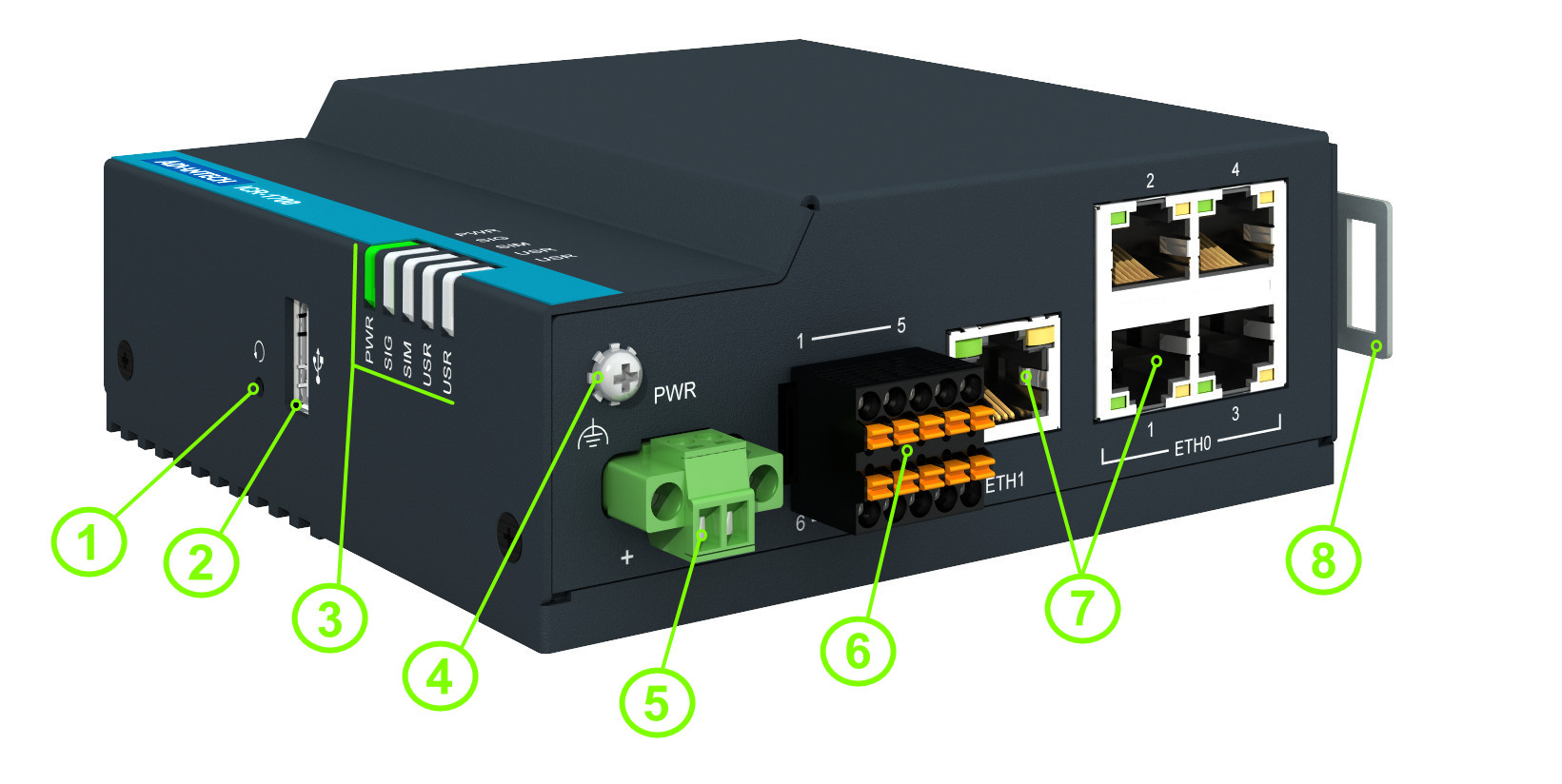

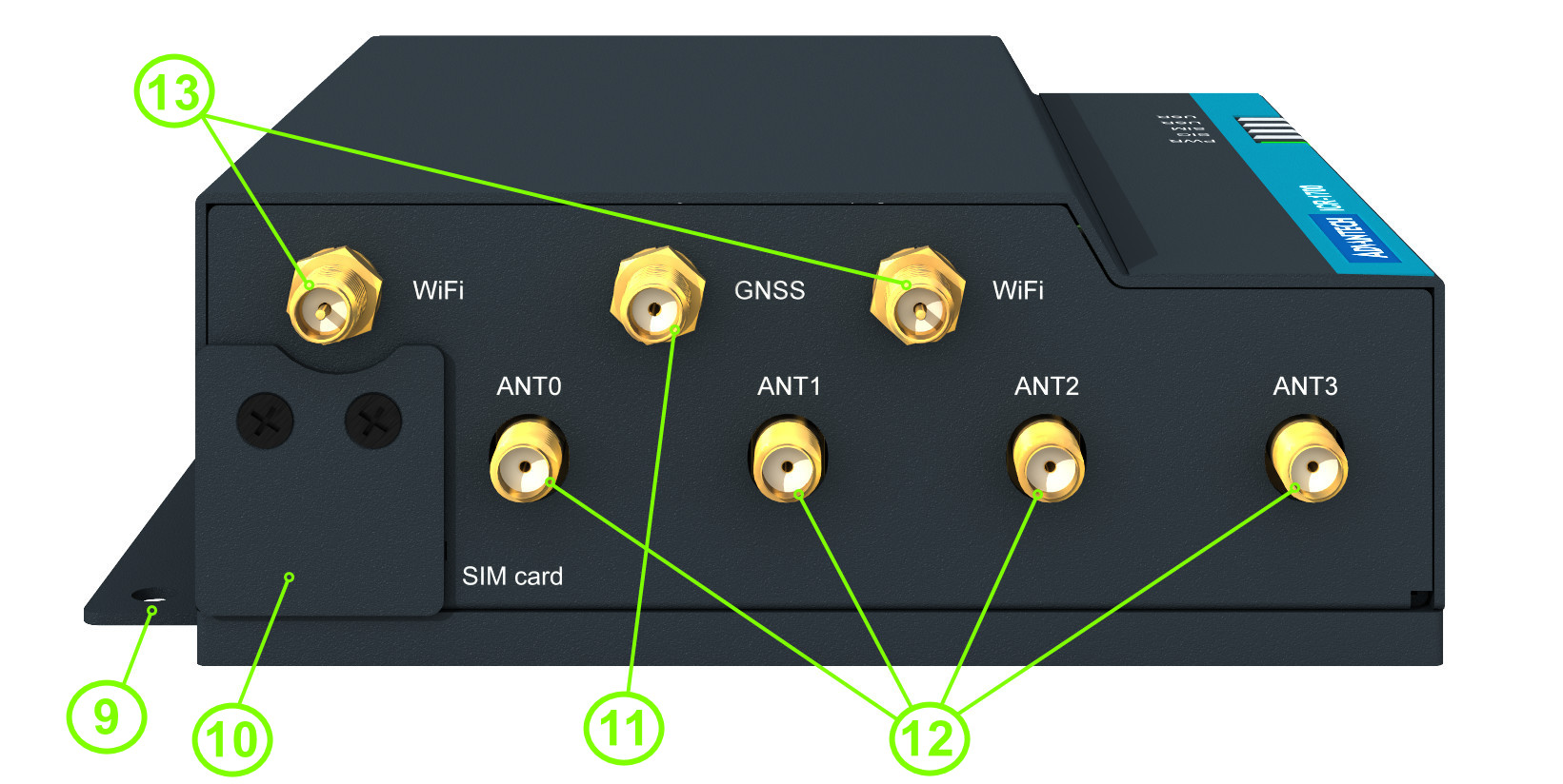

Hardware Components
The ICR-1700 series supports the hardware features illustrated in the image below (ICR-1745-EU shown). Refer to the Model Overview section for model-specific details.
| # | Caption | Type | Description |
| 1 | RST | — | Button to reboot the router or restore the defaults; see Reset. |
| 2 | USB | USB-A | USB 2.0 host port (ICR-1745-EU only); see USB Port. |
| 3 | LEDs | — | Status LED indicators; see LED Indicators. |
| 4 | GND Screw | M3 | Ensure proper grounding; see Power Supply. |
| 5 | PWR | 2-pin terminal | Power supply socket; see Power Supply. |
| 6 | Serial & I/O | 10-pin terminal | RS-232, RS-485, one digital input, and one digital output interfaces; see Serial Interfaces, I/O Port, and I/O Parameters. |
| 7 | ETH0, ETH1 | RJ45 | Gigabit Ethernet LAN interfaces — ETH0 is a four-port switch, ETH1 a separate port; see Ethernet Interfaces. |
| 8 | DIN Clip | — | DIN mounting clip, not included as a standard accessory (can be ordered optionally); see DIN Rail Mounting. |
| 9 | Wall Clip | — | Wall mounting clip, included as a standard accessory; see Wall Mounting. |
| 10 | SIM Slots | Micro SIM | Two Micro SIM card slots; see SIM Card Slots. |
| 11 | GNSS | SMA female | GNSS antenna connector (ICR-1745-EU only); see Antenna Connections and GNSS Parameters. |
| 12 | ANT0, ANT1, ANT2, ANT3 | SMA female | Cellular module antenna connectors; see Antenna Connections and Cellular Module Parameters. |
| 13 | WiFi1, WiFi2 | RP-SMA female | Connectors for the Wi-Fi antennas (W models); see Antenna Connections and Wi-Fi Parameters. |
