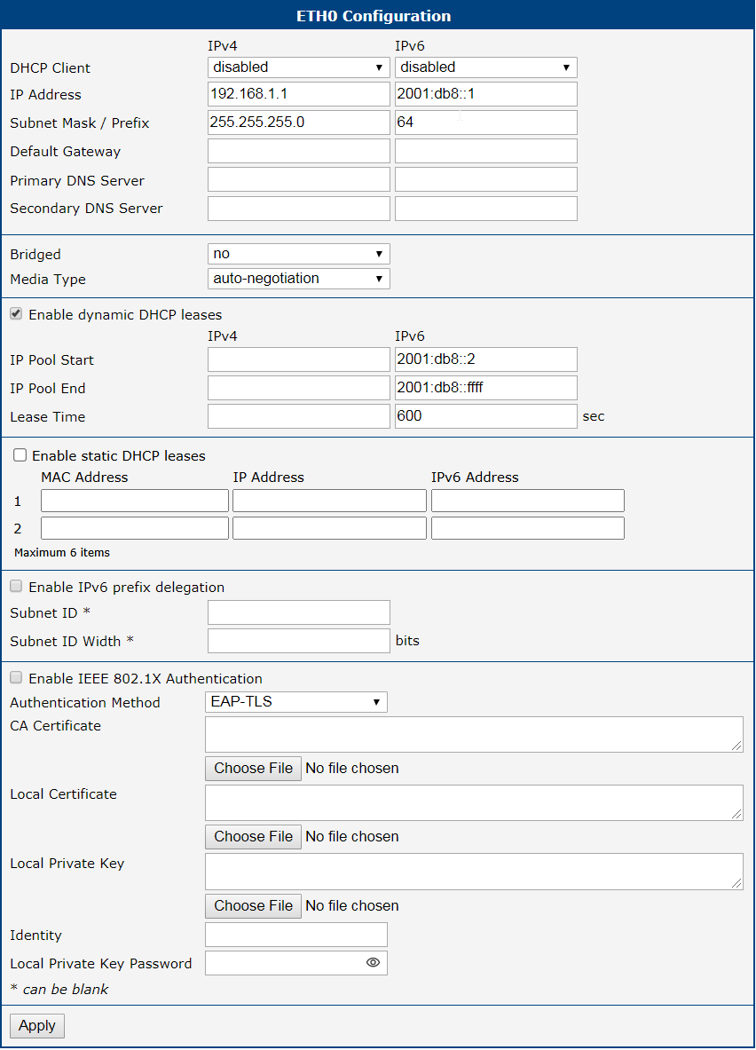

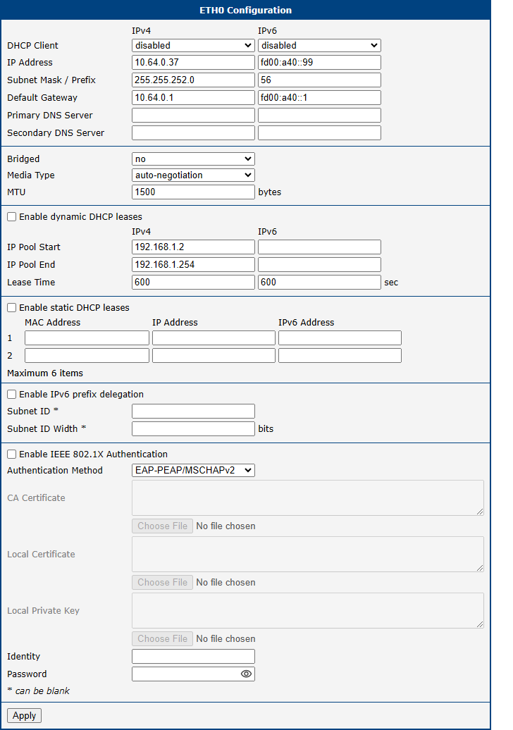

To enter the Local Area Network configuration, select the Ethernet menu item in the Configuration section. The Ethernet item will expand in the menu on the left, allowing you to choose the appropriate Ethernet interface to configure: ETH0 for the first Ethernet interface and ETH1 for the second Ethernet interface.
The LAN Configuration page is divided into IPv4 and IPv6 columns, as shown in Figure below. There is dual stack support for IPv4 and IPv6 protocols, meaning they can run concurrently. You can configure either one of them or both. If both IPv4 and IPv6 are configured, network devices will automatically select the communication protocol. The configuration items and differences between IPv6 and IPv4 are described in the tables below.
Since some models have the ETH0 interface as a switched Ethernet interface with three ports, there are three checkboxes on the page labeled Enable Port. These can be used to enable or disable individual ports. Unlike a single-port Ethernet interface, this configuration page also includes a section for VLAN filtering settings; for more information, see VLAN Filtering below.
| Item | Description |
| DHCP Client | Enables or disables the DHCP client function. If in the IPv6 column, the DHCPv6 client is enabled. The DHCPv6 client supports all three methods of obtaining an IPv6 address: SLAAC, stateless DHCPv6, and stateful DHCPv6. Options: • disabled: The router does not allow automatic allocation of an IP address from a DHCP server in the LAN network. • enabled: The router allows automatic allocation of an IP address from a DHCP server in the LAN network. |
| IP Address | A fixed IP address for the Ethernet interface. Use IPv4 notation in the IPv4 column and IPv6 notation in the IPv6 column. Shortened IPv6 notation is supported. |
| Subnet Mask / Prefix | Specifies the subnet mask for the IPv4 address. In the IPv6 column, fill in the prefix for the IPv6 address: a number in the range of 0 to 128. |
| Default Gateway | Specifies the IP address of the default gateway. If provided, every packet with a destination not found in the routing table is sent to this IP address. Use the correct IP address notation in both the IPv4 and IPv6 columns. |
| Primary DNS Server | Specifies the primary IP address of the DNS server. When the IP address is not found in the routing table, the router forwards the request to the DNS server specified here. Use the correct IP address notation in both the IPv4 and IPv6 columns. |
| Secondary DNS Server | Specifies the secondary IP address of the DNS server. |
The Default Gateway and DNS Server items are only used if the DHCP Client is set to disabled and if the ETH0 or ETH1 LAN is selected by the Backup Routes system as the default route.
The following three items (in the table below) are global for the configured Ethernet interface. Only one bridge can be active on the router at a time. The DHCP Client, IP Address, and Subnet Mask / Prefix parameters of only one of the interfaces are used for the bridge. The ETH0 LAN has higher priority when both interfaces (ETH0 and ETH1) are added to the bridge. Other interfaces can be added to or removed from an existing bridge at any time. The bridge can be created on demand for such interfaces, but not if it is configured by their respective parameters.
Warning
Under certain conditions, the ETH interface may operate as a WAN interface, and the rules defined in the Firewall settings will be applied to it. Details are described in Backup Routes and are demonstrated with examples provided there.
| Bridged | Activates or deactivates the bridging function on the router. • no: The bridging function is inactive (default). • yes: The bridging function is active. See the Bridge Notes below the table for further details. |
| Media Type | Specifies the type of duplex and speed used in the network. • Auto-negotiation: The router automatically sets the best speed and duplex mode of communication according to the network's possibilities. • 1000 Mbps Full Duplex: The router communicates at 1000 Mbps, in the full duplex mode. • 100 Mbps Full Duplex: The router communicates at 100 Mbps, in the full duplex mode. • 100 Mbps Half Duplex: The router communicates at 100 Mbps, in the half duplex mode. • 10 Mbps Full Duplex: The router communicates at 10 Mbps, in the full duplex mode. • 10 Mbps Half Duplex: The router communicates at 10 Mbps, in the half duplex mode. |
| MTU | Maximum Transmission Unit value. Default value is 1500 bytes. |
Bridge Notes
A bridge behaves like a network switch, forwarding packets between interfaces that are connected to it. The Advantech router supports creating a bridge network within Ethernet interfaces or between Ethernet interfaces and Wi-Fi Access Point (AP) interfaces. Once the bridge is configured and established, a new interface named br0 is created. This interface will appear in the Status → Network → Interfaces section.
If a bridge is configured on two Ethernet interfaces, the br0 interface will inherit the IP address of the Ethernet interface with the lower index. IP address and subnet configuration of the Ethernet interface with the higher index will be removed. This behavior is consistent regardless of the order in which the interfaces are configured.
To include a Wi-Fi AP interface in the bridge, at least one Ethernet interface must also be part of the bridge configuration. In this case, the IP address of the bridge interface br0 will again be determined by the Ethernet interface (or interfaces) with the lowest index.
DHCP Server
The DHCP server assigns the IP address, gateway IP address (IP address of the router) and IP address of the DNS server (IP address of the router) to the connected clients. If these values are filled in by the user in the configuration form, they will be preferred.
The DHCP server supports static and dynamic assignment of IP addresses. Dynamic DHCP assigns clients IP addresses from a defined address space. Static DHCP assigns IP addresses that correspond to the MAC addresses of connected clients.
Info
- If IPv6 column is filled in, the DHCPv6 server is used. DHCPv6 server offers stateful address configuration to connected clients. Only when the Subnet Prefix above is set to 64, the DHCPv6 server offers both: the stateful address configuration and SLAAC (Stateless Address Autoconfiguration).
- For DHCPv6 static address assignment to work, DHCPv6 client must use DUID-LL or DUID-LLT types that are derived from its MAC address.
Warning
Do not to overlap ranges of static allocated IP addresses with addresses allocated by the dynamic DHCP server. IP address conflicts and incorrect network function can occur if you overlap the ranges.
Configuration of Dynamic DHCP Server
| Enable dynamic DHCP leases | Select this option to enable a dynamic DHCP server. |
| IP Pool Start | Starting IP addresses allocated to the DHCP clients. Use proper notation in IPv4 and IPv6 column. |
| IP Pool End | End of IP addresses allocated to the DHCP clients. Use proper IP address notation in IPv4 and IPv6 column. |
| Lease time | Time in seconds that the IP address is reserved before it can be re-used. |
Configuration of Static DHCP Server
| Enable static DHCP leases | Select this option to enable a static DHCP server. You can define up to six rules. A new row for defining the next rule appears automatically after filling in the previous one. |
| MAC Address | MAC address of a DHCP client. |
| IPv4 Address | Assigned IPv4 address. Use proper notation. |
| IPv6 Address | Assigned IPv6 address. Use proper notation. |
IPv6 Prefix Delegation
Warning
This is an advanced configuration option. IPv6 prefix delegation works automatically with DHCPv6: use only if different configuration is desired and if you know the consequences.
If you want to override the automatic IPv6 prefix delegation, you can configure it in this form. You have to know your Subnet ID Width (part of IPv6 address), see the figure below for the calculation help: it is an example: 48 bits is Site Prefix, 16 bits is Subnet ID (Subnet ID Width) and 64 bits is Interface ID.
| Enable IPv6 prefix delegation | Enables prefix delegation configuration filled-in below. |
| Subnet ID | The decimal value of the Subnet ID of the Ethernet interface. Maximum value depends on the Subnet ID Width. |
| Subnet ID Width | The maximum Subnet ID Width depends on your Site Prefix: it is the remainder to 64 bits. |
802.1X Authentication with RADIUS Server
IEEE 802.1X is an IEEE standard for port-based Network Access Control (PNAC). It provides an authentication mechanism for devices connecting to a LAN or WLAN using "EAP over LAN" (EAPoL), which encapsulates the Extensible Authentication Protocol (EAP).
IEEE 802.1X authentication involves three parties: a supplicant, an authenticator, and an authentication server, illustrated in the figure below.
- The supplicant is a client device (e.g., a laptop) requesting network access.
- The authenticator is a network device (e.g., a switch or router) that controls network access and mediates communication with the authentication server.
- The authentication server (typically a RADIUS server) validates the supplicant's credentials and authorizes or denies access.
Info
Advantech routers can function as a supplicant or an authenticator, but not as an authentication server.
| Interface | Supplicant Role | Authenticator Role |
| LAN | As a built-in feature, configure LAN with 802.1X authentication. | While not a built-in feature, it can be facilitated by the 802.1X Authenticator Router App. |
| WiFi | In Station (STA) mode. | In Access Point (AP) mode. |
The 802.1X supplicant can be enabled in the section below. This requires configuring an identity and, for EAP-TLS, certificates.
| Enable IEEE 802.1X Authentication | Enables the 802.1X supplicant on this interface. |
| Authentication Method | Selects the authentication method (EAP-PEAP/MSCHAPv2 or EAP-TLS). |
| CA Certificate | Defines the CA certificate for the EAP-TLS protocol. |
| Local Certificate | Defines the local certificate for the EAP-TLS protocol. |
| Local Private Key | Defines the local private key for the EAP-TLS protocol. |
| Identity | The username (identity) for authentication. |
| Password | The password for authentication (used only for EAP-PEAP/MSCHAPv2). |
| Local Private Key Password | The password for the local private key (used only for EAP-TLS). |
LAN Configuration Examples

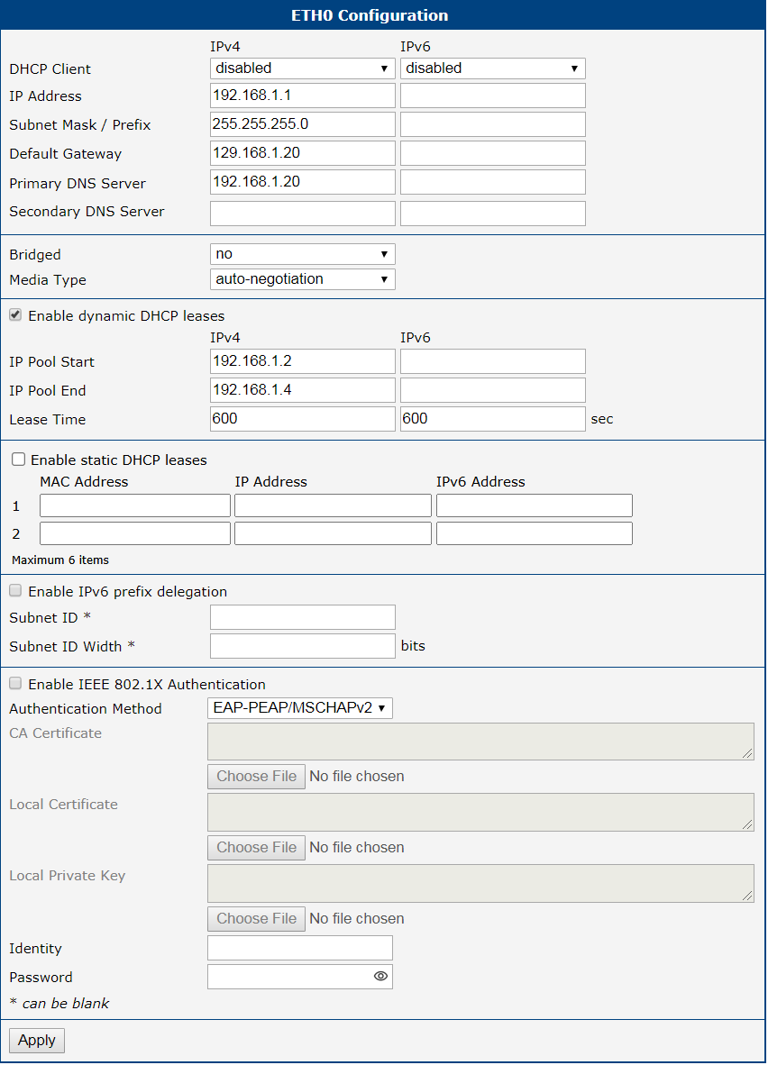

Example 1: IPv4 Dynamic DHCP Server, Default Gateway and DNS Server
- The range of dynamic allocated IPv4 addresses is from 192.168.1.2 to 192.168.1.4.
- The address is allocated for 600 second (10 minutes).
- Default gateway IP address is 192.168.1.20
- DNS server IP address is 192.168.1.20

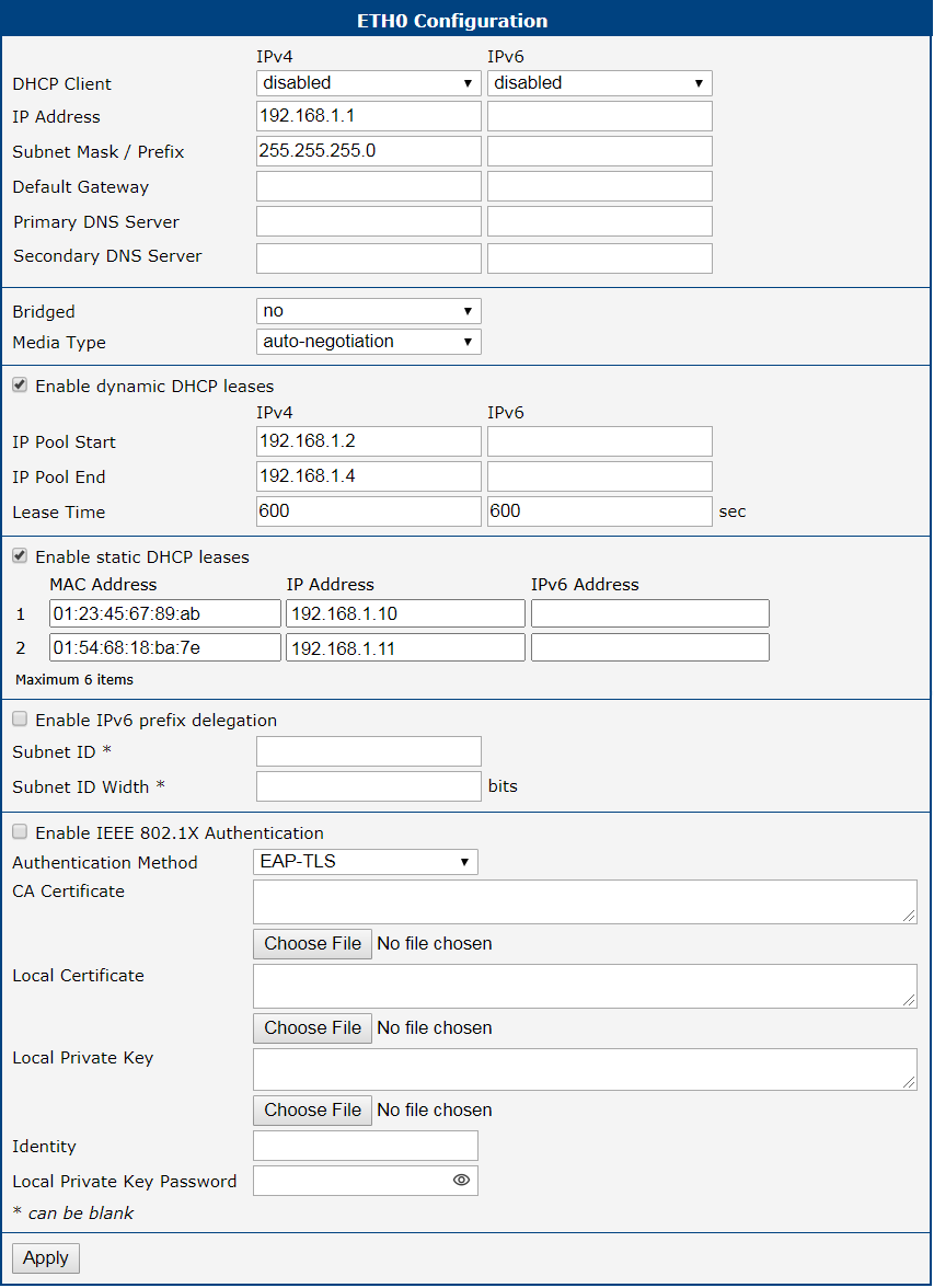

Example 2: IPv4 Dynamic and Static DHCP server
- The range of allocated addresses is from 192.168.1.2 to 192.168.1.4.
- The address is allocated for 600 seconds (10 minutes).
- The client with the MAC address 01:23:45:67:89:ab has the IP address 192.168.1.10.
- The client with the MAC address 01:54:68:18:ba:7e has the IP address 192.168.1.11.
Example 3: IPv6 Dynamic DHCP Server
- The range of dynamic allocated IPv6 addresses is from 2001:db8
ffff. - The address is allocated for 600 second (10 minutes).
- The router is still accessible via IPv4 (192.168.1.1).

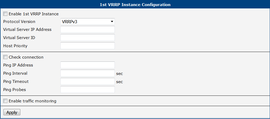

The Virtual Router Redundancy Protocol (VRRP) is a standard network protocol that provides automatic default gateway redundancy. It creates a virtual router, represented by a shared floating IP address, which is managed by a primary (Master) router and one or more Backup routers. If the Master router fails, a Backup router automatically takes over its role, ensuring that devices on the LAN maintain network connectivity without manual intervention. This is particularly useful for adding cellular redundancy to a primary wired connection or for creating a high-availability setup between two cellular links.
The router supports up to two VRRP instances, which can be configured on the Configuration → VRRP page.
VRRP Instance Configuration
To enable and configure a VRRP instance, check the Enable VRRP box and configure the following parameters:
| Protocol Version | Specifies the VRRP version to be used. • VRRPv2: The original standard, widely supported, for IPv4 networks. • VRRPv3: The newer standard that adds support for IPv6 networks. |
| Virtual Server IP Address | Sets the shared virtual IP address. This address must be identical for all routers in the VRRP group and serves as the default gateway for all LAN devices. |
| Virtual Server ID | Defines the identifier for the virtual router group. The range is 1–255. This ID must be identical for all routers participating in the same VRRP group. |
| Host Priority | Sets the priority value used to elect the Master router. The range is 1–254 (default is 100). • The router with the highest priority value becomes the Master. • If the Virtual Server IP matches the interface's real IP, the priority is automatically set to 255 (IP Address Owner), overriding this setting. |
Connection Checking
The Check connection feature adds a crucial layer of reliability by actively testing the health of the router's WAN connection. While VRRP itself detects router failures, this feature can detect upstream network outages even if the router is still running.
When enabled, the Master router periodically sends ICMP echo requests (pings) to a specified target IP address. If no replies are received after a configurable number of attempts, the router assumes the connection has failed and lowers its VRRP priority, triggering a failover to a Backup router.
Info
For reliable connection monitoring, ping a stable public IP address (e.g., a public DNS server like 8.8.8.8). In a private network, you can ping a remote gateway that is directly accessible or available via a VPN.
The Enable traffic monitoring option optimizes this process by suspending ping tests as long as any other traffic is received on the interface. This confirms the connection is active and reduces unnecessary data usage.
| Ping IP Address | The destination IP address for the ICMP echo requests. Domain names are not supported. |
| Ping Interval | The time in seconds between each ping request. |
| Ping Timeout | The time in seconds to wait for a response to each ping. |
| Ping Probes | The number of consecutive failed pings before the connection is declared down. |

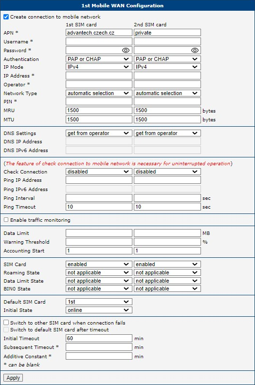

Select the Mobile WAN item in the Configuration menu to open the cellular network configuration page.
Connection to Mobile Network
Info
- Starting with firmware version 6.6.0, PLMN whitelisting is now an integrated firmware feature, available in the Operator field. This native functionality replaces the legacy PLMN Whitelist Router App.
- To avoid potential conflicts, disable or uninstall the legacy Router App before using the integrated PLMN whitelisting feature.
If the Create connection to mobile network checkbox is checked, the router will automatically attempt to establish a connection after booting up. You can specify the following parameters for each SIM card separately.
| APN | The Access Point Name (APN) of the mobile network. |
| Username | The username for logging into the mobile network. |
| Password | The password for logging into the mobile network. |
| Authentication | The authentication protocol used by the network. Both Username and Password must be specified for this setting to apply. • PAP or CHAP: The router automatically selects the authentication method. • PAP: Forces PAP authentication. • CHAP: Forces CHAP authentication. |
| IP Mode | The version of the IP protocol to be used. • IPv4: Use only the IPv4 protocol (default). • IPv6: Use only the IPv6 protocol. • IPv4/IPv6: Enable an independent dual stack for both IPv4 and IPv6. |
| IP Address | The IP address of the SIM card (for IPv4 and IPv4/IPv6 modes only). Enter this manually only if the carrier has assigned a static IP address. |
| Dial Number | The number the router dials for a CSD connection. The default is *99***1#. |
| Operator | Specifies the preferred mobile network operator using the carrier’s PLMN code. The behavior depends on the input: • Empty field: The router operates in automatic mode, connecting to any available network. • Single PLMN: The router locks to the specified operator and connects only to that network. • Comma-separated list (whitelist): By providing two or more PLMNs, you create a whitelist of allowed operators. Upon connecting or if the current network is not on the list, the router will perform a network scan (which may take up to two minutes) and connect to the first operator from your list that it finds available. • Whitelist with automatic fallback: Prefix the list with 0, (e.g., 0,23001,90001) to first connect automatically and then switch to a whitelisted operator if needed. |
| Network Type | Specifies the preferred mobile network technology. Available options depend on the router model and may include: • automatic selection: Allows the router to choose the best available technology automatically. It never selects NB-IoT; for NB-IoT connectivity, select the NB-IoT option explicitly. • UMTS/HSPA • LTE • NB-IoT • LTE-M • NR5G: Equivalent to 5G SA (Standalone). Note: 5G NSA (Non-Standalone) is a combination of LTE and 5G technologies and functions only when automatic selection is enabled. |
| PIN | The Personal Identification Number used to unlock the SIM card. Use this only if required by the SIM card. The card will be blocked after several failed attempts. |
| MRU | Maximum Receive Unit: the maximum packet size the router can receive. Default is 1500 B. Incorrect values may cause data reception errors. Minimum: 128 B for IPv4, 1280 B for IPv6. |
| MTU | Maximum Transmission Unit: the maximum packet size the router can transmit. Default is 1500 B. Incorrect values may cause data transmission errors. Minimum: 128 B for IPv4, 1280 B for IPv6. |
Info
- An incorrect MTU size may cause data transfer failures. A value that is too low increases fragmentation and overhead, while a value that is too high can cause packets to be dropped by the network.
- If the IP Address field is left blank, the carrier will automatically assign an IP address. Manual assignment can result in a faster connection.
- If the APN field is left blank, the router will attempt to auto-select an APN based on the SIM card’s IMSI. The selected APN name can be found in the System Log.
- To use a blank APN, enter the word
blankin the APN field.
Warning
An incorrect PIN will block the SIM card after several failed attempts.
Parameters marked with an asterisk (*) are required only if specified by your mobile network operator. If the router fails to connect, verify the accuracy of all entered data and consider trying a different authentication method or network type.

The DNS Settings parameter simplifies client-side configuration. When set to get from operator, the router automatically obtains the primary and secondary DNS server IP addresses from the carrier. To specify them manually, select set manually and enter the IPv4 or IPv6 addresses, depending on the selected IP Mode.
Network Connection Check
Warning
Enabling the Check Connection function is essential for ensuring uninterrupted operation of the router.
If Check Connection is set to enabled or enabled + bind, the router sends ping requests to the destinations specified in Ping IP Address or Ping IPv6 Address at regular intervals defined by Ping Interval. If you specify two addresses, the router considers the connection functional if at least one of the destinations responds; a connection failure is triggered only if both destinations are unreachable.
If a ping fails, a new one is sent after the Ping Timeout. If three consecutive pings fail (or three rounds of pings to both addresses), the router terminates and re-establishes the cellular connection. This monitoring function can be configured for each SIM card but runs only on the active SIM. Ensure you use reliable destination addresses, such as the operator’s DNS server or public DNS services.
If Check Connection is set to enabled, ping requests are sent based on the routing table and may use any available interface. To ensure pings are sent only through the mobile WAN interface, set it to enabled + bind. The disabled option deactivates connection checking.
Warning
For routers connected to the Verizon network, the connection retry interval increases with each attempt. The first two retries occur after 1 minute, followed by intervals of 2, 8, and 15 minutes. The ninth and all subsequent retries occur every 90 minutes.
If Enable Traffic Monitoring is checked, the router monitors Mobile WAN traffic instead of sending pings. If no data is transmitted, it will begin sending pings.
| Ping IP Address | The destination IPv4 address or domain name for ping queries. Available in IPv4 and IPv4/IPv6 modes. |
| Ping IPv6 Address | The destination IPv6 address or domain name for ping queries. Available in IPv6 and IPv4/IPv6 modes. |
| Ping Interval | The time interval between outgoing pings. |
| Ping Timeout | The time (in seconds) to wait for a ping response. |

SIM Card Switching
In the lower part of the form, you can specify rules for switching between SIM cards.
Info
The router automatically switches between SIMs based on the logical AND of all configured rules (manual permission, roaming, data limit, and digital input state).
| SIM Card | Enables or disables the use of a SIM card. Setting all SIMs to disabled deactivates the cellular module. |
| Roaming State | Configures SIM usage based on roaming status (must be activated by your operator). • not applicable: Use the SIM everywhere. • home network only: Use the SIM only when not roaming. |
| Data Limit State | Configures SIM usage based on the data limit. • not applicable: Use the SIM regardless of the data limit. • not exceeded: Use the SIM only if the data limit has not been exceeded. |
| BINx State | Configures SIM usage based on digital input x state. • not applicable: Use the SIM regardless of the input state. • on: Use the SIM only if the input is on (voltage present). • off: Use the SIM only if the input is off (no voltage). |
Use the following parameters to specify the behavior of SIM card switching.
| Default SIM Card | Specifies the primary SIM card the router should use to connect. |
| Initial State | The action the module takes after a SIM is selected. • online: Establish a connection immediately (default). • offline: Remain offline. The state can be changed via SMS. The module will also go offline if no SIM card meets the switching criteria. |
| Switch to other SIM card when connection fails | If enabled, the router switches to the backup SIM card if the connection on the default SIM fails (as detected by the Check Connection feature). |
| Switch to default SIM card after timeout | If enabled, the router will attempt to switch back to the default SIM after a specified timeout. Applies only if the switch was triggered by a connection failure or roaming. Requires Switch to other SIM card when connection fails to be enabled. |
| Initial Timeout | The time (1 to 10,000 minutes) the router waits before the first attempt to switch back to the default SIM. |
| Subsequent Timeout | The time (1 to 10,000 minutes) the router waits after a failed attempt to switch back. |
| Additive Constant | An additional time (1 to 10,000 minutes) added to the Subsequent Timeout for each further attempt. |
SIM Card Switching Examples
Example 1: Timeout Configuration
With Switch to default SIM card after timeout checked and the following values configured:
The first attempt to switch back to the default SIM occurs after 60 minutes. If it fails, the second attempt is made after 30 minutes. The third attempt follows after 50 minutes (30 + 20), and the fourth after 70 minutes (30 + 20 + 20).
Example 2: Data Limit Switching
This example demonstrates how to configure the router to automatically switch to the second SIM card once the data limit of 800 MB is exceeded on the first (default) SIM. The Data Limit State for the 1st SIM card must be set to not exceeded. An SMS warning is also sent upon reaching 400 MB (50% threshold), which requires enabling the corresponding feature on the SMS Configuration page. The billing period starts on the 18th day of the month.
| Create PPPoE connection | Enables the PPPoE client on the selected interface. When checked, the router will automatically attempt to establish a connection on boot. |
| Interface | Selects the Ethernet interface (ETH0 or ETH1) on which the PPPoE client will operate. |
| Username | The username required for authentication with the PPPoE server. |
| Password | The password for the specified username. |
| Authentication | Specifies the authentication protocol to be used. • PAP or CHAP: Allows the router to negotiate and use either protocol (default). • PAP: Forces the use of Password Authentication Protocol. • CHAP: Forces the use of Challenge-Handshake Authentication Protocol. |
| IP Mode | Defines the IP protocol version for the connection. • IPv4: Establishes an IPv4-only session (default). • IPv6: Establishes an IPv6-only session. • IPv4/IPv6: Enables a dual-stack session for both IPv4 and IPv6. |
| MRU | The Maximum Receive Unit in bytes — the largest packet size the router can receive. The default is 1492 B. |
| MTU | The Maximum Transmission Unit in bytes — the largest packet size the router can transmit. The default is 1492 B. |
| Clamp Max. Segment Size | When enabled (default), automatically adjusts the TCP Maximum Segment Size (MSS) to prevent fragmentation, improving performance and reliability. |
| DNS Settings | Configures how DNS servers are obtained. • Get from server: Automatically uses the DNS servers provided by the PPPoE server (default). • Manual: Allows you to specify primary and secondary DNS servers manually. |
| Primary DNS Server | Primary IPv4 address of the DNS server. |
| Primary IPv6 DNS Server | Primary IPv6 address of the DNS server. |
| Secondary DNS Server | Secondary IPv4 address of the DNS server. |
| Secondary IPv6 DNS Server | Secondary IPv6 address of the DNS server. |
Warning
Setting an incorrect MTU or MRU value can lead to packet fragmentation or loss, resulting in a failed or unreliable connection. Use the default value of 1492 B unless your provider requires a different setting.

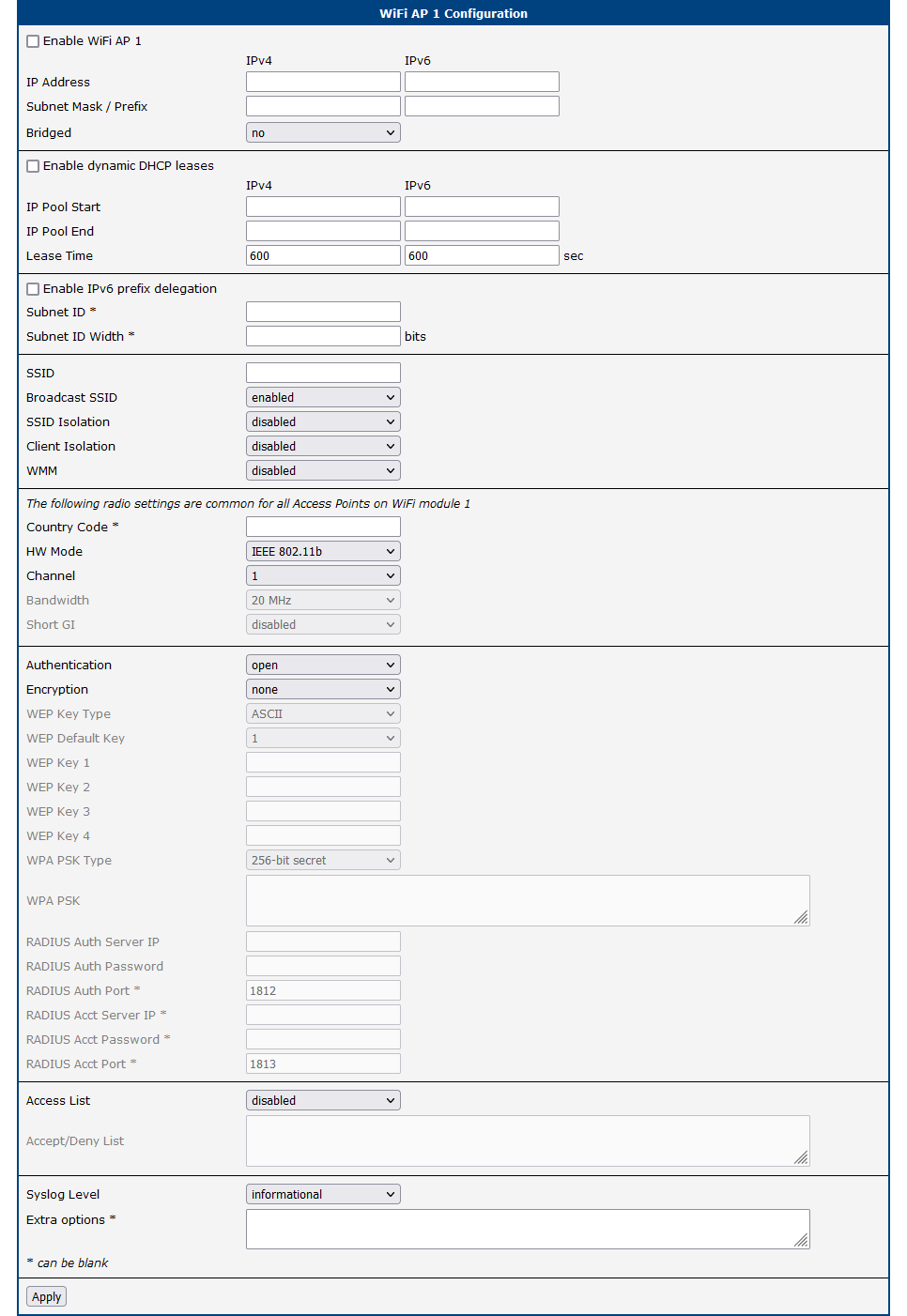

To enable Wi-Fi access point mode, check the Enable Wi-Fi AP box at the top of the Configuration → WiFi → Access Point 1 or Access Point 2 configuration page. In this mode, the router operates as an access point, allowing other devices in station (STA) mode to connect.
| Enable WiFi AP | Enables the Wi-Fi access point (AP). Both Access Point 1 (AP1) and Access Point 2 (AP2) can be enabled and operated simultaneously. |
| IP Address | A fixed IP address for the Wi-Fi interface. Use standard IPv4 or IPv6 notation. |
| Subnet Mask / Prefix | Specifies the subnet mask for an IPv4 address or the prefix length (0 to 128) for an IPv6 address. |
| Bridged | Activates bridge mode: • no: Bridged mode is disabled (default). The WLAN is a separate network from the LAN. • yes: Bridged mode is enabled. The WLAN is connected to one or more LAN networks. In this mode, most network settings in this table are ignored, and the router uses the settings of the bridged LAN interface. See the Bridge Notes in Ethernet for further details. |
| Enable dynamic DHCP leases | Enables the dynamic allocation of IP addresses using the DHCP (or DHCPv6) server. |
| IP Pool Start | The start of the IP address range assigned to DHCP clients. |
| IP Pool End | The end of the IP address range assigned to DHCP clients. |
| Lease Time | The duration (in seconds) for which a client can use its assigned IP address. |
| Enable IPv6 prefix delegation | Enables prefix delegation for IPv6 clients. |
| Subnet ID | The decimal value of the Subnet ID for the interface. The maximum value is determined by the Subnet ID Width. |
| Subnet ID Width | The maximum Subnet ID width, which depends on your site's configuration. The remaining bits (up to 64) are used for the prefix. |
| SSID | The unique identifier (name) of the Wi-Fi network. Access Point 1 (AP1) and Access Point 2 (AP2) can have different SSIDs. |
| Broadcast SSID | Defines how the SSID is broadcast in the beacon frame: • enabled: The SSID is included in the beacon frame (standard behavior). • zero length: The SSID is omitted from the beacon frame. Requests to send beacon frames are ignored. • clear: SSID characters in the beacon are replaced with zeros, maintaining the original length. Requests for beacon frames are ignored. |
| SSID Isolation | When enabled with a selected zone, clients on this access point cannot communicate with clients on other access points that have a different zone selected. |
| Client Isolation | If enabled, clients connected to this access point are prevented from communicating with each other. If disabled, the AP functions like a switch, allowing clients on the same LAN to communicate. |
| WMM | Enables basic QoS (Quality of Service) for the Wi-Fi network. Suitable for simple applications that require QoS but does not guarantee network throughput. |
| Country Code | • The country code where the router is installed. This code must be entered in ISO 3166-1 alpha-2 format. • For proper and optimal utilization of WiFi functionality in the given region, always set the correct country code. • After changing the country code, save the settings by clicking the Apply button, then continue with further WiFi configuration. If the country code is not specified, it will use "NL" for ICR-17xx-EU and "CN" for ICR-17xx-CN as the default country code. • If an incorrect country code is entered, the router may violate country-specific regulations regarding the use of WiFi parameters. |
| Follow STA radio settings | When enabled, if the STA mode is connected to an external access point, the router's own AP radio settings will automatically adjust to match those of the external AP. |
| HW Mode¹ | Specifies the Wi-Fi standard supported by the access point. Available options include: IEEE 802.11b (2.4 GHz), IEEE 802.11b+g (2.4 GHz), IEEE 802.11b+g+n (2.4 GHz), IEEE 802.11a (5 GHz), IEEE 802.11a+n (5 GHz), IEEE 802.11ac (5 GHz). This setting is shared by both Access Point 1 and Access Point 2. |
| Channel¹ | The channel on which the Wi-Fi access point operates. Available channels depend on the selected Country. Select Auto to allow the router to choose the optimal channel automatically. If you change the country, review this setting, as the previously selected channel may no longer be valid. This setting is shared by both Access Point 1 and Access Point 2. Note: When 40 MHz bandwidth is selected, in the 2.4 GHz band the channel number refers to the primary (20 MHz) channel; in the 5 GHz and 6 GHz bands, it refers to the center frequency of the 40 MHz channel. On NAM routers, only channels 1 to 11 are supported in the 2.4 GHz band. |
| Bandwidth¹ | Selects the transfer bandwidth. This option may be unavailable for some hardware modes. If the selected bandwidth is occupied, the router may automatically switch to a lower bandwidth. This setting is shared by both Access Point 1 and Access Point 2. |
| Short GI | Available for 802.11n mode — enables a short guard interval (400 ns instead of 800 ns) to improve data transmission efficiency. This setting is shared by both Access Point 1 and Access Point 2. |
| Authentication | Defines the access control method for the Wi-Fi network: • open: [insecure] No authentication required. Encryption is not available.• shared: [insecure] Basic authentication with a WEP key.• WPA-PSK: [insecure] Pre-Shared Key authentication with WPA encryption.• WPA2-PSK: [insecure] Pre-Shared Key authentication with WPA2 encryption (AES).• WPA3-PSK: Simultaneous Authentication of Equals (SAE) with WPA3 encryption (AES). • WPA-Enterprise: [insecure] RADIUS-based authentication via an external server.• WPA2-Enterprise: RADIUS-based authentication with stronger encryption. |
| Encryption | Specifies the type of data encryption: • none: [insecure] No data encryption.• WEP: [insecure] Wired Equivalent Privacy.• TKIP: [insecure] Temporal Key Integrity Protocol, used for WPA.• AES: Advanced Encryption Standard, used for WPA2/WPA3. |
| WEP Key Type | Specifies the WEP key format. • ASCII: WEP key in ASCII format. • HEX: WEP key in hexadecimal format. |
| WEP Default Key | Specifies the default WEP key. |
| WEP Key 1–4 | Allows entry of up to four different WEP keys. • ASCII format: The WEP key must be entered in quotes and can have the following lengths: - 5 characters (40-bit WEP key) - 13 characters (104-bit WEP key) • Hexadecimal format: The WEP key must be entered using hexadecimal digits and can have the following lengths: - 10 hex digits (40-bit WEP key) - 26 hex digits (104-bit WEP key) |
| WPA PSK Type | Specifies the format of the WPA Pre-Shared Key: • 256-bit secret: A 64-character hexadecimal key. • ASCII passphrase: A passphrase of 8 to 63 characters. • PSK File: Absolute path to a file containing key-MAC address pairs. |
| WPA PSK Secret | The secret key or passphrase for WPA-PSK authentication. |
| RADIUS Auth Server IP | The IPv4 or IPv6 address of the RADIUS authentication server. |
| RADIUS Auth Password | The access password for the RADIUS authentication server. |
| RADIUS Auth Port | The port number of the RADIUS authentication server (default is 1812). |
| RADIUS Acct Server IP | The IPv4 or IPv6 address of the RADIUS accounting server (if different from the authentication server). |
| RADIUS Acct Password | The access password for the RADIUS accounting server. |
| RADIUS Acct Port | The port number of the RADIUS accounting server (default is 1813). |
| Access List | Defines the mode of the client access list: • disabled: The access list is not used. • accept: Only clients in the list can access the network. • deny: Clients in the list are blocked from accessing the network. |
| Accept/Deny List | A list of client MAC addresses for network access control. Each MAC address should be entered on a new line. |
| Syslog Level | Defines the logging level for messages sent to the system log: • verbose debugging: The highest level of detail. • debugging • informational: The default level. • notification • warning: The lowest level. |
| Extra options | Allows the user to define additional parameters for hostapd. The options are appended to the configuration file. Use this feature only if you are familiar with its functionality. For more information, refer to the hostapd.conf configuration file. |
¹ The availability of configuration options may vary depending on the specific WiFi module and can be affected by the selected country code.

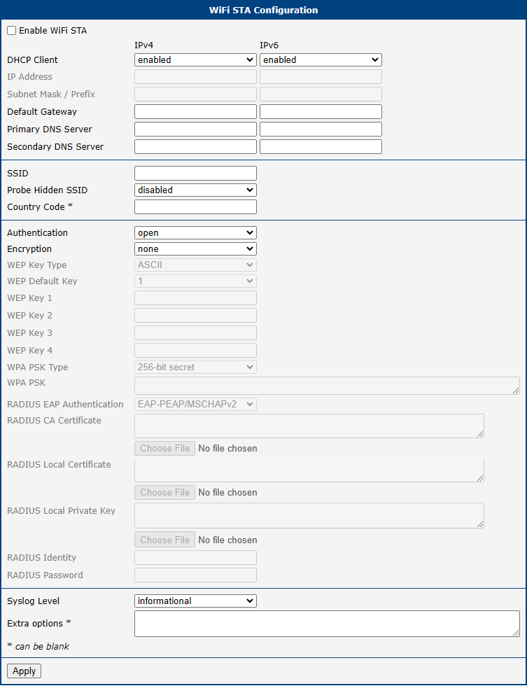

WiFi Station
Info
- You can find and connect to an available Wi-Fi network using Status → Wi-Fi → WiFi Scan.
- The router supports operating as both an access point (AP) and a station (STA) simultaneously.
- For networks using WPA-Enterprise security (RADIUS authentication), the station mode supports only the EAP-PEAP/MSCHAPv2 (both PEAPv0 and PEAPv1) and EAP-TLS authentication methods.
Activate Wi-Fi station mode by checking the Enable WiFi STA box at the top of the Configuration → WiFi → Station configuration page. In this mode, the router functions as a client station, connecting to an available access point (AP) and bridging its wired connection to the Wi-Fi network. In station mode, the Wi-Fi channel and bandwidth are determined by the associated access point.
| Enable WiFi STA | Enables the Wi-Fi station (STA) mode. |
| DHCP Client | Activates or deactivates the DHCP client (or DHCPv6 client for IPv6). |
| IP Address | Specifies a fixed IP address for the Wi-Fi interface. Use standard IPv4 or IPv6 notation. |
| Subnet Mask / Prefix | Defines the subnet mask for an IPv4 address or the prefix length (0 to 128) for an IPv6 address. |
| Default Gateway | Specifies the IP address of the default gateway. Packets with destinations not found in the routing table are sent to this gateway. |
| Primary DNS Server | Specifies the primary IP address of the DNS server. |
| SSID | The unique identifier (name) of the Wi-Fi network to connect to. |
| Probe Hidden SSID | An access point with a hidden SSID does not broadcast its name, preventing the station from connecting automatically. Enable this option to force the station to probe for a specific hidden SSID. If you are not connecting to a hidden network, keep this disabled to reduce unnecessary radio transmissions. |
| Country Code | • Optional entry of the country code where the router is installed. • If not specified, the code is inherited from the AP to which the STA connects. • If an incorrect country code is entered, the router may violate country-specific regulations regarding WiFi parameters. • Note: The country code must be entered in ISO 3166-1 alpha-2 format. |
| Authentication | Access control methods for the Wi-Fi network: • open: [insecure] No authentication required.• shared: [insecure] Basic authentication with a WEP key.• WPA-PSK: [insecure] Authentication using a PSK with the WPA standard.• WPA2-PSK: [insecure] Authentication using a PSK with the WPA2 standard.• WPA3-PSK: Authentication using SAE with the WPA3 standard. • WPA-Enterprise: [insecure] Authentication using a RADIUS server with the WPA standard.• WPA2-Enterprise: Authentication using a RADIUS server with the WPA2 standard. |
| Encryption | The data encryption method: • none: [insecure] No encryption.• WEP: [insecure] Static encryption with WEP keys (may not be supported on some models).• TKIP: [insecure] Legacy dynamic encryption used with WPA/WPA2.• AES: Modern dynamic encryption used with WPA2/WPA3. |
| WPA PSK Type | The format of the key for WPA-PSK authentication: • 256-bit secret: A 64-character hexadecimal key. • ASCII passphrase: A passphrase of 8 to 63 characters. |
| RADIUS EAP Authentication | The EAP protocol used for RADIUS authentication: • EAP-PEAP/MSCHAPv2: Uses TLS to protect legacy EAP authentication. • EAP-TLS: Uses TLS for mutual authentication between the client and server. |
| RADIUS CA Certificate | The Certificate Authority (CA) certificate used to verify the server certificate during EAP-TLS authentication. |
| RADIUS Local Certificate | The client certificate required for EAP-TLS authentication. |
| RADIUS Local Private Key | The private key associated with the client certificate for EAP-TLS authentication. |
| RADIUS Identity | The identity (username) used to connect to the RADIUS server. |
| RADIUS Password | The password used to authenticate the RADIUS identity (for EAP-PEAP/MSCHAPv2). For EAP-TLS, this field is optional and specifies the decryption key for the local private key if it is encrypted. |
| Extra options | Allows the user to define additional parameters for wpa_supplicant. The options are appended to the configuration file. Use this feature only if you fully understand the implications. For more information, refer to the wpa_supplicant.conf configuration file. |

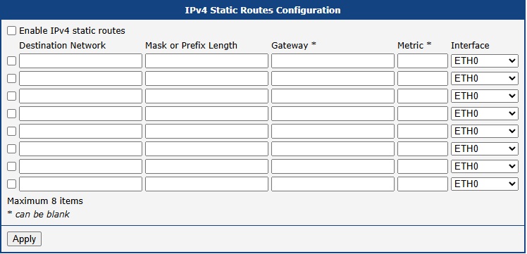

Static Routes
Static routes are manually configured, fixed paths that define how the router should forward traffic to a specific destination network or host. Unlike dynamic routes, which are learned automatically, static routes do not change unless they are manually updated. They are ideal for small, stable networks or for defining a specific path that must always be used.
The configuration is managed on the Static Routes page. The router provides separate configuration tables for IPv4 and IPv6, each supporting up to eight individual static routes. A new row is automatically added as you fill in the previous one.
| Enable IPv4 static routes | The master switch for the static routing feature. If unchecked, all static routes are disabled. Individual routes must also be enabled using the checkbox in their respective rows. |
| Destination Network | The IP address of the target network or host for which this route is being created. |
| Mask or Prefix Length | The subnet mask (for IPv4) or prefix length (for IPv6) of the destination network. |
| Gateway | The IP address of the next-hop router that will be used to reach the destination network. |
| Metric | A numerical value (1–255) representing the route's priority. A lower metric indicates a more preferred route. |
| Interface¹ | The network interface through which the specified gateway is reachable. |
¹ The Any option allows for the creation of routes where the gateway may not be directly connected, such as a GRE tunnel endpoint. When Any is selected, specifying a Gateway is mandatory, as it determines which interface will be used.

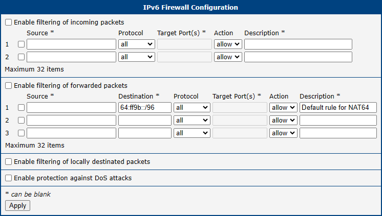

The next section defines the forwarding firewall policy. If the Enable filtering of forwarded packets checkbox is unchecked, all incoming packets are forwarded. When enabled, and if a packet is addressed to another network interface, the router processes it through the FORWARD chain in iptables. If the FORWARD chain accepts the packet, the router forwards it, provided there is a corresponding entry in the routing table.
You can define up to thirty-two forwarding rules. A new row appears automatically after filling in the previous one. The forwarding settings can be applied to specific interfaces, providing granular control over traffic flow.
Info
As shown in the figure above, the first entry in the IPv6 forwarded packets configuration is the default firewall rule for NAT64, which is disabled by default. To enable the NAT64 function, navigate to Configuration → NAT → IPv6 → Enable NAT64.
| Source Address(es)¹ | Specifies the source IP address to which the rule applies (IPv4 or IPv6). |
| Destination Address(es)¹ | Specifies the destination IP address to which the rule applies (IPv4 or IPv6). |
| Protocol | Specifies the protocol to which the rule applies: • all, TCP, UDP, GRE, ESP, ICMP/ICMPv6. |
| Target Port(s) | Specifies the target port number or range. |
| Action | Defines the action the router performs: • allow: Permits the packets to be forwarded. • deny: Blocks the packets from being forwarded. |
| Description | A user-defined description for the rule, which is stored as a comment in iptables. |
¹ This field supports IP address input in the formats: IP, IP/mask, or IP_start-IP_end.
When the Enable filtering of locally destined packets function is enabled, the router automatically drops packets requesting an unsupported service without sending any notification.
To protect against DoS (Denial of Service) attacks, the Enable protection against DoS attacks option limits the number of allowed connections per second to five. A DoS attack floods the target system with excessive requests, overwhelming its resources.

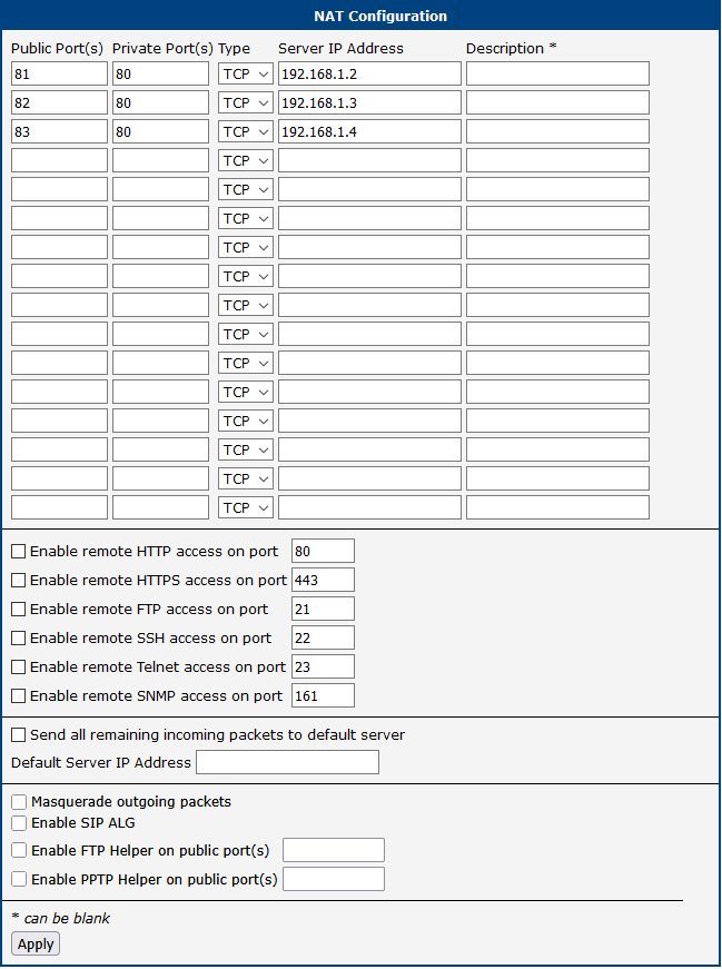

NAT
Network Address Translation (NAT) is a fundamental networking function that modifies IP address information in packet headers while they are in transit. The router implements NAPT (Network Address and Port Translation), also known as PAT (Port Address Translation) or IP masquerading, which allows multiple devices in a private network to share a single public IP address.
The NAT configuration is managed on the Configuration → NAT page, which has separate subpages for IPv4 and IPv6.
Port Forwarding
Port forwarding, also known as destination NAT (DNAT), allows external devices to connect to a specific service on a device within the private LAN. You can define up to sixteen port forwarding rules.
| Public Port(s) | The external port or port range on the router's WAN interface. A single port or a range (e.g., 8000-8010) can be specified. |
| Private Port(s) | The internal port or port range on the destination server. |
| Type | The protocol for the rule: TCP or UDP. |
| Server IP Address | The private IPv4 or IPv6 address of the server on the LAN to which traffic will be forwarded. |
| Description | An optional description for the rule. |
For configurations requiring more than sixteen rules, additional rules can be added to the startup script (Configuration → Scripts). Use the following iptables command format for IPv4:
For IPv4 NAT:
iptables -t nat -A pre_nat -p tcp --dport [PORT_PUBLIC] -j DNAT --to-destination [IPADDR]:[PORT_PRIVATE]For IPv6, use the ip6tables command:
ip6tables -t nat -A napt -p tcp --dport [PORT_PUBLIC] -j DNAT --to-destination [IP6ADDR]:[PORT_PRIVATE]Replace the bracketed values with your specific port numbers and IP addresses.

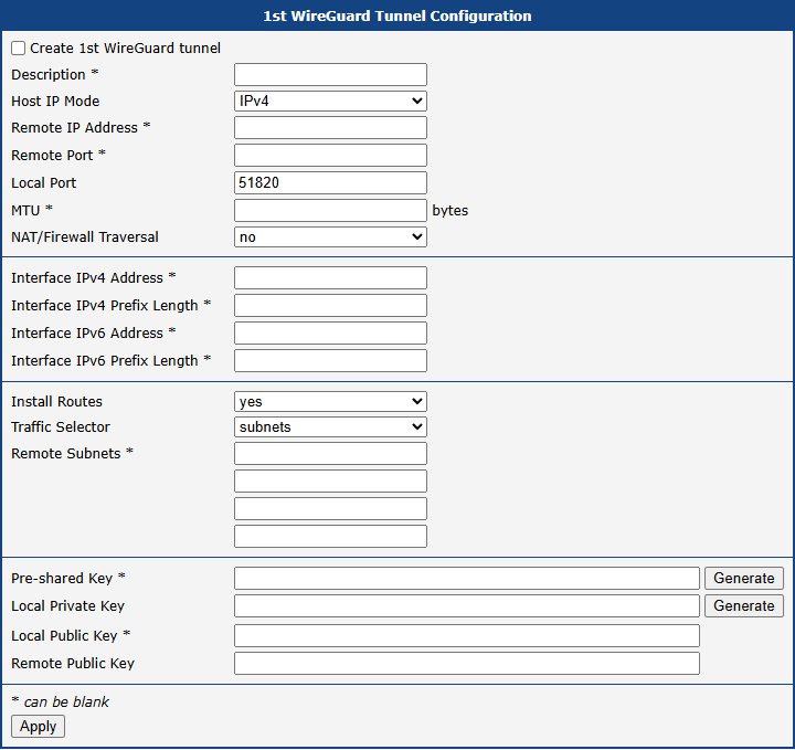

WireGuard
WireGuard is a modern, secure, and high-performance VPN (Virtual Private Network) protocol and opensource software that creates encrypted tunnels. It is designed for ease of use, speed, and a reduced attack surface compared to older protocols like IPsec and OpenVPN. WireGuard operates by encapsulating traffic within UDP (User Datagram Protocol) packets. Advantech routers support the creation of up to four WireGuard tunnels simultaneously.
To access the WireGuard tunnel configuration pages, click WireGuard in the Configuration section of the main menu. The menu item will expand, displaying separate configuration pages for 1st Tunnel, 2nd Tunnel, 3rd Tunnel, and 4th Tunnel.
WireGuard on Advantech routers supports both IPv4 and IPv6 tunnels (dual stack), enabling the transport of IPv6 traffic over IPv4 tunnels and vice versa.
Info
- The FRRouting (FRR) router app is an Internet routing protocol suite for Advantech routers. This User Module includes protocol daemons for BGP, IS-IS, LDP, OSPF, PIM, and RIP. FRR can be used in conjunction with WireGuard for dynamic routing configurations.
- Detailed information and practical examples of WireGuard tunnel configuration and authentication can be found in the WireGuard Tunnel application guide.
The following table describes all available WireGuard tunnel configuration options:
| Parameter | Description |
| Create WireGuard tunnel | Enables and activates the respective tunnel. |
| Description | A user-defined name or description for the WireGuard tunnel interface. |
| Host IP Mode | • IPv4: The router uses IPv4 for communication with the remote peer. • IPv6: The router uses IPv6 for communication with the remote peer. |
| Remote IP Address | The IPv4 or IPv6 address, or the domain name, of the remote WireGuard peer. This address must correspond to the selected Host IP Mode. |
| Remote Port | The UDP port number on the remote WireGuard peer where it is listening for incoming connections. |
| Local Port | The UDP port number on which the local WireGuard interface listens for incoming connections (default port is 51820). |
| MTU | The Maximum Transmission Unit (MTU) for the WireGuard tunnel interface, specified in bytes. The default value is 1400 bytes. It’s generally recommended to keep the default value unless specific network conditions require adjustment. |
| NAT/Firewall Traversal | When set to yes, the router sends keepalive packets (every 25 seconds) to maintain the tunnel connection active, especially when the local peer is behind a NAT (Network Address Translation) device or firewall. This ensures the NAT/firewall mapping remains valid, allowing incoming connections to reach the peer behind NAT. |
| Interface IPv4 Address | The IPv4 address assigned to the local WireGuard tunnel interface. This address is used for routing traffic within the tunnel. |
| Interface IPv4 Prefix Length | The IPv4 subnet prefix length associated with the local WireGuard tunnel interface address. |
| Interface IPv6 Address | The IPv6 address assigned to the local WireGuard tunnel interface. This address is used for routing traffic within the tunnel. |
| Interface IPv6 Prefix Length | The IPv6 subnet prefix length associated with the local WireGuard tunnel interface address. |
| Install Routes | • no: Disables automatic route installation. Use this option when a dynamic routing protocol (e.g., FRR/BGP) is used to manage routes. • yes: Enables automatic installation of routes based on the configured subnets. |
| Traffic Selector | • all traffic: All traffic is routed through the WireGuard tunnel (route 0.0.0.0/0 for IPv4 and ::/0 for IPv6). • subnets: Traffic is routed through the WireGuard tunnel based on the specific subnets defined below. |
| Remote Subnets | If Traffic Selector is set to subnets, specify the destination subnets (networks) to be routed through the WireGuard tunnel in CIDR notation (e.g., 192.168.1.0/24). A maximum of 4 subnets can be defined. |
Cryptographic Keys
WireGuard's security is based on modern public-key cryptography.
| Pre-shared Key | An optional key that adds an additional layer of symmetric-key encryption, providing post-quantum resistance. Click Generate to create a new key and share it with the remote peer. |
| Local Private Key | The secret private key for this router. Click Generate to create a new one. This key must never be shared. |
| Local Public Key | The public key derived from the local private key. Share this key with the remote peer so it can authenticate and encrypt traffic sent to this router. |
| Remote Public Key | The public key of the remote peer. Used to authenticate the remote peer and encrypt traffic sent to it. |
WireGuard Example
The following example demonstrates a WireGuard IPv4 tunnel configuration between Router A and Router B.
In this setup, Router B is configured as the listening side (server), and Router A initiates the tunnel connection (client). The configuration details for Router A and Router B, based on the topology shown above, are as follows:
| Configuration | Router A | Router B |
| Host IP Mode | IPv4 | IPv4 |
| Remote IP Address | 10.0.6.60 | — (Listens on all interfaces) |
| Remote Port | 51820 | — (Listens on local port) |
| Local Port | 51820 | 51820 |
| NAT/Firewall Traversal | yes | no |
| Interface IPv4 Address | 172.16.24.1 | 172.16.24.2 |
| Interface IPv4 Prefix Length | 30 | 30 |
| Install Routes | yes | yes |
| Traffic Selector | subnets | subnets |
| Remote Subnets | 192.168.2.0/24 | 192.168.1.0/24 |
| Local Private Key | generated key A | generated key B |
| Local Public Key | public key A | public key B |
| Remote Public Key | public Key B | public key A |
Verifying Connectivity

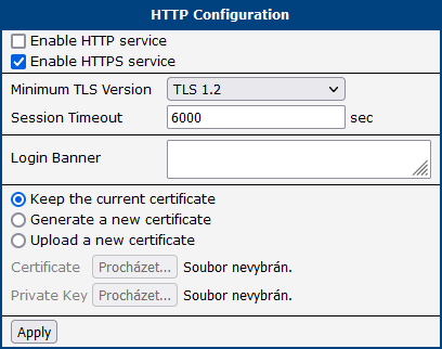

HTTP
Warning
Make sure your certificate matches the Security Level. Increasing Security Level without generating a new certificate may lead to inability to connect to Web GUI.
This page manages access to the router's web configuration interface via HTTP and HTTPS. For maximum security, use HTTPS — it encrypts all communication between the browser and the router. Even if HTTP is disabled, the router continues to listen on port 80 for the sole purpose of redirecting requests to HTTPS.
| Enable HTTP service | Enables unencrypted access to the web interface. Not recommended. |
| Enable HTTPS service | Enables secure, encrypted access to the web interface. This is the default and recommended setting. |
| Minimum TLS Version | The minimum TLS version the router's web server will accept. Options range from TLS 1.0 to TLS 1.3. TLS 1.0 and 1.1 are only available when Security Level is set to 0. For maximum security, select the highest version compatible with your clients. |
| Session Timeout | The inactivity period (in minutes) after which a user is automatically logged out. |
| Login Banner | Custom text displayed on the login page above the credentials fields. |
| Keep the current certificate | Retains the certificate currently stored on the router. |
| Generate a new certificate | Generates a new self-signed certificate corresponding to the selected Security Level. |
| Upload a new certificate | Allows uploading a custom certificate, such as one signed by a trusted Certificate Authority. |
| Certificate | The PEM-formatted certificate file to upload. The file may contain a single certificate or a full certificate chain. |
| Private Key | The private key file corresponding to the certificate being uploaded. |
¹ For a detailed explanation, see the Security Guidelines application guide, specifically the chapter on cryptographic algorithms.

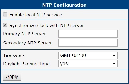

NTP
The NTP (Network Time Protocol) configuration page allows you to configure the router’s NTP client and/or server functions. To open the NTP configuration page, click NTP in the Configuration section of the main menu.
Info
- Some configuration options described below may not be available on all router models.
- Upon initial activation, the NTP service may require up to 15 minutes to stabilize due to hardware clock adjustments. During this period, Syslog may report
TIME_ERROR: Clock Unsynchronized. This is normal and will resolve when synchronization is complete.
Warning
Operating the router as an NTP server while its own clock is not synchronized to a reliable external time source (e.g., remote NTP server, cellular network, or GNSS) is strongly discouraged. This may result in incorrect time propagation to other devices relying on this router.
Info
Time-Synchronization Accuracy
The accuracy of the router’s clock depends on the synchronization source:
- Remote NTP Server (recommended): Typically within several milliseconds. External NTP servers are usually synchronized to atomic clocks.
- Cellular Network (NITZ): Typically up to several seconds, depending on the mobile operator’s infrastructure.
- GNSS: Typically around one second. Not recommended for applications requiring high-precision timekeeping.
| Enable local NTP server | When enabled, the router functions as an NTP server, allowing other devices on the local network to synchronize their time with it. The accuracy of the time served depends on how the router’s own clock is synchronized (see options below). |
| Synchronize clock with NTP server | When enabled, the router synchronizes its clock with the configured NTP server(s). The Primary NTP Server and Secondary NTP Server fields below specify the remote time servers to use. |
| Primary NTP Server | IP address or domain name of the primary remote NTP server. This server is queried first for time synchronization. |
| Secondary NTP Server | IP address or domain name of the secondary remote NTP server. This server is used if the primary server is unavailable. |
| Timezone | Specifies the geographical timezone where the router is physically located. This setting is crucial for correct local time display and DST adjustments. |
| Daylight Saving Time | Enables or disables automatic adjustment for Daylight Saving Time (DST). When enabled, the router will adjust its clock according to the DST rules for the selected Timezone. |

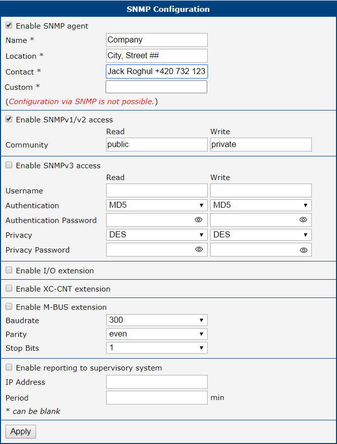

SNMP
The SNMP page allows you to configure the SNMP v1/v2 or v3 agent, which transmits information about the router and its expansion ports (if applicable) to a management station. To access the page, click SNMP in the Configuration → Services section.
SNMP (Simple Network Management Protocol) provides status information about network elements such as routers or endpoint devices. In SNMP v3, communication is secured through user-specific encryption and authentication. To enable the SNMP service, select the Enable SNMP agent checkbox. IPv6 is supported for SNMP traps as well.
Info
Name, Location, Contact, and Custom identification fields are now configured in Configuration → System → Identification. These fields are no longer present on the SNMP configuration page.
| Enable SNMP agent | Turns on the SNMP agent, allowing the router to be managed and monitored using SNMP protocols. |
| Name | Designation of the router. |
| Location | Location of where you installed the router. |
| Contact | Person who manages the router together with information how to contact this person. |
| Custom | You can use this input field to enter specific information tailored to your requirements. |
| Enable SNMPv1/v2 access | Enables access for SNMPv1 and SNMPv2 protocols. Enter community strings for read and write access. |
| Community (Read/Write) | Community strings for SNMPv1/v2 access. Default: public for read, private for write. |
| Enable SNMPv3 access | Activates configuration options for SNMPv3, providing stronger authentication and encryption. |
| Username | The username for SNMPv3, configured independently for read and write access. |
| Authentication | The authentication algorithm (e.g., SHA-512) for SNMPv3 identity verification. |
| Authentication Password | Password for generating the authentication key. Enter valid characters only, refer to Allowed and Restricted Input Characters. |
| Privacy | The encryption algorithm (e.g., AES) used to secure SNMPv3 communication. |
| Privacy Password | Password for encrypting SNMPv3 messages. Enter valid characters only, refer to Allowed and Restricted Input Characters. |
| Enable I/O extension | Allows monitoring and reporting of digital I/O signals available on the router. |
| Enable M-BUS extension | Enables support for M-BUS (Meter-Bus) devices. Configure the baudrate, parity, and stop bits as required for your metering hardware. External RS-232/M-BUS converters may be needed. |
| Baudrate, Parity, Stop Bits | Communication parameters for the M-BUS interface. |
| Enable reporting to supervisory system | Enables transmission of statistical and location data to a supervisory or monitoring server. |
| Address | Destination IP address or hostname of the supervisory system. |
| Period | Reporting interval in minutes (1–1440). |
Info
Enabling the Enable M-BUS extension option and configuring the Baudrate, Parity, and Stop Bits settings allows you to monitor the status of meters connected via the M-BUS interface. While the M-BUS expansion port is not currently supported, it is possible to use an external RS-232/M-BUS converter.
Each monitored value is uniquely identified by a numerical OID (Object Identifier) — a dot-separated sequence of numbers forming a hierarchical tree. The figure below shows the basic tree structure used for creating OIDs.
The SNMP values specific to Advantech routers start at OID .1.3.6.1.4.1.30140, interpreted as: iso.org.dod.internet.private.enterprises.conel

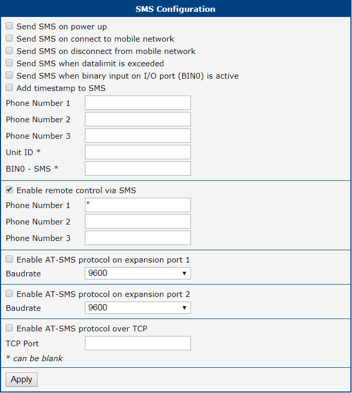

SMS
Open the SMS page in the Services submenu of the Configuration section of the main menu. The router can automatically send SMS messages to a cell phone or SMS message server when certain events occur. The form allows you to select which events generate an SMS message.
| Send SMS on power up | Activates/deactivates the sending of an SMS message automatically on power up. |
| Send SMS on connect to mobile network | Activates/deactivates the sending of an SMS message automatically when the router connects to a mobile network. |
| Send SMS on disconnect from mobile network | Activates/deactivates the sending of an SMS message automatically when the router disconnects from a mobile network. |
| Send SMS when datalimit is exceeded | Activates/deactivates the sending of an SMS message automatically when the data limit is exceeded. |
| Send SMS when binary input on I/O port (BIN0) is active | Automatic sending of an SMS message after the binary input on the I/O port (BIN0) is active. The text of the message is the BIN0 parameter. |
| Add timestamp to SMS | Activates/deactivates the adding of a timestamp to the SMS messages. This timestamp has a fixed format YYYY-MM-DD hh:mm:ss. |
| Phone Number 1 | Specifies the first phone number to which the router sends the generated SMS. |
| Phone Number 2 | Specifies the second phone number to which the router sends the generated SMS. |
| Phone Number 3 | Specifies the third phone number to which the router sends the generated SMS. |
| Unit ID | The name of the router. The router sends the name in the SMS. |
| BIN0 - SMS | Text of the SMS message when the first binary input is activated. |
| BIN1 - SMS | Text of the SMS message when the second binary input is activated. |
Remote Control via SMS
The router can be controlled by sending specific commands via SMS from an authorized phone number. To activate this functionality, enable it and specify at least one authorized number.
| Phone Number 1 | Specifies the first phone number allowed to access the router using an SMS. |
| Phone Number 2 | Specifies the second phone number allowed to access the router using an SMS. |
| Phone Number 3 | Specifies the third phone number allowed to access the router using an SMS. |
The table below lists all supported control commands. Note that most commands trigger temporary actions that are reverted upon reboot; only the set profile command makes a permanent change to the router's configuration. To control the router, send an SMS containing only the command text:
SMS | Description |
| go online sim [1|2] | Switches the active mobile connection to the specified SIM card. |
| go online | Switch the router to the online mode. |
| go offline | Switch the router to the offline mode. |
| set outx=0 | Set digital output x to 0. Example: set out0=0. |
| set outx=1 | Set digital output x to 1. Example: set out0=1. |
| set profile std | Set the standard profile. This change is permanent. |
| set profile alt1 | Set alternative profile 1. This change is permanent. |
| set profile alt2 | Set alternative profile 2. This change is permanent. |
| set profile alt3 | Set alternative profile 3. This change is permanent. |
| reboot | Reboot the router. |
| get ip | Responds with the current IPv4 address of the active mobile connection. |
| get ipv6 | Responds with the current IPv6 address of the active mobile connection. |
Info
For advanced users, custom SMS processing can be implemented using a script at /var/scripts/sms. This script is invoked only for messages that are NOT processed as standard control commands (e.g., messages with unknown text or from unauthorized numbers). The Enable remote control via SMS option must be enabled for the script to run.
The script receives arguments indicating the sender's authorization status. This allows you to implement custom logic for unhandled messages. The script file does not require execute permissions (chmod +x). For more details, see the Extending Router Functionality application guide, chapter Handling Incoming SMS with a Custom Script.
AT-SMS Protocol
The AT-SMS protocol provides direct access to the router's cellular module using standard AT commands. This allows for advanced management of SMS messages and retrieval of detailed module status information.
Setting the parameters in the Enable AT-SMS protocol over TCP frame, you can enable the router to use the AT-SMS protocol on a TCP port. This function requires you to specify a TCP port number.

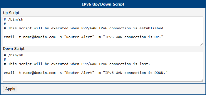

Scripts
The router provides several hooks for executing custom shell scripts in response to system and network events. This powerful feature allows for a high degree of automation and customization. The available script types are:
- Startup Script: Executed once every time the router boots up.
- Up/Down IPv4 Scripts: Executed when the primary IPv4 WAN connection is established or lost.
- Up/Down IPv6 Scripts: Executed when the primary IPv6 WAN connection is established or lost.
For detailed information about available commands, refer to the Command Line Interface application guide. For broader guidance on customization, see the Extending Router Functionality application guide.
Startup
The Startup Script is ideal for tasks that need to run once at boot, such as initializing custom services, performing configuration checks, or launching background monitoring processes. The script is entered into the text area on the Configuration → Scripts page and saved by clicking the Apply button.
Warning
Changes to the startup script only take effect after the router is rebooted.
Script Example
The following script sends an SMS message upon router startup.
#!/bin/sh
# Define variables
PhoneNumber="+420123456789"
Message="Router has successfully started up."
# Send the SMS
sms "$PhoneNumber" "$Message"
exit 0Up/Down IPv4
The Up/Down IPv4 page allows you to define scripts that are triggered by changes in the primary WAN IPv4 connection state. The "Up" script runs when the IPv4 connection is established, and the "Down" script runs when it is lost. Because the router has a dual-stack implementation, scripts for IPv4 and IPv6 are configured and triggered independently.

Script Example
This example uses the IPv6 Up/Down scripts to send an email notification whenever the IPv6 WAN connection status changes. The SMTP service must be configured beforehand.
Up Script:email -t name@domain.com -s "Router Alert" -m "IPv6 WAN connection is UP."
Down Script:email -t name@domain.com -s "Router Alert" -m "IPv6 WAN connection is DOWN."
Warning
After saving an Up/Down script, the router must be rebooted for the changes to become active.
