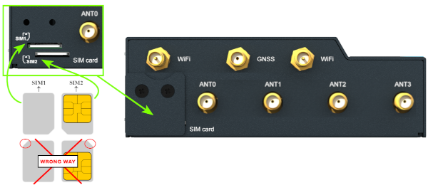

SIM Card Slots
The router has two SIM card slots located beneath a metal cover. To communicate over a cellular network, insert an activated, data-provisioned SIM card into a SIM card slot. You can install two SIM cards simultaneously to use the SIM switching feature. You can configure each SIM card with a different APN (Access Point Name).
Tips
SIM card type: Micro SIM (3FF) — 15.0 × 12.0 × 0.76 mm.
Changing the SIM Card
- Always disconnect the router from the power supply before handling the SIM card.
- Unscrew the two screws on the SIM card cover and remove the cover.
- To remove an inserted SIM card, use the flat end of a spudger or your fingernail. Press the card slightly into its slot until you hear a click. Release the card; it will pop out of its slot.
- To insert a SIM card, push the card into the slot until it clicks into place.
- Replace the cover and tighten the two screws.
If the SIM card requires a PIN, enter it in the router's web interface under Administration → Unlock SIM Card.
Antenna Connections
Four SMA female connectors — ANT0, ANT1, ANT2, and ANT3 — are provided for connecting cellular antennas to the router. On model ICR-1745-EU, a dedicated GNSS SMA female connector is also provided for the GNSS antenna. RP-SMA female connectors labeled WIFI are provided for connecting Wi-Fi antennas on models that support Wi-Fi.
Warning
Always operate the router with a cellular antenna securely connected to each cellular antenna connector. Transmitting without an antenna attached causes RF energy to be reflected at the open connector, which can permanently damage the radio circuitry. Ensure all antennas are properly installed before powering on or transmitting.
Tips
The recommended tightening torque for the antenna SMA connectors is 0.9 Nm.
