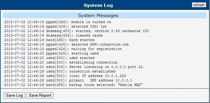

System Log
To view the router's operational logs, navigate to the Status → System Log page. This page displays messages generated by the router's operating system and various services.
Info
For security, sensitive data such as passwords is automatically filtered out from the system log and diagnostic reports.
The level of detail in the log is controlled by the Minimum Severity setting on the Configuration → Services → Syslog page.
The router manages log storage to prevent files from growing indefinitely. By default, the total log size is limited to 1000 KiB, split between two rotating files. When the current file is full, the system switches to the other. Once both are full, new entries overwrite the oldest ones. The Log Size Limit can be adjusted on the Syslog configuration page.
The System Log page provides several options for downloading diagnostic information:
Save Log: Downloads the current contents of the system log as a plain text file (
*.log).Save Report: Generates and downloads a comprehensive diagnostic report file (
*.txt), which is essential for troubleshooting and providing to technical support. The report always contains the following information:- General system information and status
- Network statistics and current routing tables
- A list of all running processes
- Filesystem usage information
- The complete system log
Tips
For users logged in with the Admin role, the report additionally includes a copy of the current router configuration. This section is omitted for standard users.
