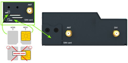

SIM Card Slots
The router has two SIM card slots located beneath a metal cover. To communicate over a cellular network, insert an activated, data-provisioned SIM card into a SIM card slot. You can install two SIM cards simultaneously to use the SIM switching feature. You can configure each SIM card with a different APN (Access Point Name).
Tips
SIM card type: Micro SIM (3FF) — 15.0 × 12.0 × 0.76 mm.
Changing the SIM Card
- Always disconnect the router from the power supply before handling the SIM card.
- Unscrew the two screws on the SIM card cover and remove the cover.
- To remove an inserted SIM card, use the flat end of a spudger or your fingernail. Press the card slightly into its slot until you hear a click. Release the card; it will pop out of its slot.
- To insert a SIM card, push the card into the slot until it clicks into place.
- Replace the cover and tighten the two screws.
If the SIM card requires a PIN, enter it in the router's web interface under Administration → Unlock SIM Card.

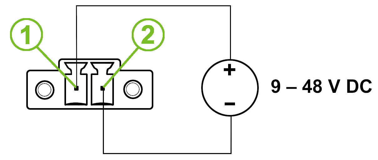

Power Supply
A two-pin terminal connector (pitch 3.5 mm) is used to power the router. The matching connector is included as a standard accessory.
| Pin | Signal | Description |
| 1 | VCC(+) | Positive pole of DC supply voltage (+9 to +48 V DC) |
| 2 | GND(−) | Negative pole of DC supply voltage |
The required supply voltage is +9 to +48 V DC. The router has built-in protection against reversed polarity without signaling.

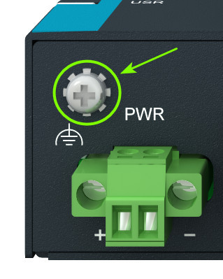

Warning
- Grounding the router using the grounding screw eliminates the protection against reversed polarity. Ensure the negative pole of the DC supply shares the same voltage reference as the grounding screw. A voltage difference between these points may damage the router; only an authorized service center can perform repairs.
- Use a power supply specified as a Limited Power Source (LPS) or a CEC/NEC Class 2 power supply.
Tips
The power supply common pole is not connected to the router's metal chassis or internal ground.
To protect the router, ground it using the grounding screw as shown below. The maximum tightening torque for the grounding screw is 0.6 Nm.

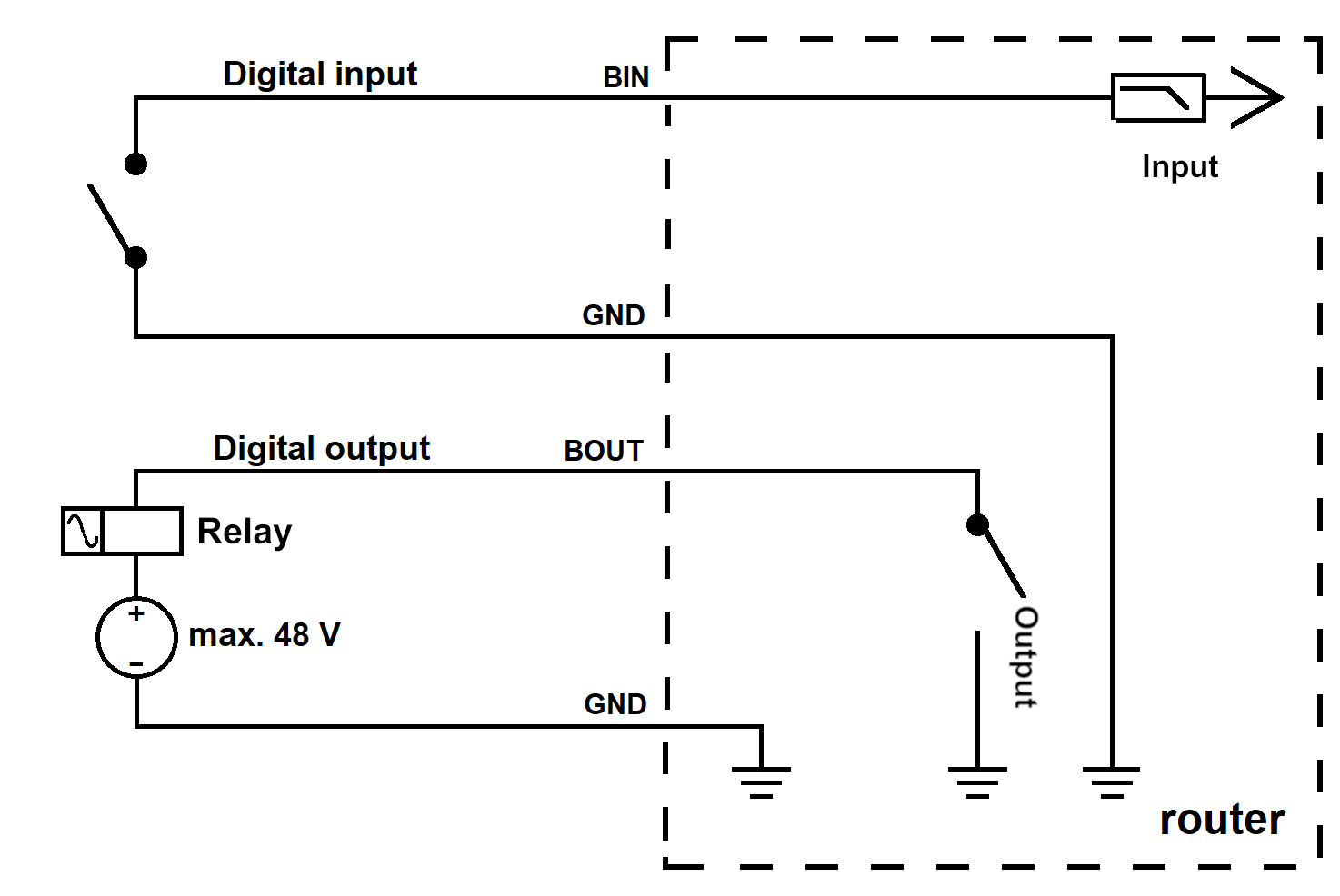

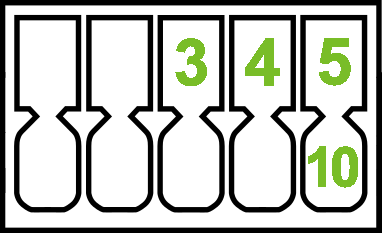

I/O Port Interfaces
The I/O interface provides one digital input and one digital output on a 10-pin terminal block.
| 3 | BIN | Digital input |
| 4 | BOUT | Digital output |
| 5, 10 | GND | Ground (common negative pole) |
Tips
The I/O interface is not electrically isolated from the router.

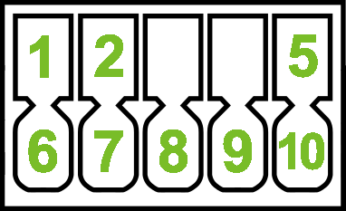

Serial Interfaces
The RS-232 and RS-485 serial interfaces share the same 10-pin terminal block as the I/O port. Both interfaces are active simultaneously.
RS-232:
| 6 | TXD | Transmit Data |
| 7 | RXD | Received Data |
| 8 | RTS | Request to Send |
| 9 | CTS | Clear to Send |
| 10 | GND | Ground |
RS-485:
| 1 | D (+) | In/Out |
| 2 | D (−) | In/Out |
| 5 | GND | Ground |
Tips
The serial interfaces are not electrically isolated from the router.
