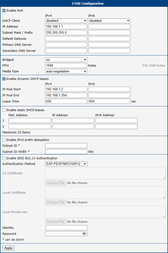

To enter the Local Area Network configuration, select the Ethernet menu item in the Configuration section. The Ethernet item will expand in the menu on the left, allowing you to choose the appropriate Ethernet interface to configure: ETH0 for the first Ethernet interface and ETH1 for the second Ethernet interface.
The LAN Configuration page is divided into IPv4 and IPv6 columns, as shown in Figure below. There is dual stack support for IPv4 and IPv6 protocols, meaning they can run concurrently. You can configure either one of them or both. If both IPv4 and IPv6 are configured, network devices will automatically select the communication protocol. The configuration items and differences between IPv6 and IPv4 are described in the tables below.
| Item | Description |
| Enable Port | Enables or disables the physical Ethernet port. |
| DHCP Client | Enables or disables the DHCP client function. If in the IPv6 column, the DHCPv6 client is enabled. The DHCPv6 client supports all three methods of obtaining an IPv6 address: SLAAC, stateless DHCPv6, and stateful DHCPv6. Options: • disabled: The router does not allow automatic allocation of an IP address from a DHCP server in the LAN network. • enabled: The router allows automatic allocation of an IP address from a DHCP server in the LAN network. |
| IP Address | A fixed IP address for the Ethernet interface. Use IPv4 notation in the IPv4 column and IPv6 notation in the IPv6 column. Shortened IPv6 notation is supported. |
| Subnet Mask / Prefix | Specifies the subnet mask for the IPv4 address. In the IPv6 column, fill in the prefix for the IPv6 address: a number in the range of 0 to 128. |
| Default Gateway | Specifies the IP address of the default gateway. If provided, every packet with a destination not found in the routing table is sent to this IP address. Use the correct IP address notation in both the IPv4 and IPv6 columns. |
| Primary DNS Server | Specifies the primary IP address of the DNS server. When the IP address is not found in the routing table, the router forwards the request to the DNS server specified here. Use the correct IP address notation in both the IPv4 and IPv6 columns. |
| Secondary DNS Server | Specifies the secondary IP address of the DNS server. |
The Default Gateway and DNS Server items are only used if the DHCP Client is set to disabled and if the ETH0 or ETH1 LAN is selected by the Backup Routes system as the default route.

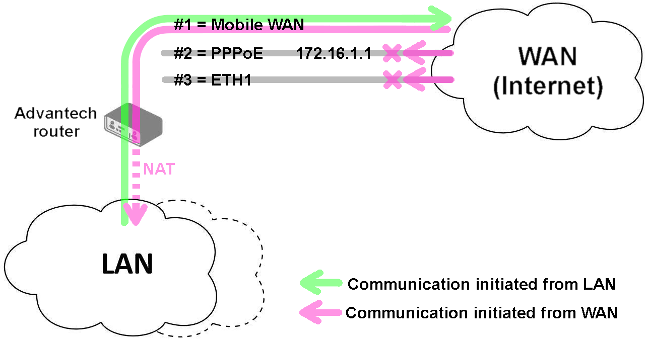

Warning
Under certain conditions, the ETH interface may operate as a WAN interface, and the rules defined in the Firewall settings will be applied to it. Details are described in Backup Routes and are demonstrated with examples provided there.

DHCP Server
The DHCP server assigns the IP address, gateway IP address (IP address of the router) and IP address of the DNS server (IP address of the router) to the connected clients. If these values are filled in by the user in the configuration form, they will be preferred.
The DHCP server supports static and dynamic assignment of IP addresses. Dynamic DHCP assigns clients IP addresses from a defined address space. Static DHCP assigns IP addresses that correspond to the MAC addresses of connected clients.
Info
- If IPv6 column is filled in, the DHCPv6 server is used. DHCPv6 server offers stateful address configuration to connected clients. Only when the Subnet Prefix above is set to 64, the DHCPv6 server offers both: the stateful address configuration and SLAAC (Stateless Address Autoconfiguration).
- For DHCPv6 static address assignment to work, DHCPv6 client must use DUID-LL or DUID-LLT types that are derived from its MAC address.
Warning
Do not to overlap ranges of static allocated IP addresses with addresses allocated by the dynamic DHCP server. IP address conflicts and incorrect network function can occur if you overlap the ranges.
Configuration of Dynamic DHCP Server
| Enable dynamic DHCP leases | Select this option to enable a dynamic DHCP server. |
| IP Pool Start | Starting IP addresses allocated to the DHCP clients. Use proper notation in IPv4 and IPv6 column. |
| IP Pool End | End of IP addresses allocated to the DHCP clients. Use proper IP address notation in IPv4 and IPv6 column. |
| Lease time | Time in seconds that the IP address is reserved before it can be re-used. |
Configuration of Static DHCP Server
| Enable static DHCP leases | Select this option to enable a static DHCP server. You can define up to thirty-two rules. A new row for defining the next rule appears automatically after filling in the previous one. |
| MAC Address | MAC address of a DHCP client. |
| IPv4 Address | Assigned IPv4 address. Use proper notation. |
| IPv6 Address | Assigned IPv6 address. Use proper notation. |
IPv6 Prefix Delegation
Warning
This is an advanced configuration option. IPv6 prefix delegation works automatically with DHCPv6: use only if different configuration is desired and if you know the consequences.
If you want to override the automatic IPv6 prefix delegation, you can configure it in this form. You have to know your Subnet ID Width (part of IPv6 address), see the figure below for the calculation help: it is an example: 48 bits is Site Prefix, 16 bits is Subnet ID (Subnet ID Width) and 64 bits is Interface ID.
| Enable IPv6 prefix delegation | Enables prefix delegation configuration filled-in below. |
| Subnet ID | The decimal value of the Subnet ID of the Ethernet interface. Maximum value depends on the Subnet ID Width. |
| Subnet ID Width | The maximum Subnet ID Width depends on your Site Prefix: it is the remainder to 64 bits. |
802.1X Authentication with RADIUS Server
IEEE 802.1X is an IEEE standard for port-based Network Access Control (PNAC). It provides an authentication mechanism for devices connecting to a LAN or WLAN using "EAP over LAN" (EAPoL), which encapsulates the Extensible Authentication Protocol (EAP).
IEEE 802.1X authentication involves three parties: a supplicant, an authenticator, and an authentication server, illustrated in the figure below.
- The supplicant is a client device (e.g., a laptop) requesting network access.
- The authenticator is a network device (e.g., a switch or router) that controls network access and mediates communication with the authentication server.
- The authentication server (typically a RADIUS server) validates the supplicant's credentials and authorizes or denies access.
Info
Advantech routers can function as a supplicant or an authenticator, but not as an authentication server.
| Interface | Supplicant Role | Authenticator Role |
| LAN | As a built-in feature, configure LAN with 802.1X authentication. | While not a built-in feature, it can be facilitated by the 802.1X Authenticator Router App. |
| WiFi | In Station (STA) mode. | In Access Point (AP) mode. |
The 802.1X supplicant can be enabled in the section below. This requires configuring an identity and, for EAP-TLS, certificates.
| Enable IEEE 802.1X Authentication | Enables the 802.1X supplicant on this interface. |
| Authentication Method | Selects the authentication method (EAP-PEAP/MSCHAPv2 or EAP-TLS). |
| CA Certificate | Defines the CA certificate for the EAP-TLS protocol. |
| Local Certificate | Defines the local certificate for the EAP-TLS protocol. |
| Local Private Key | Defines the local private key for the EAP-TLS protocol. |
| Identity | The username (identity) for authentication. |
| Password | The password for authentication (used only for EAP-PEAP/MSCHAPv2). |
| Local Private Key Password | The password for the local private key (used only for EAP-TLS). |

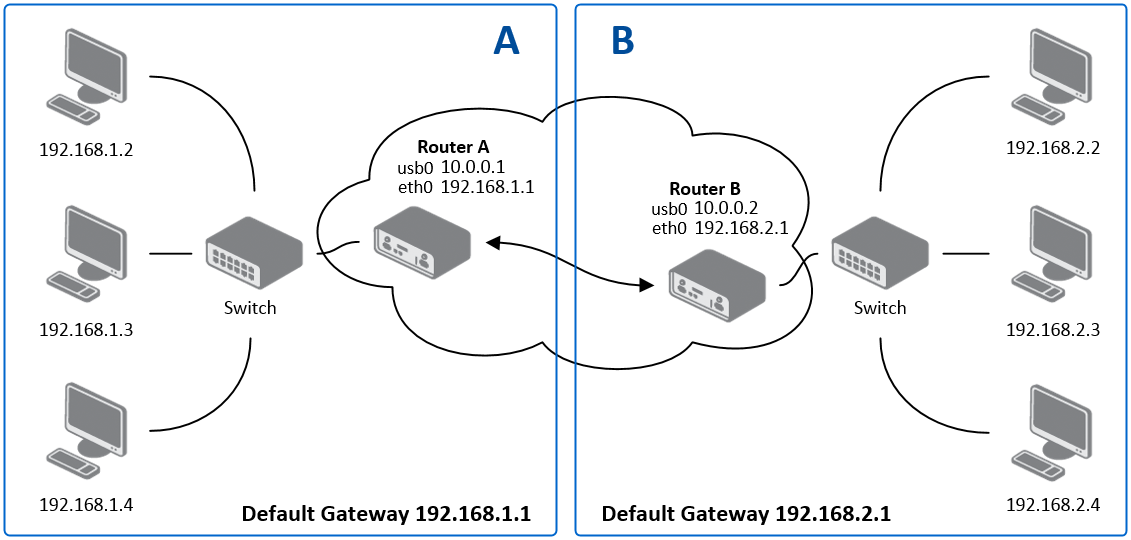

LAN Configuration Examples

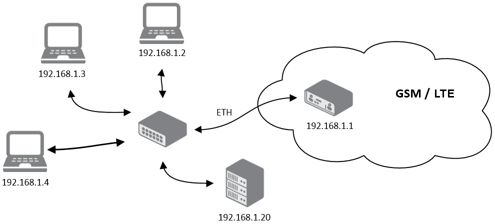

Example 1: IPv4 Dynamic DHCP Server, Default Gateway and DNS Server
- The range of dynamic allocated IPv4 addresses is from 192.168.1.2 to 192.168.1.4.
- The address is allocated for 600 second (10 minutes).
- Default gateway IP address is 192.168.1.20
- DNS server IP address is 192.168.1.20

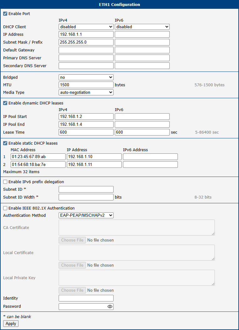

Example 2: IPv4 Dynamic and Static DHCP server
- The range of allocated addresses is from 192.168.1.2 to 192.168.1.4.
- The address is allocated for 600 seconds (10 minutes).
- The client with the MAC address 01:23:45:67:89:ab has the IP address 192.168.1.10.
- The client with the MAC address 01:54:68:18:ba:7e has the IP address 192.168.1.11.

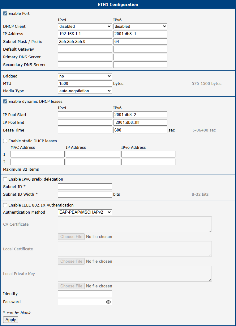

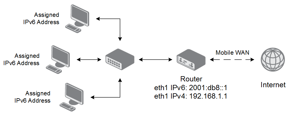

Example 3: IPv6 Dynamic DHCP Server
- The range of dynamic allocated IPv6 addresses is from 2001:db8
ffff. - The address is allocated for 600 second (10 minutes).
- The router is still accessible via IPv4 (192.168.1.1).

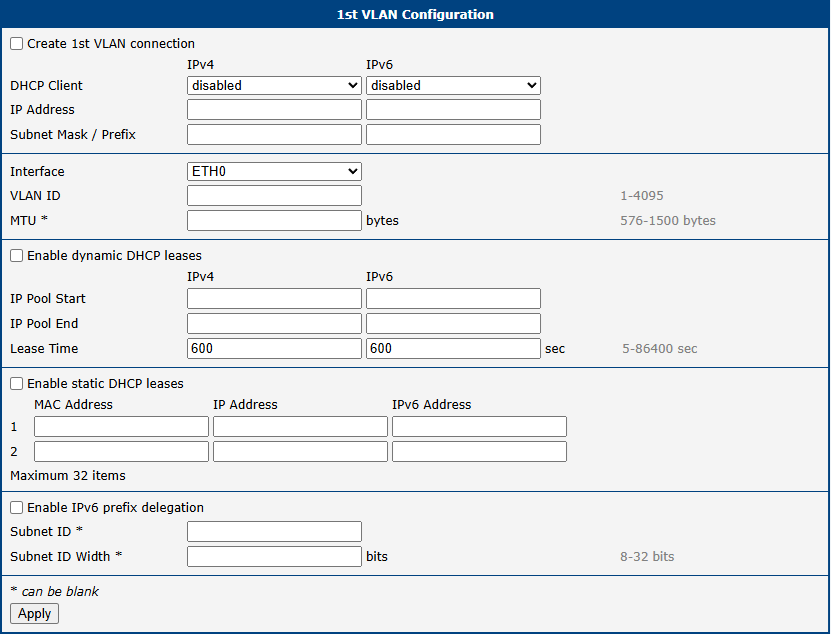

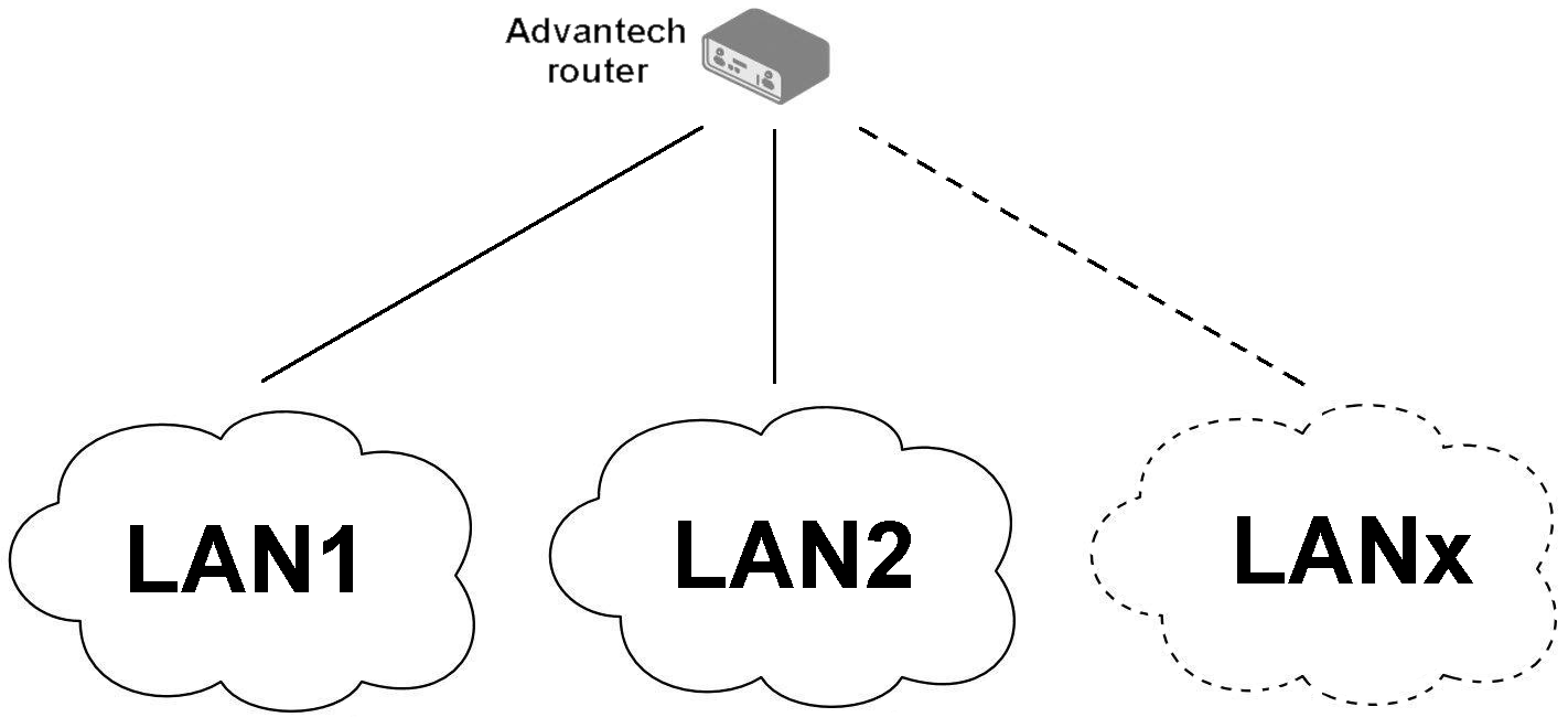

VLAN
The router allows for the creation of up to three separate Virtual LAN (VLAN) interfaces, enabling network segmentation for enhanced security and traffic management. Each VLAN can be configured with its own IP address, DHCP server, and other network settings, effectively creating an independent logical network on a shared physical interface.
The VLAN configuration page, accessible via Configuration → VLAN, is divided into sections for interface setup, DHCP services, and IPv6 prefix delegation.
| Create VLAN connection | Enables the creation and configuration of this VLAN interface. |
| DHCP Client (IPv4/IPv6) | Enables or disables the DHCP client for the VLAN interface. When enabled, the interface will request an IP address from a DHCP server on the network. |
| IP Address | Assigns a static IPv4 or IPv6 address to the VLAN interface. |
| Subnet Mask / Prefix | Defines the subnet mask (for IPv4) or prefix length (for IPv6) for the static IP address. |
| Interface | Selects the parent physical Ethernet interface (ETH0 or ETH1) to which this VLAN will be bound. |
| VLAN ID | Specifies the unique identifier (1–4095) for the VLAN. This ID is used to tag traffic belonging to this virtual network. |
| MTU | Sets the Maximum Transmission Unit (MTU) in bytes for this VLAN interface. If left blank, the default value of the parent interface is used. |
| Enable dynamic DHCP leases | Enables the built-in DHCP server for this VLAN, which can dynamically assign IPv4 and IPv6 addresses to clients. • IP Pool Start: The first IP address in the DHCP assignment pool. • IP Pool End: The last IP address in the DHCP assignment pool. • Lease Time: The duration in seconds for which an IP address is leased to a client (default is 600). |
| Enable static DHCP leases | Enables static IP address assignments based on a client's MAC address. Up to 32 static leases can be defined for each address family (IPv4 and IPv6). • MAC Address: The hardware address of the client device. • IP Address: The fixed IPv4 address to be assigned to the client. • IPv6 Address: The fixed IPv6 address to be assigned to the client. |
| Enable IPv6 prefix delegation | Configures the router to request a block of IPv6 addresses from an upstream router, which can then be used to assign addresses to clients on this VLAN. • Subnet ID: The identifier for the requested subnet. • Subnet ID Width: The size of the subnet ID in bits. |

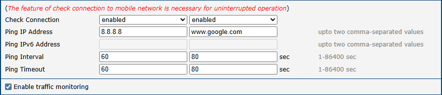

Connection Checking
The Check connection feature adds a crucial layer of reliability by actively testing the health of the router's WAN connection. While VRRP itself detects router failures, this feature can detect upstream network outages even if the router is still running.
When enabled, the Master router periodically sends ICMP echo requests (pings) to a specified target IP address. If no replies are received after a configurable number of attempts, the router assumes the connection has failed and lowers its VRRP priority, triggering a failover to a Backup router.
Info
For reliable connection monitoring, ping a stable public IP address (e.g., a public DNS server like 8.8.8.8). In a private network, you can ping a remote gateway that is directly accessible or available via a VPN.
The Enable traffic monitoring option optimizes this process by suspending ping tests as long as any other traffic is received on the interface. This confirms the connection is active and reduces unnecessary data usage.
| Ping IP Address | The destination IP address for the ICMP echo requests. Domain names are not supported. |
| Ping Interval | The time in seconds between each ping request. |
| Ping Timeout | The time in seconds to wait for a response to each ping. |
| Ping Probes | The number of consecutive failed pings before the connection is declared down. |

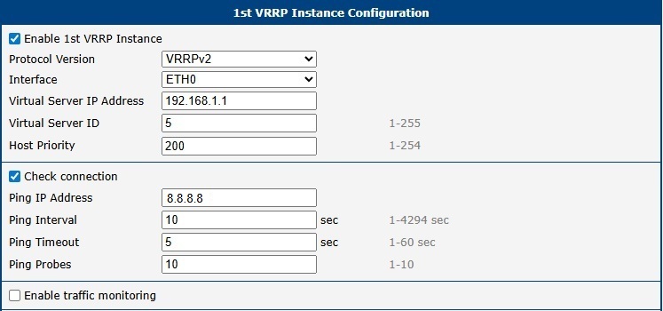

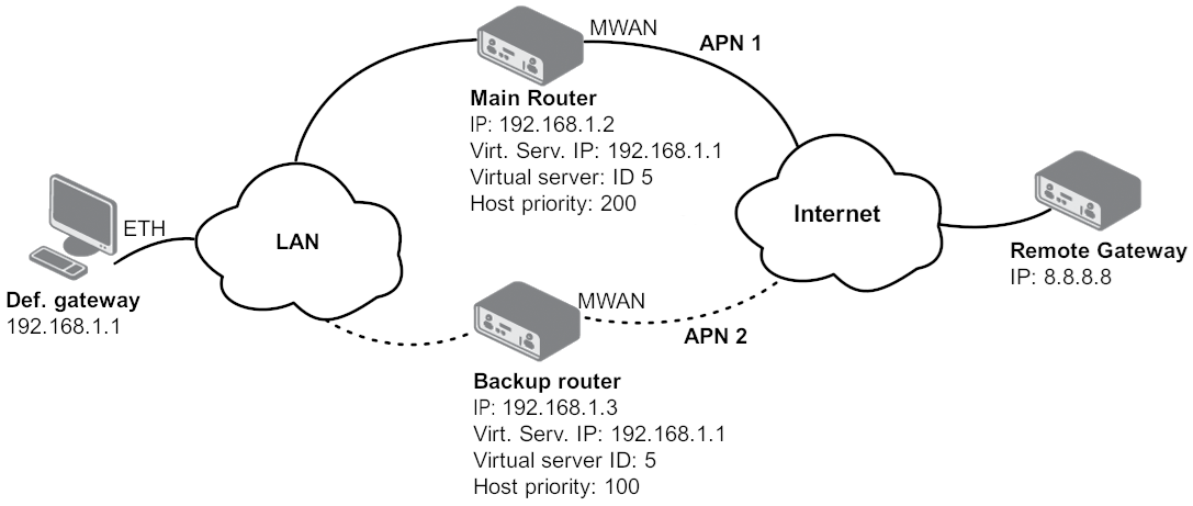

VRRP Example
This example illustrates a high-availability topology using two routers, each with an independent cellular connection. For maximum redundancy, APN 1 and APN 2 are provided by different mobile operators.
- LAN Side: Both routers share the Virtual IP address 192.168.1.1 (Virtual Server ID 5). LAN clients use this IP as their default gateway, unaware of the physical routers.
- Priorities: The Main router (Real IP 192.168.1.2) is configured with a higher priority of 200, making it the Master. The Backup router (Real IP 192.168.1.3) has a lower priority of 100.
- WAN Side: To ensure end-to-end connectivity, both routers monitor a reliable public target (8.8.8.8) via their respective cellular WAN interfaces.
If the Main router fails to receive a ping response from 8.8.8.8, it automatically lowers its priority. The Backup router then becomes the new Master and takes over the Virtual IP, ensuring uninterrupted Internet access for all LAN clients.
Configure the Backup router identically to the Main router, with one exception: set the Host Priority to 100. The Check connection settings should remain the same.

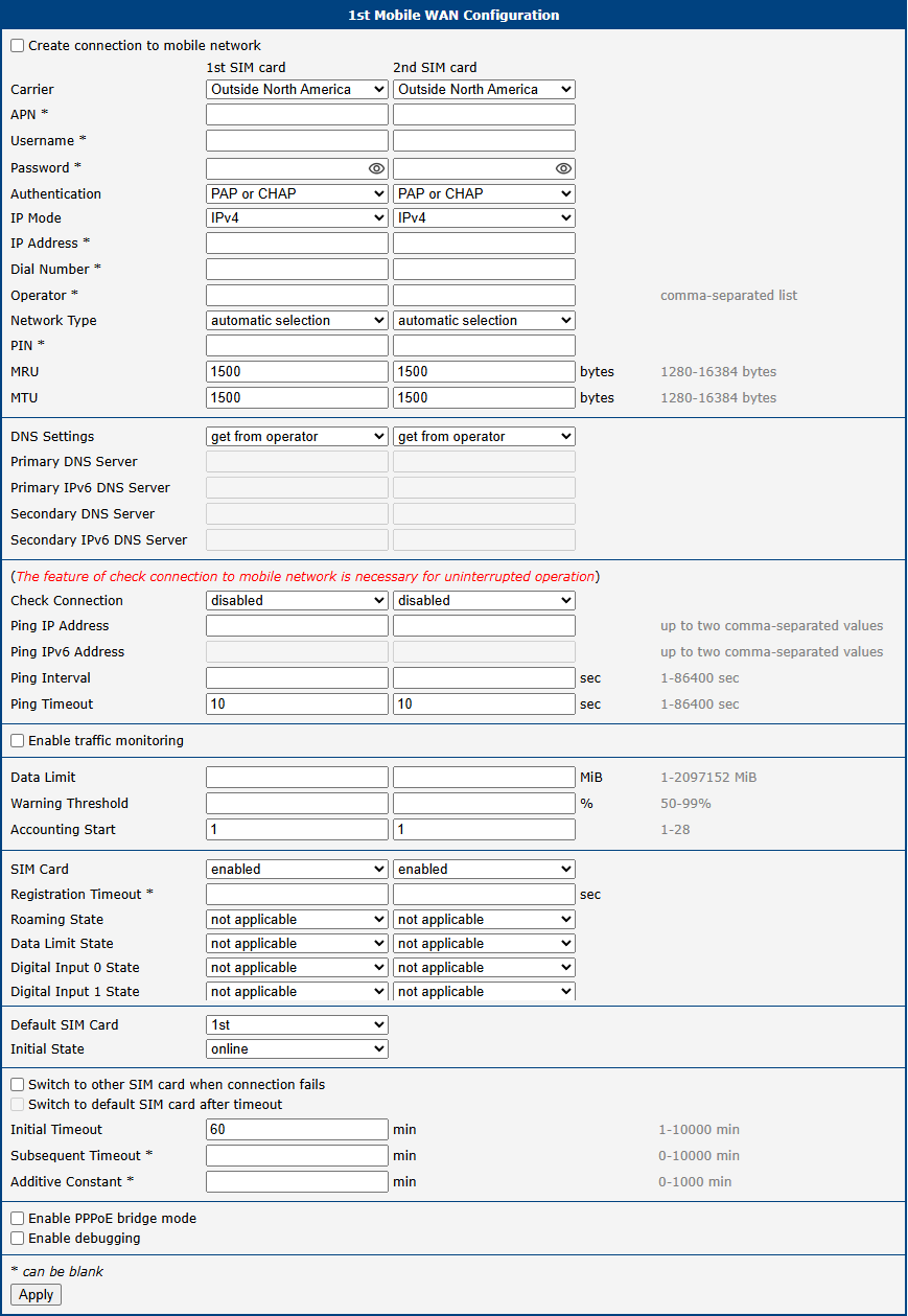

Select the Mobile WAN item in the Configuration menu to open the cellular network configuration page.
Connection to Mobile Network
Info
- Starting with firmware version 6.6.0, PLMN whitelisting is now an integrated firmware feature, available in the Operator field. This native functionality replaces the legacy PLMN Whitelist Router App.
- To avoid potential conflicts, disable or uninstall the legacy Router App before using the integrated PLMN whitelisting feature.
If the Create connection to mobile network checkbox is checked, the router will automatically attempt to establish a connection after booting up. You can specify the following parameters for each SIM card separately.
| Carrier | Allows for manual or automatic selection of a mobile network carrier. This is primarily available for global or NAM (North American) certified models. • For non-NAM or global models, the Outside North America option restricts connections to non-NAM operators. • For NAM-certified models, choices typically include: ◦ North America, Autoselect: Automatically detects and connects to a suitable NAM operator. ◦ North America, Generic: Enables a generic, PTCRB-compliant configuration. ◦ Manual selection of specific operators like AT&T, Rogers, T-Mobile, or Verizon. |
| APN | The Access Point Name (APN) of the mobile network. |
| Username | The username for logging into the mobile network. |
| Password | The password for logging into the mobile network. |
| Authentication | The authentication protocol used by the network. Both Username and Password must be specified for this setting to apply. • PAP or CHAP: The router automatically selects the authentication method. • PAP: Forces PAP authentication. • CHAP: Forces CHAP authentication. |
| IP Mode | The version of the IP protocol to be used. • IPv4: Use only the IPv4 protocol (default). • IPv6: Use only the IPv6 protocol. • IPv4/IPv6: Enable an independent dual stack for both IPv4 and IPv6. |
| IP Address | The IP address of the SIM card (for IPv4 and IPv4/IPv6 modes only). Enter this manually only if the carrier has assigned a static IP address. |
| Dial Number | The number the router dials for a CSD connection. The default is *99***1#. |
| Operator | Specifies the preferred mobile network operator using the carrier’s PLMN code. The behavior depends on the input: • Empty field: The router operates in automatic mode, connecting to any available network. • Single PLMN: The router locks to the specified operator and connects only to that network. • Comma-separated list (whitelist): By providing two or more PLMNs, you create a whitelist of allowed operators. Upon connecting or if the current network is not on the list, the router will perform a network scan (which may take up to two minutes) and connect to the first operator from your list that it finds available. • Whitelist with automatic fallback: Prefix the list with 0, (e.g., 0,23001,90001) to first connect automatically and then switch to a whitelisted operator if needed. |
| Network Type | Specifies the preferred mobile network technology. Available options depend on the router model and may include: • automatic selection: Allows the router to choose the best available technology automatically. It never selects NB-IoT; for NB-IoT connectivity, select the NB-IoT option explicitly. • GPRS/EDGE • UMTS/HSPA • LTE • NB-IoT • LTE-M • NR5G: Equivalent to 5G SA (Standalone). Note: 5G NSA (Non-Standalone) is a combination of LTE and 5G technologies and functions only when automatic selection is enabled. |
| PIN | The Personal Identification Number used to unlock the SIM card. Use this only if required by the SIM card. The card will be blocked after several failed attempts. |
| MRU | Maximum Receive Unit: the maximum packet size the router can receive. Default is 1500 B. Incorrect values may cause data reception errors. Minimum: 128 B for IPv4, 1280 B for IPv6. |
| MTU | Maximum Transmission Unit: the maximum packet size the router can transmit. Default is 1500 B. Incorrect values may cause data transmission errors. Minimum: 128 B for IPv4, 1280 B for IPv6. |
Info
- An incorrect MTU size may cause data transfer failures. A value that is too low increases fragmentation and overhead, while a value that is too high can cause packets to be dropped by the network.
- If the IP Address field is left blank, the carrier will automatically assign an IP address. Manual assignment can result in a faster connection.
- If the APN field is left blank, the router will attempt to auto-select an APN based on the SIM card’s IMSI. The selected APN name can be found in the System Log.
- To use a blank APN, enter the word
blankin the APN field.
Warning
An incorrect PIN will block the SIM card after several failed attempts.
Parameters marked with an asterisk (*) are required only if specified by your mobile network operator. If the router fails to connect, verify the accuracy of all entered data and consider trying a different authentication method or network type.
DNS Configuration
The DNS Settings parameter simplifies client-side configuration. When set to get from operator, the router automatically obtains the primary and secondary DNS server IP addresses from the carrier. To specify them manually, select set manually and enter the IPv4 or IPv6 addresses, depending on the selected IP Mode.
Network Connection Check
Warning
Enabling the Check Connection function is essential for ensuring uninterrupted operation of the router.
If Check Connection is set to enabled or enabled + bind, the router sends ping requests to the destinations specified in Ping IP Address or Ping IPv6 Address at regular intervals defined by Ping Interval. If you specify two addresses, the router considers the connection functional if at least one of the destinations responds; a connection failure is triggered only if both destinations are unreachable.
If a ping fails, a new one is sent after the Ping Timeout. If three consecutive pings fail (or three rounds of pings to both addresses), the router terminates and re-establishes the cellular connection. This monitoring function can be configured for each SIM card but runs only on the active SIM. Ensure you use reliable destination addresses, such as the operator’s DNS server or public DNS services.
If Check Connection is set to enabled, ping requests are sent based on the routing table and may use any available interface. To ensure pings are sent only through the mobile WAN interface, set it to enabled + bind. The disabled option deactivates connection checking.
Warning
For routers connected to the Verizon network, the connection retry interval increases with each attempt. The first two retries occur after 1 minute, followed by intervals of 2, 8, and 15 minutes. The ninth and all subsequent retries occur every 90 minutes.
If Enable Traffic Monitoring is checked, the router monitors Mobile WAN traffic instead of sending pings. If no data is transmitted, it will begin sending pings.
| Ping IP Address | The destination IPv4 address or domain name for ping queries. You can specify up to two comma-separated values. If two addresses are provided, the connection is considered failed only when neither responds. Available in IPv4 and IPv4/IPv6 modes. |
| Ping IPv6 Address | The destination IPv6 address or domain name for ping queries. You can specify up to two comma-separated values. If two addresses are provided, the connection is considered failed only when neither responds. Available in IPv6 and IPv4/IPv6 modes. |
| Ping Interval | The time interval between outgoing pings. |
| Ping Timeout | The time (in seconds) to wait for a ping response. |

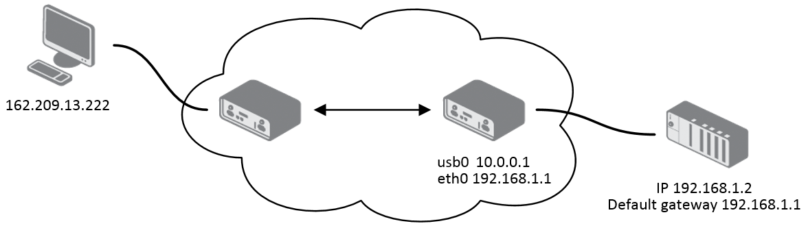

Connection Check Example
The figure below shows a scenario where the IPv4 connection is monitored by pinging 8.8.8.8 every 60 seconds for the first SIM card and www.google.com every 80 seconds for the second SIM card. Since Enable traffic monitoring is active, pings are only sent if no other data traffic is detected.
Data Limit Settings
Info
The Data Limit parameters serve two independent functions:
- SMS Warning: Triggered based on the Warning Threshold. Requires the Send SMS when data limit is exceeded option to be enabled in Services → SMS.
- SIM Switching: To force the router to switch to another SIM once the limit is reached, the Data Limit State in the lower part of the form must be set to not exceeded. If left as not applicable, the limit is ignored for switching purposes.
| Data Limit | The maximum amount of data (sent and received) allowed per billing period (one month). The maximum configurable value is 2 TB (2,097,152 MB). |
| Warning Threshold | A percentage of the Data Limit (ranging from 50% to 99%). When this threshold is exceeded, the router sends an SMS message. |
| Accounting Start | The day of the month when the billing cycle begins. The router starts counting data from this day. |
SIM Card Switching
In the lower part of the form, you can specify rules for switching between SIM cards.
Info
The router automatically switches between SIMs based on the logical AND of all configured rules (manual permission, roaming, data limit, and digital input state).
| SIM Card | Enables or disables the use of a SIM card. Setting all SIMs to disabled deactivates the cellular module. |
| Registration Timeout | Sets the registration timeout for the SIM card in seconds (default is 2 minutes). |
| Roaming State | Configures SIM usage based on roaming status (must be activated by your operator). • not applicable: Use the SIM everywhere. • home network only: Use the SIM only when not roaming. |
| Data Limit State | Configures SIM usage based on the data limit. • not applicable: Use the SIM regardless of the data limit. • not exceeded: Use the SIM only if the data limit has not been exceeded. |
| BINx State | Configures SIM usage based on digital input x state. • not applicable: Use the SIM regardless of the input state. • on: Use the SIM only if the input is on (voltage present). • off: Use the SIM only if the input is off (no voltage). |
Use the following parameters to specify the behavior of SIM card switching.
| Default SIM Card | Specifies the primary SIM card the router should use to connect. |
| Initial State | The action the module takes after a SIM is selected. • online: Establish a connection immediately (default). • offline: Remain offline. The state can be changed via SMS. The module will also go offline if no SIM card meets the switching criteria. |
| Switch to other SIM card when connection fails | If enabled, the router switches to the backup SIM card if the connection on the default SIM fails (as detected by the Check Connection feature). |
| Switch to default SIM card after timeout | If enabled, the router will attempt to switch back to the default SIM after a specified timeout. Applies only if the switch was triggered by a connection failure or roaming. Requires Switch to other SIM card when connection fails to be enabled. |
| Initial Timeout | The time (1 to 10,000 minutes) the router waits before the first attempt to switch back to the default SIM. |
| Subsequent Timeout | The time (0 to 10,000 minutes) the router waits after a failed attempt to switch back. |
| Additive Constant | An additional time (0 to 1,000 minutes) added to the Subsequent Timeout for each further attempt. |
Other Settings
| Enable PPPoE bridge mode | Enables PPPoE bridge mode on the Mobile WAN interface, allowing a device on the LAN to establish a direct PPPoE connection with the mobile operator and obtain the public IP address. |
| Enable debugging | Enables detailed diagnostic logging. For messages to appear in the system log, the Minimum Severity in Configuration → Services → Syslog must be set to Debug. If it is set to a lower severity, a dialog offers to change it automatically when you enable this option. Note: This can generate a large volume of data and should be disabled after troubleshooting. |

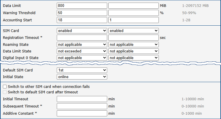

SIM Card Switching Examples
Example 1: Timeout Configuration
With Switch to default SIM card after timeout checked and the following values configured:
The first attempt to switch back to the default SIM occurs after 60 minutes. If it fails, the second attempt is made after 30 minutes. The third attempt follows after 50 minutes (30 + 20), and the fourth after 70 minutes (30 + 20 + 20).
Example 2: Data Limit Switching
This example demonstrates how to configure the router to automatically switch to the second SIM card once the data limit of 800 MB is exceeded on the first (default) SIM. The Data Limit State for the 1st SIM card must be set to not exceeded. An SMS warning is also sent upon reaching 400 MB (50% threshold), which requires enabling the corresponding feature on the SMS Configuration page. The billing period starts on the 18th day of the month.

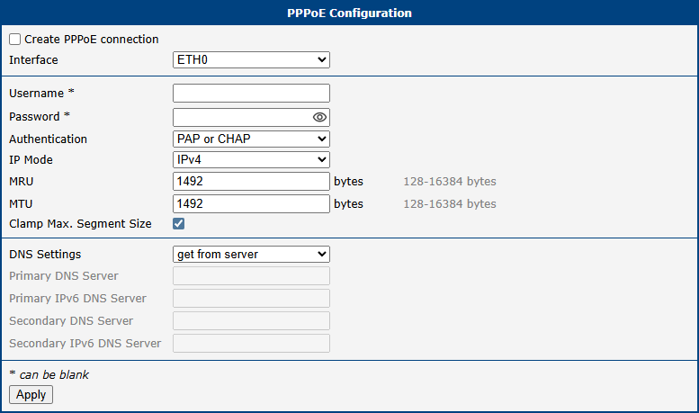

The PPPoE settings are available on the Configuration → PPPoE page.
| Create PPPoE connection | Enables the PPPoE client on the selected interface. When checked, the router will automatically attempt to establish a connection on boot. |
| Interface | Selects the interface on which the PPPoE client will operate: the Ethernet interface (ETH0 or ETH1) or a configured VLAN interface (1st VLAN/2nd VLAN/3rd VLAN). |
| Username | The username required for authentication with the PPPoE server. |
| Password | The password for the specified username. |
| Authentication | Specifies the authentication protocol to be used. • PAP or CHAP: Allows the router to negotiate and use either protocol (default). • PAP: Forces the use of Password Authentication Protocol. • CHAP: Forces the use of Challenge-Handshake Authentication Protocol. |
| IP Mode | Defines the IP protocol version for the connection. • IPv4: Establishes an IPv4-only session (default). • IPv6: Establishes an IPv6-only session. • IPv4/IPv6: Enables a dual-stack session for both IPv4 and IPv6. |
| MRU | The Maximum Receive Unit in bytes — the largest packet size the router can receive. The default is 1492 B. |
| MTU | The Maximum Transmission Unit in bytes — the largest packet size the router can transmit. The default is 1492 B. |
| Clamp Max. Segment Size | When enabled (default), automatically adjusts the TCP Maximum Segment Size (MSS) to prevent fragmentation, improving performance and reliability. |
| DNS Settings | Configures how DNS servers are obtained. • Get from server: Automatically uses the DNS servers provided by the PPPoE server (default). • Manual: Allows you to specify primary and secondary DNS servers manually. |
| Primary DNS Server | Primary IPv4 address of the DNS server. |
| Primary IPv6 DNS Server | Primary IPv6 address of the DNS server. |
| Secondary DNS Server | Secondary IPv4 address of the DNS server. |
| Secondary IPv6 DNS Server | Secondary IPv6 address of the DNS server. |
Warning
Setting an incorrect MTU or MRU value can lead to packet fragmentation or loss, resulting in a failed or unreliable connection. Use the default value of 1492 B unless your provider requires a different setting.

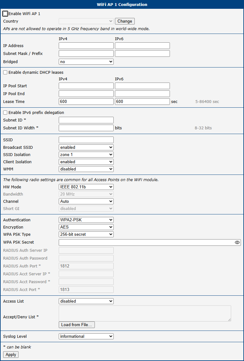

WiFi Access Point
Important Note on Upgrading to Firmware 6.6.0
When upgrading from a firmware version prior to 6.6.0, any separate Country settings for the Wi-Fi Access Point (AP) and Station (STA) modes will be consolidated into a single, unified Country setting. This change ensures regulatory compliance and simplifies configuration.
Info
- The router supports configuring two separate WLANs (multiple SSIDs) for access point 1 (AP1) and access point 2 (AP2). However, both access points must share the same radio settings (channel, mode, channel width, etc.).
- The router supports operating as both an access point (AP) and a station (STA) simultaneously.
- RADIUS (Remote Authentication Dial-In User Service) is supported as a networking protocol for centralized authentication, authorization, and accounting (AAA). The router acts only as a RADIUS client, communicating with an external RADIUS server.
To enable Wi-Fi access point mode, check the Enable Wi-Fi AP box at the top of the Configuration → WiFi → Access Point 1 or Access Point 2 configuration page. In this mode, the router operates as an access point, allowing other devices in station (STA) mode to connect.
| Enable WiFi AP | Enables the Wi-Fi access point (AP). Both Access Point 1 (AP1) and Access Point 2 (AP2) can be enabled and operated simultaneously. |
| Country | A single Wi-Fi country code applies to all AP and STA interfaces and is configured on a separate page (accessible via the Change button), refer to WiFi Country. After changing the country, you must review the HW Mode, Bandwidth, and Channel settings. |
| IP Address | A fixed IP address for the Wi-Fi interface. Use standard IPv4 or IPv6 notation. |
| Subnet Mask / Prefix | Specifies the subnet mask for an IPv4 address or the prefix length (0 to 128) for an IPv6 address. |
| Bridged | Activates bridge mode: • no: Bridged mode is disabled (default). The WLAN is a separate network from the LAN. • yes: Bridged mode is enabled. The WLAN is connected to one or more LAN networks. In this mode, most network settings in this table are ignored, and the router uses the settings of the bridged LAN interface. See the Bridge Notes in Ethernet for further details. |
| Enable dynamic DHCP leases | Enables the dynamic allocation of IP addresses using the DHCP (or DHCPv6) server. |
| IP Pool Start | The start of the IP address range assigned to DHCP clients. |
| IP Pool End | The end of the IP address range assigned to DHCP clients. |
| Lease Time | The duration (in seconds) for which a client can use its assigned IP address. |
| Enable IPv6 prefix delegation | Enables prefix delegation for IPv6 clients. |
| Subnet ID | The decimal value of the Subnet ID for the interface. The maximum value is determined by the Subnet ID Width. |
| Subnet ID Width | The maximum Subnet ID width, which depends on your site's configuration. The remaining bits (up to 64) are used for the prefix. |
| SSID | The unique identifier (name) of the Wi-Fi network. Access Point 1 (AP1) and Access Point 2 (AP2) can have different SSIDs. |
| Broadcast SSID | Defines how the SSID is broadcast in the beacon frame: • enabled: The SSID is included in the beacon frame (standard behavior). • zero length: The SSID is omitted from the beacon frame. Requests to send beacon frames are ignored. • clear: SSID characters in the beacon are replaced with zeros, maintaining the original length. Requests for beacon frames are ignored. |
| SSID Isolation | When enabled with a selected zone, clients on this access point cannot communicate with clients on other access points that have a different zone selected. |
| Client Isolation | If enabled, clients connected to this access point are prevented from communicating with each other. If disabled, the AP functions like a switch, allowing clients on the same LAN to communicate. |
| WMM | Enables basic QoS (Quality of Service) for the Wi-Fi network. Suitable for simple applications that require QoS but does not guarantee network throughput. |
| Follow STA radio settings | When enabled, if the STA mode is connected to an external access point, the router's own AP radio settings will automatically adjust to match those of the external AP. |
| HW Mode¹ | Specifies the Wi-Fi standard supported by the access point. Available options include: IEEE 802.11b (2.4 GHz), IEEE 802.11b+g (2.4 GHz), IEEE 802.11b+g+n (2.4 GHz), IEEE 802.11a (5 GHz), IEEE 802.11a+n (5 GHz), IEEE 802.11ac (5 GHz). This setting is shared by both Access Point 1 and Access Point 2. |
| Bandwidth¹ | Selects the transfer bandwidth. This option may be unavailable for some hardware modes. If the selected bandwidth is occupied, the router may automatically switch to a lower bandwidth. This setting is shared by both Access Point 1 and Access Point 2. |
| Channel¹ | The channel on which the Wi-Fi access point operates. Available channels depend on the selected Country. Select Auto to allow the router to choose the optimal channel automatically. If you change the country, review this setting, as the previously selected channel may no longer be valid. This setting is shared by both Access Point 1 and Access Point 2. Note: When 40 MHz bandwidth is selected, in the 2.4 GHz band the channel number refers to the primary (20 MHz) channel; in the 5 GHz and 6 GHz bands, it refers to the center frequency of the 40 MHz channel. On NAM routers, only channels 1 to 11 are supported in the 2.4 GHz band. |
| Short GI | Available for 802.11n mode — enables a short guard interval (400 ns instead of 800 ns) to improve data transmission efficiency. This setting is shared by both Access Point 1 and Access Point 2. |
| Authentication | Defines the access control method for the Wi-Fi network: • WPA2-PSK: [insecure] Pre-Shared Key authentication with WPA2 encryption (AES).• WPA3-PSK: Simultaneous Authentication of Equals (SAE) with WPA3 encryption (AES). • WPA2-Enterprise: RADIUS-based authentication with enhanced encryption. • WPA3-Enterprise: RADIUS-based authentication with enhanced encryption. |
| Encryption | Specifies the type of data encryption: • AES: Advanced Encryption Standard, used for WPA2/WPA3. |
| WPA PSK Type | Specifies the format of the WPA Pre-Shared Key: • 256-bit secret: A 64-character hexadecimal key. • ASCII passphrase: A passphrase of 8 to 63 characters. • PSK File: Absolute path to a file containing key-MAC address pairs. |
| WPA PSK Secret | The secret key or passphrase for WPA-PSK authentication. |
| RADIUS Auth Server IP | The IPv4 or IPv6 address of the RADIUS authentication server. |
| RADIUS Auth Password | The access password for the RADIUS authentication server. |
| RADIUS Auth Port | The port number of the RADIUS authentication server (default is 1812). |
| RADIUS Acct Server IP | The IPv4 or IPv6 address of the RADIUS accounting server (if different from the authentication server). |
| RADIUS Acct Password | The access password for the RADIUS accounting server. |
| RADIUS Acct Port | The port number of the RADIUS accounting server (default is 1813). |
| Access List | Defines the mode of the client access list: • disabled: The access list is not used. • accept: Only clients in the list can access the network. • deny: Clients in the list are blocked from accessing the network. |
| Accept/Deny List | A list of client MAC addresses for network access control. Each MAC address should be entered on a new line. |
| Syslog Level | Defines the logging level for messages sent to the system log: • verbose debugging: The highest level of detail. • debugging • informational: The default level. • notification • warning: The lowest level. |
| Extra options | Allows the user to define additional parameters for hostapd. The options are appended to the configuration file. Use this feature only if you are familiar with its functionality. For more information, refer to the hostapd.conf configuration file. |
¹ The availability of configuration options may vary depending on the specific WiFi module and can be affected by the selected country code.

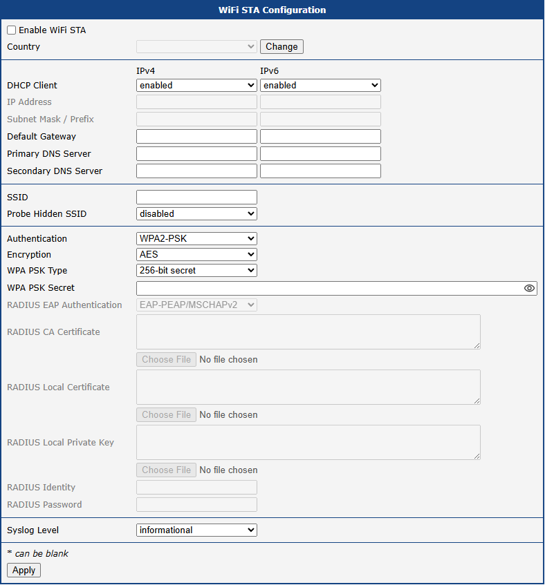

WiFi Station
Info
- You can find and connect to an available Wi-Fi network using Status → Wi-Fi → WiFi Scan.
- For networks using WPA-Enterprise security (RADIUS authentication), the station mode supports only the EAP-PEAP/MSCHAPv2 (both PEAPv0 and PEAPv1) and EAP-TLS authentication methods.
Activate Wi-Fi station mode by checking the Enable WiFi STA box at the top of the Configuration → WiFi → Station configuration page. In this mode, the router functions as a client station, connecting to an available access point (AP) and bridging its wired connection to the Wi-Fi network. In station mode, the Wi-Fi channel and bandwidth are determined by the associated access point.
| Enable WiFi STA | Enables the Wi-Fi station (STA) mode. |
| Country | A single Wi-Fi country code applies to all AP and STA interfaces and is configured on a separate page (accessible via the Change button), refer to WiFi Country. After changing the country, you must review your radio settings. |
| DHCP Client | Activates or deactivates the DHCP client (or DHCPv6 client for IPv6). |
| IP Address | Specifies a fixed IP address for the Wi-Fi interface. Use standard IPv4 or IPv6 notation. |
| Subnet Mask / Prefix | Defines the subnet mask for an IPv4 address or the prefix length (0 to 128) for an IPv6 address. |
| Default Gateway | Specifies the IP address of the default gateway. Packets with destinations not found in the routing table are sent to this gateway. |
| Primary DNS Server | Specifies the primary IP address of the DNS server. |
| SSID | The unique identifier (name) of the Wi-Fi network to connect to. |
| Probe Hidden SSID | An access point with a hidden SSID does not broadcast its name, preventing the station from connecting automatically. Enable this option to force the station to probe for a specific hidden SSID. If you are not connecting to a hidden network, keep this disabled to reduce unnecessary radio transmissions. |
| Authentication | Access control methods for the Wi-Fi network: • WPA2-PSK: [insecure] Authentication using a PSK with the WPA2 standard.• WPA3-PSK: Authentication using SAE with the WPA3 standard. • WPA2-Enterprise: Authentication using a RADIUS server with the WPA2 standard. • WPA3-Enterprise: Authentication using a RADIUS server with the WPA3 standard. |
| Encryption | The data encryption method: • AES: Modern dynamic encryption used with WPA2/WPA3. |
| WPA PSK Type | The format of the key for WPA-PSK authentication: • 256-bit secret: A 64-character hexadecimal key. • ASCII passphrase: A passphrase of 8 to 63 characters. |
| RADIUS EAP Authentication | The EAP protocol used for RADIUS authentication: • EAP-PEAP/MSCHAPv2: Uses TLS to protect legacy EAP authentication. • EAP-TLS: Uses TLS for mutual authentication between the client and server. |
| RADIUS CA Certificate | The Certificate Authority (CA) certificate used to verify the server certificate during EAP-TLS authentication. |
| RADIUS Local Certificate | The client certificate required for EAP-TLS authentication. |
| RADIUS Local Private Key | The private key associated with the client certificate for EAP-TLS authentication. |
| RADIUS Identity | The identity (username) used to connect to the RADIUS server. |
| RADIUS Password | The password used to authenticate the RADIUS identity (for EAP-PEAP/MSCHAPv2). For EAP-TLS, this field is optional and specifies the decryption key for the local private key if it is encrypted. |
| Extra options | Allows the user to define additional parameters for wpa_supplicant. The options are appended to the configuration file. Use this feature only if you fully understand the implications. For more information, refer to the wpa_supplicant.conf configuration file. |

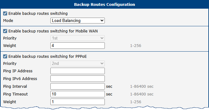

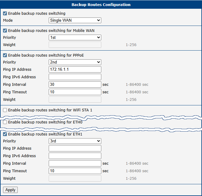

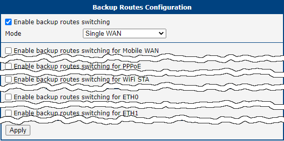

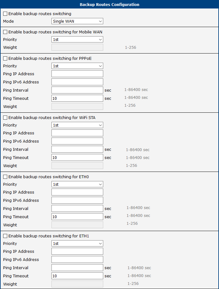

Backup Routes

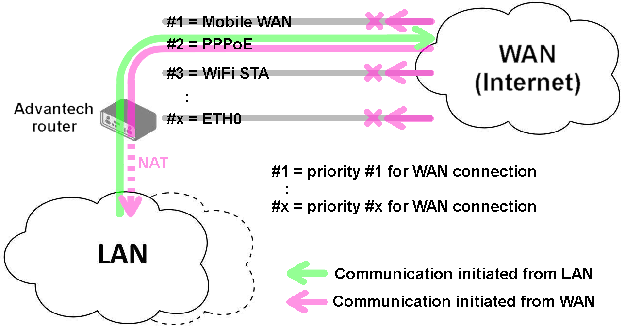

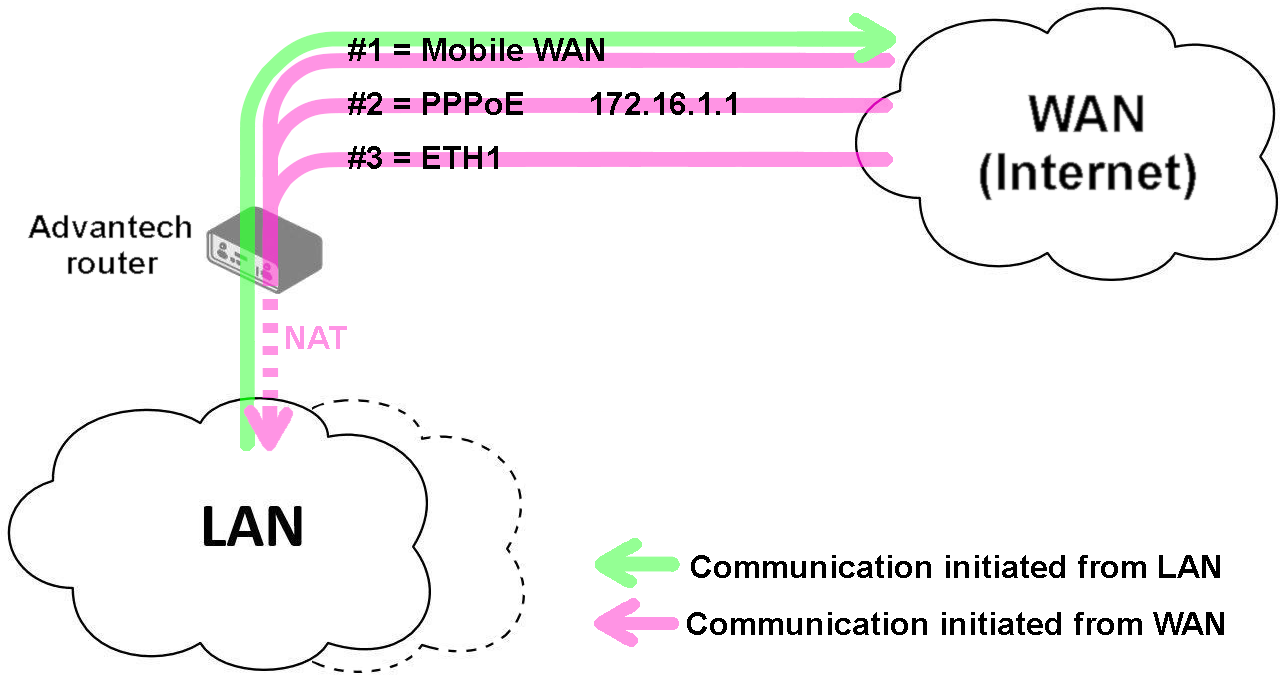

The Backup Routes feature provides a mechanism for managing WAN connectivity, enabling automatic failover and load balancing across multiple Internet sources. The configuration is managed on the Configuration → Backup Routes page.
You can choose to let the router manage WAN connections automatically using its default priorities, or customize the behavior to meet specific network requirements.
Warning
- Some WAN interfaces (e.g., Wi-Fi, secondary Ethernet ports) may not be available on all router models.
- When using default priorities, an Ethernet interface will not be considered a valid WAN connection unless it has a static IP address configured or its DHCP client is enabled.
- In default priority mode, merely unplugging an Ethernet cable will not trigger a failover. The interface must be administratively down or fail to obtain an IP address.
Default Failover
If the Enable backup routes switching option is unchecked, the router uses a predefined, internal priority list to select the active WAN interface. The default interface priority is as follows:
- Mobile WAN (
usb0orusb1) - PPPoE (
pppoe0) - Wi-Fi STA (
wlan0) - ETH1 (
eth1) - ETH0 (
eth0)
Based on this order, the router will only use the ETH1 interface if the Mobile WAN, PPPoE, and Wi-Fi connections are all unavailable. Note that a LAN interface (like ETH0) can become a WAN interface under certain conditions, which may have security implications. Ensure your firewall and NAT rules are configured accordingly.
Customized Backup Routes
To gain full control over failover and load balancing, check the Enable backup routes switching box. This allows you to define interface priorities, connection checking parameters, and select one of three operational modes.
Operational Modes
| Mode | Selects the operational mode for managing WAN interfaces: • Single WAN: Only one WAN interface is active at a time. If the primary interface fails, the router switches to the next available interface by priority. The router is accessible from outside only on the active interface. • Multiple WANs: Same as Single WAN, with one difference: the router is accessible from outside on all enabled WAN interfaces simultaneously. • Load Balancing: Traffic is distributed across multiple WAN interfaces simultaneously. Assign a Weight to each interface to control its share of traffic streams. |
Interface Configuration
For each interface to include in the backup system, check its Enable backup routes switching box and configure the following parameters.
| Priority | Sets the priority of the interface (1st is highest). The router always uses the highest-priority active interface. |
| Ping IP Address | The destination IPv4 address or domain name for ICMP echo requests used to verify connection health. |
| Ping IPv6 Address | The destination IPv6 address or domain name for ICMP echo requests. |
| Ping Interval | The time in seconds between each ping test. |
| Ping Timeout | The time in seconds to wait for a response before considering a ping test failed. |
| Weight | (Load Balancing mode only) A value from 1 to 256 that determines the traffic ratio for this interface. For example, if two interfaces have weights of 4 and 1, they will handle approximately 80% and 20% of traffic streams, respectively. |
Warning
- Load Balancing: The traffic distribution is based on data streams, not total bandwidth. The actual data volume may not perfectly match the weight ratio, especially with a small number of concurrent connections.
- Mobile WAN: To use a cellular connection in a custom backup scenario, set Check Connection to enabled + bind on the Mobile WAN configuration page.
Backup Routes Examples
Example 1: Default Settings
If no settings are configured on the Backup Routes page, the system operates with the default priorities. This provides a simple, automatic failover mechanism.
Note: Assume all affected interfaces are correctly configured and activated on their configuration pages.
Example 2: Default Route Switching
This example shows how the default system handles a primary interface failure. If the highest-priority interface (Mobile WAN) becomes unavailable, the router automatically switches to the next interface in the default priority list (PPPoE).
Example 3: Custom Backup Routes
This example demonstrates a custom failover configuration using the Mobile WAN, PPPoE, and ETH1 interfaces. The Mobile WAN is set as the highest priority, followed by PPPoE, and finally ETH1. The connection status of the PPPoE tunnel is monitored by pinging 172.16.1.1.
In Single WAN mode, if the Mobile WAN connection fails, the router fails over to the PPPoE tunnel.
In Multiple WANs mode, the router is accessible via all three interfaces simultaneously, even though only one is used for outbound traffic at a time.

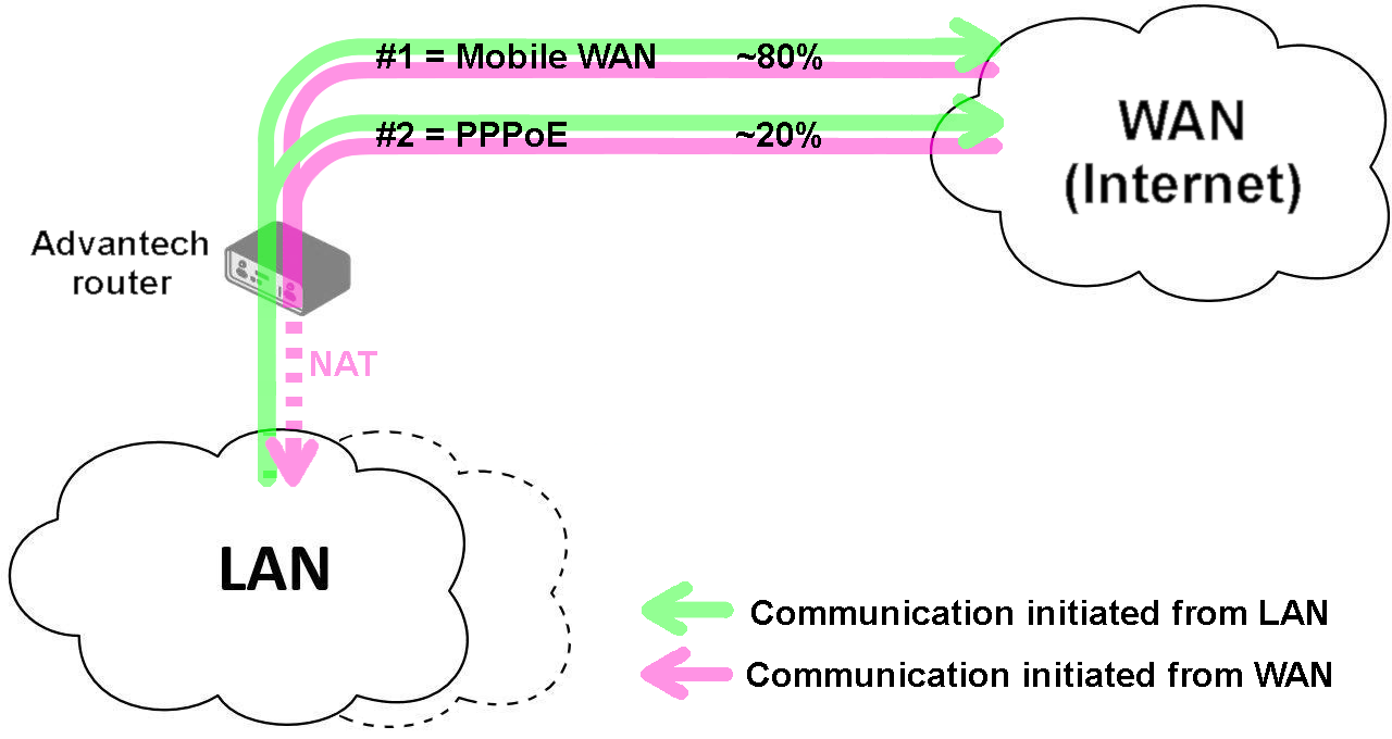

Example 4: Load Balancing Mode
This example shows a load balancing configuration between the Mobile WAN and a PPPoE interface. The weights are set to 4 and 1, respectively, meaning the Mobile WAN will handle approximately 80% of traffic streams and the PPPoE interface 20%.
Example 5: No WAN Routes
If Backup Routes is enabled but no interfaces are selected for WAN routing, the router has no dedicated WAN connection and functions as a LAN router. The Mobile WAN interface will not be used, even if connected to a cellular network.

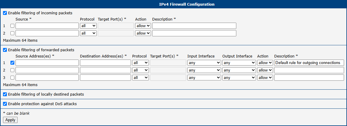

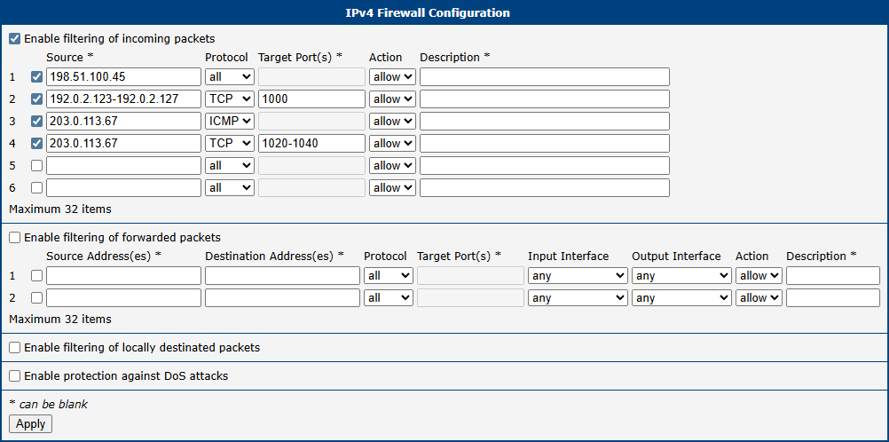

The figure below shows the default configuration page for the IPv4 firewall. The configuration fields are identical for both the IPv4 and IPv6 forms.
Info
Starting with firmware version 6.6.0, rule descriptions are stored directly as comments in the system's iptables configuration. This allows you to easily identify rules created via the web interface when managing the firewall from the command line (e.g., using iptables-save).
The first section of the configuration form defines the incoming firewall policy. If the Enable filtering of incoming packets checkbox is unchecked, all incoming connections are accepted. When enabled, and if connections originate from the WAN interface, the router checks them against the PREROUTING chain in the mangle table. The router accepts a connection only if a matching rule exists with the Action set to allow; otherwise, if no matching rule is found or the Action is set to deny, the connection is dropped.
You can define up to 64 rules based on IP addresses, protocols, and ports. Each rule can be enabled or disabled using the checkbox on the left of its row. A new row for the next rule appears automatically after filling in the previous one.
Please note that incoming rules apply only to connections originating from the WAN zone. For details on priority rules related to WAN interfaces, refer to Backup Routes.
| Source¹ | Specifies the IP address to which the rule applies. Use an IPv4 address in the IPv4 form and an IPv6 address in the IPv6 form. |
| Protocol | Specifies the protocol to which the rule applies: • all: The rule applies to all protocols. • TCP: The rule applies to the TCP protocol. • UDP: The rule applies to the UDP protocol. • GRE: The rule applies to the GRE protocol. • ESP: The rule applies to the ESP protocol. • ICMP/ICMPv6: The rule applies to ICMP (ICMPv6 for IPv6). |
| Target Port(s) | Specifies the port number or range. Enter a single port or a range separated by a hyphen (e.g., 1020–1040). |
| Action | Specifies the action the router performs: • allow: Permits the packets to enter the network. • deny: Blocks the packets from entering the network. |
| Description | A user-defined description for the rule, which is stored as a comment in iptables. |
¹ This field supports IP address input in the formats: IP, IP/mask, or IP_start-IP_end.
The next section defines the forwarding firewall policy. If the Enable filtering of forwarded packets checkbox is unchecked, all incoming packets are forwarded. When enabled, and if a packet is addressed to another network interface, the router processes it through the FORWARD chain in iptables. If the FORWARD chain accepts the packet, the router forwards it, provided there is a corresponding entry in the routing table.
You can define up to 64 forwarding rules. A new row appears automatically after filling in the previous one. The forwarding settings can be applied to specific interfaces, providing granular control over traffic flow.
Info
As shown in the figure above, the second entry in the IPv6 forwarded packets configuration is the default firewall rule for NAT64, which is disabled by default. To enable the NAT64 function, navigate to Configuration → NAT → IPv6 → Enable NAT64.
| Source Address(es)¹ | Specifies the source IP address to which the rule applies (IPv4 or IPv6). |
| Destination Address(es)¹ | Specifies the destination IP address to which the rule applies (IPv4 or IPv6). |
| Protocol | Specifies the protocol to which the rule applies: • all, TCP, UDP, GRE, ESP, ICMP/ICMPv6. |
| Target Port(s) | Specifies the target port number or range. |
| Input Interface | Specifies the interface on which the packet is received. Options include any, WAN zone, LAN zone, or specific interfaces such as Ethernet, Bridge, VLAN, Mobile, PPPoE, Wi-Fi, and VPN interfaces. |
| Output Interface | Specifies the interface through which the packet will be sent. The available options are the same as for Input Interface. |
| Action | Defines the action the router performs: • allow: Permits the packets to be forwarded. • deny: Blocks the packets from being forwarded. |
When the Enable filtering of locally destined packets function is enabled, the router automatically drops packets requesting an unsupported service without sending any notification.
To protect against DoS (Denial of Service) attacks, the Enable protection against DoS attacks option limits the number of allowed connections per second to three. A DoS attack floods the target system with excessive requests, overwhelming its resources.

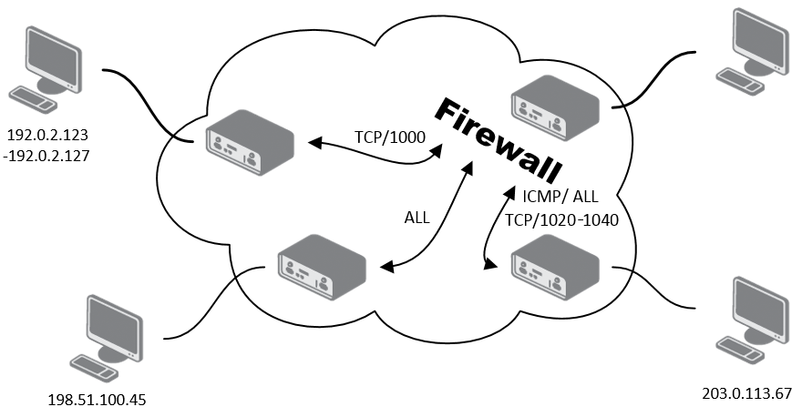

Firewall Configuration Example
In this example, the router is configured to permit the following access:
- Access from IP address 198.51.100.45 using any protocol.
- Access from the IP address range 192.0.2.123 to 192.0.3.127 using the TCP protocol on port 1000.
- Access from IP address 203.0.113.67 using the ICMP protocol.
- Access from IP address 203.0.113.67 using the TCP protocol on target ports ranging from 1020 to 1040.
See the network topology and configuration form in the figures below.

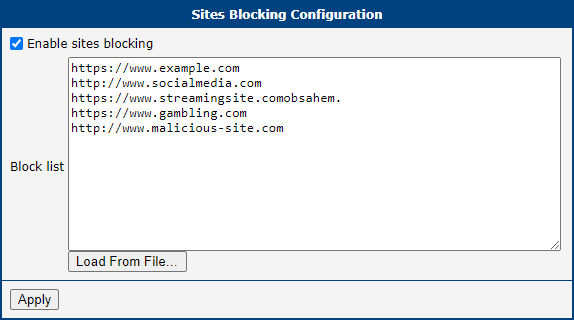

On the Sites configuration page, you can define specific URLs that you want the firewall to block. To enable this feature, check the Enable sites blocking option.
You can then build your blocklist in two ways:
- Manually enter each URL into the Block list box, placing each one on a new line.
- Use the Load From File... button to import a predefined list of URLs from a plain text file.

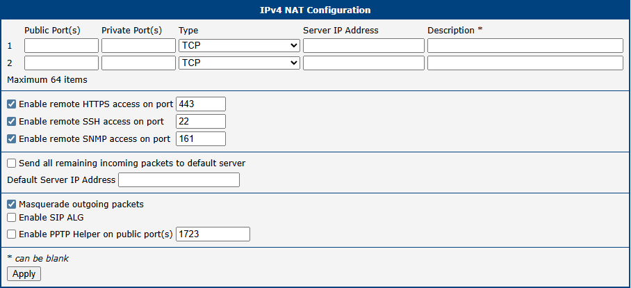

The NAT configuration is managed on the Configuration → NAT page, which has separate subpages for IPv4 and IPv6.
Port Forwarding
Port forwarding, also known as destination NAT (DNAT), allows external devices to connect to a specific service on a device within the private LAN. You can define up to sixty-four port forwarding rules.
| Public Port(s) | The external port or port range on the router's WAN interface. A single port or a range (e.g., 8000-8010) can be specified. |
| Private Port(s) | The internal port or port range on the destination server. |
| Type | The protocol for the rule: TCP or UDP. |
| Server IP Address | The private IPv4 or IPv6 address of the server on the LAN to which traffic will be forwarded. |
| Description | An optional description for the rule. |
For configurations requiring more than sixty-four rules, additional rules can be added to the startup script (Configuration → Scripts). Use the following iptables command format for IPv4:
For IPv4 NAT:
iptables -t nat -A pre_nat -p tcp --dport [PORT_PUBLIC] -j DNAT --to-destination [IPADDR]:[PORT_PRIVATE]For IPv6, use the ip6tables command:
ip6tables -t nat -A pre_nat -p tcp --dport [PORT_PUBLIC] -j DNAT --to-destination [IP6ADDR]:[PORT_PRIVATE]Replace the bracketed values with your specific port numbers and IP addresses.
Remote Access
This section allows you to enable remote access to the router's own management services from the WAN interface.

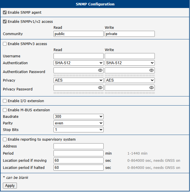

| Enable remote HTTPS access on port | Allows secure remote access to the router's web interface via HTTPS on the specified port. |
| Enable remote SSH access on port | Allows remote access to the router's command-line interface via SSH on the specified port. |
| Enable remote SNMP access on port | Allows remote management and monitoring of the router via SNMP on the specified port. |
Warning
For secure management, always use HTTPS access. The HTTP remote access option is for redirection only. Exposing unsecured services to the Internet poses a significant security risk and should be avoided.
Default Server and NAT Helpers
This section contains advanced NAT features, including a default server (DMZ) setting and Application-Layer Gateways (ALGs) for specific protocols.
| Send all remaining incoming packets to default server | When enabled, all incoming traffic from the WAN that does not match any other port forwarding rule is forwarded to the specified default server. This is often referred to as a DMZ. |
| Default Server Address | The private IPv4 or IPv6 address of the default server. |
| Enable NAT64 | (IPv6 only) Activates NAT64 translation, allowing IPv6-only clients to communicate with IPv4-only services. Requires a corresponding firewall rule to be effective. |
| Masquerade outgoing packets | Enables source NAT (SNAT) for all outgoing traffic, making it appear to originate from the router's public WAN IP address. This should almost always be enabled. |
| Enable SIP ALG | (IPv4 only) Enables the Session Initiation Protocol Application-Layer Gateway, which helps VoIP traffic traverse NAT by modifying SIP packet headers. |
| Enable FTP Helper on public port(s) | Assists with NAT traversal for the FTP protocol, particularly for active mode FTP, on the specified port (default is 21). |
| Enable PPTP Helper on public port(s) | (IPv4 only) Assists with NAT traversal for the Point-to-Point Tunneling Protocol (PPTP) for VPN connections on the specified port (default is 1723). |
Warning
The NAT64 functionality is based on the Jool implementation, which has certain limitations. It is not possible to connect to the router itself using its NAT64-mapped IPv4 address (e.g., 64:ff9b::192.0.2.1). Furthermore, firewall rules for NAT64 traffic must be created in the input chain, not the forward chain, as Jool processes the packets as if they originate from the router itself.
NAT Configuration Examples

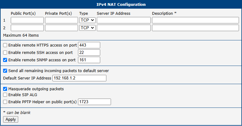

Example 1: Forward All Traffic to a Single Device (DMZ)
This configuration forwards all incoming traffic from the Internet to a single device on the LAN, effectively placing it in a Demilitarized Zone (DMZ).
- Enable the Send all remaining incoming packets to default server option.
- Enter the IP address of the target device in the Default Server IP Address field.
The LAN device must be configured to use the router's IP address as its default gateway. With this setup, a ping request to the router's public SIM card IP address will be answered by the device, not the router.

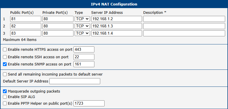

Example 2: Port Forwarding to Multiple Devices
This example shows how to make services on multiple internal devices accessible from the Internet using port forwarding. A different public port is mapped to a service on each internal server.
For instance, to make a web server on device 192.168.1.2 (port 80) accessible via public port 81, create the following rule:
- Public Port(s):
81 - Private Port(s):
80 - Type: TCP
- Server IP Address:
192.168.1.2
External users can then access the web server by navigating to http://<router_public_ip>:81. Since the Send all remaining incoming packets to default server option is disabled, any traffic not matching a specific rule will be dropped.

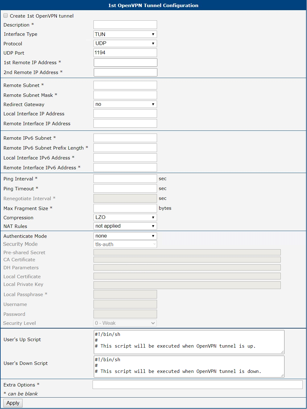

OpenVPN
OpenVPN is a robust and highly flexible VPN solution that creates secure point-to-point or site-to-site connections over the Internet. The router supports up to four concurrent OpenVPN tunnels, each with its own configuration. Both IPv4 and IPv6 are supported in a dual-stack configuration.
To configure an OpenVPN tunnel, select OpenVPN from the Configuration section of the main menu. The menu will expand to show configuration pages for each tunnel (1st Tunnel through 4th Tunnel).
Tunnel Configuration
The following table describes the available parameters for configuring an OpenVPN tunnel.
| Description | An optional name or description for the tunnel. |
| Interface Type | Determines the layer at which the VPN operates: • TUN (default): A routed VPN that operates at the network layer (Layer 3). This is the most common mode. • TAP: A bridged VPN that operates at the data link layer (Layer 2). This requires a bridge to be configured on the corresponding Ethernet interface. |
| Protocol | The transport protocol for the VPN tunnel: • UDP/UDPv6: Uses UDP for transport. This is generally faster and is the recommended default. • TCP/TCPv6 Server: Uses TCP and configures the router to act as a server, listening for incoming client connections. • TCP/TCPv6 Client: Uses TCP and configures the router to act as a client, initiating a connection to a remote server. |
| UDP/TCP Port | The port number for the selected protocol. The default is 1194. |
| 1st/2nd Remote IP Address | The IPv4 address, IPv6 address, or domain name of the remote OpenVPN server. A second address can be provided for redundancy. |
| Remote Subnet | The IPv4 address of the remote network behind the tunnel. |
| Remote Subnet Mask | The subnet mask of the remote IPv4 network. |
| Redirect Gateway | If enabled, all of the router's outbound traffic will be sent through the VPN tunnel. |
| Local/Remote Interface IP Address | The virtual IPv4 addresses for the local and remote endpoints of the tunnel interface. |
| Remote IPv6 Subnet | The IPv6 prefix of the remote network behind the tunnel. |
| Remote IPv6 Prefix | The prefix length of the remote IPv6 network. |
| Local/Remote Interface IPv6 Address | The virtual IPv6 addresses for the local and remote endpoints of the tunnel interface. |
| Ping Interval | The interval in seconds at which keep-alive packets are sent to the remote peer. |
| Ping Timeout | The time in seconds to wait for a response before considering the tunnel to be down. This value should be greater than Ping Interval. |
| Renegotiate Interval | The time in seconds before the session key is renegotiated. This does not apply when using the Pre-shared Secret authentication mode. |
| Max Fragment Size | The maximum size in bytes of a packet before it is fragmented. |
| Compression | Configures data compression for the VPN tunnel: • none (recommended): No compression is used. This is the most secure setting. • LZO (deprecated, factory default): Uses the legacy LZO lossless compression algorithm. This option is insecure due to the VORACLE vulnerability and is pending removal from future OpenVPN versions. Its use is strongly discouraged — it is provided only for backward compatibility with legacy systems. A newly created tunnel uses this option by default — change it to none unless compatibility with a legacy peer is required. |
| NAT Rules | Determines whether NAT should be applied to traffic passing through the tunnel. |
Authentication and Security
OpenVPN offers multiple authentication methods, allowing for flexible and highly secure configurations.
| Authenticate Mode | Selects the method used to authenticate the VPN peers: • none: No authentication. Not recommended for production use. • pre-shared secret: Uses a static, pre-shared key for authentication. • username/password: Authenticates using a username, password, and a common CA certificate. • X.509 cert.: Uses a full PKI with certificates for authentication. Can be configured in client, server, or multi-client server mode. |
| Security Mode | Configures an additional HMAC layer for verifying control channel packets: • tls-auth: Authenticates control channel packets. • tls-crypt: Encrypts and authenticates control channel packets, providing better protection against DoS attacks. This is the recommended mode. |
| Pre-shared Secret | The static key used for Pre-shared secret authentication mode or as the HMAC key for Security Mode. |
| CA Certificate | The certificate of the Certificate Authority that signed the client and server certificates. |
| DH Parameters | The Diffie-Hellman parameters file, required for server-side X.509 configurations. |
| Local Certificate | The public certificate for this router. |
| Local Private Key | The private key corresponding to the local certificate. |
| Local Passphrase | The passphrase used to protect the local private key file. |
| Username/Password | The credentials used for the Username/password authentication mode. |
| Security Level¹ | Applies only when Authenticate Mode is set to X.509 cert.; it has no effect for none, pre-shared secret, or username / password mode. Sets the minimum cryptographic strength for the connection. Higher levels disable older, less secure algorithms. • 2 - Medium (default): Enforces a minimum of 112-bit security. • 3 - High: Enforces a minimum of 128-bit security (e.g., requires AES-128 or stronger). • 4 - Very High: Enforces a minimum of 192-bit security (e.g., requires AES-192 or stronger). |
| Extra Options | A field for adding any additional OpenVPN command-line parameters. |
¹ For a detailed explanation of security levels, see the Security Guidelines application guide, specifically the chapter on cryptographic algorithms.
Info
- An active WAN connection is required for an OpenVPN tunnel to be established, even if the tunnel's traffic is not intended to traverse that WAN.

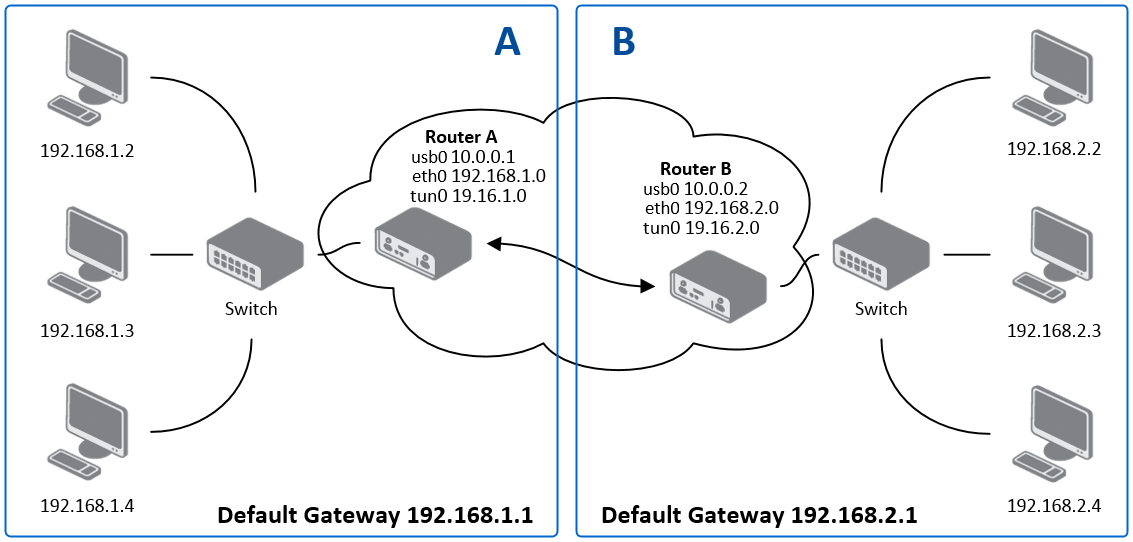

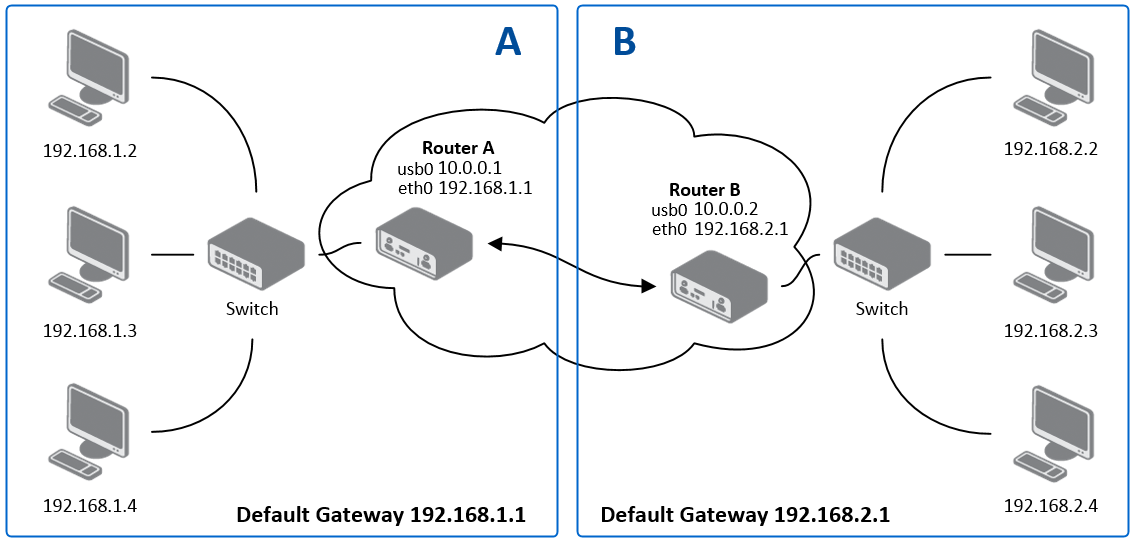

OpenVPN Configuration Example
This example shows a basic site-to-site OpenVPN tunnel between Router A and Router B.
| Configuration | Router A | Router B |
| Protocol | UDP | UDP |
| UDP Port | 1194 | 1194 |
| Remote IP Address | 10.0.0.2 | 10.0.0.1 |
| Remote Subnet | 192.168.2.0 | 192.168.1.0 |
| Remote Subnet Mask | 255.255.255.0 | 255.255.255.0 |
| Local Interface IP Address | 19.16.1.0 | 19.16.2.0 |
| Remote Interface IP Address | 19.16.2.0 | 19.16.1.0 |
| Compression | none | none |
| Authentication Mode | none | none |
Info
For more detailed examples, including certificate-based authentication, refer to the OpenVPN Tunnel application guide.

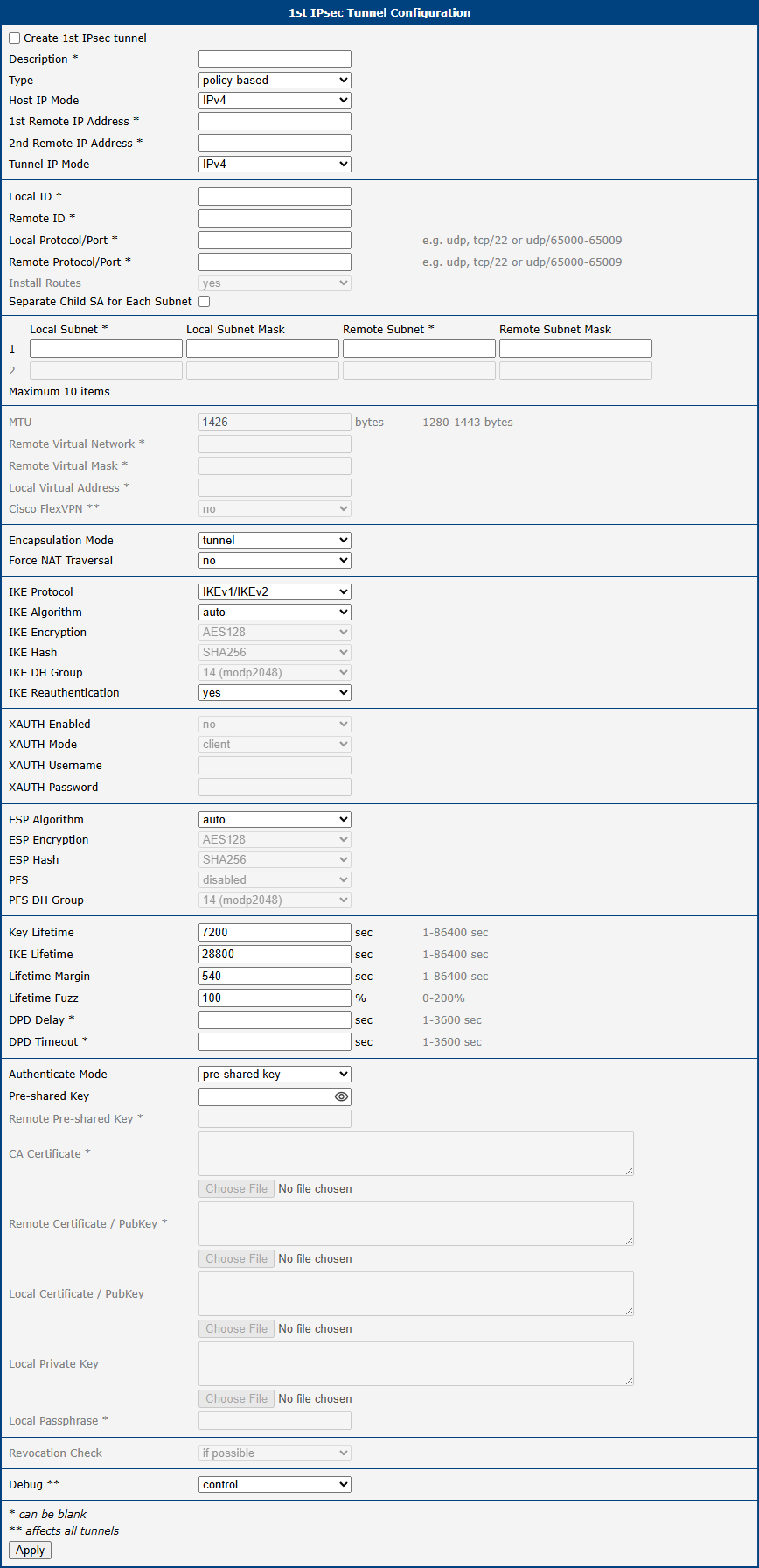

Configuration Items Description
The configuration GUI for IPsec is shown in the figure below, and the description of all items is provided in the following table.
| Description | A user-defined name or description for the tunnel. |
| Type | • policy-based: Standard VPN approach based on security policies. • route-based: VPN approach based on routing rules. Data throughput may be slightly lower compared to policy-based VPN. |
| Host IP Mode | • IPv4: The router communicates with the remote peer using IPv4. • IPv6: The router communicates with the remote peer using IPv6. |
| 1st Remote IP Address | The primary IPv4, IPv6 address, or domain name of the remote peer, corresponding to the selected Host IP Mode. |
| 2nd Remote IP Address | The secondary (failover) IPv4 or IPv6 address, or domain name, of the remote peer. If configured, failover works as follows: at startup, the router initiates a connection to the 1st Remote IP Address. If that connection fails, the router attempts to connect to the 2nd Remote IP Address. Once the secondary connection is established, the router continues to use it until it fails — it does not automatically switch back to the primary address while the secondary connection is active. |
| Tunnel IP Mode | • IPv4: IPv4 traffic is transported inside the tunnel. • IPv6: IPv6 traffic is transported inside the tunnel. |
| Local ID | The identifier (ID) for the local side of the tunnel, typically composed of a hostname and a domain name (e.g., router@mycompany.com). |
| Remote ID | The identifier (ID) for the remote side of the tunnel. |
| Local Protocol/Port | Narrows the traffic selector by specifying the protocol and port for the local network. The format is protocol/port (e.g., 17/1701 for UDP port 1701). |
| Remote Protocol/Port | Narrows the traffic selector by specifying the protocol and port for the remote network. |
| Install Routes | For route-based mode only. If set to yes, the router automatically uses the traffic selectors to create and install routes. |
| Separate Child SA for Each Subnet | If enabled, a unique Child Security Association (SA) is created for each pair of local and remote subnets. This can improve interoperability with certain vendors and allow for more granular traffic policies. If disabled, a single Child SA covers all defined traffic selectors. |
| Local Subnet | The IPv4 or IPv6 address of the local network, based on the selected Tunnel IP Mode. |
| Local Subnet Mask | The IPv4 subnet mask or IPv6 prefix length (0–128) for the local network. |
| Remote Subnet | The IPv4 or IPv6 address of the network behind the remote peer. |
| Remote Subnet Mask | The IPv4 subnet mask or IPv6 prefix length for the remote network. |
| MTU | The Maximum Transmission Unit for the tunnel in route-based mode. The default value is 1426 bytes. |
| Remote Virtual Network | Specifies the virtual remote network for a server (responder). |
| Remote Virtual Mask | Specifies the virtual remote network mask for a server. |
| Local Virtual Address | Specifies the virtual local network address for a client. Use 0.0.0.0 to have an address assigned by the server. |
| Cisco FlexVPN | Enable to support Cisco FlexVPN functionality (route-based type only). For more information, see the strongswan.conf page. |
| Encapsulation Mode | Specifies the IPsec encapsulation method: • tunnel: The entire IP datagram is encapsulated. • transport: Only the IP header is encapsulated (not supported for route-based VPN). |
| Force NAT Traversal | Enforces NAT traversal by enabling UDP encapsulation of ESP packets. |
| IKE Protocol | Specifies the version of the Internet Key Exchange (IKE) protocol: IKEv1/IKEv2 (auto-negotiate), or explicitly IKEv1 or IKEv2. When set to IKEv1/IKEv2, the router first attempts to negotiate using IKEv2. If the peer does not support IKEv2, the router automatically falls back to IKEv1. IKEv2 is strongly recommended whenever possible, as it provides improved security and enhanced functionality. |
| IKE Algorithm | Specifies how algorithms are selected: • auto: Encryption and hash algorithms are selected automatically. • manual: Algorithms are defined by the user. |
| IKE Encryption | Available encryption algorithms: 3DES, AES128, AES192, AES256, AES128GCM128, AES192GCM128, AES256GCM128, CAMELLIA192, CAMELLIA256, CHACHA20POLY1305. |
| IKE Hash | Available hash algorithms: MD5, SHA1, SHA256, SHA384, SHA512. |
| IKE DH Group | Selects the Diffie-Hellman (DH) group, which determines the strength of the key used in the key exchange process. The choice of group is a trade-off between security and performance, as stronger groups require more computation. For detailed guidance on selecting an appropriate group, refer to the official Algorithm Proposals (Cipher Suites) page. |
| IKE Reauthentication | Enable or disable IKE reauthentication (not for IKEv1). |
| XAUTH Enabled | Enable eXtended Authentication (for IKEv1 only). |
| XAUTH Mode | Select the XAUTH mode: client or server. |
| XAUTH Username | The username for XAUTH. |
| XAUTH Password | The password for XAUTH. |
| ESP Algorithm | Specifies how algorithms are selected: • auto: Encryption and hash algorithms are selected automatically. • manual: Algorithms are defined by the user. |
| ESP Encryption | Available encryption algorithms: DES, 3DES, AES128, AES192, AES256, AES128GCM128, AES192GCM128, AES256GCM128, CAMELLIA192, CAMELLIA256, CHACHA20POLY1305. |
| ESP Hash | Available hash algorithms: MD5, SHA1, SHA256, SHA384, SHA512. |
| PFS | Enables or disables Perfect Forward Secrecy, which ensures that session keys are not compromised if one of the long-term private keys is compromised. |
| PFS DH Group | Specifies the Diffie-Hellman group for PFS (see IKE DH Group). |
| Key Lifetime | Specifies the maximum interval after which a new set of encryption keys is automatically negotiated. The typical value is a few hours. The connection remains uninterrupted. |
| Key Lifetime | Specifies the maximum interval after which a new set of encryption keys is automatically negotiated. The typical value is a few hours. The connection remains uninterrupted. (default: 7200 seconds) |
| IKE Lifetime | Specifies the time period after which the router must re-authenticate the connection. The typical value ranges from a few hours to several days and must be greater than Key Lifetime. The entire connection is re-established, and a brief interruption may occur. (default: 28800 seconds) |
| Lifetime Margin | Specifies how long before Key Lifetime or IKE Lifetime expires the router should initiate rekeying or reauthentication, to ensure the process completes within the lifetime interval. This value should be less than half of Key Lifetime and IKE Lifetime. (default: 540 seconds) |
| Lifetime Fuzz | Specifies a percentage used to calculate a random time offset added to Lifetime Margin. This introduces random variation in each rekeying and reauthentication cycle to prevent multiple devices from synchronizing their requests. |
| DPD Delay | Time after which the IPsec tunnel functionality is tested. |
| DPD Timeout | The period the router waits for a DPD response before considering the peer to be down. |
| Authenticate Mode | Specifies the authentication method: • Pre-shared key: Use a shared secret for both sides. • X.509 Certificate: Use X.509 certificates for authentication. |
| (Local) Pre-shared Key | The shared secret for both sides of the tunnel (for IKEv2, this is the local key). This field appears only when pre-shared key mode is selected. |
| Remote Pre-shared Key | The shared secret for the remote side (for IKEv2). Appears only when pre-shared key mode is selected. |
| CA Certificate | The CA certificate or chain used for X.509 authentication to validate the remote peer's certificate. |
| Remote Certificate \ PubKey | The remote peer's X.509 certificate or public key for signature-based authentication. |
| Local Certificate \ PubKey | The local router's X.509 certificate or public key. |
| Local Passphrase | The passphrase used during private key generation. |
| Revocation Check | Certificate revocation policy: • if possible: Fails only if a certificate is known to be revoked. • if URI defined: Fails if a CRL/OCSP URI is available, but revocation checking fails. • always: Fails if no revocation information is available (the certificate is not known to be unrevoked). |
| Debug | Controls the level of logging verbosity: silent (no logging), audit (logs only successful connections and disconnections), control (default level), control-more, raw, private (most verbose, including private keys). See the Logger Configuration page on the strongSwan website for details. |

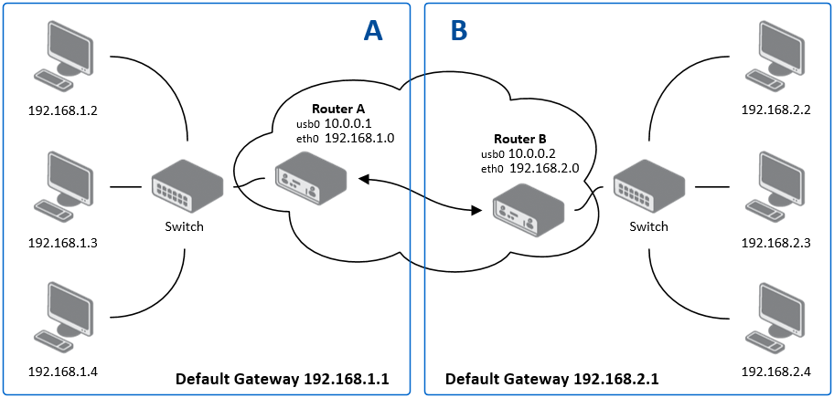

Basic IPv4 IPsec Tunnel Configuration Example
Configuration of Router A and Router B is as follows:
| Host IP Mode | IPv4 | IPv4 |
| 1st Remote IP Address | 10.0.0.2 | 10.0.0.1 |
| Tunnel IP Mode | IPv4 | IPv4 |
| Local Subnet | 192.168.1.0 | 192.168.2.0 |
| Local Subnet Mask | 255.255.255.0 | 255.255.255.0 |
| Authenticate mode | pre-shared key | pre-shared key |
| Pre-shared key | test | test |

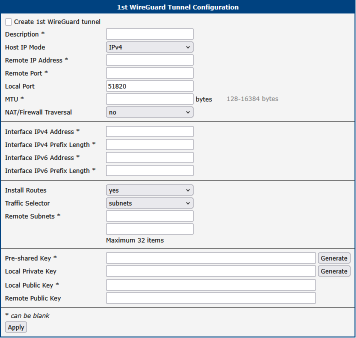

The following table describes all available WireGuard tunnel configuration options:
| Parameter | Description |
| Create WireGuard tunnel | Enables and activates the respective tunnel. |
| Description | A user-defined name or description for the WireGuard tunnel interface. |
| Host IP Mode | • IPv4: The router uses IPv4 for communication with the remote peer. • IPv6: The router uses IPv6 for communication with the remote peer. |
| Remote IP Address | The IPv4 or IPv6 address, or the domain name, of the remote WireGuard peer. This address must correspond to the selected Host IP Mode. |
| Remote Port | The UDP port number on the remote WireGuard peer where it is listening for incoming connections. |
| Local Port | The UDP port number on which the local WireGuard interface listens for incoming connections (default port is 51820). |
| MTU | The Maximum Transmission Unit (MTU) for the WireGuard tunnel interface, specified in bytes. If left blank, the kernel selects the MTU automatically; setting it to 1400 bytes is recommended. |
| NAT/Firewall Traversal | When set to yes, the router sends keepalive packets (every 25 seconds) to maintain the tunnel connection active, especially when the local peer is behind a NAT (Network Address Translation) device or firewall. This ensures the NAT/firewall mapping remains valid, allowing incoming connections to reach the peer behind NAT. |
| Interface IPv4 Address | The IPv4 address assigned to the local WireGuard tunnel interface. This address is used for routing traffic within the tunnel. |
| Interface IPv4 Prefix Length | The IPv4 subnet prefix length associated with the local WireGuard tunnel interface address. |
| Interface IPv6 Address | The IPv6 address assigned to the local WireGuard tunnel interface. This address is used for routing traffic within the tunnel. |
| Interface IPv6 Prefix Length | The IPv6 subnet prefix length associated with the local WireGuard tunnel interface address. |
| Install Routes | • no: Disables automatic route installation. Use this option when a dynamic routing protocol (e.g., FRR/BGP) is used to manage routes. • yes: Enables automatic installation of routes based on the configured subnets. |
| Traffic Selector | • all traffic: All traffic is routed through the WireGuard tunnel (route 0.0.0.0/0 for IPv4 and ::/0 for IPv6). • subnets: Traffic is routed through the WireGuard tunnel based on the specific subnets defined below. |
| Remote Subnets | If Traffic Selector is set to subnets, specify the destination subnets (networks) to be routed through the WireGuard tunnel in CIDR notation (e.g., 192.168.1.0/24). A maximum of 32 subnets can be defined. |
Cryptographic Keys
WireGuard's security is based on modern public-key cryptography.
| Local Private Key | The secret private key for this router. Click Generate to create a new one. This key must never be shared. |
| Local Public Key | The public key derived from the local private key. Share this key with the remote peer so it can authenticate and encrypt traffic sent to this router. |
| Remote Public Key | The public key of the remote peer. Used to authenticate the remote peer and encrypt traffic sent to it. |
| Pre-shared Key | An optional key that adds an additional layer of symmetric-key encryption, providing post-quantum resistance. Click Generate to create a new key and share it with the remote peer. |

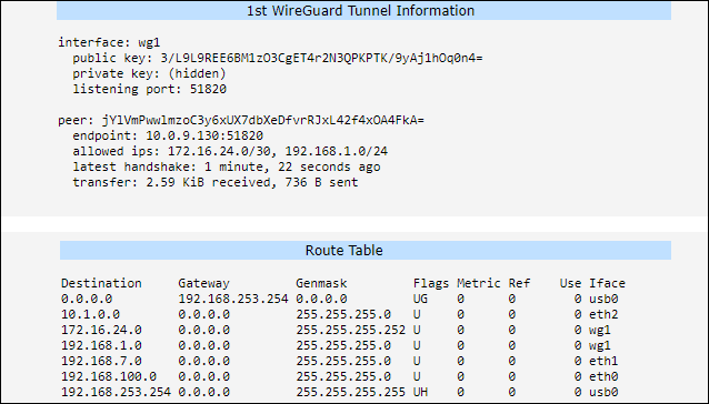

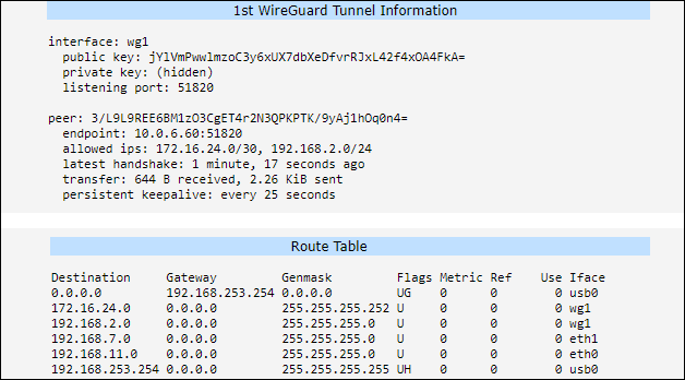

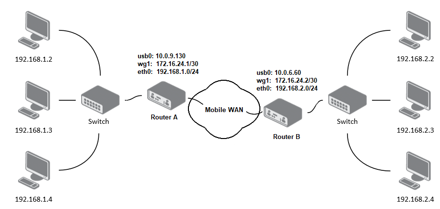

WireGuard Example
The following example demonstrates a WireGuard IPv4 tunnel configuration between Router A and Router B.
In this setup, Router B is configured as the listening side (server), and Router A initiates the tunnel connection (client). The configuration details for Router A and Router B, based on the topology shown above, are as follows:
| Remote IP Address | 10.0.6.60 | — (Listens on all interfaces) |
| Remote Port | 51820 | — (Listens on local port) |
| Local Port | 51820 | 51820 |
| NAT/Firewall Traversal | yes | no |
| Interface IPv4 Address | 172.16.24.1 | 172.16.24.2 |
| Interface IPv4 Prefix Length | 30 | 30 |
| Install Routes | yes | yes |
| Traffic Selector | subnets | subnets |
| Remote Subnets | 192.168.2.0/24 | 192.168.1.0/24 |
| Local Private Key | generated key A | generated key B |
| Local Public Key | public key A | public key B |
| Remote Public Key | public Key B | public key A |
Verifying Connectivity
After applying the configuration, verify the tunnel status on the Status → WireGuard page. A successful connection is indicated by the presence of a Latest handshake time, which shows how long ago the last cryptographic key exchange occurred. This value will only appear after traffic has been initiated from the client side (Router A) or after the first keepalive packet has been sent.

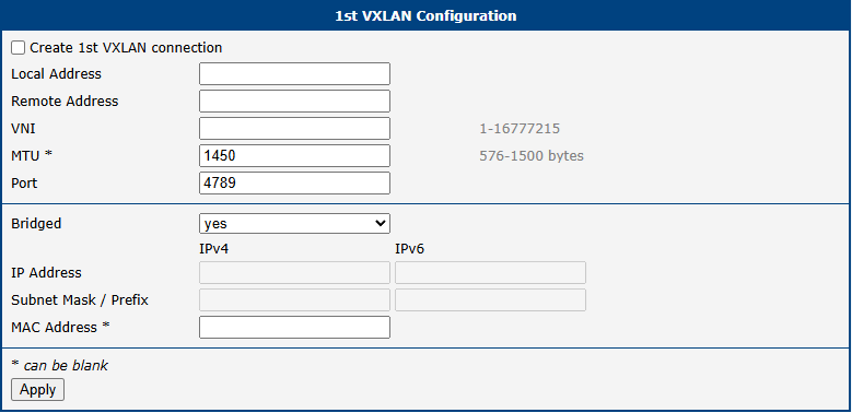

VXLAN
Info
VXLAN does not provide any native encryption or authentication. When deploying VXLAN over public or untrusted networks, it is strongly recommended to route the VXLAN traffic through a secure VPN tunnel, such as IPsec or WireGuard, to ensure data confidentiality and integrity.
Virtual Extensible LAN (VXLAN) is a Layer 2 overlay scheme on a Layer 3 network. It uses a VLAN-like encapsulation to wrap Layer 2 Ethernet frames within Layer 3 UDP packets. This allows for the creation of virtualized Layer 2 subnets that can span across physical Layer 3 network boundaries. Advantech routers support up to four simultaneous VXLAN tunnels. The configuration pages for VXLAN are located under Configuration → VXLAN.
The table below describes the parameters available for configuring each of the VXLAN interfaces.
| Create VXLAN connection | Activates the selected VXLAN tunnel (1st to 4th). |
| Local Address | The local IP address of the router used as the source for the VXLAN tunnel. |
| Remote Address | The IP address of the remote tunnel peer (VTEP). For secure deployments, this should be the internal IP of an established VPN tunnel. |
| VNI | VXLAN Network Identifier (1 to 16777215). This ID must be identical on both VTEP peers. |
| MTU | Maximum Transmission Unit (576 to 1500 bytes). The recommended value is 1450 to account for the 50-byte VXLAN overhead and prevent fragmentation. This field can be left blank. |
| Port | The destination UDP port used for the outer header. The standard port is 4789. |
| Bridged | Select yes to add the VXLAN interface to the router's local bridge, enabling seamless Layer 2 connectivity. If set to no, the VXLAN interface is considered "Routed" and has its own IP address. |
| IP Address | The IPv4 or IPv6 address assigned to the VXLAN interface. Configured when Bridged is set to no (Routed mode). |
| Subnet Mask / Prefix | The corresponding IPv4 subnet mask or IPv6 prefix length for the assigned IP address. |
| MAC Address | A custom MAC address for the VXLAN interface. If specified, the address must be unicast and locally administered. This field is optional and can be left blank. |
VXLAN configuration parameters
Deployment Example
In this scenario, two routers bridge their local networks over an existing WireGuard tunnel to ensure security. The Bridged option is enabled to allow Layer 2 traffic (such as broadcast or non-IP protocols) to pass transparently through the secure tunnel.
| Setting | Router A (Site 1) | Router B (Site 2) |
| Local Address | 10.0.0.1 (VPN IP) | 10.0.0.2 (VPN IP) |
| Remote Address | 10.0.0.2 (VPN IP) | 10.0.0.1 (VPN IP) |
| VNI | 100 | 100 |
| Port | 4789 | 4789 |
| Bridged | yes | yes |
Example of secure VXLAN bridge over VPN
Security Recommendations
To protect your network when using VXLAN, follow these best practices:
- Use VPN Transport: Never expose unencrypted VXLAN traffic directly to the internet. Always encapsulate it within IPsec or WireGuard.
- Firewall Whitelisting: Configure the firewall under Configuration → Firewall to allow incoming traffic on UDP port
4789only from the trusted peer IP address. - MTU Adjustment: Ensure the MTU is correctly set (e.g.,
1450) to avoid packet fragmentation issues caused by the combination of VPN and VXLAN headers.

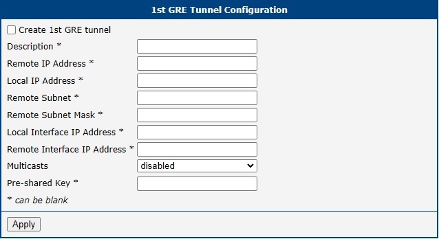

GRE
Generic Routing Encapsulation (GRE) is a tunneling protocol that encapsulates a wide variety of network layer protocols inside virtual point-to-point links over an IP network. The router supports creating up to four GRE tunnels.
The configuration pages are located under Configuration → GRE, with separate tabs for each tunnel.
Warning
- GRE is an unencrypted protocol and does not support IPv6 transport. For secure communication, use it in combination with IPsec.
- GRE tunnels cannot pass through a NAT device without a corresponding NAT traversal solution, such as a port forwarding rule for protocol 47 (GRE).
The following table describes the parameters for configuring a GRE tunnel.
| Remote IP Address | The public IP address of the remote tunnel endpoint. |
| Local IP Address | The public IP address of the local tunnel endpoint. |
| Remote Subnet | The IP address of the destination network behind the remote endpoint. |
| Remote Subnet Mask | The subnet mask of the remote network. |
| Local Interface IP Address | The virtual IP address of the local end of the GRE tunnel interface. |
| Remote Interface IP Address | The virtual IP address of the remote end of the GRE tunnel interface. |
| Multicasts | Controls multicast traffic through the tunnel: • disabled: Blocks multicast traffic. • enabled: Allows multicast traffic. |
| Pre-shared Key | An optional 32-bit numerical key for basic packet validation. Both routers must use the same key, or packets will be dropped. This is not a cryptographic key and provides no security. |
This example shows a basic site-to-site GRE tunnel between Router A and Router B, connecting their respective LANs.
Info
For more detailed examples, refer to the GRE Tunnel application guide.

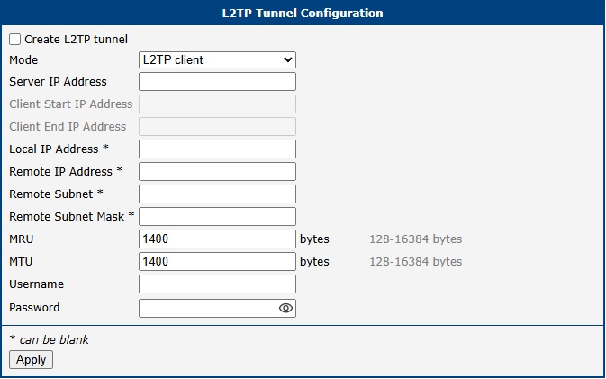

To set up an L2TP tunnel, check the Create L2TP tunnel box and configure the following parameters.
| Mode | Determines the router's role in the L2TP connection: • L2TP server: The router acts as the L2TP Network Server (LNS), accepting connections from clients. • L2TP client: The router acts as the L2TP Access Concentrator (LAC), initiating a connection to a remote server. |
| Server IP Address | (Client mode only) The IP address of the remote L2TP server. |
| Client Start/End IP Address | (Server mode only) The starting and ending addresses of the IP pool from which the server assigns addresses to connecting clients. |
| Local IP Address | The virtual IP address of the local end of the L2TP tunnel. |
| Remote IP Address | The virtual IP address of the remote end of the L2TP tunnel. |
| Remote Subnet/Mask | The IP address and subnet mask of the network behind the remote peer, used for creating a static route. |
| MRU/MTU | The Maximum Receive Unit and Maximum Transmission Unit in bytes. The default value is 1400. |
| Username/Password | The credentials used for authenticating the L2TP session. Valid characters only — refer to Allowed and Restricted Input Characters. |
This example shows a typical client-server setup, where Router A (Server) provides access to its LAN for Router B (Client).
| Configuration | Router A (Server) | Router B (Client) |
| Mode | L2TP Server | L2TP Client |
| Server IP Address | — | 10.0.0.1 |
| Client Start IP Address | 192.168.2.5 | — |
| Client End IP Address | 192.168.2.254 | — |
| Local IP Address | 192.168.1.1 | — |
| Username | username | username |
| Password | password | password |

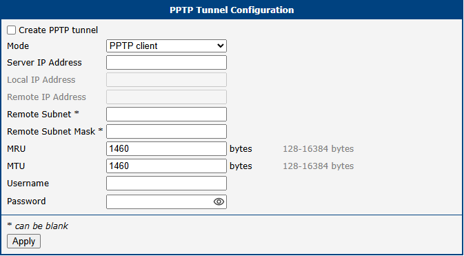

To set up a PPTP tunnel, check the Create PPTP tunnel box and configure the following parameters.
| Mode | Determines the router's role in the PPTP connection: • PPTP server: The router acts as the server, accepting connections from remote clients. • PPTP client: The router acts as the client, initiating a connection to a remote server. |
| Server IP Address | (Client mode only) The IP address of the remote PPTP server. |
| Local IP Address | The virtual IP address for the local end of the tunnel. |
| Remote IP Address | The virtual IP address for the remote end of the tunnel. |
| Remote Subnet/Mask | The IP address and subnet mask of the network behind the remote peer. |
| MRU/MTU | The Maximum Receive Unit and Maximum Transmission Unit in bytes. The default value is 1460 to avoid packet fragmentation. |
| Username/Password | The credentials for authenticating the PPTP session. Valid characters only — refer to Allowed and Restricted Input Characters. |
Info
The router firmware also supports PPTP passthrough, which allows PPTP client devices on the LAN to establish tunnels through the router to an external server.
This example shows a standard client-server setup where Router A (Server) accepts a connection from Router B (Client).
| Mode | PPTP Server | PPTP Client |
| Remote IP Address | 192.168.2.1 | — |

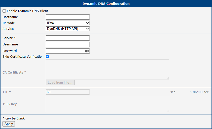

Dynamic DNS
The Dynamic DNS client allows you to access the router using a fixed, memorable hostname, even if the router’s IP address changes. The client monitors the router’s public IP address and automatically updates the DNS record on a Dynamic DNS server whenever a change is detected. The service supports both standard DDNS (RFC 2136) and secure updates via HTTPS. To configure the service, navigate to Services → Dynamic DNS.
Warning
For the Dynamic DNS service to function correctly, the router’s SIM card must be assigned a public IP address by the mobile provider.
| Hostname | Your fully qualified domain name registered with a Dynamic DNS provider (e.g., myrouter.example.com). |
| IP Mode | The IP protocol version for DNS updates: IPv4 (default), IPv6, or IPv4/IPv6 (dual-stack). |
| Service | The protocol for the DNS update: DynDNS (HTTP API) for standard web-based providers, or DDNS (RFC 2136) for direct updates to standard DNS servers. |
| Server | The update server address of your Dynamic DNS provider. If left blank, the default value members.dyndns.org is used. Several free services are available: freedns.afraid.org, www.duckdns.org, www.noip.com. Secure HTTPS URLs are supported. Active only when Service is set to DynDNS (HTTP API). |
| Username | The username for your Dynamic DNS service account. Active only when Service is set to DynDNS (HTTP API). |
| Password | The password for your Dynamic DNS service account. Active only when Service is set to DynDNS (HTTP API). |
| Skip Certificate Verification | Check to bypass SSL/TLS certificate validation when connecting to an HTTPS server. Active only when Service is set to DynDNS (HTTP API). |
| CA Certificate | The Certificate Authority (CA) certificate used to verify the server’s identity during HTTPS updates. Active only when Service is set to DynDNS (HTTP API). |
| TTL | Time to Live for the DNS record, specifying how long the record is cached by DNS resolvers. Default: 60 seconds; range: 5–86400 seconds. Active only when Service is set to DDNS (RFC 2136). |
| TSIG Key | The Transaction Signature key used to authenticate DDNS updates. Active only when Service is set to DDNS (RFC 2136). |
The example below shows how to configure the router to securely update a dual-stack DNS record using a custom provider’s HTTPS API, with certificate verification enforced. The content of the CA Certificate is pasted into the corresponding text area (or imported using the Load From File button) to authenticate the server.
| Setting | Value |
| Hostname | router.example.com |
| IP Mode | IPv4/IPv6 |
| Service | DynDNS (HTTP API) |
| Server | https://ddns.example.com |
| Username | admin_user |
| Password | <your_secure_password> |
| Skip Certificate Verification | unchecked |
| CA Certificate | <pasted PEM certificate content> |
Info
To access the router’s web interface from the internet, you must also enable Remote Access. For details, see NAT.

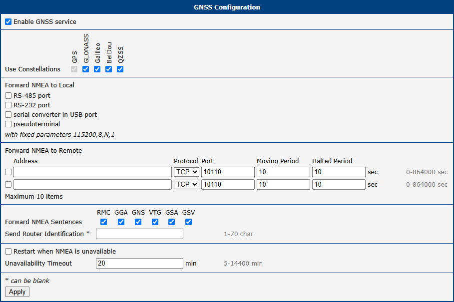

The GNSS (Global Navigation Satellite System) page allows you to configure the router's satellite positioning features. When the GNSS service is enabled, the router activates its receiver to acquire satellite signals. This provides several key functionalities:
- Real-time location data becomes available on the router's status pages (see Geolocation and GNSS), as well as via the
status geolocandstatus gnsscommands in the Command Line Interface. - The router can use GNSS as a source for time synchronization (see NTP).
- If configured, the router's location can be reported via SNMP for network management and monitoring (see SNMP).
- The location data is also available to Router Apps, which can forward it over other channels, e.g., the MQTT Manager, DNP3 Outstation, or LwM2M Manager Router Apps.
This service is essential for applications requiring precise time and location information, such as vehicle tracking, asset management, or synchronizing distributed network devices. The configuration also allows forwarding of raw NMEA data to both local serial ports and remote servers over the network.
| Enable GNSS service | Enables or disables the GNSS functionality in the router. When enabled, the router starts acquiring GNSS data from the integrated receiver. |
| Use Constellations | Selects which satellite constellations the GNSS receiver uses. The GPS constellation is always enabled, while the remaining constellations Galileo, GLONASS, BeiDou, and QZSS can be enabled or disabled individually. Satellites from all used constellations are displayed on the GNSS status page. |
| Forward NMEA to Local | Select the local interface(s) to which the NMEA output from the GNSS receiver will be forwarded. Available options: • RS-232 port • RS-485 port • serial converter in USB port • pseudoterminal The forwarded data uses fixed settings: 115200 baud, 8 data bits, no parity, 1 stop bit. |
| Forward NMEA to Remote | Configure up to ten remote destinations, each defined by: • Address: Destination IP address or hostname • Protocol: TCP or UDP transport • Port: Destination port • Moving Period: Interval (in seconds) to send data when movement is detected • Halted Period: Interval (in seconds) to send data when the device is stationary Allowed interval is 0–864000 seconds. Ports default to 10110 (NMEA over TCP/UDP). |
| Forward NMEA Sentences | Select which specific NMEA sentence types to forward (RMC, GGA, GNS, VTG, GSA, GSV). This allows filtering of the GNSS data sent to local or remote destinations. Proprietary (private) NMEA sentences are always filtered out and never forwarded. |
| Send Router Identification | A custom identification text (1–70 characters) sent to the remote destination as an additional NMEA sentence in the format $GPFID,X. Leave the field blank to omit the ID. |
| Restart when NMEA is unavailable | If enabled, the GNSS service is automatically reset if no data is received for the duration specified in the Unavailability Timeout field. |
| Unavailability Timeout | Defines the maximum time without GNSS data (5–14,400 minutes) before the service is automatically reset. |
GNSS configuration items
Info
Local forwarding is possible simultaneously to multiple hardware ports and one pseudoterminal. NMEA forwarding to remote supports both TCP and UDP and can be configured independently for up to ten remote servers.

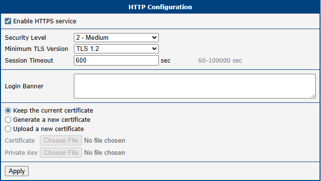

Warning
Make sure your certificate matches the Security Level. Increasing Security Level without generating a new certificate may lead to inability to connect to Web GUI: the page then displays the warning The current HTTPS certificate is insufficient for the selected Security Level, and a dialog offers to generate a new certificate after the settings are applied.
This page manages access to the router's web configuration interface via HTTP and HTTPS. For maximum security, use HTTPS — it encrypts all communication between the browser and the router. Even if HTTP is disabled, the router continues to listen on port 80 for the sole purpose of redirecting requests to HTTPS.
| Enable HTTPS service | Enables secure, encrypted access to the web interface. |
| Security Level¹ | Sets the minimum cryptographic strength by controlling which TLS versions and cipher suites are permitted. Higher levels disable older, less secure algorithms. • 2 - Medium: Enforces a minimum of 112-bit security. • 3 - High: Enforces a minimum of 128-bit security (requires AES-128 or stronger). • 4 - Very High: Enforces a minimum of 192-bit security (requires AES-192 or stronger). |
| Minimum TLS Version | The minimum TLS version the router's web server will accept. Options: TLS 1.2 and TLS 1.3. |
| Session Timeout | The inactivity period (in minutes) after which a user is automatically logged out. |
| Login Banner | Custom text displayed on the login page above the credentials fields. |
| Keep the current certificate | Retains the certificate currently stored on the router. |
| Generate a new certificate | Generates a new self-signed certificate corresponding to the selected Security Level. |
| Upload a new certificate | Allows uploading a custom certificate, such as one signed by a trusted Certificate Authority. |
| Certificate | The PEM-formatted certificate file to upload. The file may contain a single certificate or a full certificate chain. |
| Private Key | The private key file corresponding to the certificate being uploaded. |
¹ For a detailed explanation, see the Security Guidelines application guide, specifically the chapter on cryptographic algorithms.

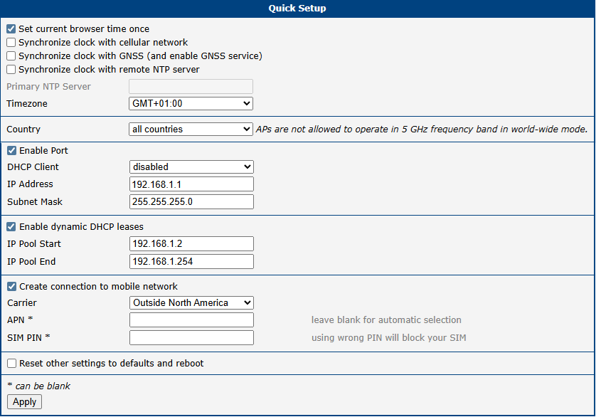

Time-Synchronization Accuracy
The accuracy of the router’s clock depends on the synchronization source:
- Remote NTP Server (recommended): Typically within several milliseconds. External NTP servers are usually synchronized to atomic clocks.
- Cellular Network (NITZ): Typically up to several seconds, depending on the mobile operator’s infrastructure.
- GNSS: Typically around one second. Not recommended for applications requiring high-precision timekeeping.
| Enable local NTP server | When enabled, the router functions as an NTP server, allowing other devices on the local network to synchronize their time with it. The accuracy of the time served depends on how the router’s own clock is synchronized (see options below). |
| Synchronize clock with cellular network | The router’s system clock will be synchronized using time information provided by the connected cellular network (e.g., via NITZ - Network Identity and Time Zone). This option is only effective if the cellular connection is active and the network provider supports this feature. |
| Synchronize clock with remote NTP server | The router’s system clock will be synchronized using the configured NTP server(s). This method provides the highest accuracy and is the recommended option when a reliable internet connection is available. |
| Synchronize clock with GNSS | The router’s system clock will be synchronized using time data from the GNSS receiver. This option is only available on router models equipped with a GNSS module. |
| Primary NTP Server | IP address or domain name of the primary remote NTP server. This server is queried first for time synchronization. |
| Secondary NTP Server | IP address or domain name of the secondary remote NTP server. This server is used if the primary server is unavailable. |
| Tertiary NTP Server | IP address or domain name of the tertiary remote NTP server. This server is used if both primary and secondary servers are unavailable. |
| Maximal Polling Interval | Defines the maximum time interval (typically in seconds, often expressed as a power of 2) between queries sent to the remote NTP server(s) for time synchronization. Longer intervals reduce network load but may result in less frequent time corrections. |
| Enable fast initial synchronization | Enables rapid initial time correction if a large discrepancy exists between the router’s current system time and the time reported by the NTP server. This allows for a quick jump to the correct time rather than gradual adjustments (slewing). |
| Timezone | Specifies the geographical timezone where the router is physically located. This setting is crucial for correct local time display and DST adjustments. |
| Daylight Saving Time | Enables or disables automatic adjustment for Daylight Saving Time (DST). When enabled, the router will adjust its clock according to the DST rules for the selected Timezone. |

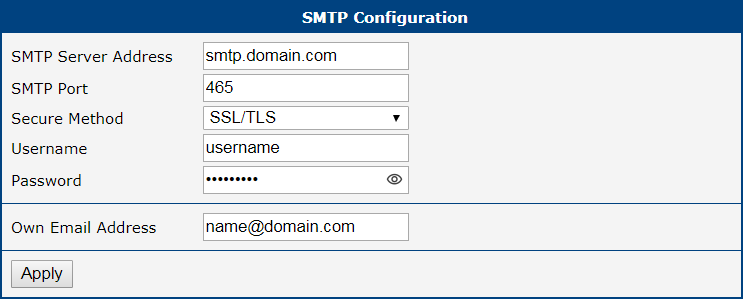

SMTP
The router includes a Simple Mail Transfer Protocol (SMTP) client, which can be configured to send emails for notifications or from scripts. To configure the client, navigate to Services → SMTP.
Info
- The settings on this page must match the requirements of your email provider's SMTP server.
- Some mobile service providers may block standard SMTP ports, potentially restricting you to using the provider's own SMTP server.
| SMTP Server Address | The IP address or domain name of your outgoing mail server. |
| SMTP Port | The port number the SMTP server uses. Common ports: 25, 465 (SSL/TLS), and 587 (STARTTLS). |
| Secure Method | The encryption method required by the server: none, SSL/TLS, or STARTTLS. |
| Username | The username for your email account. |
| Password | The password for your email account. Enter valid characters only, refer to Allowed and Restricted Input Characters. |
| Own Email Address | The sender's email address that will appear on outgoing emails (e.g., my-router@mydomain.com). |

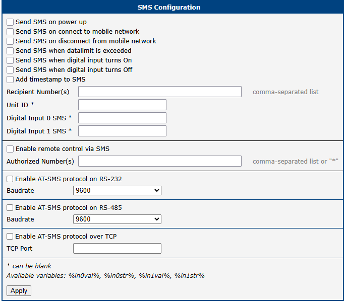

SMS
The Configuration → Services → SMS page allows you to configure all SMS-related functionality, including automated event notifications, remote control via SMS commands, and direct access to the cellular module using the AT-SMS protocol.
SMS Notifications
This section allows you to configure the router to automatically send an SMS notification to one or more phone numbers when a specific system event occurs.
| Send SMS on power up | If checked, an SMS is sent when the router starts. |
| Send SMS on connect to mobile network | If checked, an SMS is sent when the router establishes a mobile network connection. |
| Send SMS on disconnect from mobile network | If checked, an SMS is sent when the router loses its mobile network connection. |
| Send SMS when datalimit is exceeded | If checked, an SMS is sent when a mobile data limit is exceeded. |
| Send SMS when digital input turns On/Off | If checked, an SMS is sent when the state of a digital input changes to On or Off, respectively. |
| Add timestamp to SMS | If checked, a timestamp (YYYY-MM-DD hh:mm:ss) is added to the beginning of each notification SMS. |
| Recipient Number(s) | A comma-separated list of recipient phone numbers for the notifications. |
| Unit ID | A custom identifier for the router, which can be included in the SMS text. |
| Digital Input 0/1 SMS¹ | The custom text to be sent when the corresponding digital input event is triggered. |
¹ You can use variables like %in0val% (numeric value 0/1) or %in0str% (string "Off"/"On") to include the input's state in the message.
Remote Control via SMS
The router can be controlled by sending specific commands via SMS from an authorized phone number. To activate this functionality, enable it and specify at least one authorized number.
| Enable remote control via SMS | Master switch for SMS processing. When disabled, all incoming SMS messages are ignored and neither control commands nor the custom script at /var/scripts/sms will be executed. |
| Authorized Number(s) | A comma-separated list of phone numbers authorized to send control commands. Enter * to accept commands from any phone number. |

SNMP
The SNMP page allows you to configure the SNMP v1/v2 or v3 agent, which transmits information about the router and its expansion ports (if applicable) to a management station. To access the page, click SNMP in the Configuration → Services section.
SNMP (Simple Network Management Protocol) provides status information about network elements such as routers or endpoint devices. In SNMP v3, communication is secured through user-specific encryption and authentication. To enable the SNMP service, select the Enable SNMP agent checkbox.
Info
Name, Location, Contact, and Custom identification fields are now configured in Configuration → System → Identification. These fields are no longer present on the SNMP configuration page.
| Enable SNMP agent | Turns on the SNMP agent, allowing the router to be managed and monitored using SNMP protocols. |
| Enable SNMPv1/v2 access | Enables access for SNMPv1 and SNMPv2 protocols. Enter community strings for read and write access. |
| Community (Read/Write) | Community strings for SNMPv1/v2 access. Default: public for read, private for write. |
| Enable SNMPv3 access | Activates configuration options for SNMPv3, providing stronger authentication and encryption. |
| Username | The username for SNMPv3, configured independently for read and write access. |
| Authentication | The authentication algorithm (e.g., SHA-512) for SNMPv3 identity verification. |
| Authentication Password | Password for generating the authentication key. Enter valid characters only, refer to Allowed and Restricted Input Characters. |
| Privacy | The encryption algorithm (e.g., AES) used to secure SNMPv3 communication. |
| Privacy Password | Password for encrypting SNMPv3 messages. Enter valid characters only, refer to Allowed and Restricted Input Characters. |
| Enable I/O extension | Allows monitoring and reporting of digital I/O signals available on the router. |
| Enable M-BUS extension | Enables support for M-BUS (Meter-Bus) devices. Configure the baudrate, parity, and stop bits as required for your metering hardware. External RS-232/M-BUS converters may be needed. |
| Baudrate, Parity, Stop Bits | Communication parameters for the M-BUS interface. |
| Enable reporting to supervisory system | Enables transmission of statistical and location data to a supervisory or monitoring server. |
| Address | Destination IP address or hostname of the supervisory system. |
| Period | Reporting interval in minutes (1–1440). |
| Location period if moving / halted | Available on GNSS models only. Defines the reporting interval in seconds (0–864000) for location data. The GNSS service must be enabled. Separate values can be configured for when the router is moving and when it is stationary. |

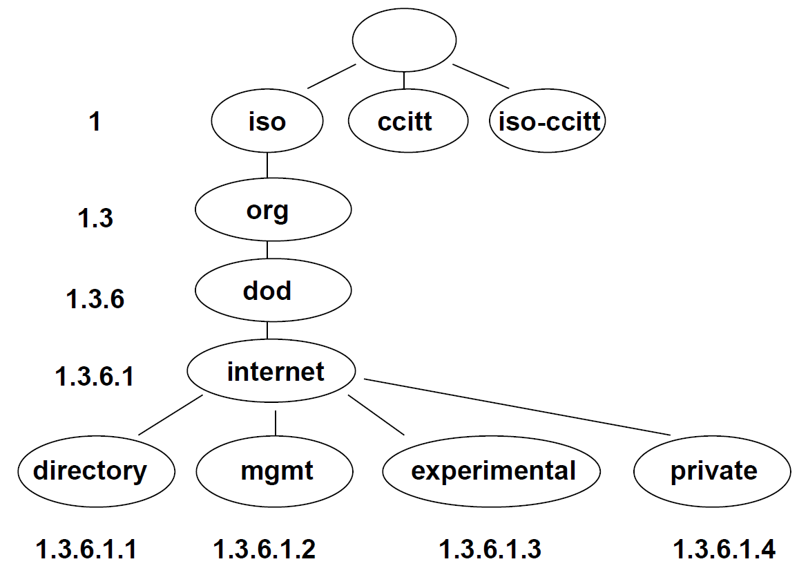

Each monitored value is uniquely identified by a numerical OID (Object Identifier) — a dot-separated sequence of numbers forming a hierarchical tree. The figure below shows the basic tree structure used for creating OIDs.
The SNMP values specific to Advantech routers start at OID .1.3.6.1.4.1.30140, interpreted as: iso.org.dod.internet.private.enterprises.conel

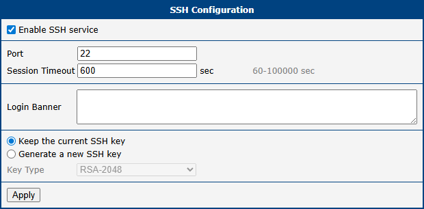

SSH
The Secure Shell (SSH) service allows for secure command-line access to the router's operating system. To configure the SSH server, navigate to Services → SSH.
Info
Only users assigned the Admin role are authorized to log in via SSH. Users with the standard User role cannot access the command line.
General Settings
| Enable SSH service | Enables or disables the SSH server on the router. |
| Port | The TCP port on which the SSH server listens for incoming connections. Default: port 22. |
| Session Timeout | The duration of inactivity (in minutes) after which an SSH session is automatically disconnected. |
| Login Banner | A custom message displayed to users before they are prompted for login credentials. |
Host Key Management
The SSH host key is a unique cryptographic key that clients use to verify the router's identity and prevent man-in-the-middle attacks.
Info
When you connect to the router via SSH for the first time, your client will prompt you to accept the host key's fingerprint. If the host key ever changes (e.g., after generating a new one), your client will display a security warning. This is expected behavior.
| Keep the current SSH key | Retains the existing host key. Recommended for normal operation. |
| Generate a new SSH key | Discards the current key and generates a new one. Typically used for security policy reasons only. |
| Key Type | The algorithm for the host key: ED25519 (modern, fast, and secure elliptic curve algorithm) or RSA (older, widely supported standard). |

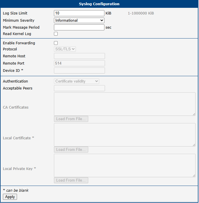

Syslog
The Syslog service collects and manages system messages from the router's operating system and applications. To configure it, navigate to Services → Syslog.
The collected logs can be viewed at Status → System Log, or via the command line with the slog command.
Local Logging
These settings control how logs are stored on the router itself.
| Log Size Limit | Sets the maximum size (in KiB) for the local log files. The default is 10 KiB. |
| Minimum Severity | Sets the minimum severity level for messages to be logged by the system. Levels range from Emergency (highest severity, least detail) to Debug (lowest severity, most detail). Note: Some components, such as IPsec or certain Router Apps, have their own independent logging level settings. These act as a secondary filter. A service-specific setting can make that service less verbose than the global setting, but it cannot force the system to log messages that fall below the global Minimum Severity level. |
| Mark Message Period | Sets a time interval for the router to write a -- MARK -- message to the log, which acts as a keepalive indicator. |
| Read Kernel Log | Check this to include kernel-level messages (e.g., firewall logs, device notifications) in the system log. Upon service (re)start, all existing kernel log entries are sent to the remote server, potentially resulting in duplicate messages; afterward, only new messages are forwarded. |
Remote Forwarding
The router can forward log messages in real time to a remote Syslog server for centralized storage and analysis.
| Enable Forwarding | Enables the forwarding of all log messages to a remote host. |
| Protocol | The transport protocol for forwarding: UDP, TCP, or SSL/TLS for a secure connection. |
| Remote Host | The hostname or IP address of the remote Syslog server. |
| Remote Port | The port number on which the remote server is listening. |
| Device ID | A custom identifier for the router, used in the forwarded log messages. If left blank, the default ID Router is used. |
Remote Server Authentication
These settings configure authentication when using the SSL/TLS protocol for secure forwarding.
| Authentication | The method used to authenticate the remote server: • None (encryption only): Encrypts the connection but does not authenticate the server. • Certificate fingerprint: Authenticates the server by matching its certificate fingerprint against the one in Acceptable Peers. • Certificate validity: Authenticates any server that presents a valid certificate signed by the specified CA. • Certified peer name: Authenticates the server by checking its certificate's validity and matching its DNS name or Common Name against the Acceptable Peers list. Note: The server may apply its own sender authentication settings, independent of this configuration. |

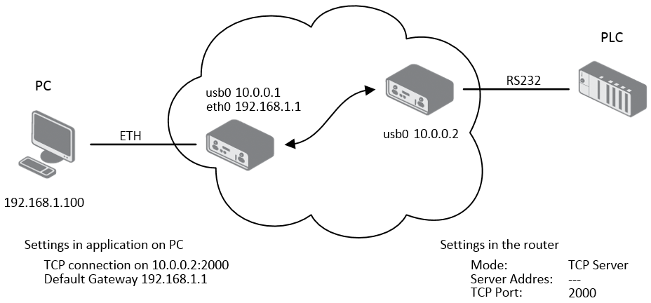

Ethernet-to-Serial Communication Example
This example demonstrates how to use the router as a gateway to connect a PC on an Ethernet network to a remote serial device. A PC at 192.168.1.100 sends data to the remote router (10.0.0.2) on TCP port 2000. The remote router is configured in TCP Server mode and listens for incoming connections. Once a connection is established, it forwards all data from the TCP socket to its RS-232 port, which is connected to the PLC. The first router (192.168.1.1) serves as the default gateway for the PC.
Serial Interface Communication Example
This example illustrates how to create a transparent serial tunnel over an IP network. The PC is connected via RS-232 to the first router (10.0.0.1), which is configured in TCP Client mode and initiates a connection to the second router (10.0.0.2) on port 2000. The second router, configured as a TCP Server, is connected to the PLC via its RS-232 port. Data from the PC is tunneled over the TCP connection to the second router and passed to the PLC.

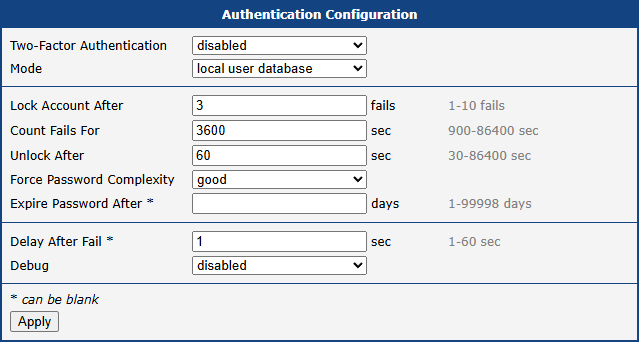

Authentication
The Configuration → System → Authentication page allows for the configuration of user authentication methods, password policies, and account lockout settings. The router can authenticate users against its local database or against external RADIUS or TACACS+ servers.
General Settings
These settings are common across all authentication modes.
| Two-Factor Authentication | Enables a second layer of security for user logins. Options include Google Authenticator or OATH. |
| Mode | Selects the primary authentication method: • Local user database: Authenticates against the router's local user list, refer to Manage Users. • RADIUS with fallback: Authenticates against a RADIUS server. If the server is unreachable, it falls back to the local database. • RADIUS only: Authenticates only against a RADIUS server. Caution: If the server is unreachable, login will be impossible. • TACACS+ with fallback: Authenticates against a TACACS+ server, with fallback to the local database. • TACACS+ only: Authenticates only against a TACACS+ server. Caution: If the server is unreachable, login will be impossible. |
| Lock Account After | The number of failed login attempts before an account is locked. |
| Count Fails For | The time window in seconds during which failed attempts are counted. |
| Unlock After | The duration in seconds after which a locked account is automatically unlocked. |
| Force Password Complexity | Enforces minimum password strength requirements. The four character classes are: uppercase letters (A–Z), lowercase letters (a–z), digits (0–9), and special characters (e.g., !@#$+.). • Good: At least 12 characters from at least 3 of the 4 classes; no more than 3 identical consecutive characters; must not contain the username; must not be a palindrome. • Strong: At least 16 characters from all 4 classes; no more than 2 identical consecutive characters; must not contain the username; must not be a palindrome. |
| Expire Password After | The number of days until a user password expires, forcing a change on next login. |
| Delay After Fail | The time in seconds the login screen is disabled after a failed attempt. |
| Debug | Enables detailed authentication-related messages in the system log. |

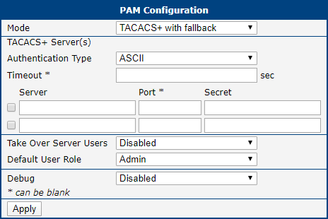

TACACS+ Mode
To use TACACS+ for authentication, select either TACACS+ with fallback or TACACS+ only and configure the server details.
Warning
As with RADIUS, a corresponding local user account is required for TACACS+ authentication. This account can be created manually or automatically with the Take Over Server Users option, as detailed in Manage Users.
| Authentication Type | The authentication protocol to use: ASCII, PAP, or CHAP. |
| Timeout | The time in seconds to wait for a response from the TACACS+ server. |
| Server | The IP address of the primary and optional secondary TACACS+ server. |
| Port | The TCP port of the TACACS+ server (default: 49). |
| Secret | The shared secret used to encrypt communication with the TACACS+ server. |
| Take Over Server Users | When enabled, a local user account is created automatically upon successful TACACS+ authentication if one does not already exist. The account is created without a password. |
| Default User Role | Assigns a default role (Admin or User) to users created via the Take Over feature. |

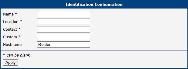

The Configuration → System → Identification page allows you to define several strings used to identify the router. These values serve multiple purposes:
- The Name and Location strings are displayed in the top-right corner of the web interface.
- The Name, Location, Contact, and Custom fields are exposed via SNMP for remote monitoring, as detailed in SNMP.
Info
Previously, these settings were located on the SNMP configuration page. They have been moved here to serve as a central point for router identification.
| Name | A custom name for the router (e.g., "Main Office Gateway"). Also used as the SNMP System Name (sysName). |
| Location | The physical location of the router (e.g., "Server Room A"). Used as the SNMP System Location (sysLocation). |
| Contact | Contact information for the person responsible for the device (e.g., an email address or phone number). Used as the SNMP System Contact (sysContact). |
| Custom | A custom string for any additional information. Used as the SNMP infoCustom field. |
| Hostname | The hostname of the router, used to identify the device on the local network (e.g., in DHCP leases). |
